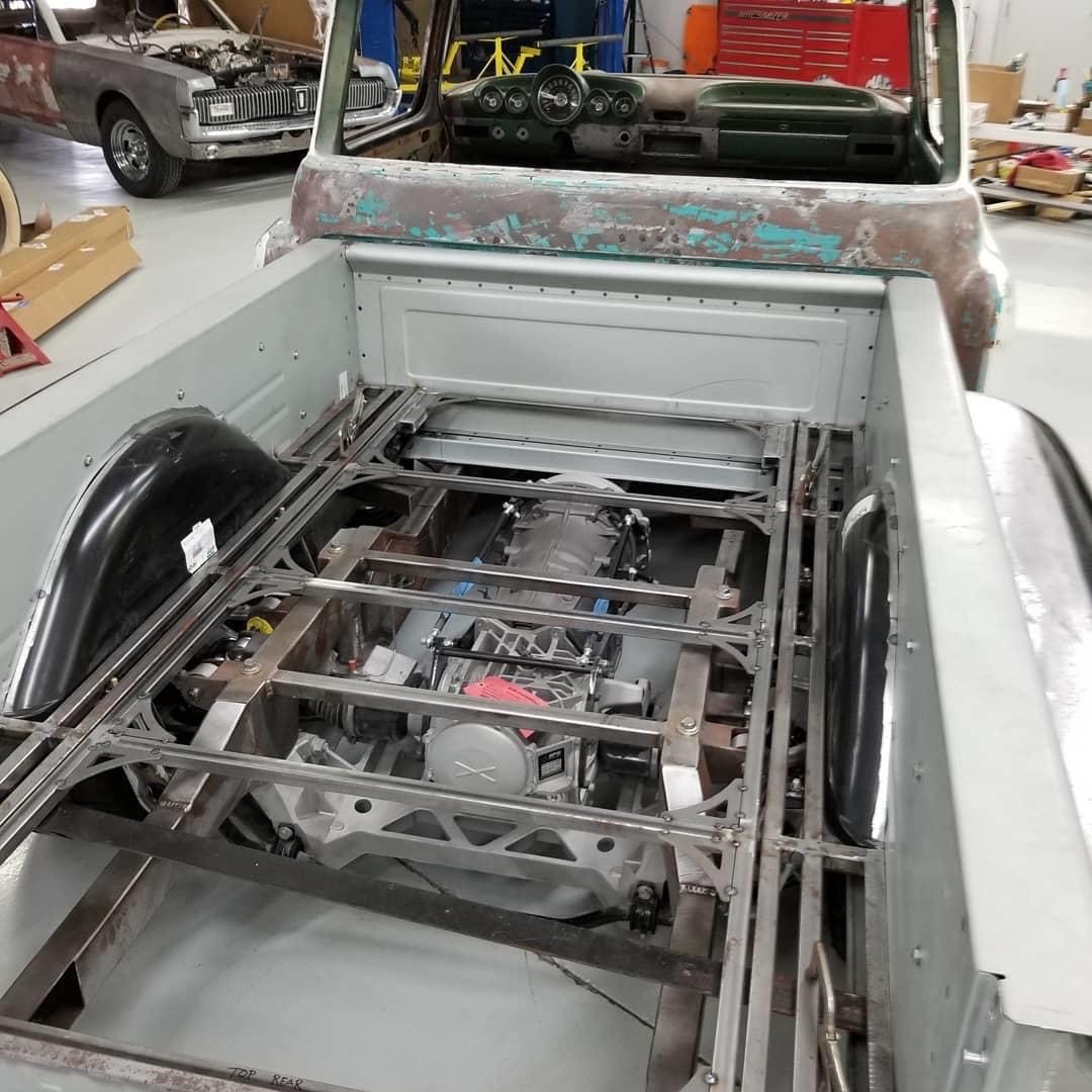

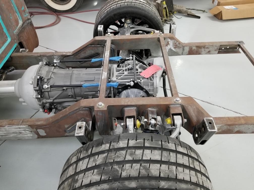

      Finally back on things. Chassis was off a little bit so we had to take the cab mounts off the pass side and zero in the cab and front end assembled before welding back on the mounts.
      Well, mounts and and the front mounts are tacked on too. Everything is lining up nice now and centered...
      Here are current pics.

      Dear god that rear end shot is NSFW! This looks monstrous compared to my lowly Mustang IRS. I'm liking what I seeing. Keep up the good work!
      Also just realized you're in Phoenix too...small world. We gotta get a truck cruise together when our trucks are done.

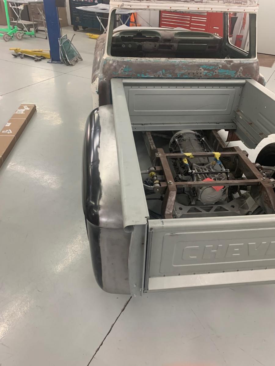

      Here are some updates. Slowly coming together. I bought the corvette wheels and wanted to stick with the Corvette Z06 factory wheel size and offset. I have to split the rear fenders and add about 1-3/8".
      Here is the Mar-K bed coming together. raising the floor about 4-1/4" too.

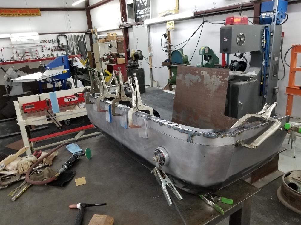

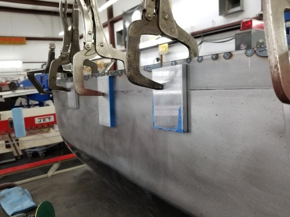

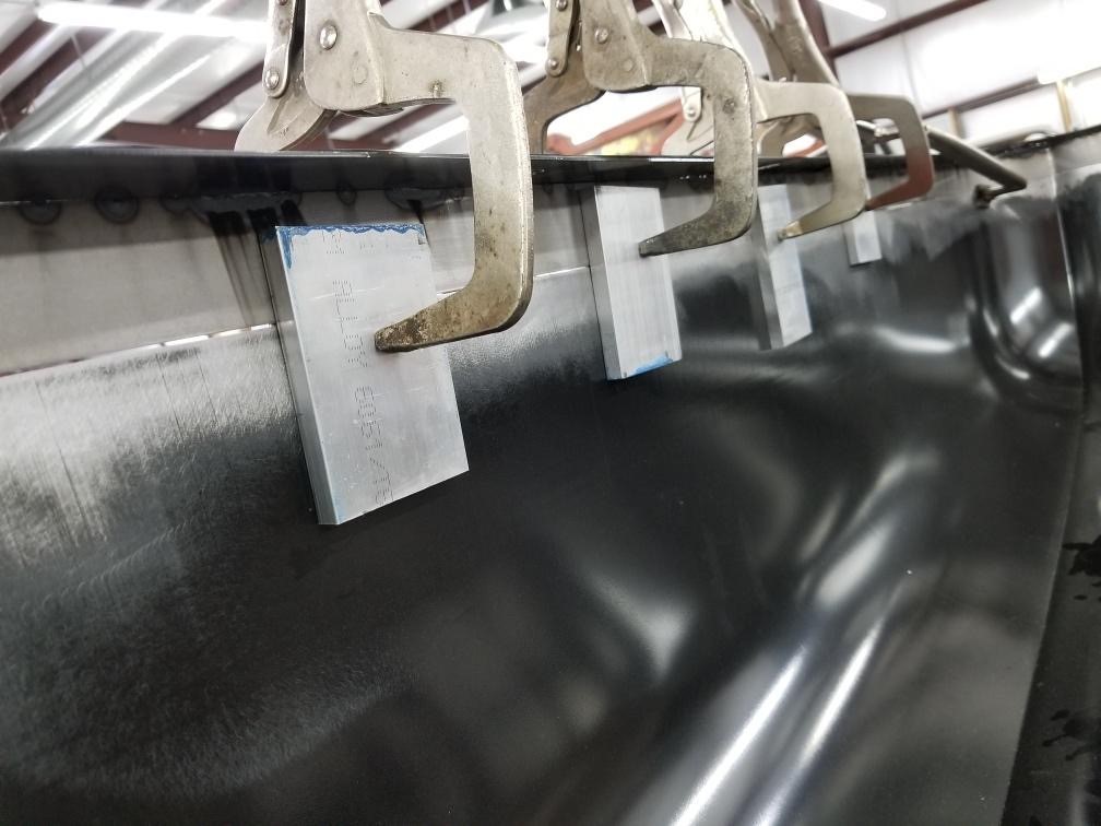

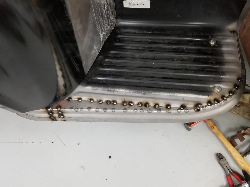

      Here we go. Getting busy on this project again. Bed mounted and fenders widened. Step is a little work. Also came across a nice 51-52 Cadillac front bumper. Going to work this in.Name:  step.jpg
