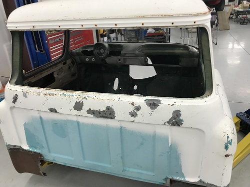

      So I have built a few resto-mods in the past and just sold my twin turbo & supercharged Grand National and am ready to move on to my next project that will be my passion. As I'm getting older I have been really loving old trucks... So I thought I would spends a couple years building a 59 Chevy Apache with all Corvette C6 Grand Sport and ZR1 components.
      I live in Arizona and sourced a good body.
Size:  274.3 KBName:  94EB694C-2E00-4F73-997E-D0BA72553300_zpse40ogxk8.jpg

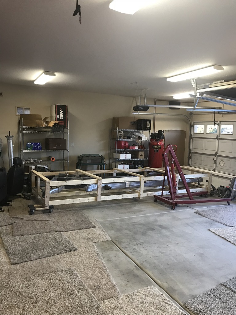

      Progressive Chassis showed up:Name:  45FC370A-5178-4949-9D74-33E89049E2B0_zpsn33v6dmz.jpeg

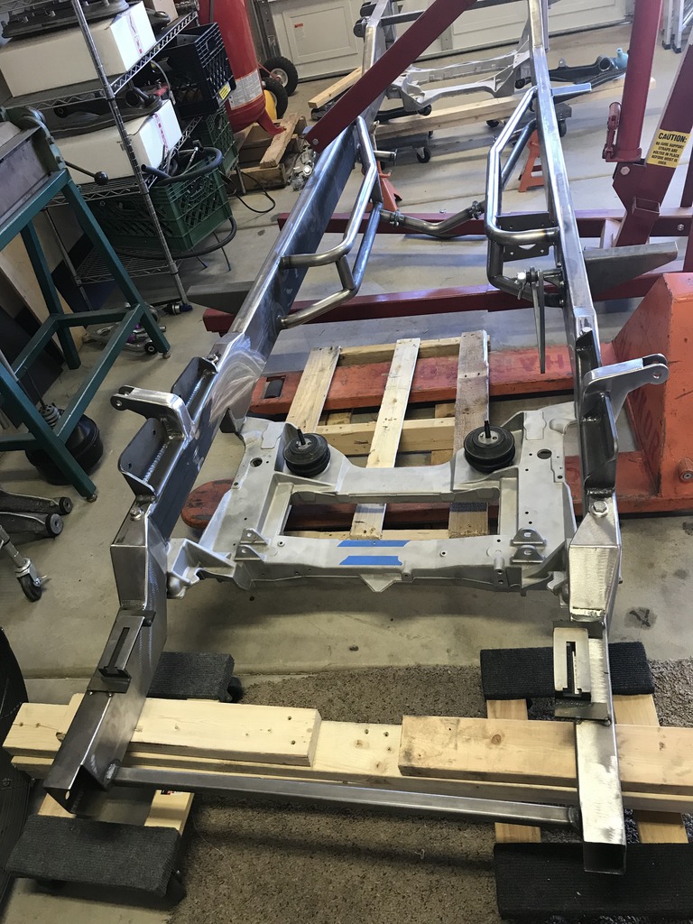

      unboxed and Corvette Cradles installedName:  102BA157-C675-481C-ACBE-4CE8D5504CC3_zpsbpkyvkhi.jpeg

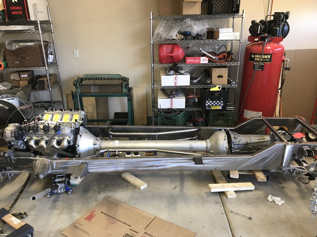

      Drive train installed. Set engine back about 2", but torque tube still too short.Name:  4E2643D5-2B08-47C4-8C1A-31B83C5D9670_zpsavel2rwm.jpeg

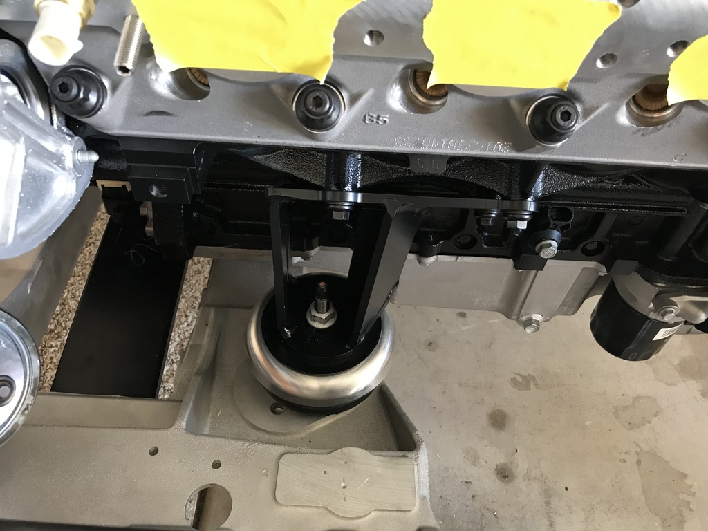

      Fabbed up motor mounts to move engine back to clear blower pulley from rack.Name:  35D7DF80-D7BA-4730-9348-1F40E5A3AB86_zpskkqpmb30.jpeg

      Yep, Gamel street rods took care of the torque tube. They installed a larger drive shaft and ZR1 couplers.

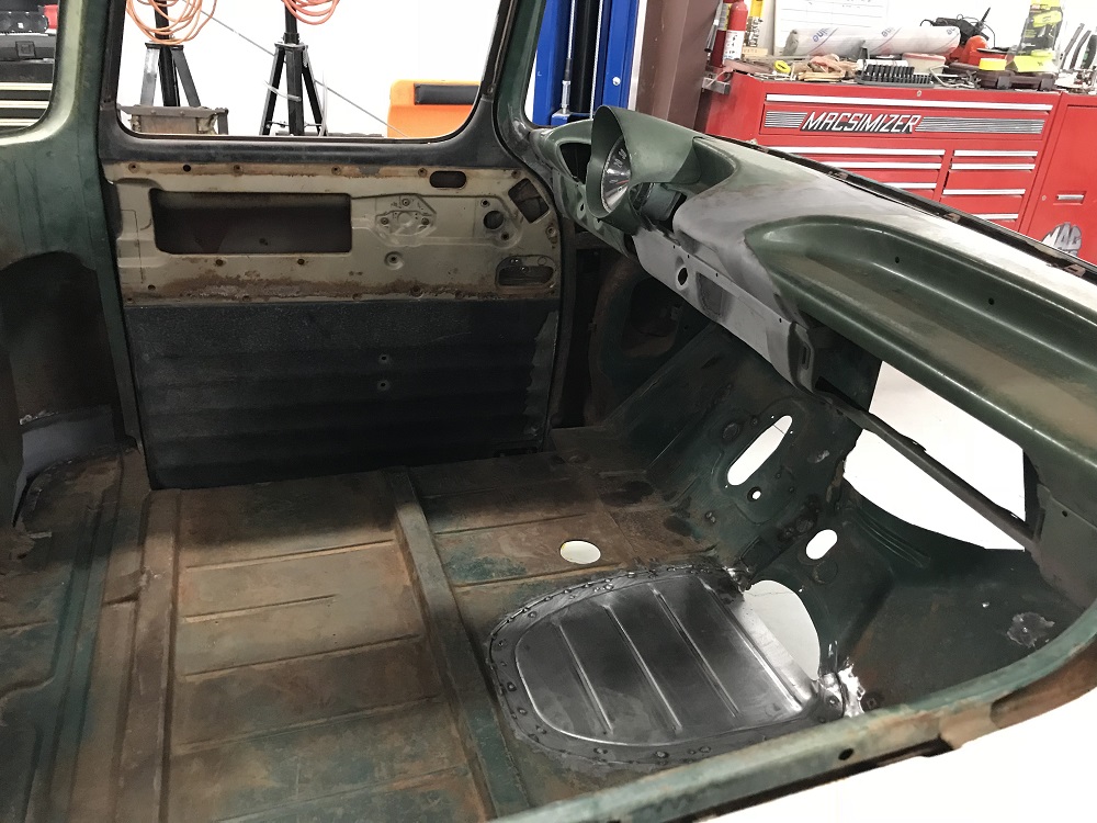

      Cutting out the old dash and putting in the 59 Impala dash. It was about 4" too wide. decided to take it out of the middle to line up the steering column with the factory location(hole in the floor).

      I too am using the stock front suspension cradle from a C5-C6 corvette. I have to fab my top rails and could use some measurements from you. If that is ok with you these are what I need.
      1. Face to face of the upper mounts across the top.
      2. Angle of upper control arms.
      3. Height of the upper control arms compared to a set spot on the cradle.
      4. static caster.
      I can provide a drawing of what I want in the next few days if that would make it easier.
      Jun 2013
      Phoenix
      112
      Egoman- PM sent
      Apr 2011
      Rosser Manitoba Canada
      338
      These are the measurements that I am looking for.
      A is the degrees of the upper control arm
      B is the distance between the mounting surfaces on the opposite sides
      C is the distance from the center of the forward mounting bolt to the center of the control arm attaching bolt.
      D is the vertical distance from the top of the sub-frame to the center of the control arm attaching bolt.
      E may be redundant but its the distance from the top of the rear sub-frame attaching point to the center of the control arm attaching bolt.
      Jun 2013
      Phoenix
      112
      Egoman: To the best of my ability
      A= 5 degrees
      B= 35-1/2"
      C= 2-7/8"
      D= 6-3/8"
      E= 8-1/4"
      Hope this helps
