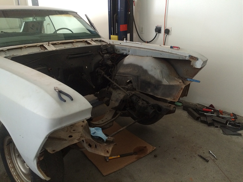

      Jeff went searching for rust...and found it...as well as dirt, sand and god knows what else haha.
      Radiator Support...toast...Jeff will be making a custom tubular support for the car so this wasn't a big deal
      But this will need to get replaced, just behind the front passenger wheel well

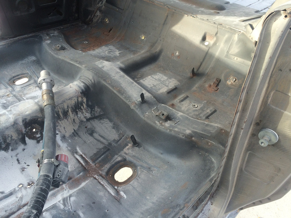

      A little update on the Chevelle. It got soda blasted by Dwight of Advanced Stripping Technologies which turned up some ‘suspect’ areas. Either way it’s good to see the car making the next step but I’m hoping the damage isn’t extensive and isolated to certain areas.
      Dwight hard at work.
      The ‘suspect’ spots where a lot of filler was used, these will be getting glass beaded to see the true state of the metal before going off for primer, crossing my fingers…
      Pin holes showed up in the floor…
      In the case for the driver door, filler was used to fill rust spots that rusted right through, awesome.
      Some typical rust spots were found that weren’t surprising like the lower windshield mounting area and trunk edge.
