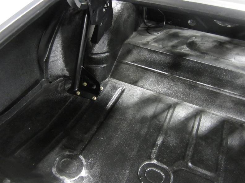

      Great job! If I may ask which spray on box liner do you guys use?
      Thanks!
    3. #43
      Jul 2013
      St. George, UT
      1,144
      Thanks guys!
      There are a lot of great products out there and in trying a few we lean towards Defender Pro. It sticks well (prep is still important), is durable, has a bit of sound deadening quality and lays down nice. It' doesn't do much for blocking heat so we still use Dynomat inside as well.

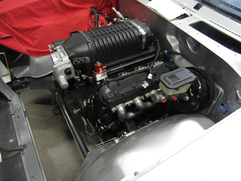

      Moving forward with the engine install, lots to do here. This shows the positioning pretty well in the ExtReme chassis. We make custom air intakes for each car, that way we can control exactly where and how we place the air filter. Note we had to machine the "whipple" logo off the supercharger for hood clearance. With some slight mods to the underside of the hood support this all fits under a stock hood!

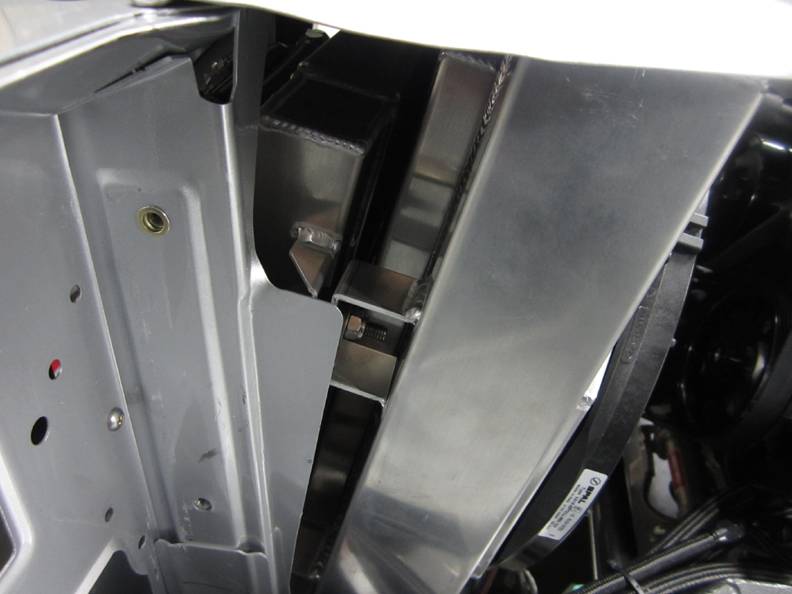

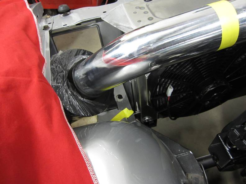

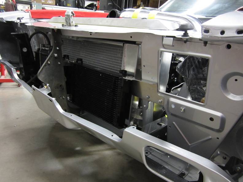

      Off to the side will be a custom air box that opens up to the grill area for cool fresh air. Up front we have a radiator, A/C condenser, intercooler, and uber heavy duty oil, power steering and trans coolers. Lots of plumbing on deck! Custom radiator support and brackets will be powdercoated silver to match the engine bay.

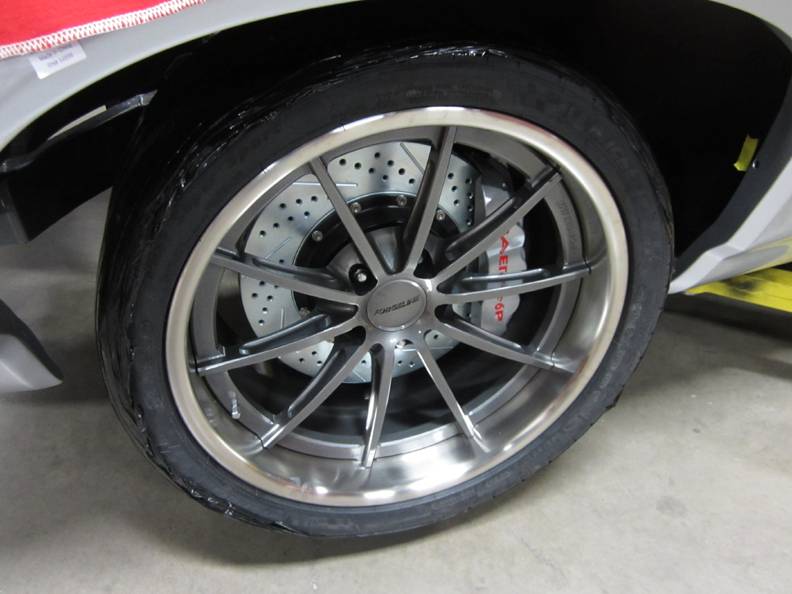

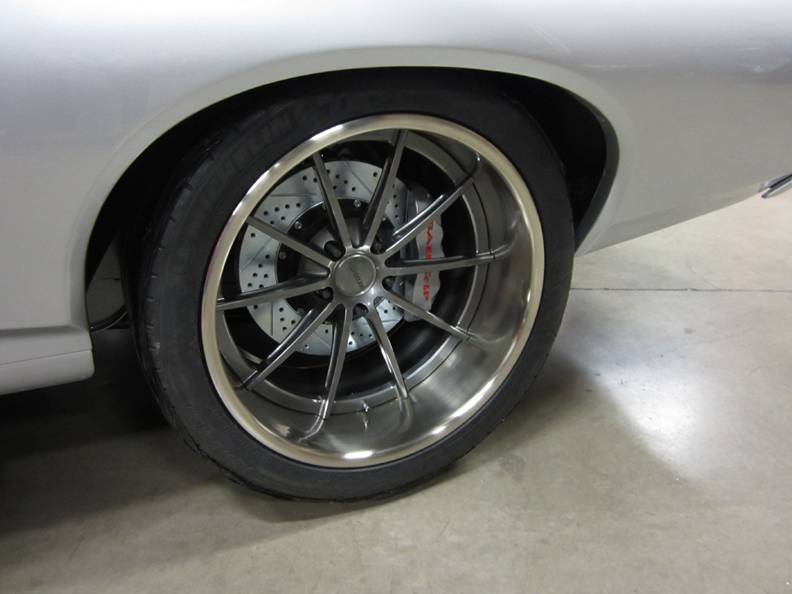

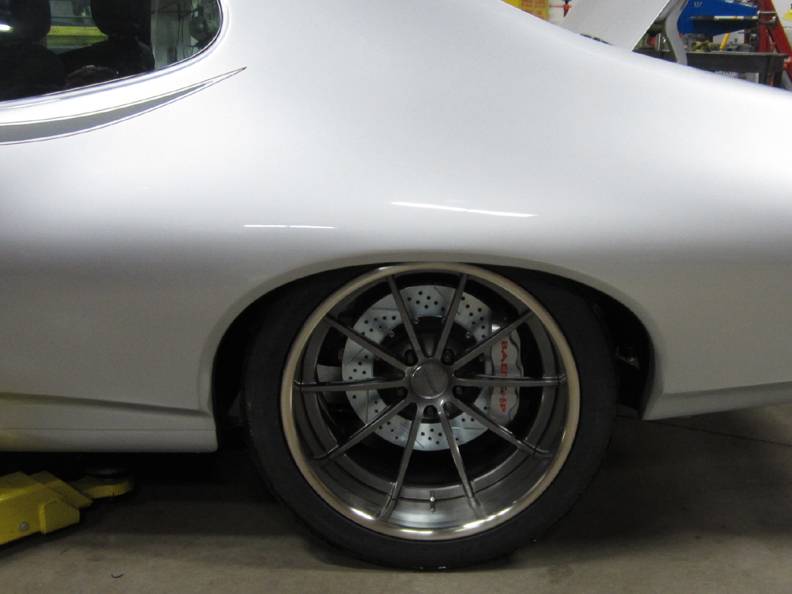

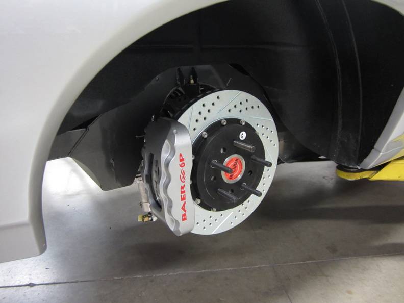

      The GTO's brakes were feeling a little lonely, luckily the new wheels and tires finally showed up. Check out the impact that brushed nickel has, man that's a cool look! This car sports 295-30-19s up front and 345-30-20s out back.

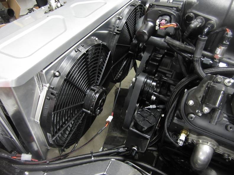

      A couple more pics of the cool, ...er, cooling parts. Dual fans, radiator, condenser, intercooler, then fluid coolers. Jeremy's still working on the plumbing and wiring so that'll all be routed and tucked in there nicely when he's done.

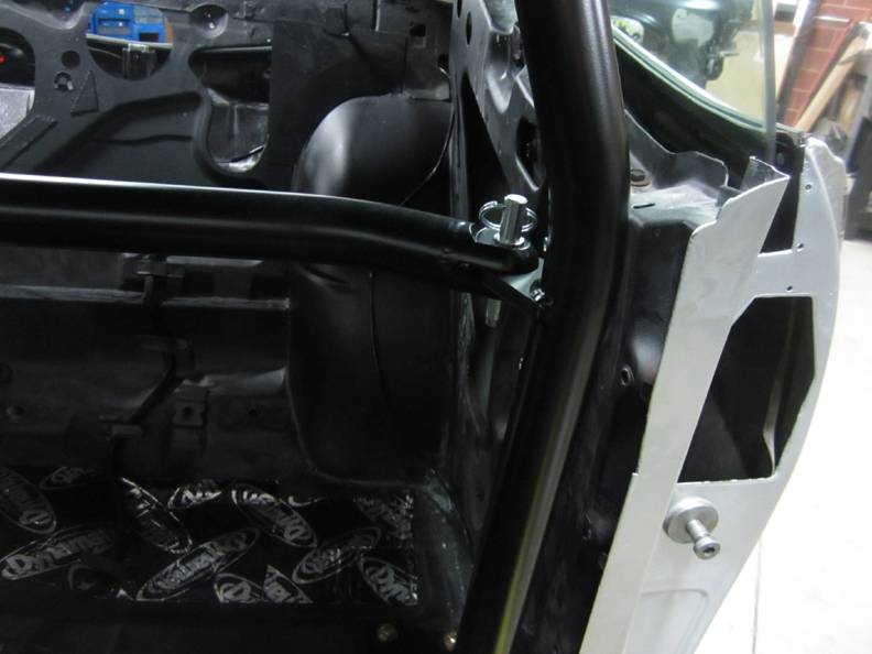

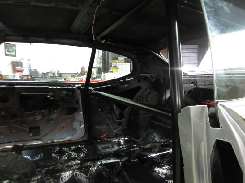

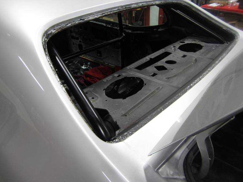

      Next up was the roll bar. Not intended to be NHRA legal, our customer wanted a 4 pt bar with rear seat access. Jeremy custom bent this one to be practical and tucked in there nice and neat.

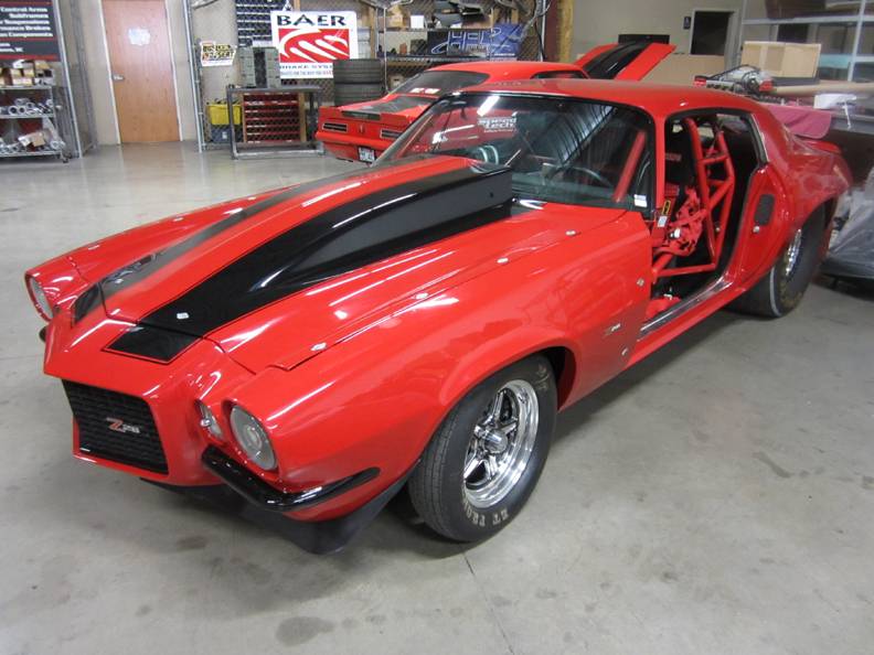

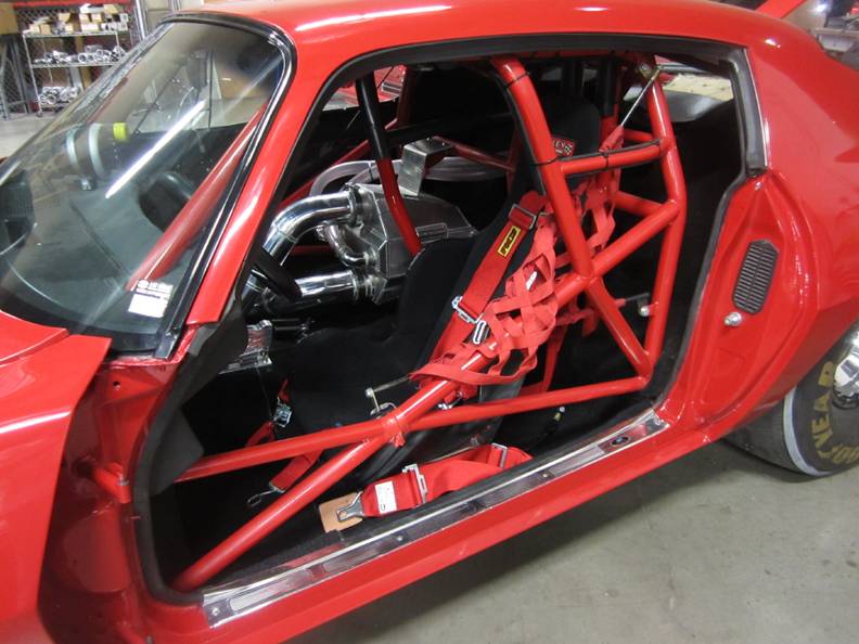

      For those tempted to think going with a 4 pt the customer doesn't understand good roll bar design, well this is his other car which is also at our shop for some upgrades. Now that's a roll cage. :D

      Nice progress Ben, and great job on the roll bar! I have to bend my back brace bars to follow the roof line like that.

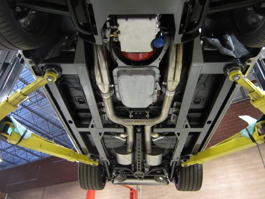

      Quick update- The underneath is mostly done, the exhaust system being the latest venture. Notice this is 3" stainless tubing with some electric cut outs for play time. I'll have more pics up soon that show all the details under here.

      I like the way you guys made the H-pipe!
