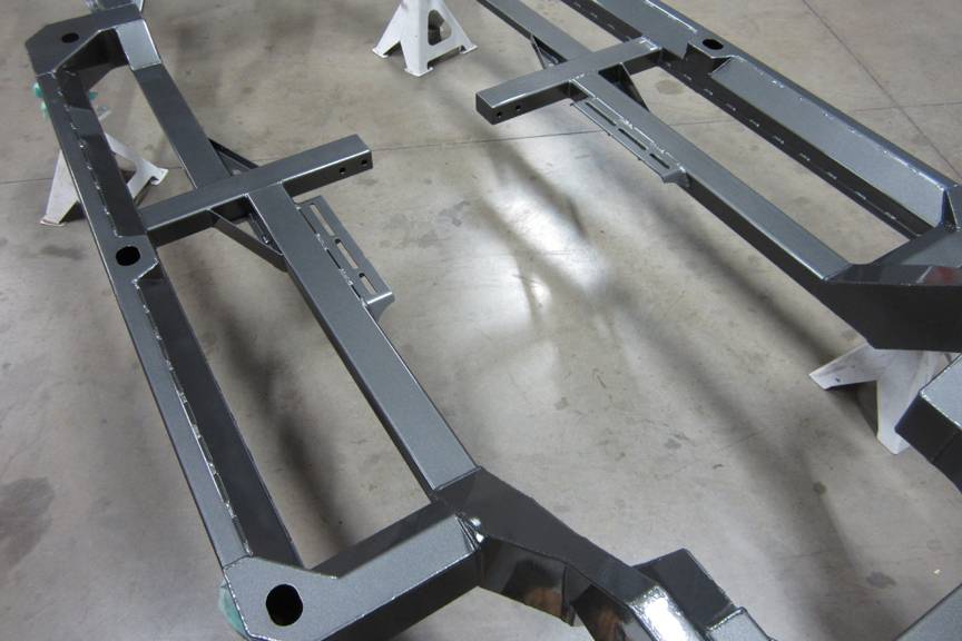

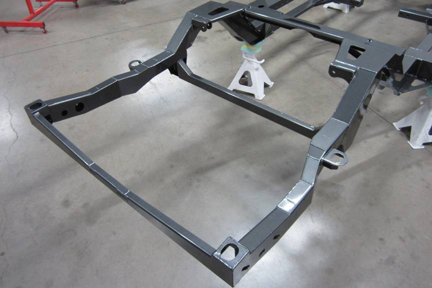

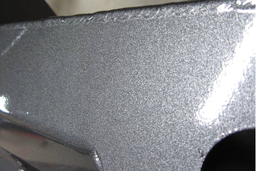

      Some pics of the bare "after the prototype's revisions" production frame. This car got our gunmetal grey metallic powder coating. Lookin good!
      More coming soon...

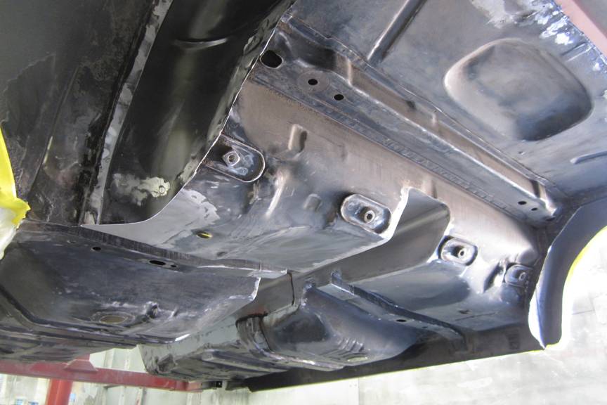

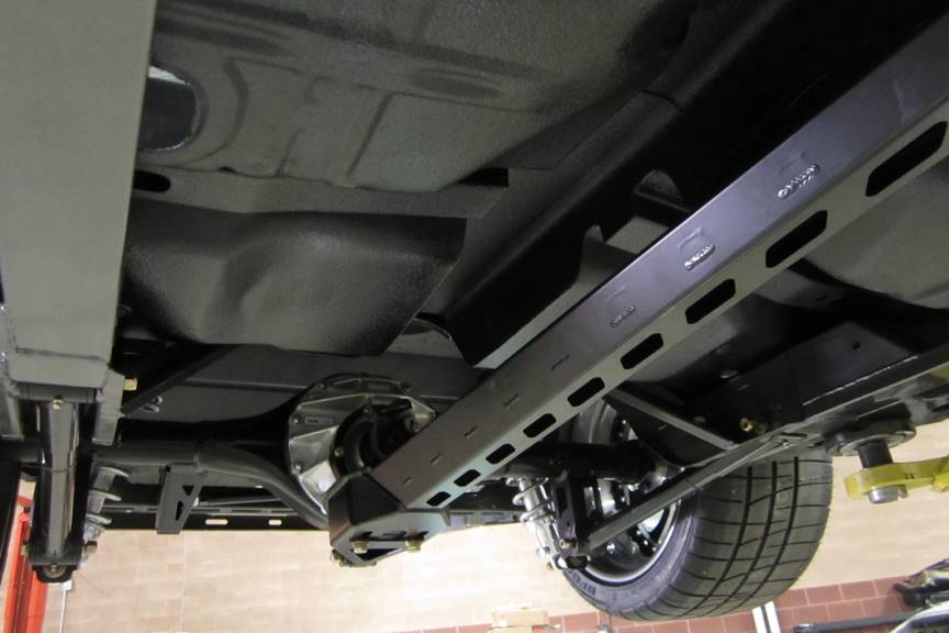

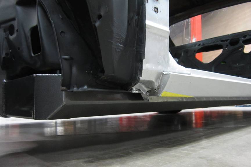

      Will raising the tunnel in the rear neccesitate modifications to a stock seat bottom?
    3. #23
      Jul 2013
      St. George, UT
      1,144
      The stock floor is fairly low back there, so at this point our measurements say yes. You should be able to modify the center inner seat support to clear the tunnel and maintain the factory bench rear seat. We're not quite to that point in the build yet but so far that's what we're seeing. Note that our chassis is designed to maximize suspension travel range even at this low ride height. This necessitates the taller tunnel to clear the driveline at full suspension compression. The front will need to be converted to bucket seats if it has not been already, but we suspect a front bench seat pro touring car will be somewhat rare anyway.

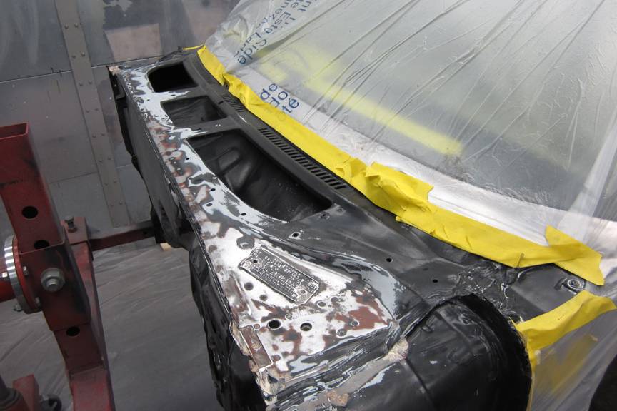

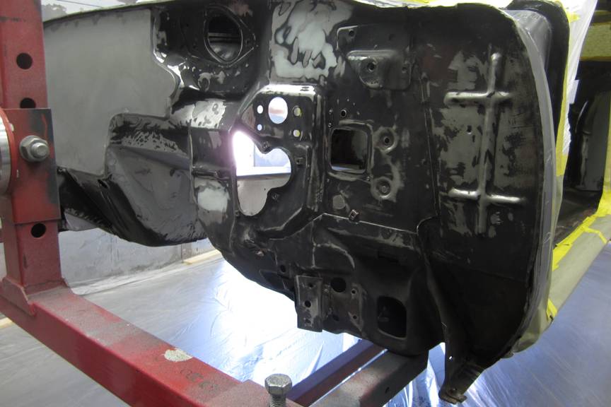

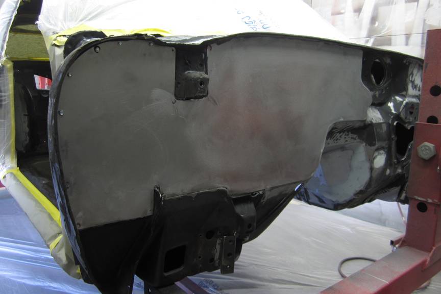

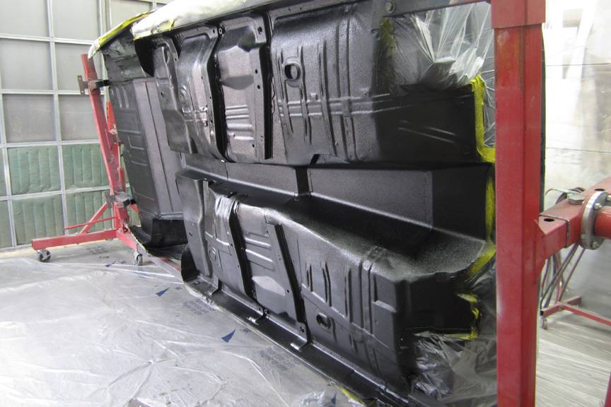

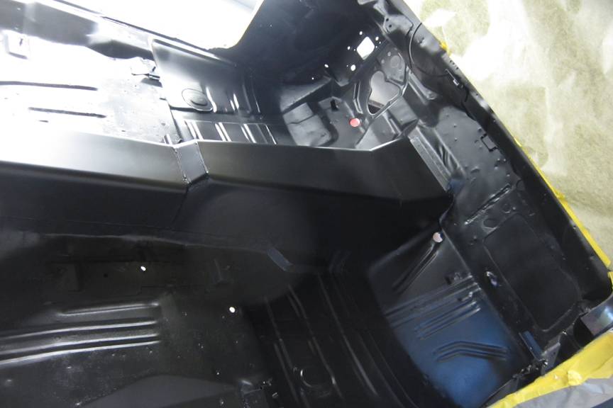

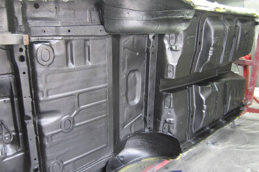

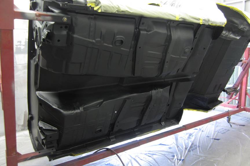

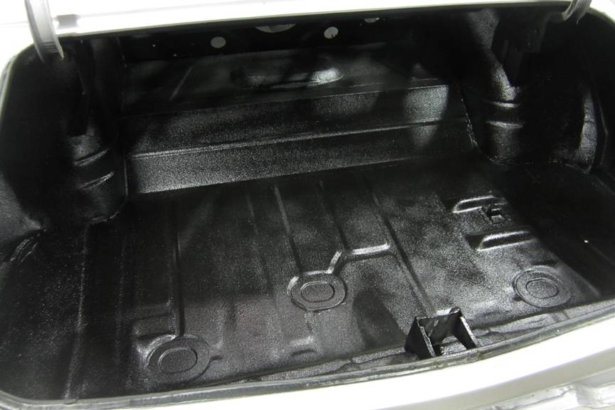

      More updates! With the frame powder coated and ready to install our attention got us back to the body, by cleaning up and smoothing the firewall and prepping everything for paint and box liner.
    14. #34
      Jul 2013
      St. George, UT
      1,144
      We like to use black epoxy primer to seal everything first, including the interior areas. Then in the exposed areas and the trunk we use spray on box liner as a second application. It's super durable, has a nice color and sheen to it, and along with the texture gives a nice contrast to the shiny frame and suspension parts. We're like form and function here.

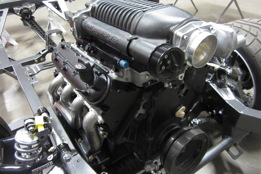

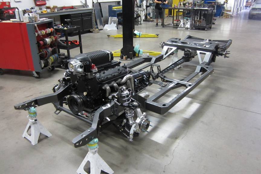

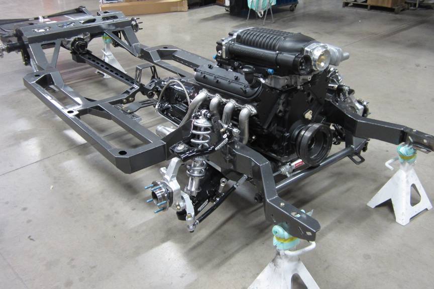

      While the paint and body crew were working on their handiwork the mechanical crew mocked up the engine and fitted our 1st set of production A body headers. For each of our applications we initially design and build the headers in house, considering both component and ground clearance specifically at a low ride height, and then send out that design for production models. In this case Ultimate Headers is building our ExtReme headers exclusively for us using their high quality materials and production processes. The end result is a super nice header that fits perfectly in our applications.
      The engine here is LS3 based however everything internally has been upgraded. This motor was previously run by the owner in a late model Camaro which dipped into the 10's in the 1/4. Pulled out and freshened up for the GTO, the lighter weight A body should see a further drop in track times. He also shared with us it made a great around town cruiser too. This will be the ultimate GTO when it's back on the streets, right?

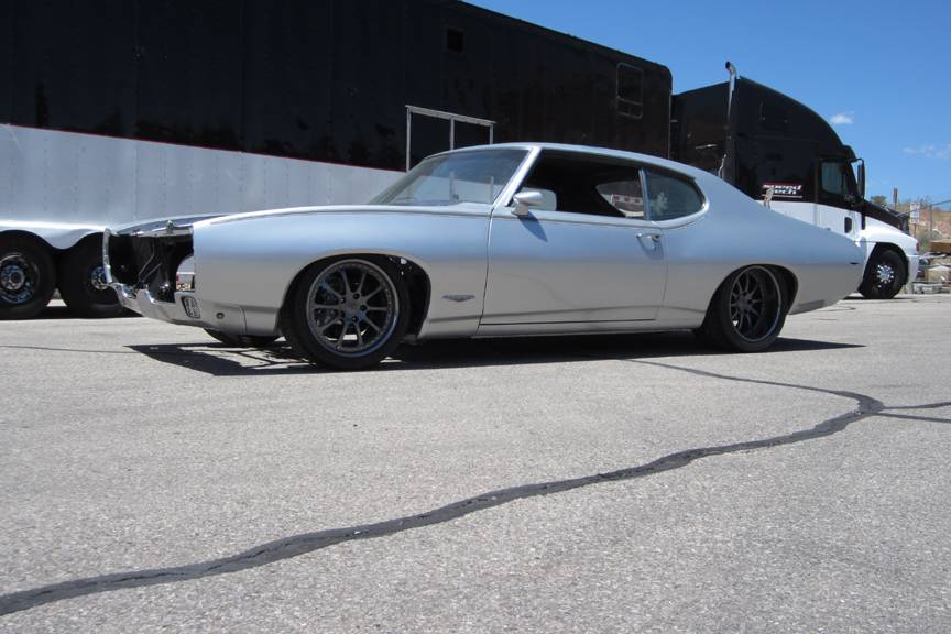

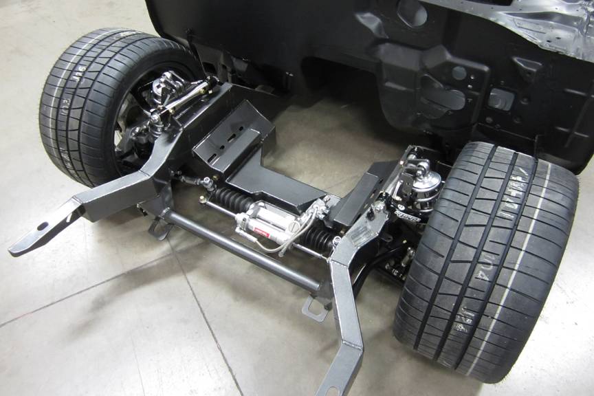

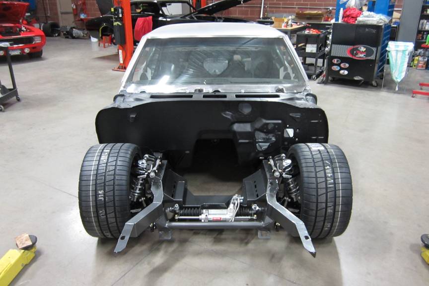

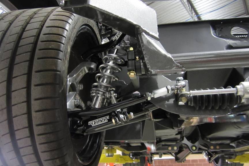

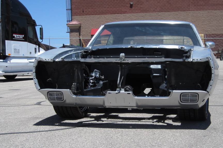

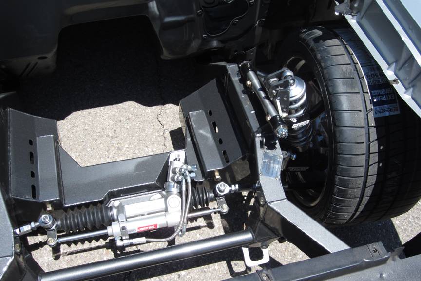

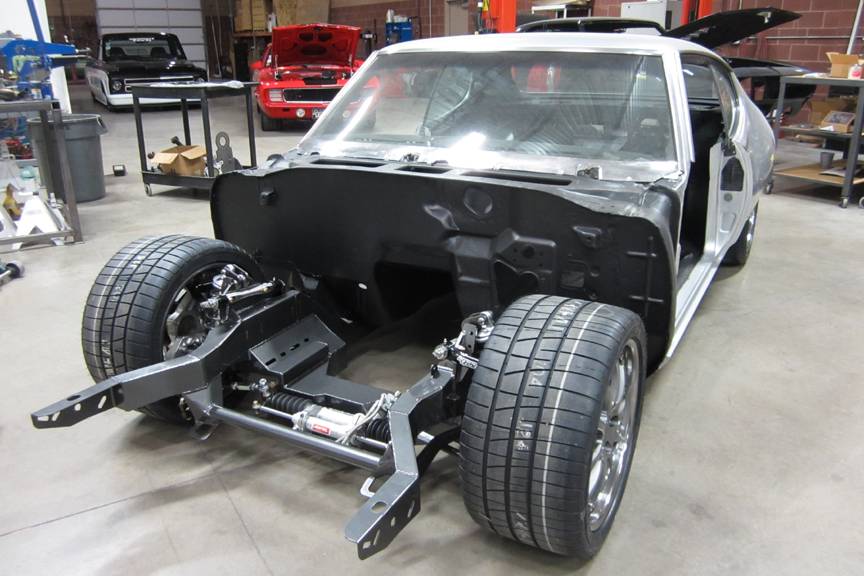

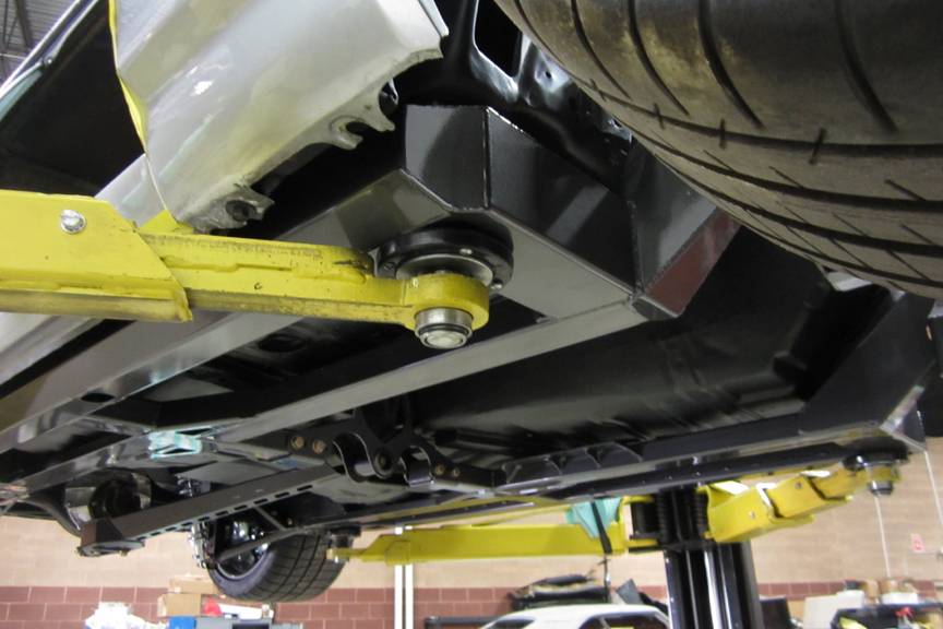

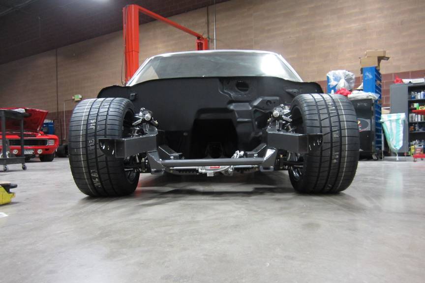

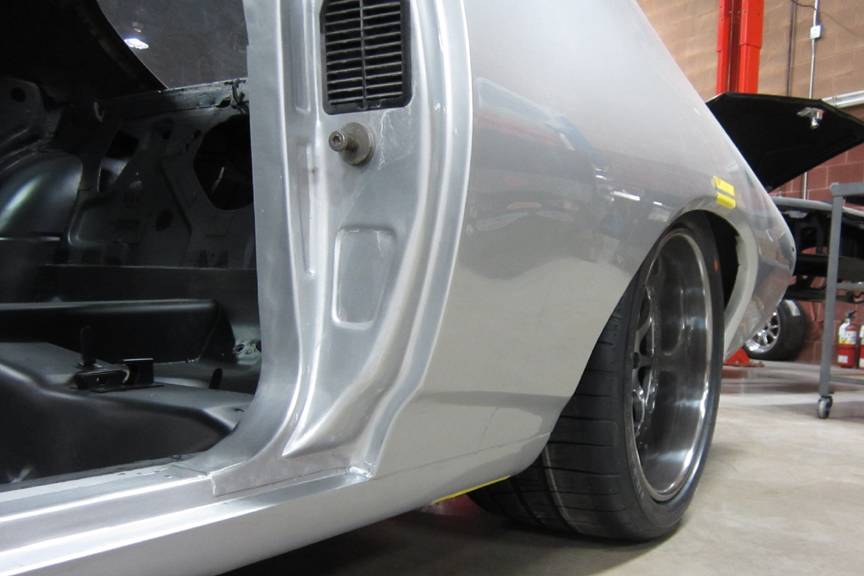

      Next objective was installing the frame into the car and having a good last look at clearance and suspension geometry at ride height. For this we installed 315 30 18s on the front and 335s out back. Everything is looking perfect and working out just as we anticipated. I know some of you will have questions about clearance and all, hopefully I have everything covered in the pics. If not let me know and maybe I can shoot something specific for you.

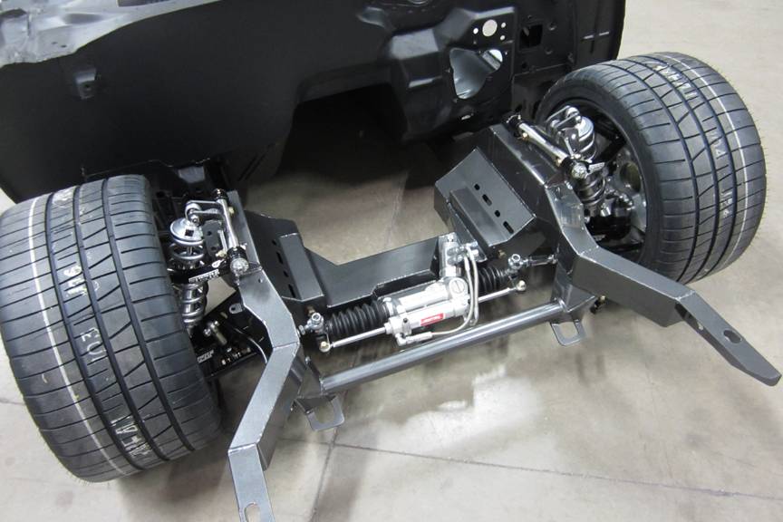

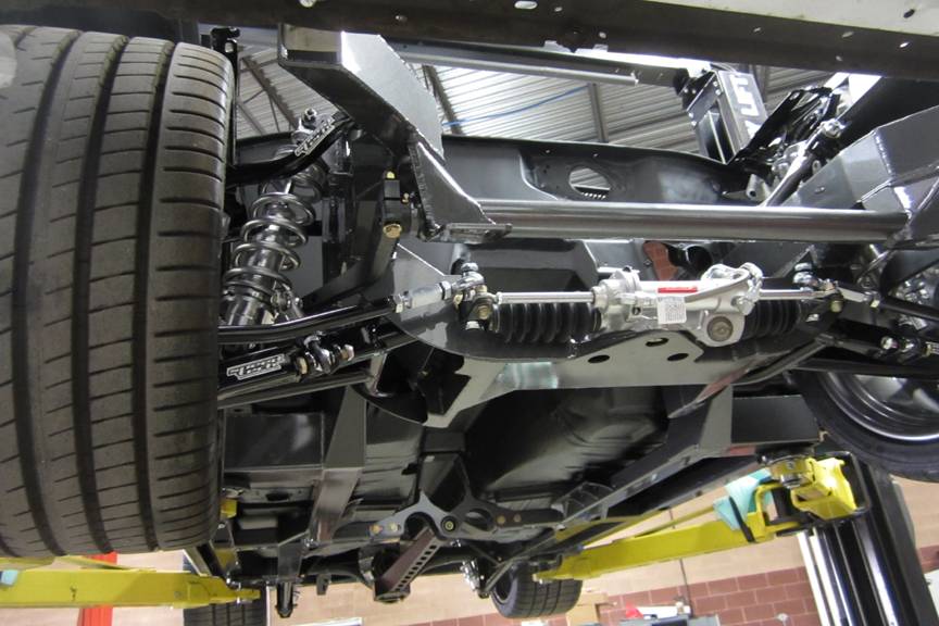

      More install pics...

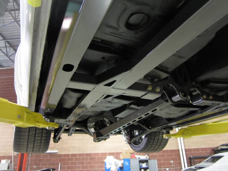

      And with the front clip and doors on. The 5th photo down from a ground up view the truck's tire makes it look there's something hanging down under the cross member that goes under the engine. There's actually a good deal of clearance there, even at this low ride height. Our goal was to have incredible geometry with plenty of suspension travel yet not have to worry about bottoming out at all.
