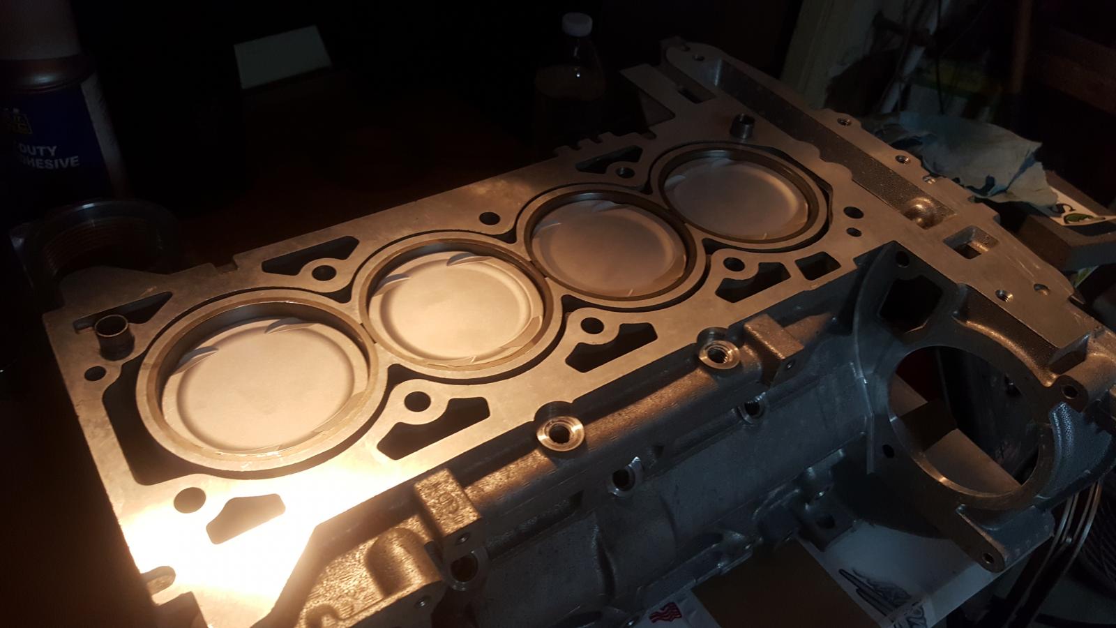

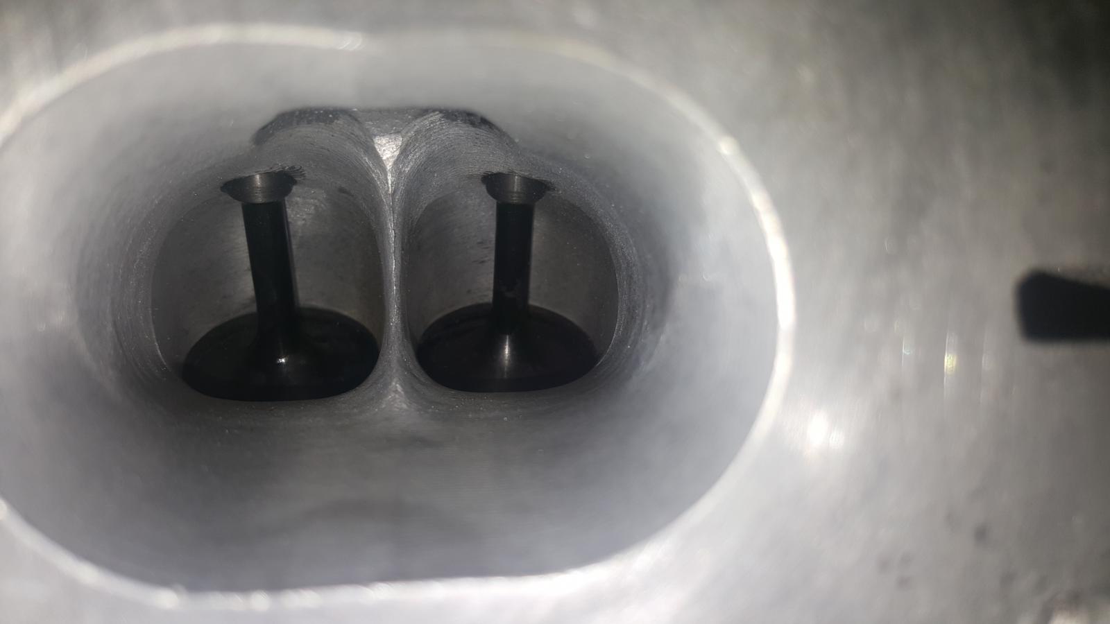

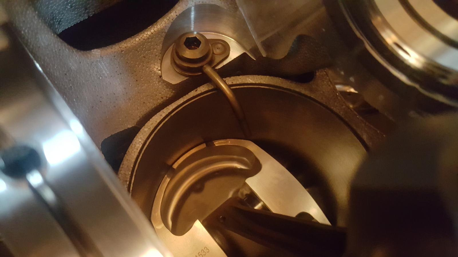

      More progress. Its 115° today so not much more is going to happen.

      That piston looks looks like it is sticking out pretty far! :^(
    12. #192
      Feb 2016
      SoCal
      475
      Nope not really. About .007" as planned. Wanted to get a nice quench this time around.

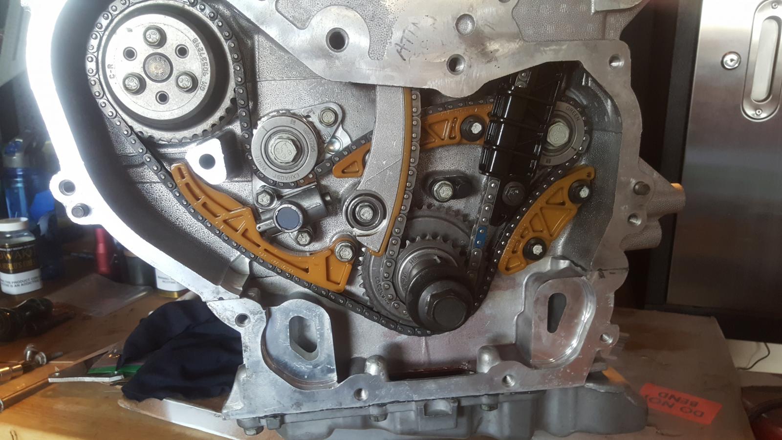

      Off to another good start today and then hit a snag. Got all the block plugs painted and in, neutral balance shafts and chain on, head gasket and studs in, cant find head stud nuts anywhere... at a stand still now

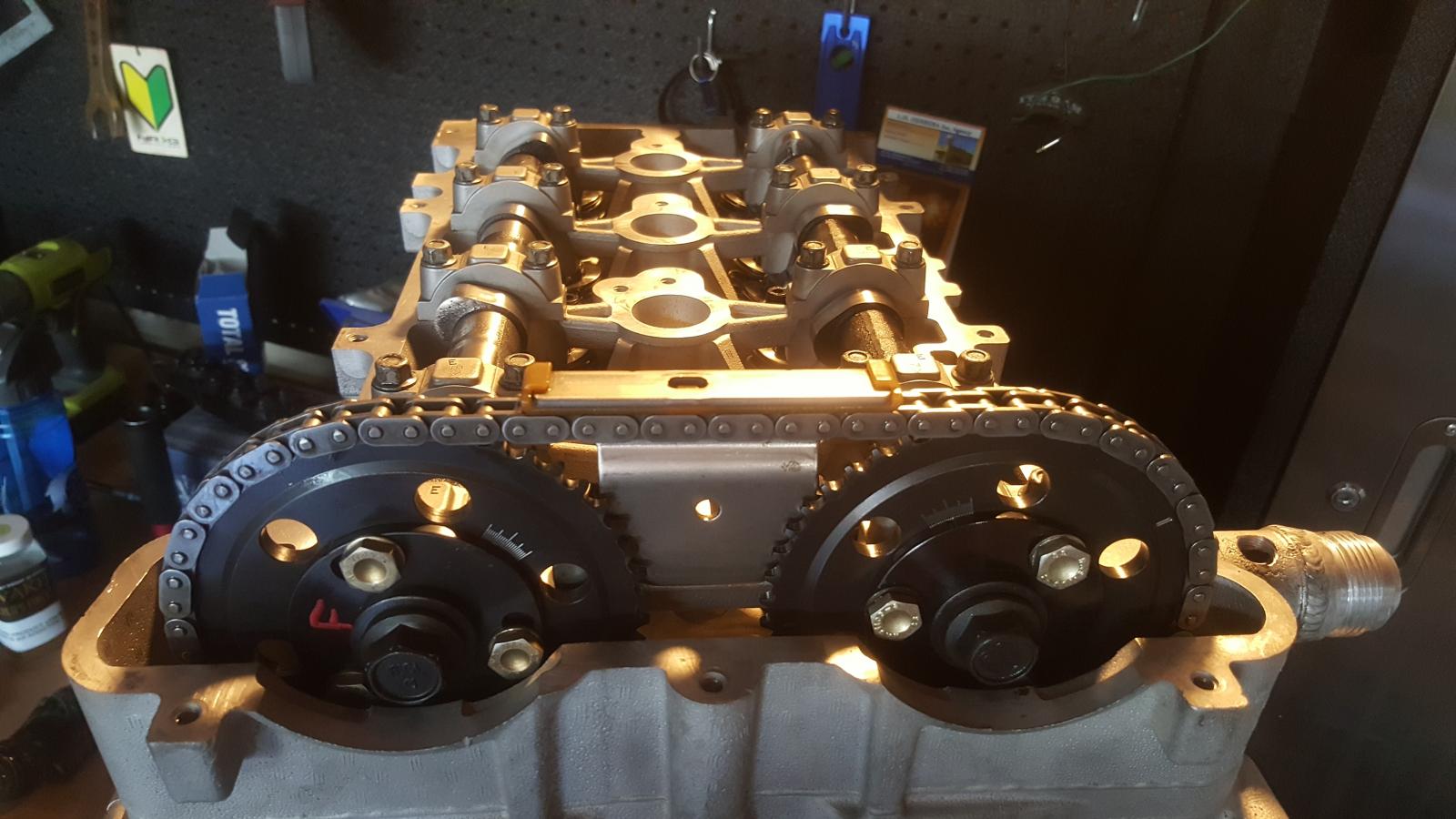

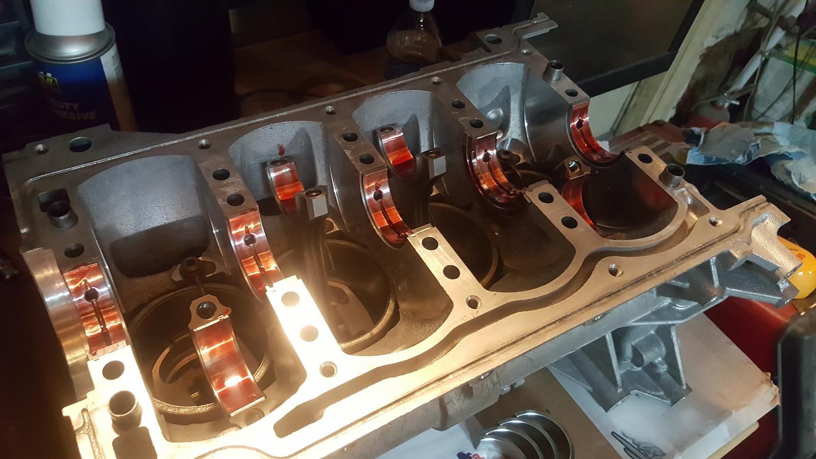

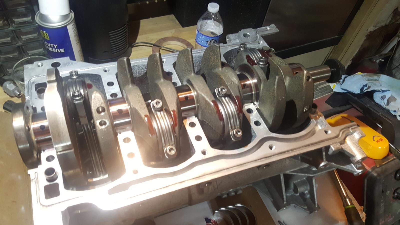

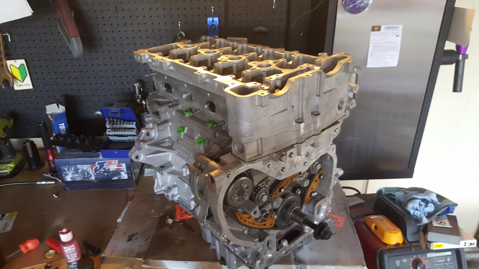

      We have long block completion.
