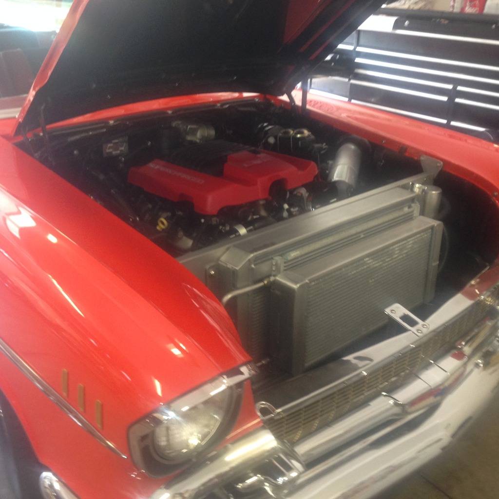

      The learning curve continues..........I didn't take the car to the Automotion show in the Dells as planned because the Intercooler wasn't working........I had the car running for a while and was checking the cooling system with my infrared heat gun........Noticed the intercooler was ambient temp.......Hummm.....Check the intercooler lines and just a gradual heat change Hummm.......I checked the plug and had Power.......Humm.......I added a Reservoir for the coolant that was higher than the Supercharger and it was full.....but there was no movement of coolant when running.........I called Pace Performance (where the system was purchased) and told them the pump wasn't working........They said they would Warranty it and send out a new one.........(paid for in advance till they got the defective one back)........So.....We get back from the Dells and the box was waiting for me.........Beautiful !!!....So......I change out the pump......fill with water again (was surprised there wasn't a lot of coolant leakage from the line from the intercooler).......started the car and the pump ran for about 10 seconds and shut off...........Darn !!!.........Check all the fuses......everything good.....
      Hummm!!!!.........Come in the house and do a Internet search about the pump........Found a thread about this exact problem..........Air in the System.......When the pump sees Air it turns off......Hummm....System is full at it's highest point..........Hummm.......Go out and now Focus and this issue...........I ended up putting a "T" fitting from a Radiator flush kit in the upper Intercooler hose....I back filled the Intercooler that I thought was full wit 3/4 of a gallon of coolant.....capped it off and it now works perfectly..........Sheesh !!!.......This car stuff is Hard !!!!

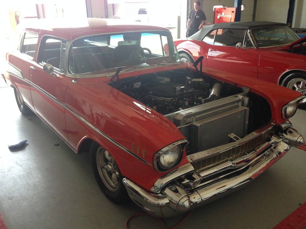

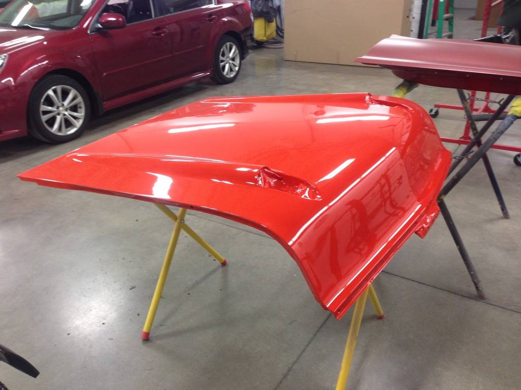

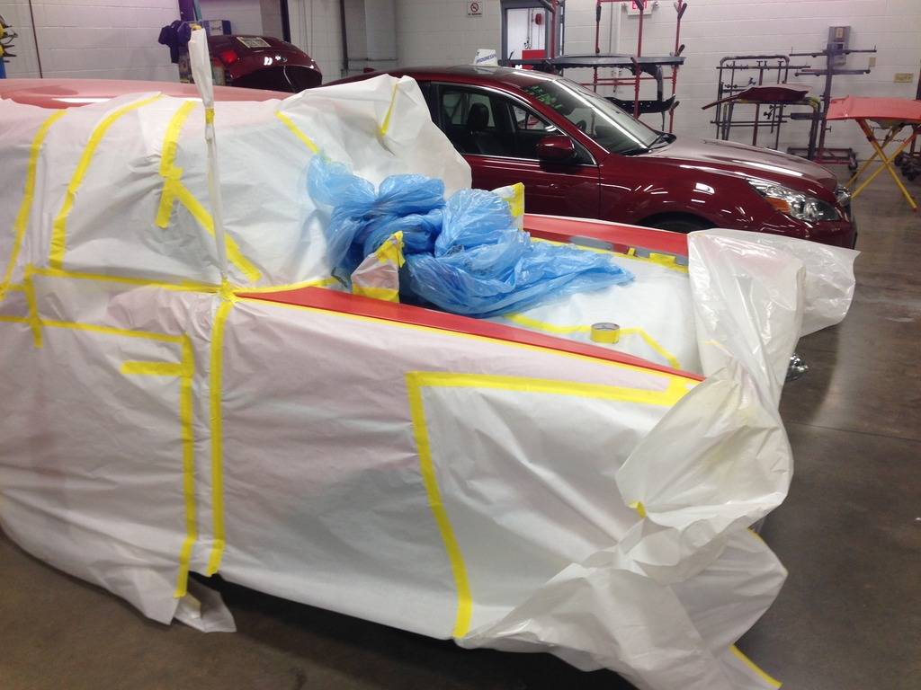

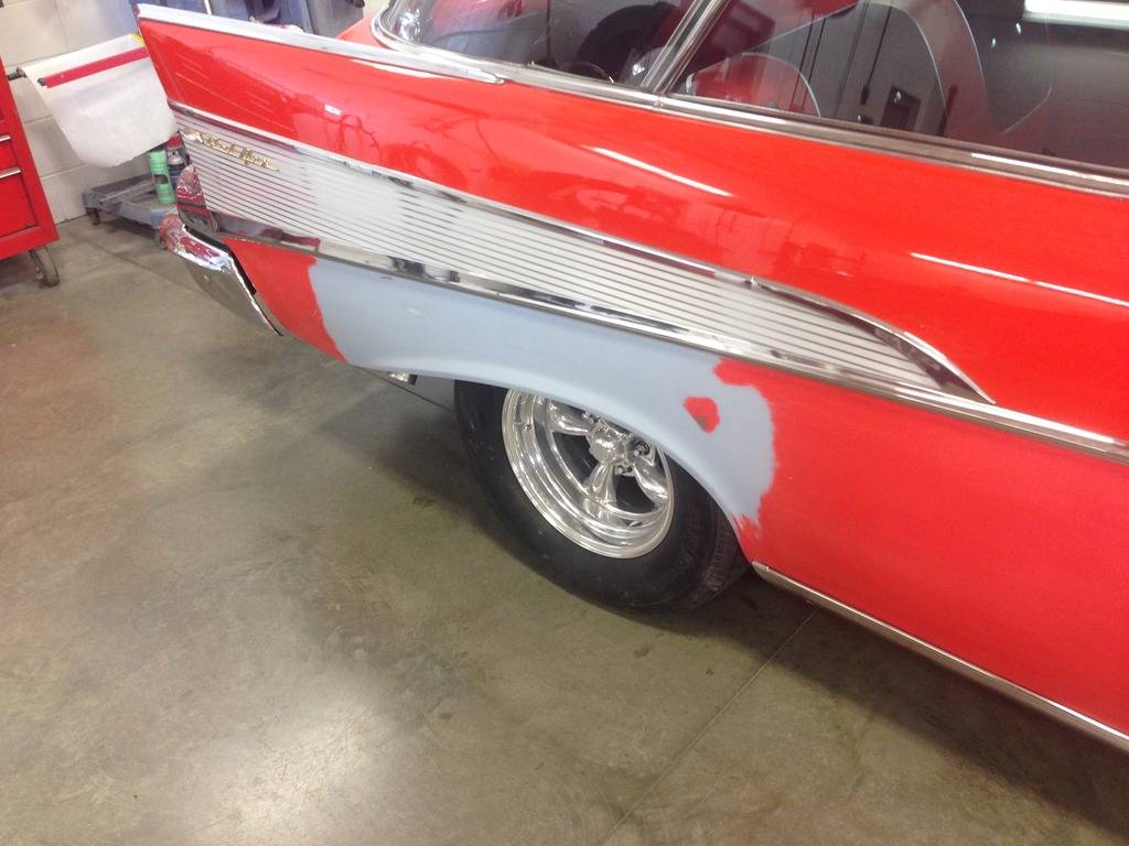

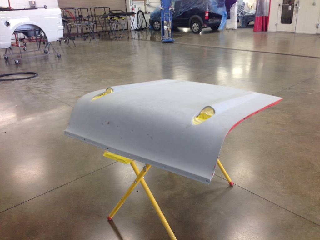

      The Hood had a bunch of stone chips on it from a couple years of Power Tours.....And ....everyone knows how that works out.......Now that the big stuff is finished and every time I looked at the car, all I saw was the stone chips.......So.......the car is at Pulera's getting the hood repainted, other little chips touched up.......then a good buffing......Then it's time to put some miles under it's belt......
    3. #83
      Sep 2013
      289

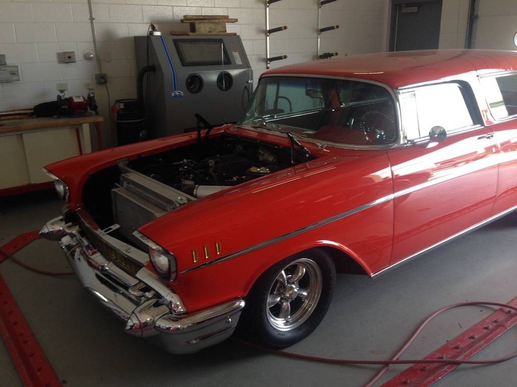

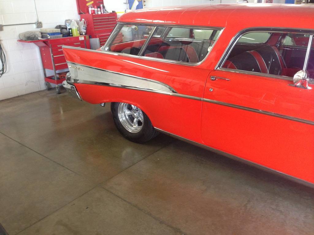

      It's been a while , update........Pulera's got the paint mixed and matched.......as long as they got it that close I decided to have them fix the passenger side wheel well area.......there was a spot (very small) where there was a paint adhesion problem (small bubble)......not a rust issue at all....But......Like everything at Pulera's......they don't do anything unless they do it correctly.....so....Before and after pic's............Should get it back next week so I can get some miles on it.......
      After

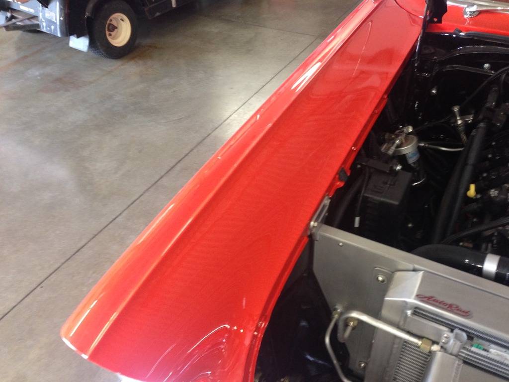

      They also repainted the top of the fenders that had a bunch of paint chips that I put in while installing the core support
      Almost there..........

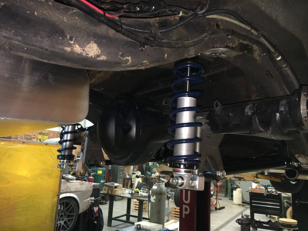

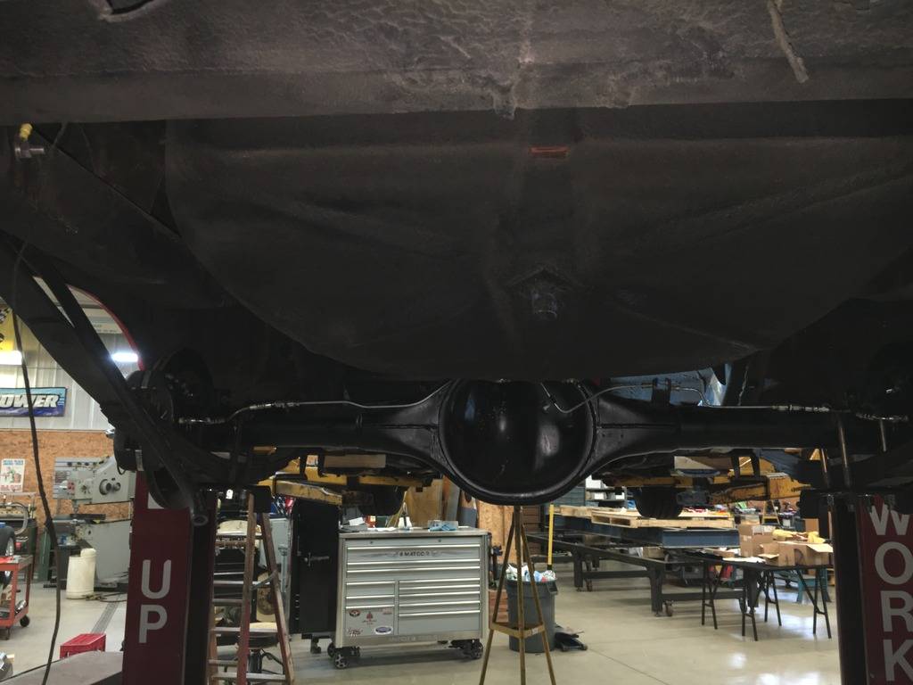

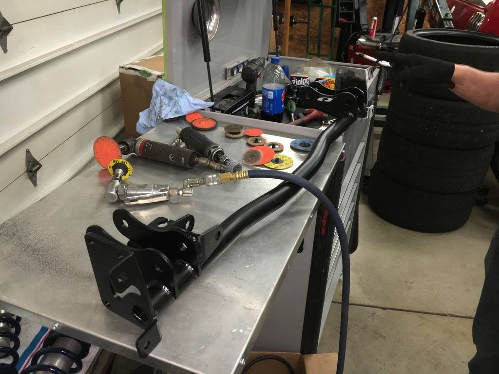

      The Car is at Frame-Up Wheelworks getting the triangulated 4 Bar set-up installed....along with the new tank and spare Tire storage well mod's.........Here are some pic's of the start of the process....

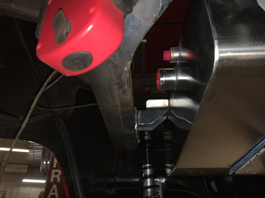

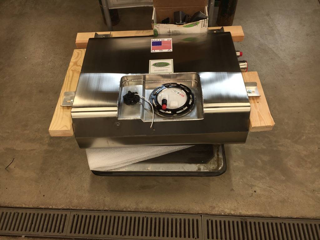

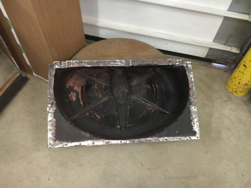

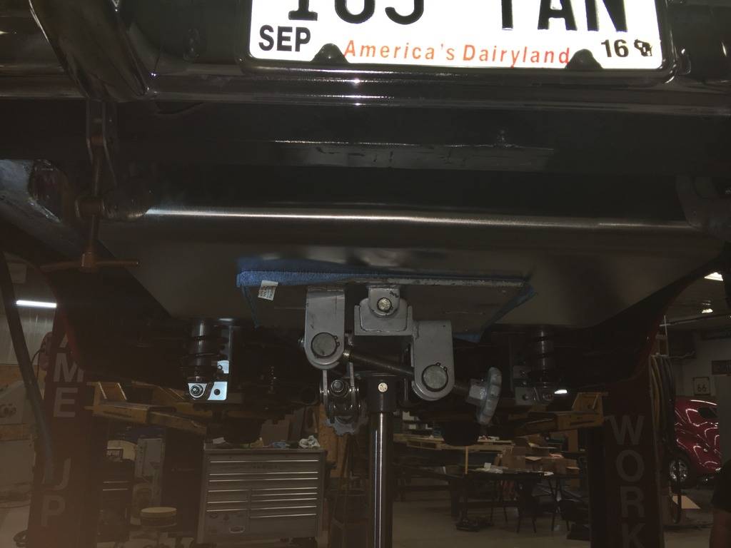

    19. #99
      Sep 2013
      289
      Moving along.........
      Spare tire well out.................
      New Ricks Tank going in............
