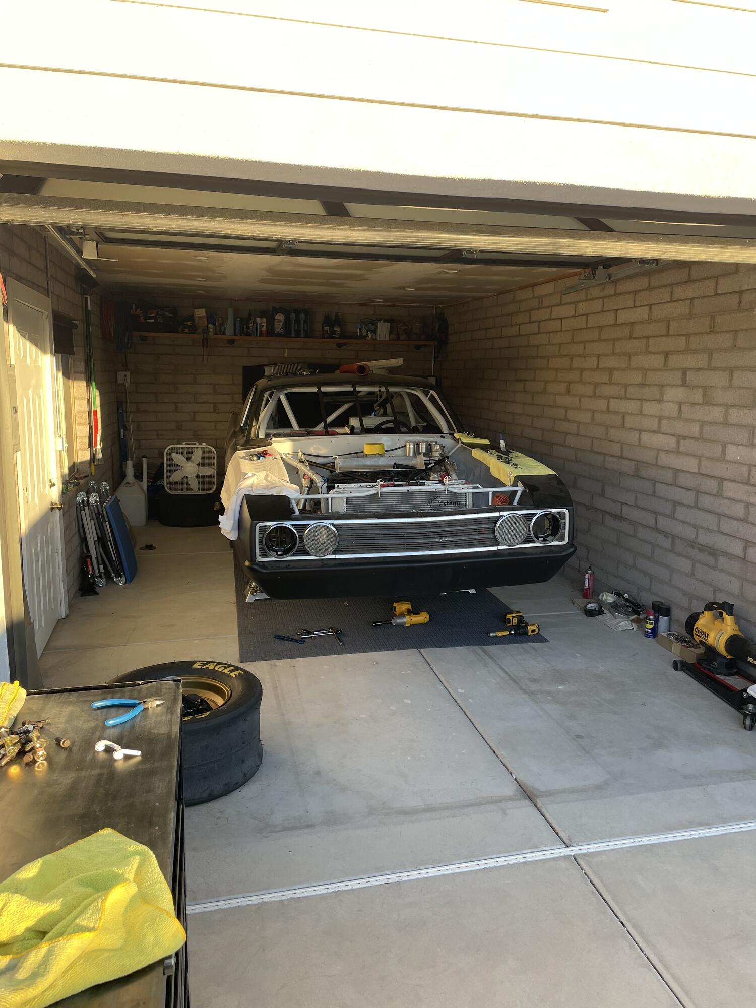

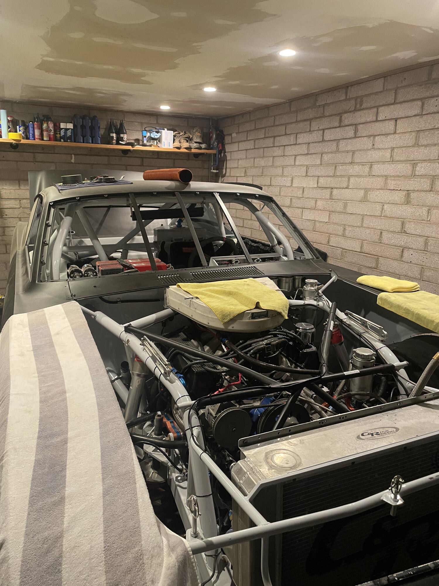

      I don't know where to start, I feel bad for not updating this thread but life happens and I now understand how some people end up with old cars sitting around that they're "going to finish" at some point. Since the last post it has been nearly 2 years, most of which the car has sat untouched. The good news is that in the past few months I've tackled a lot of small items on the car, and even cranked the engine over the other day. Here are two pictures of the car in its new home in AZ. I am picking up the last 3x braided lines this week, and the car will be ready to fire for the first time very soon. I think some friends are going to come over for the inaugural start.
      Anyway, more to come soon if any of you are still following!
