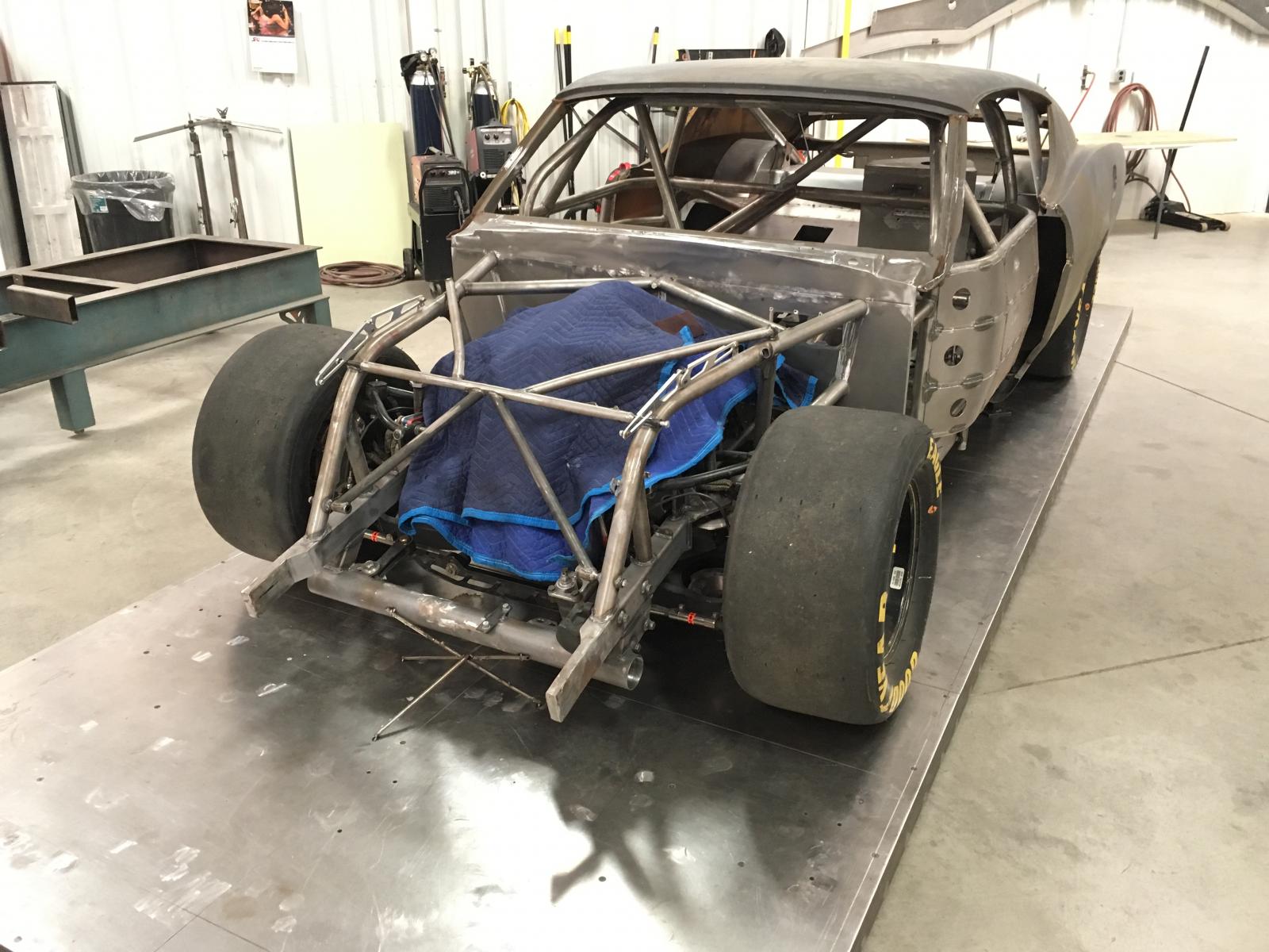

    17. #77
      Nov 2014
      Scottsdale, AZ
      61
      More pictures
      Car is back on the surface plate. Got the windshield supports done, then laid out the exhaust exit. Fitted the lexan, now time to pull it all apart for paint.
