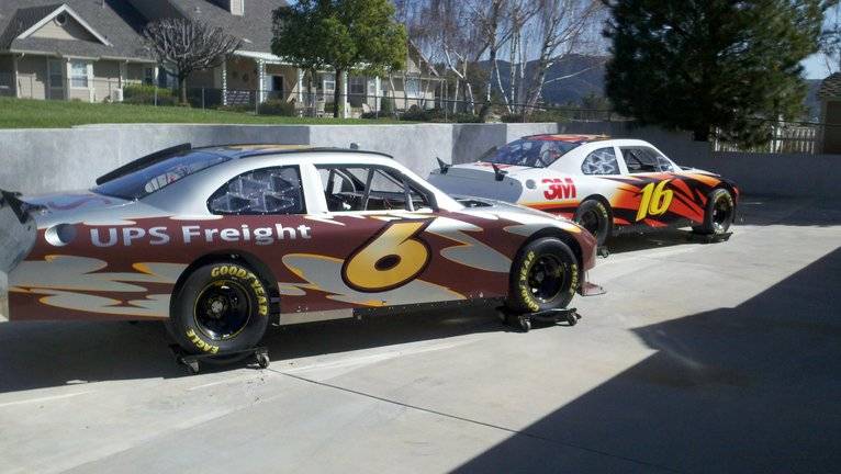

      My friend picked up two zero lap cars, left over from Sonoma, and pieced them together from used parts from the different NASCAR teams -- Got the brakes from the Wood Brothers Daytona winning car for one of them -- -- then he went and put Chevy engines in them from Van Gordon -- go figure LOL
