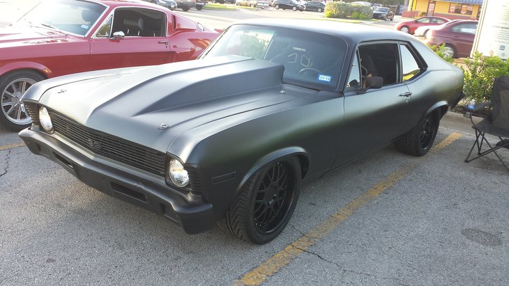

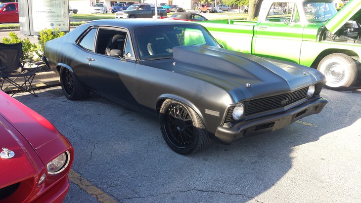

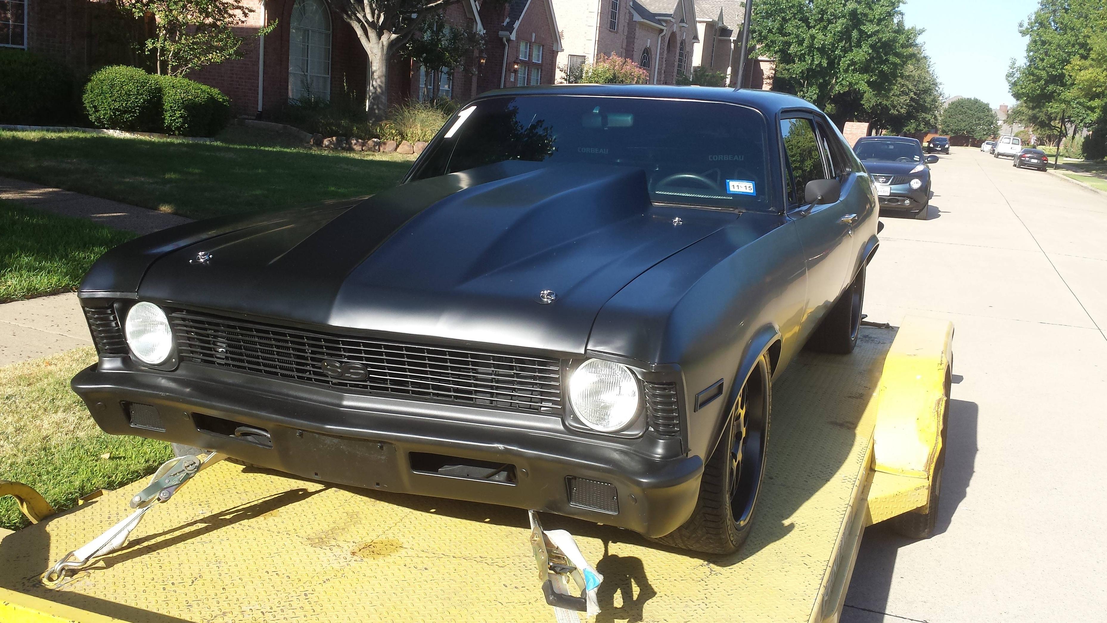

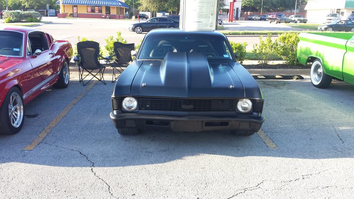

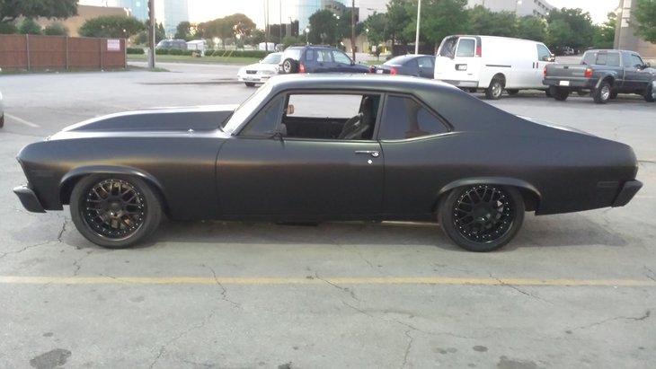

      Hear are a few pictures of the new stance from the car show this weekend.

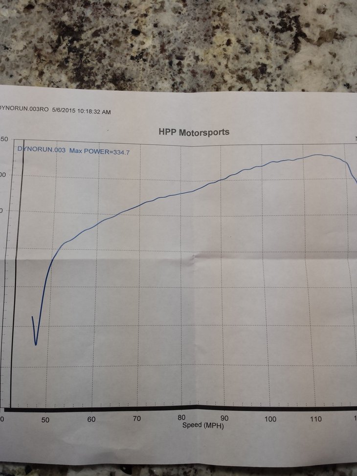

      Just got back from the dyno. My little 355 put down 334 to the wheels!

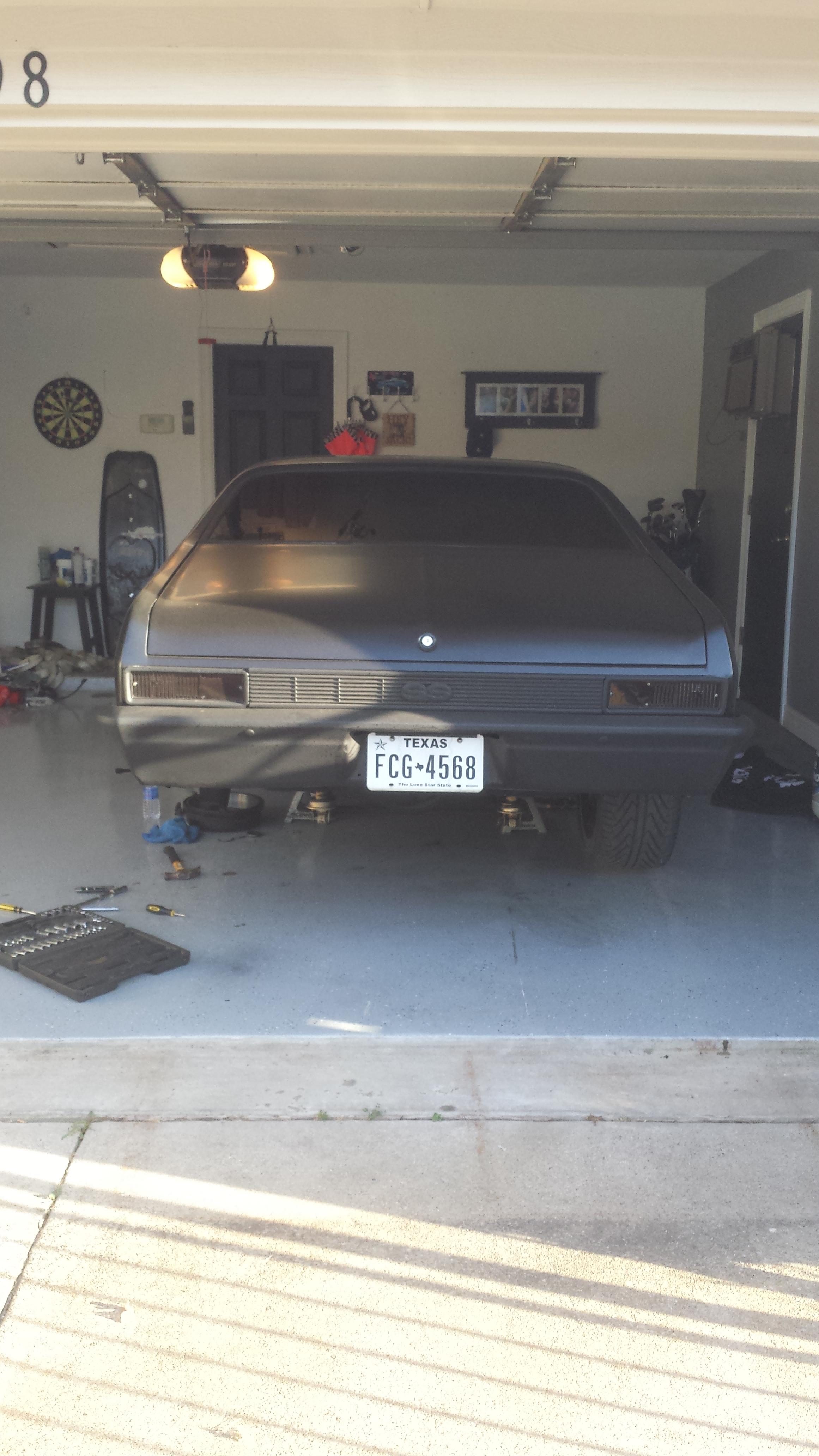

      Finally got the rear lowered back down. Had to fab up new mounts.

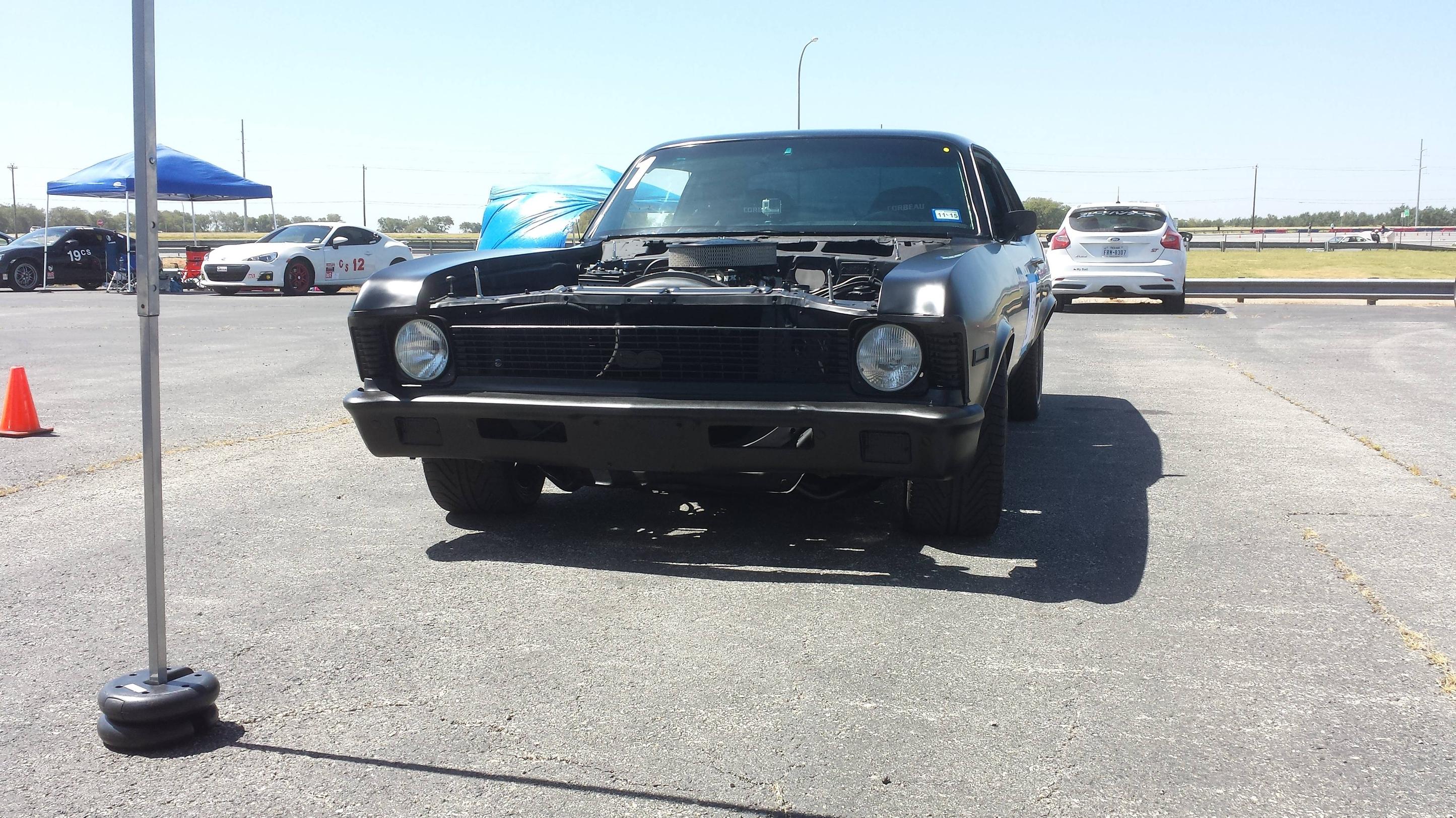

      So I entered my first autocross race on Sunday and tho it was a lot if fun I ran into a few problems. First problem. After helping set up and work the first heat I get the nova all ready and prepare for my heat. Pull up flagger says go I dump the peddle get around the first turn only to be red flagged. So I pull off the course and they tell my im pouring out gas from the tank. So after letting out a couple gallons I head back to race. Only to have the same thing happen. So I go down the street to autozone and pick up a new gas cap. Finally I get to complete one lap only to be told I did not finish... and I didn't go around a certain cone.
      So I attempt a second lap only to be told again I DNF and now my axle is leaking diff fluid lol. SO I call it a day and load her back up. Even tho all that I still had fun sliding the old girl around the corners and getting her loose. Luckily the rear diff problem was the seal and was only a $40.00 fix.
      They are having another event in two weeks and I hope I can have tho old girl ready by then. I just ordered Hotchkis front adjustable shocks and sway bar so I am hoping I will have a week to test and work the kinks out!

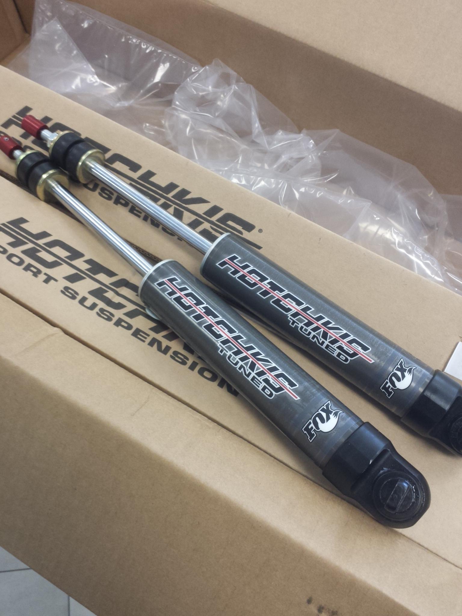

      Got some new shocks today! Hotchkis performance adjustables!

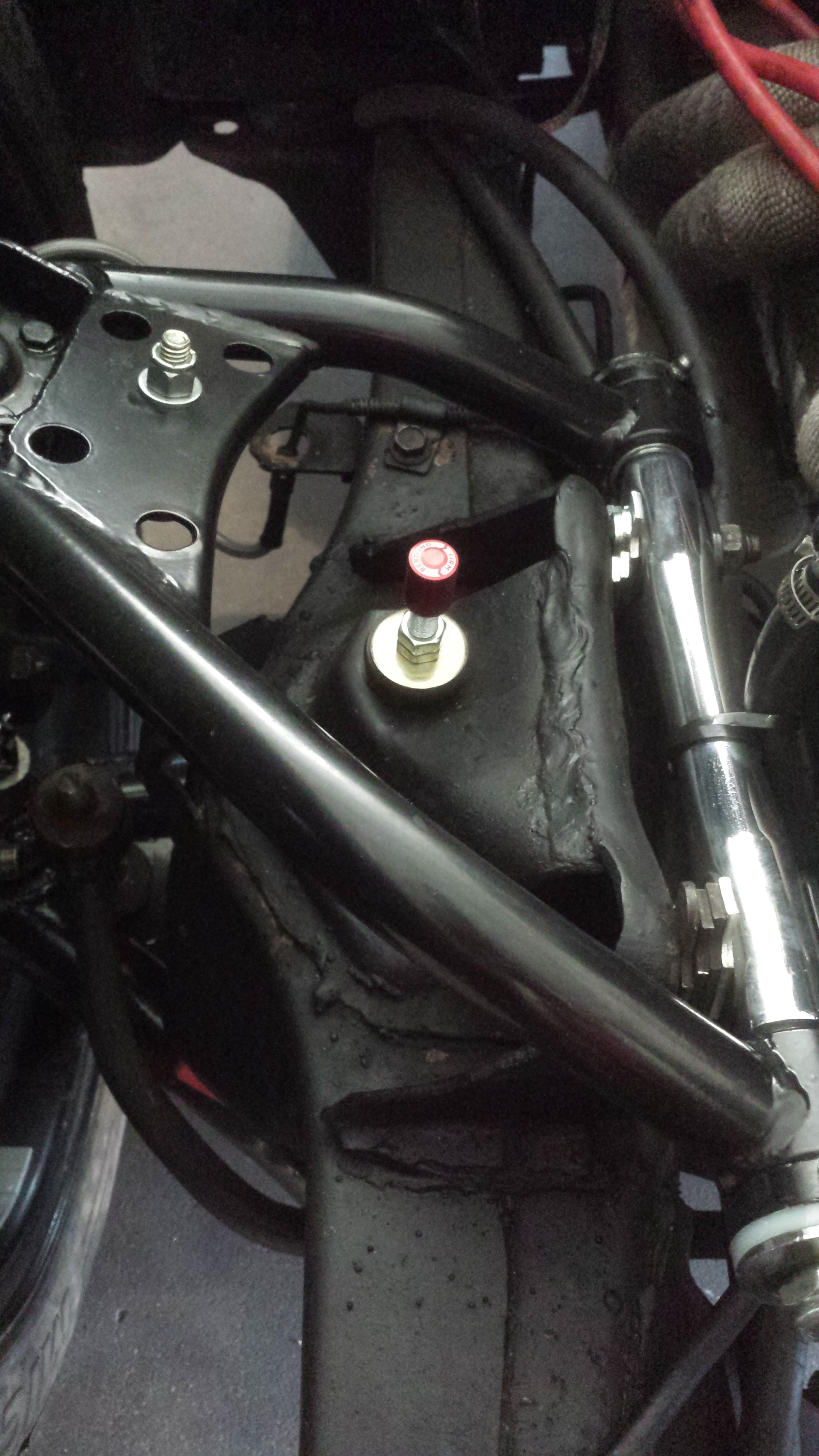

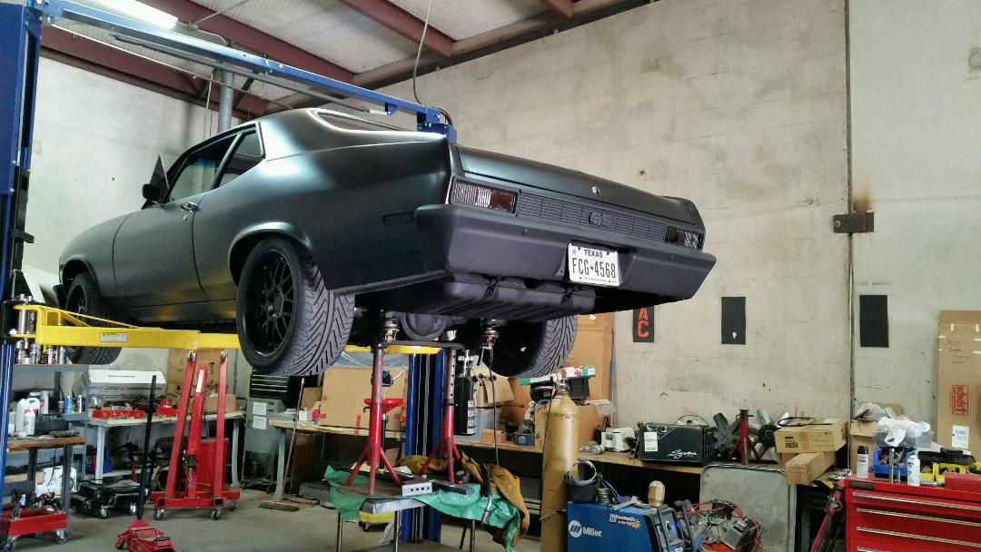

      Guess who installed ride tech 4 link yesterday... Car handles 100000 times better than the old ladder bars. Now I just need a rear sway bar. Any suggestions? Mine might have to be custom...
    15. #35
      Jan 2014
      119
      Quote Originally Posted by 72_Nova View Post
      I would see what ridetech recommends for a rear sway bar. They seem to have this game figured out quite well. Especially using their parts.

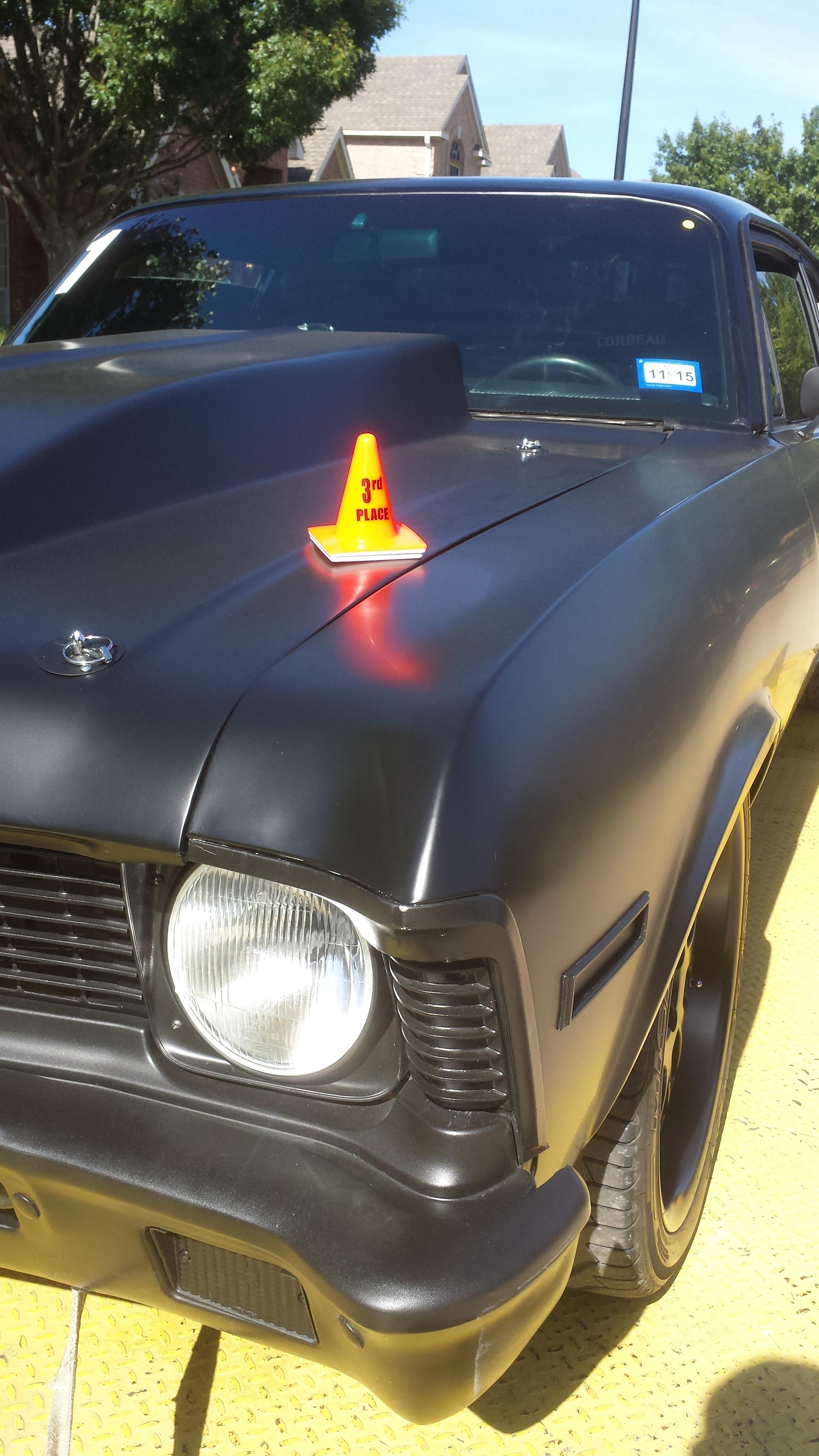

      So yesterday I got first place in CAM-T with a 3 second lead over 2nd and a 6 second lead over 3rd. Guess the new 4 link did the trick! The first video was the winning lap and the second video would have been the fastest lap but I ended up taking a cone out.

      First off thanks the wrap was super hard and it looks killer! Yes no inner fenders. Idk if that makes a difference with rubbing much but at full lock the tire rubs. The wheels I have are 18x9.5 with a 20mm offset which would put you in the 6 to 5.75 offset range. Im running 275 up front and 295 out back. Just got new Falken 165k's for this race and they made a huge difference.
      I did not upgrade anything on the arms. The uppers went on just fine it was the lowers that were a bitch. But nothing a BFH couldn't fix. Be prepaired to hammer away! Alignment was no issue but the one down side is since the car is so Low I only have a half inch of upwards travel. Car is lowered 5 inches up front. Im thinking about removing the bumps. Are you in Texas?
