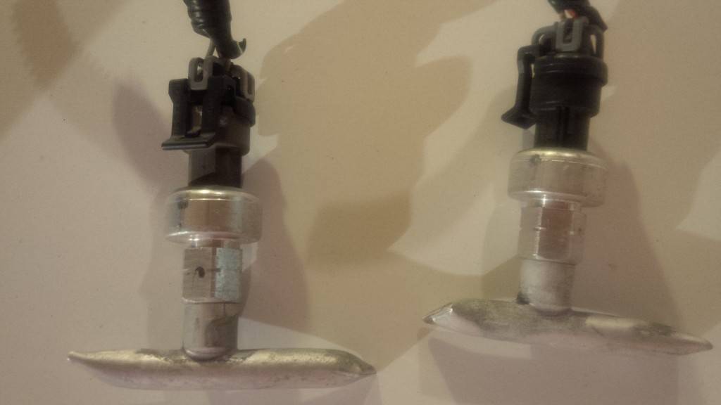

      I do have the E38 ECM and it is pwm capable I have the 2011 Corvette program already loaded into it. I will look hard at the C6 PWM setup. I have HP tuners so the tuning aspect is not a problem. I was already thinking of a 70 amp relay if I went with the Derale setup. You just confirmed that would work. So let me look into what parts I will need for the C6 route. The only tricky part would be the "trinary" switch. I have an "Old Air" setup on the car now so I would have to come up with a solution to that little problem.

      I went to the junk yard & found a couple switches, I cut the hard line a few inches on either side to have installed in my system. AC guy near me can take the screw in base & solder them onto an elbow.
      I had previously purchased the connector & pigtail from EFI Connection & it plugs into this switch.

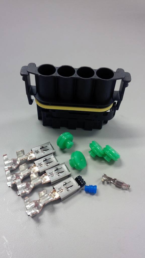

      Does anyone have 2 spare 478-23124472620060 "large terminals" for the connector? My brother is installing the corvette fan module and this conn. is on backorder from mouser (18 weeks). I have 2 extras from my build.
      Thanks, Steve

      Steve,
      Damn, I just sold a complete kit to someone that had a similar issue with the Mouser backorder. It would be nice to find another vendor for these parts...

      I have a few kits left that has the connector body, all terminals, & seals. I was selling them for $50 each before Mouser had them available. I had to get them from over seas, & had to buy a bunch to make shipping reasonable. Willing to lower price, but want to sell them as a kit, make me an offer.
      Scot

      If you don't have the terminals fuelie, I'll take a whole kit, samckitt. $35.00 + shipping?
      Steve

      I checked this morning, I have enough for 5 kits.
      Scot
