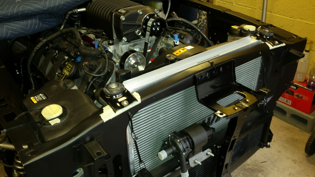

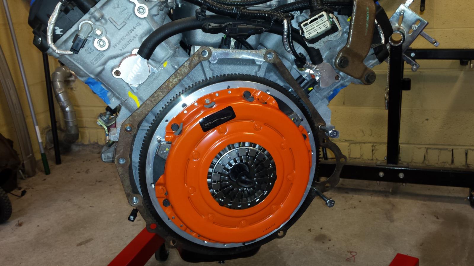

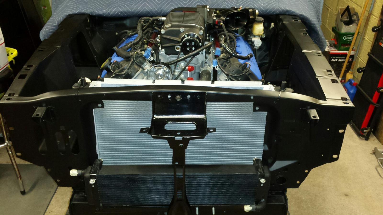

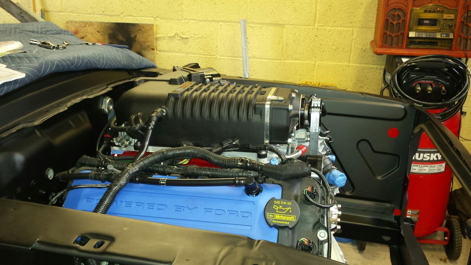

      I got the engine installed over the 4th of July weekend and mocked up the radiator and heat exchanger a few days ago.

      What kind of oil filter mount is that?

      Quote Originally Posted by 67greengt View Post
      Its the factory engine oil cooler (F150).

      640
      Is it a truck engine or mustang engine? Are you using that one for clearance issues? Different crossmember but mine did not have a fit issue with the stock oil filter location. Love your car! And I can safely say, that even when only stock and no super charger, it will fly!

      Andrewb70 - Thanks for the tips. I actually have the Aeromotive 340 Stealth Tank which I'm hoping will survive for a while but I will keep your recommendations in mind.
      Peter - It's a truck engine out of a 2012 F150. Not using it due to clearance issues. I know the truck that it came out of which only had just under 5k miles on it and I got it for a good deal plus the factory oil cooler. The compression is 10.5:1 vs 11:1 of the Mustang.

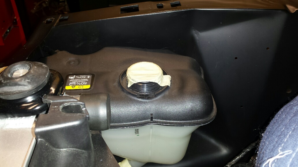

    8. #48
      Aug 2012
      Pennsylvania
      252

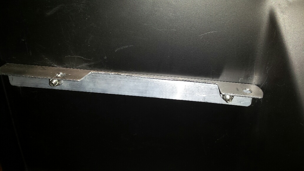

      Name:  Coolant Tanks.jpg
      Mocked up the Radiator and coolant tanks (which sit a tad bit too high) and I guess making the decision to relocate the battery to the trunk early on was a wise move.

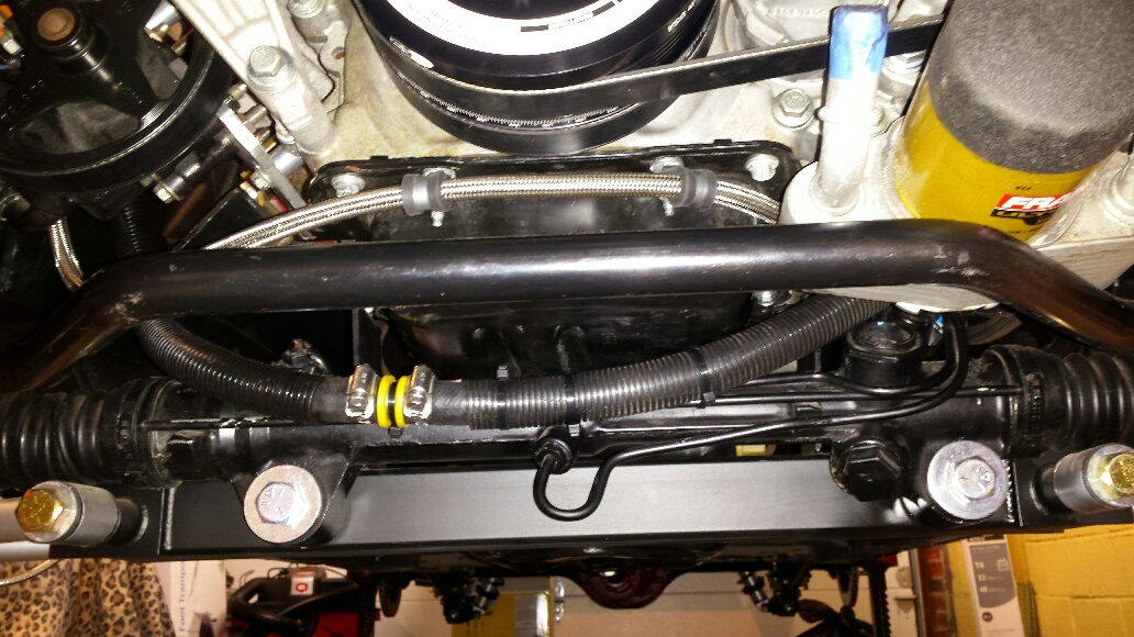

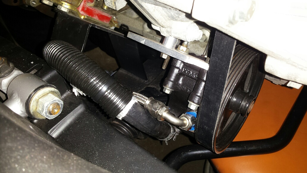

Size:  234.7 KBName:  20160101_172406_resized.jpg
Size:  250.3 KBName:  20151108_163700_resized.jpg
Size:  193.2 KBName:  20151121_190328_resized.jpg
Size:  257.7 KBName:  20160102_174045_resized.jpg
Size:  171.3 KBName:  20160102_182804_resized.jpg
Size:  176.5 KBName:  20151227_131852_resized.jpg
Size:  229.5 KBI haven't posted any updates in a while, but things are still moving along (slowly!). I have the PS pump permanently mounted and all of the lines made and ran to the Hydroboost unit. The Radiator, and Heat exchanger are mocked up as well as all the coolant hose routing. Currently making the brackets for the coolant tanks and I need to make a few more brackets for the Heat exchanger. Hopefully I can get back to the few spots underneath that I need to weld up so that I can finish the coating and seam sealing.

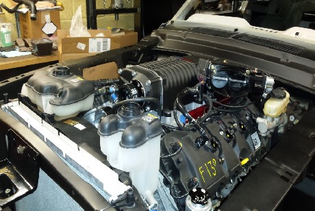

      So I threw the fenders and hood on for one last time before pulling it all apart for touch up and final assembly, and for some strange reason I had the crazy idea that the hood would clear the blower??
      Well, I guess its time to shop for a raised hood??

      Nice build! I wonder if the center section of a newer gt500 would give you enough clearance?
