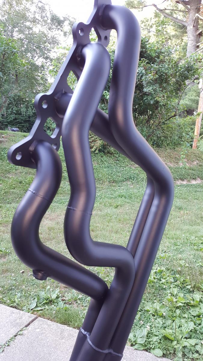

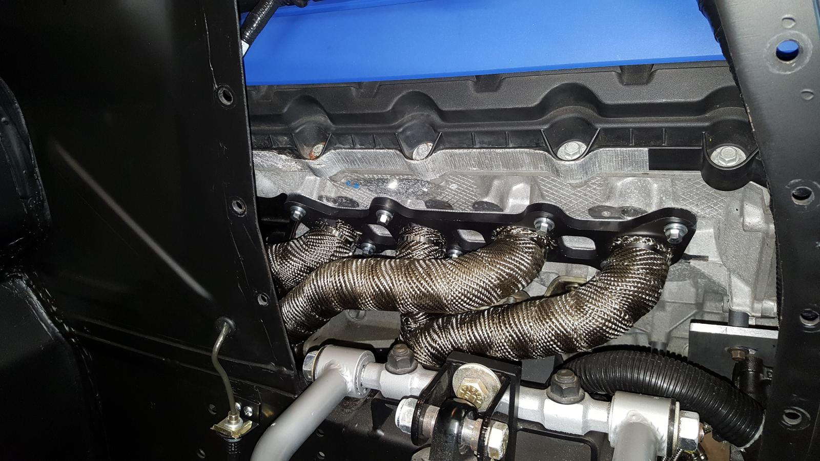

      Quote Originally Posted by Dalpilot View Post
      Who's headers are those?
      They are Doug's Coyote swap headers. They were designed based on the TCI front IFS. I have the Rod & Customs front IFS, and thesea were definitely a challenge to make the fitment perfect. I had to modify the driver side header and shave the clutch fork.
