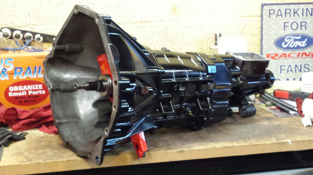

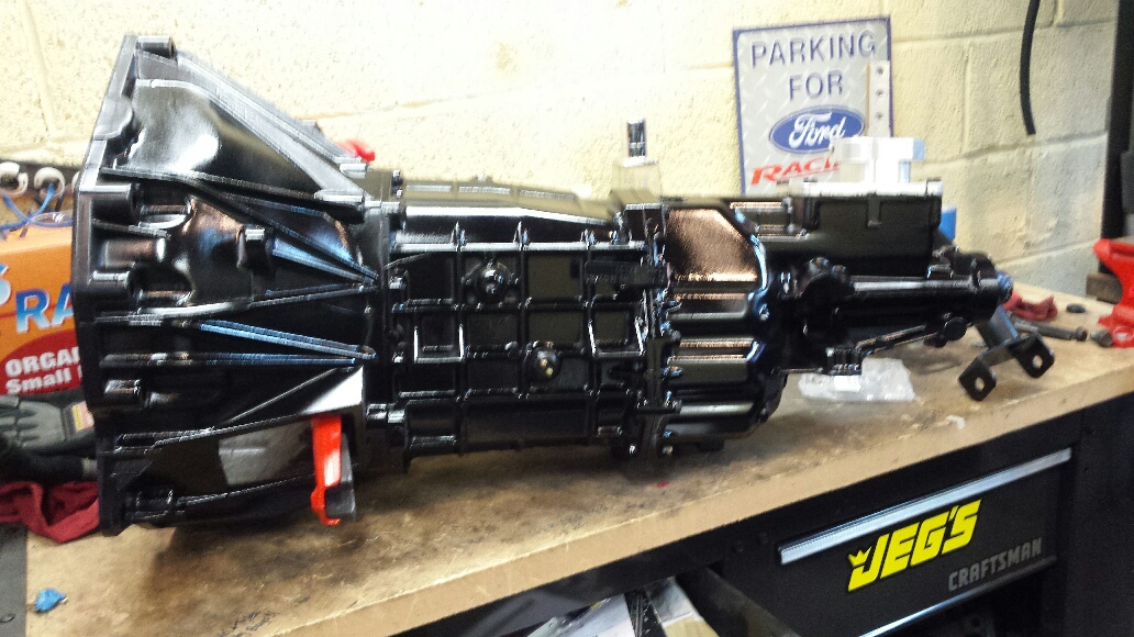

      Gnitro - The Coyote and the GT500 are different with respect to cubic inches and built on different platform. The Coyote is a 302cu 5.0l, and the GT500 engine is a 351 cu 5.8l. The trans that I'm running is a Tremec T45 built by Hanlon Performance. The TR3650's and T45's bolt directly to the coyote. Not sure if the T56 out of the 03/04 Cobra's directly bolt to the Coyote without an adapter plate or aftermarket bell housing.

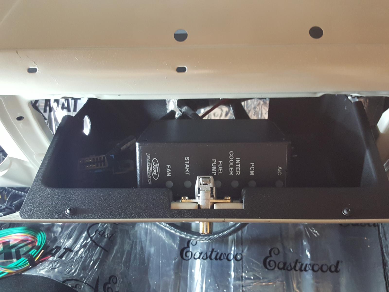

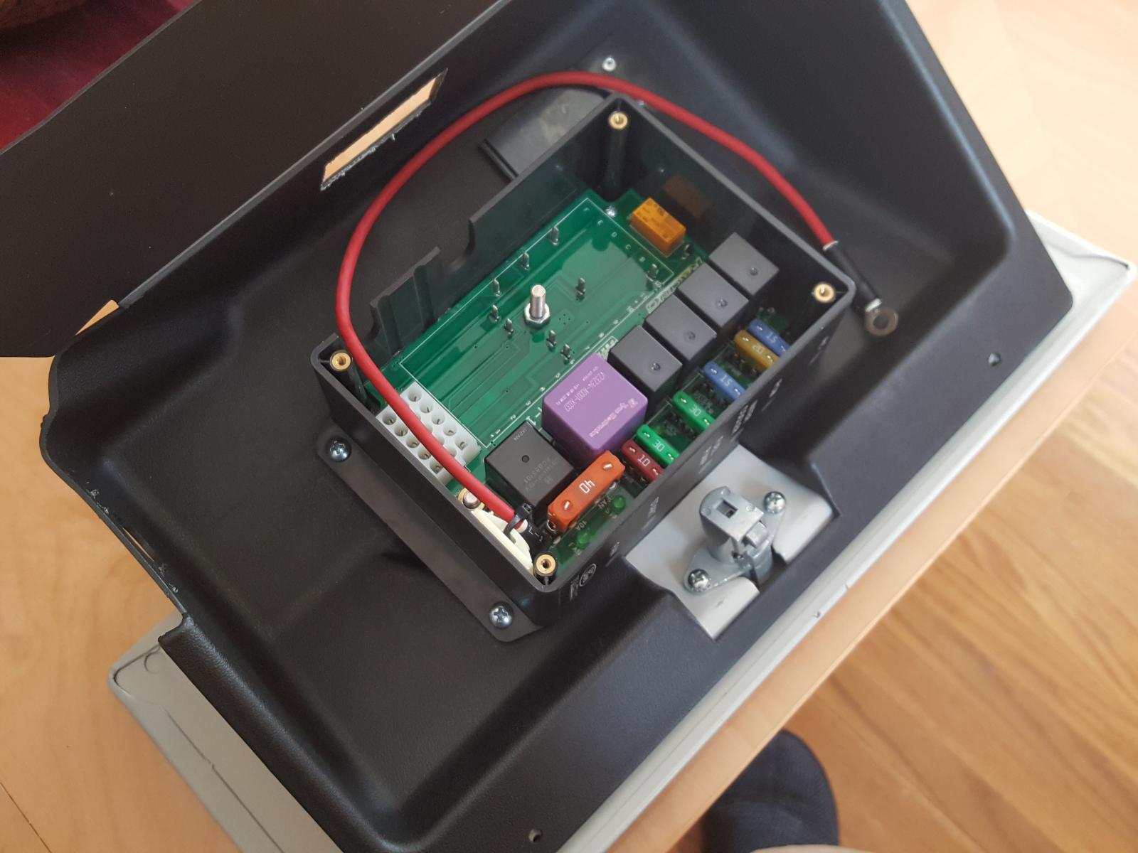

      That glove-box mounted panel is a trick little installation! Everything looks good so far!

      Centerforce - Thanks much appreciated.....
      And Yes, I am running a Dual Friction Centerforce Clutch!!!
