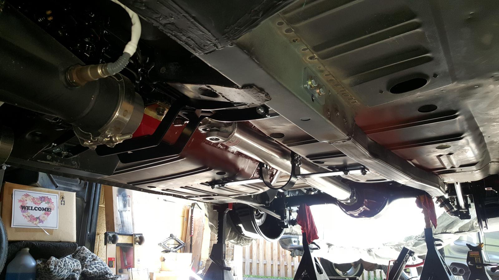

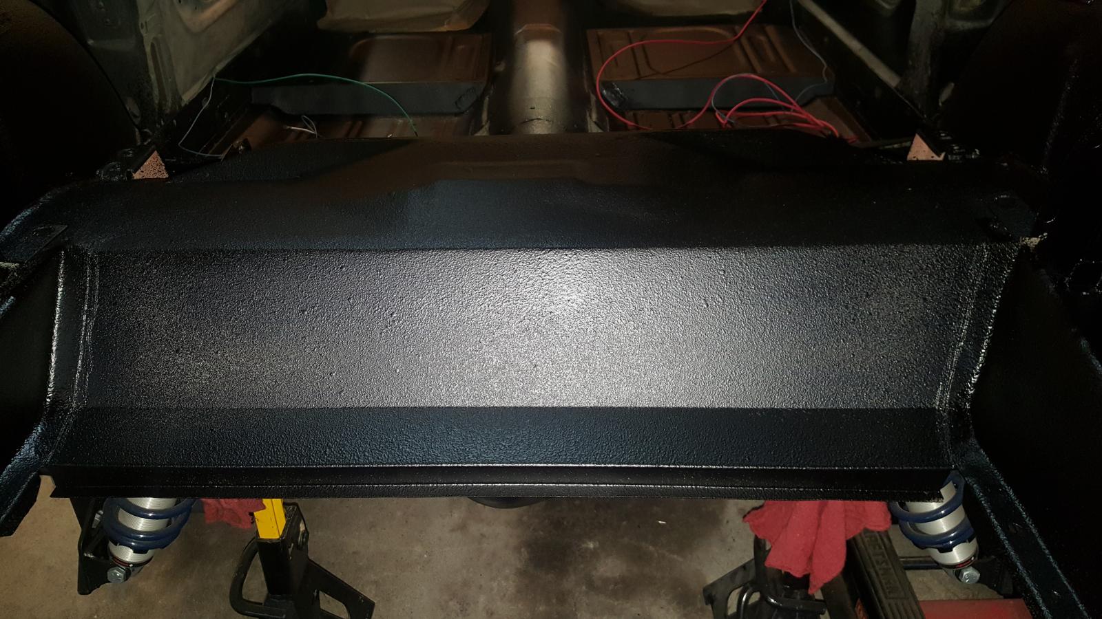

      I went with the "Weld-in" Tin Man Fabrication subframe connectors. Good design and well made.

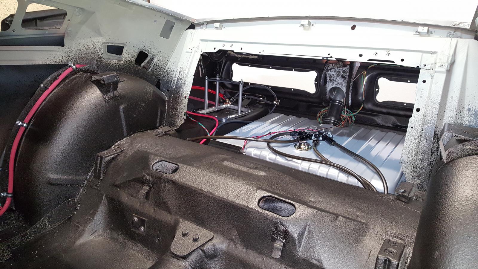

      Next is to coat the interior, trunk area, and undercarriage.

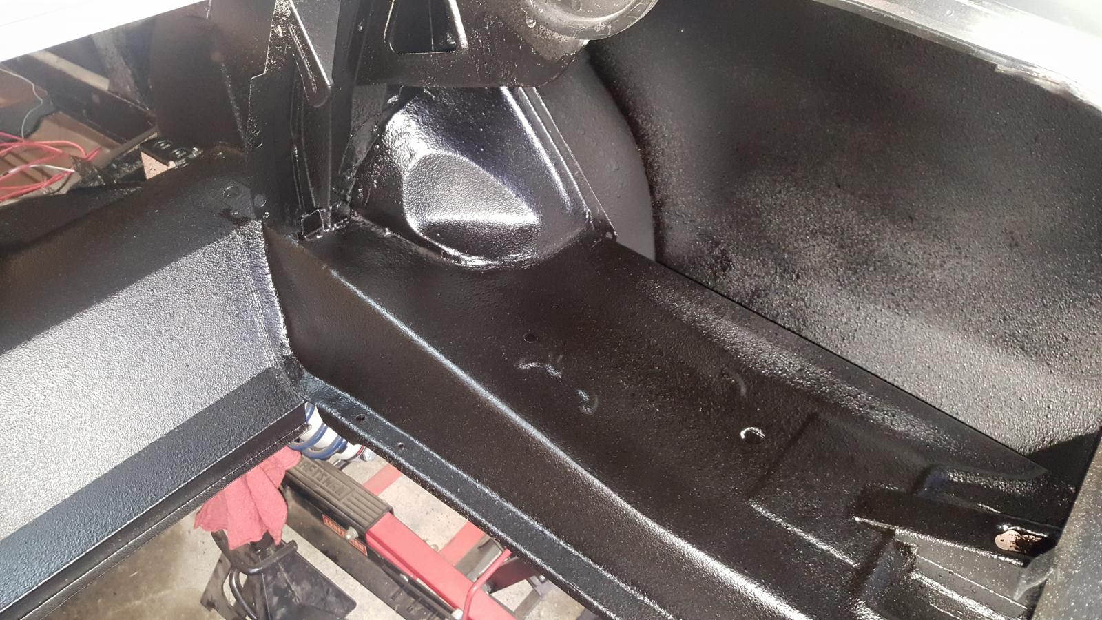

      Nov 2011
      163
      what coating did you use on the interior?

      Aug 2012
      Pennsylvania
      254
      Quote Originally Posted by justin51986 View Post
      I used Boom Mat by DEI

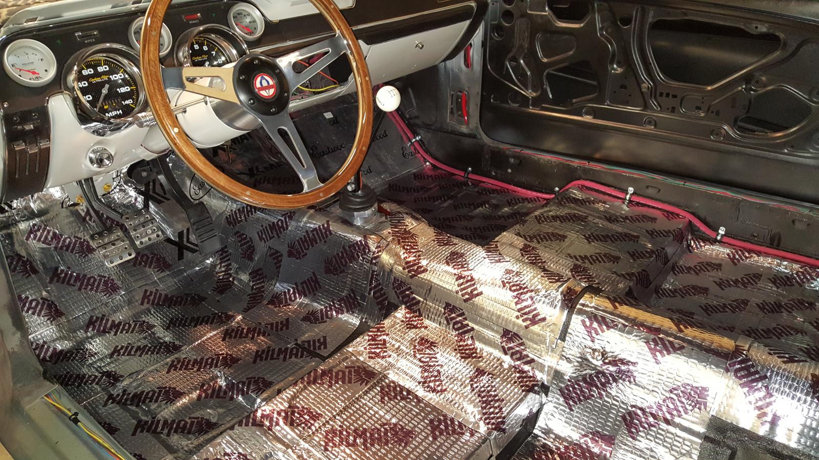

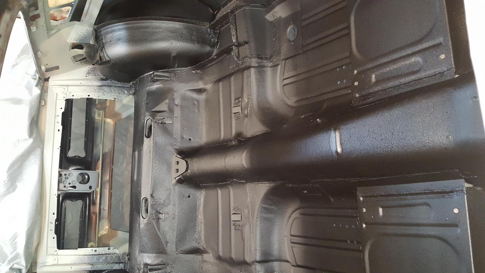

      I've been getting quite a few things done lately, and now she's finally running!! I finished the floor out with a product called KilMat (80mil thickness) which is much like Dynamat and Xmat.

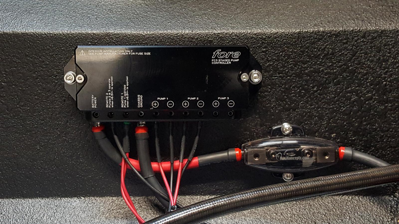

      I modified a 22 gal fuel tank with an Aeromotive Phantom setup with twin 340 pumps.

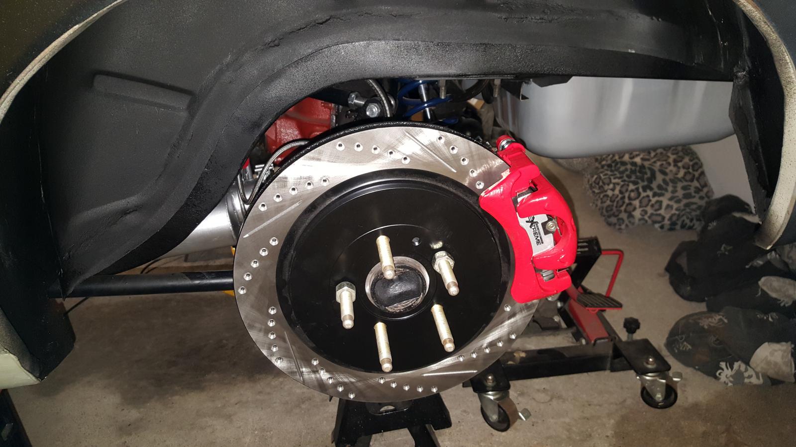

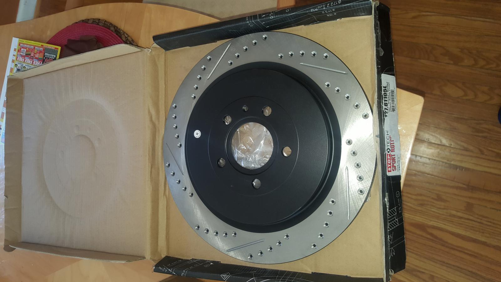

      Finished up the rear brakes with Two piston Brake Calipers, and Stop Tech 14" Brake Rotors

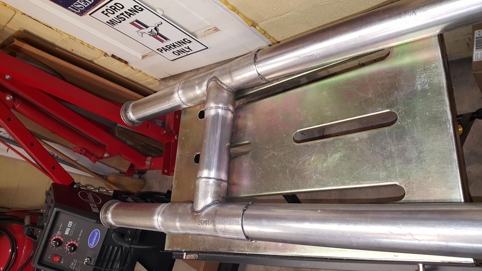

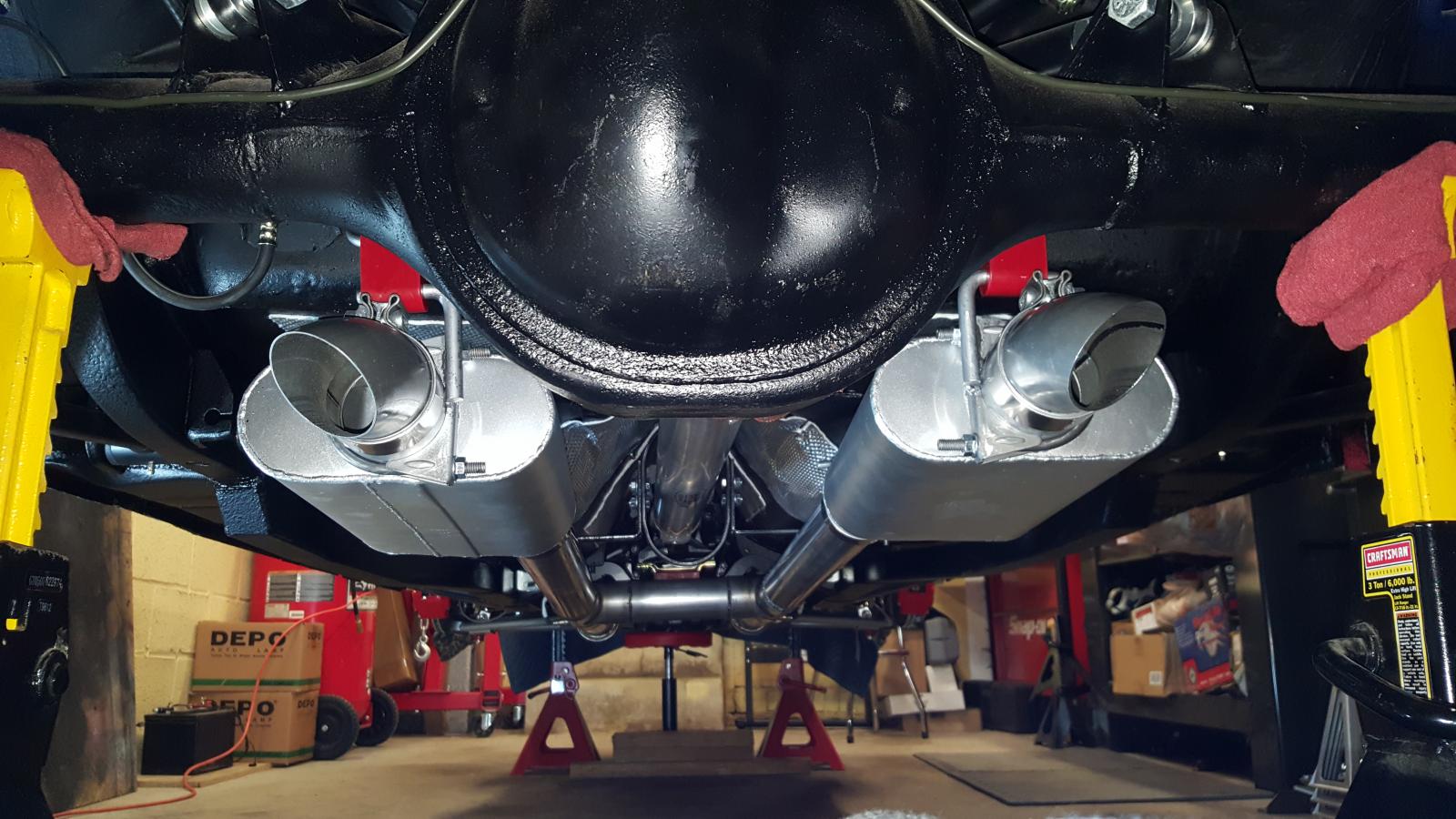

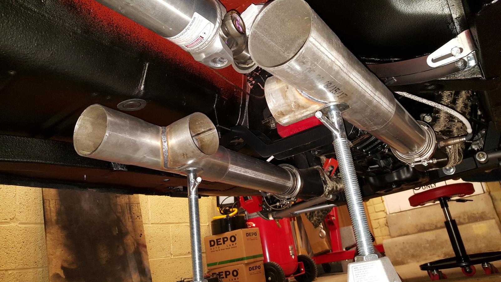

      I was able to fab up my own 3" exhaust with turndowns. I wanted an H-Pipe as I love the sound that they produce. I've always ran an H-pipe on my previous Mustangs and figured if it sounds good and performs good on a pushrod, then it's got to sound good on a Coyote!
      The Eastwood MIG135 is a handy machine!

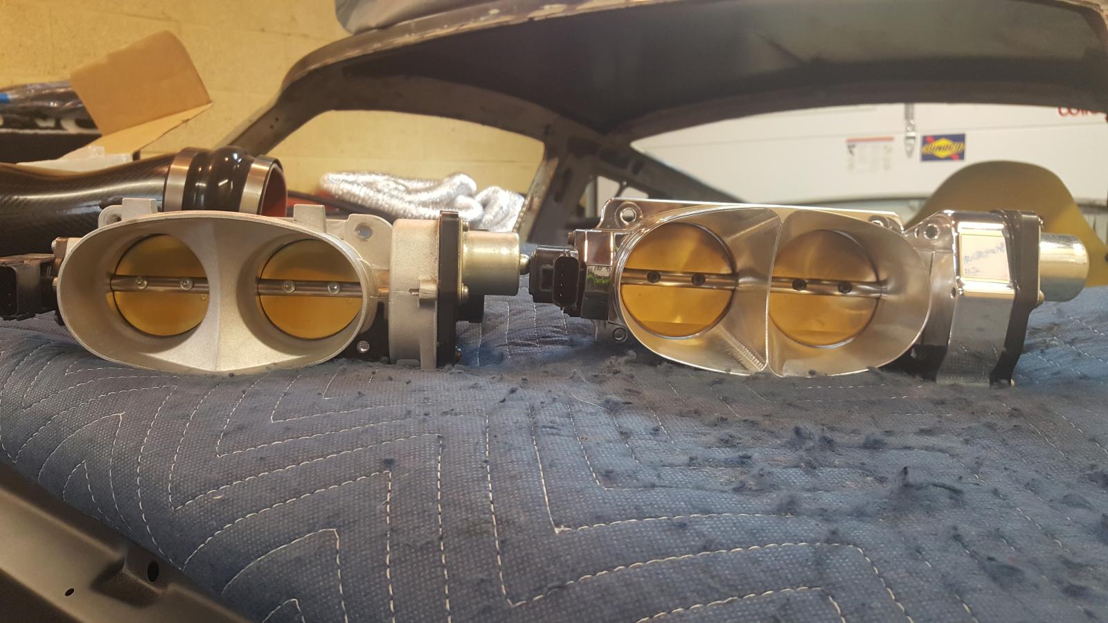

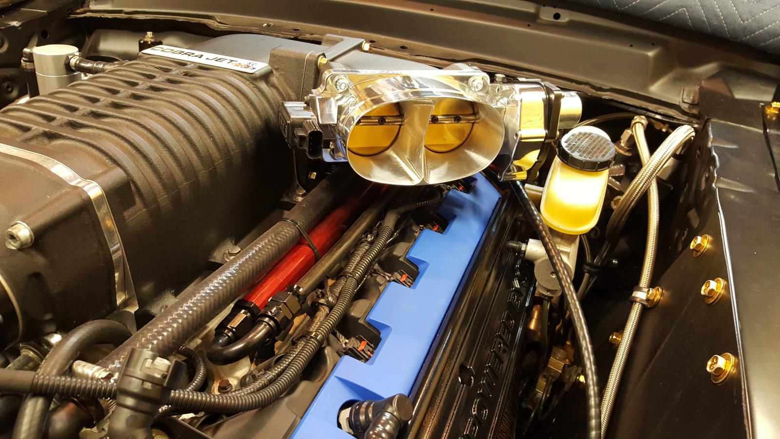

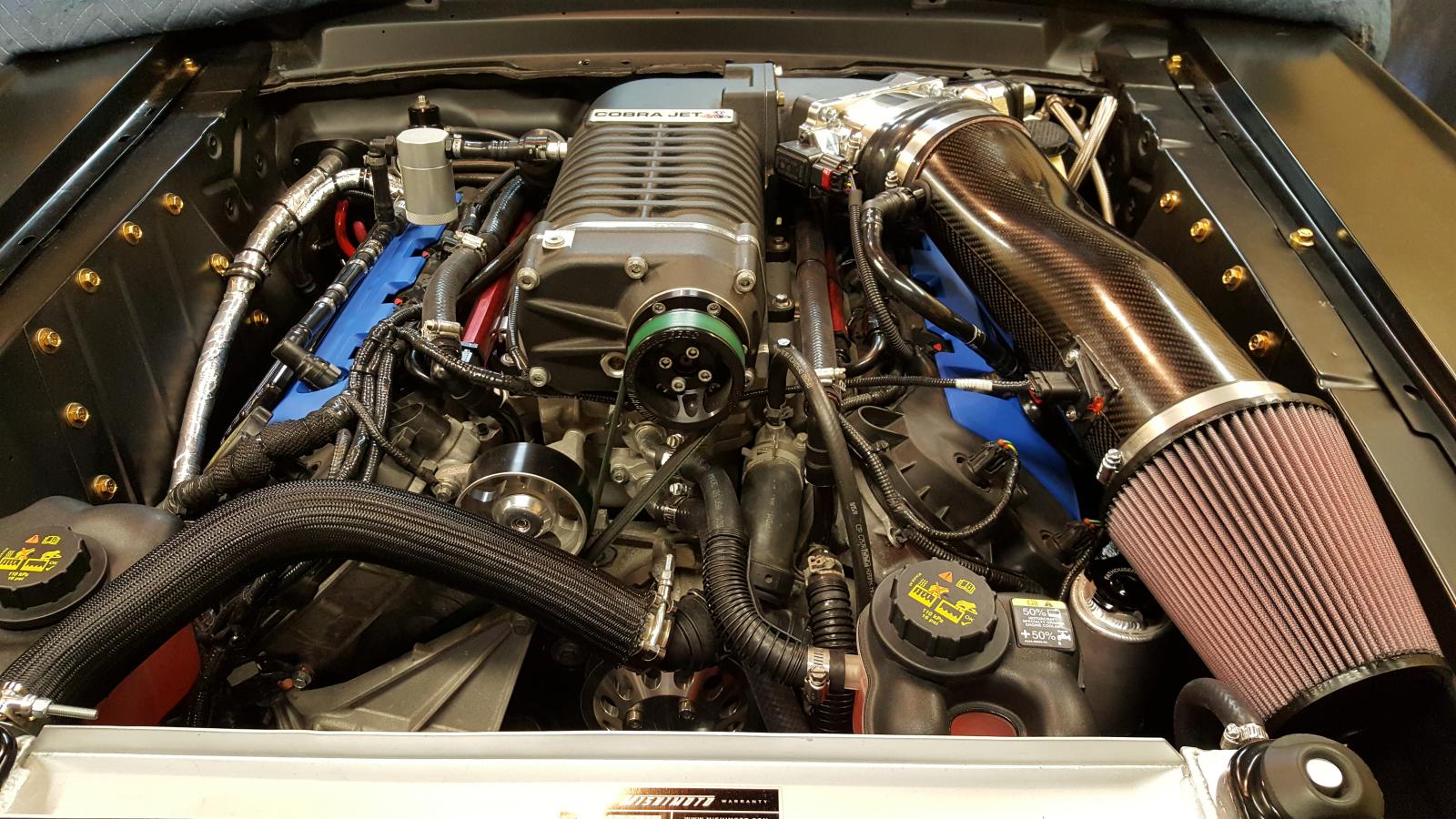

      Here is a pic of the engine bay. I upgraded the throttle body to a VMP twin 67MM.

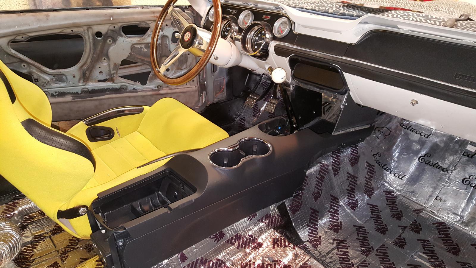

      Started working on my console a few weeks ago, and I think I made good progress? I started with a console out of a 2016 Mustang. Ended up cutting it down four inches from the bottom, then heating/shrinking it about another seven inches to get it to work for me. I also wanted to mimic the factory part of the dash to mate to the radio bezel to look somewhat appropriate.
