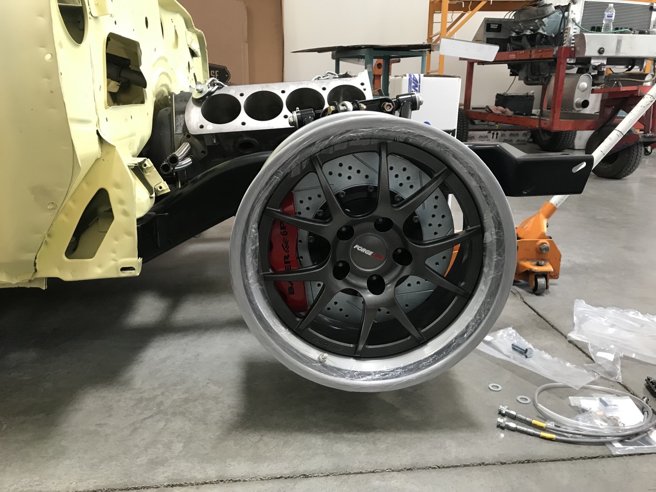

      It’s been raining here on and off so we haven’t made it to the chassis shop yet. Had lunch with my body and paint buddy. We mapped out a plan to move forward so he could be finished by the summer. I think the timeline is very ambitious. I’ll be ordering brakes tomorrow, 14” Baer 6p fronts, 13” SS4+ rears. This way I can install them along with the wheels and tires so that any issues can be taken care of before the car is in paint. It’s going to be an expensive 6 months.

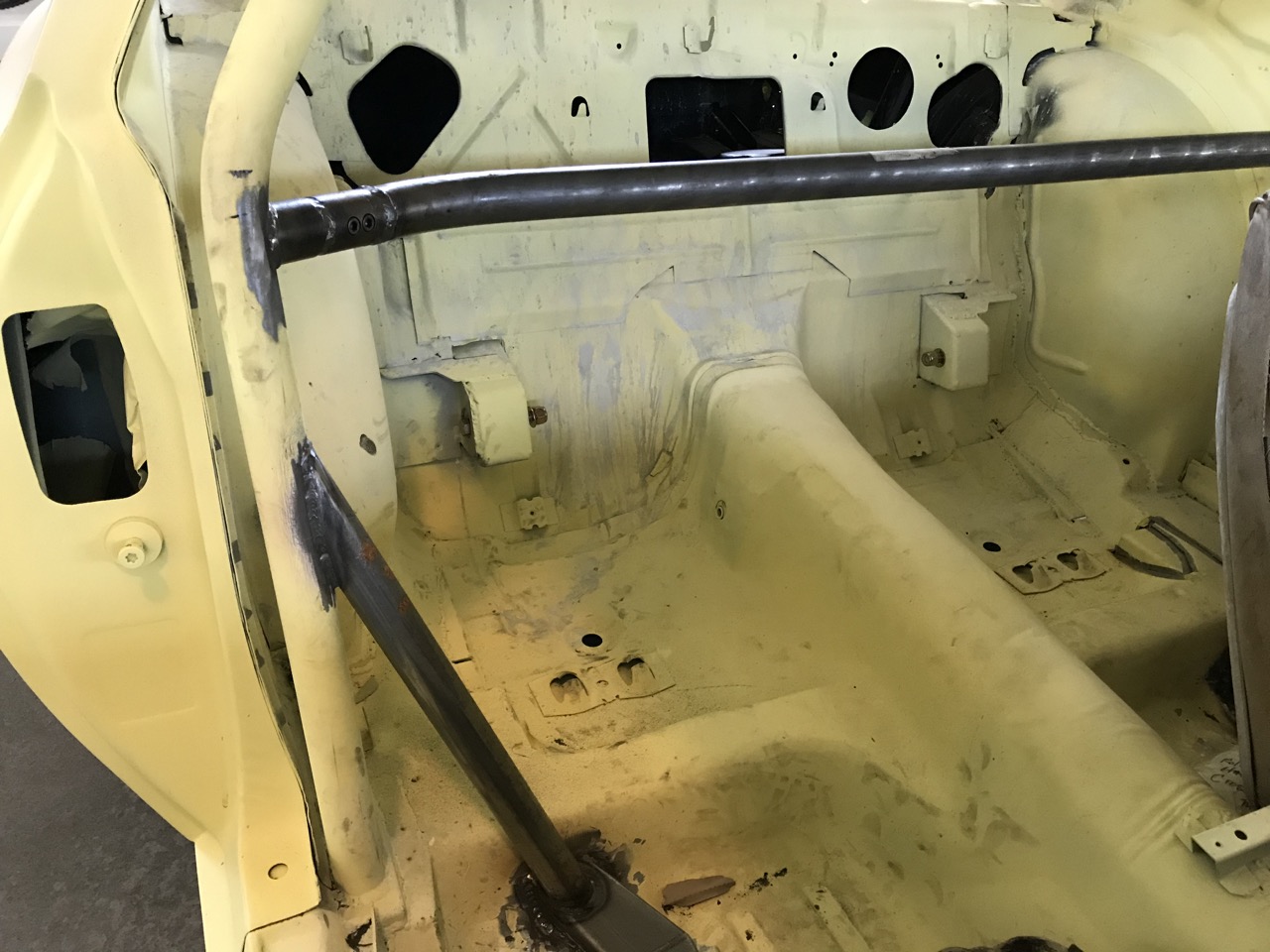

      Just got the car back from the chassis shop. We decided against the door bars I had in mind. The chassis guy felt that the benefit of the bars we designed (down from the main hoop then angled sharply low to the floor, below the entire seat bolster) wouldn't be worth it. He felt the triangulating pieces from the hoop to the subframe connectors behind the seats would add enough stiffness given how I plan to use the car. I'm kind of relieved...was worried about them being in the way and the interior will look a lot cleaner now. I kept the harness bar removable.

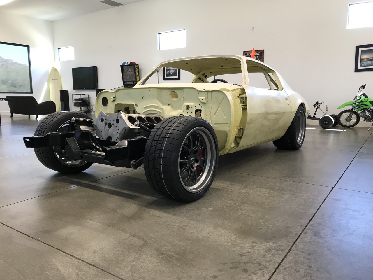

      I threw on the brakes quickly to check for clearance with the wheels. No issues. Next step is to mount tires on the wheels and install on the car. Body and paint guy said he'll be ready for her in May. At that point, we'll hang the front clip and deal with any tire clearance issues before she's painted.

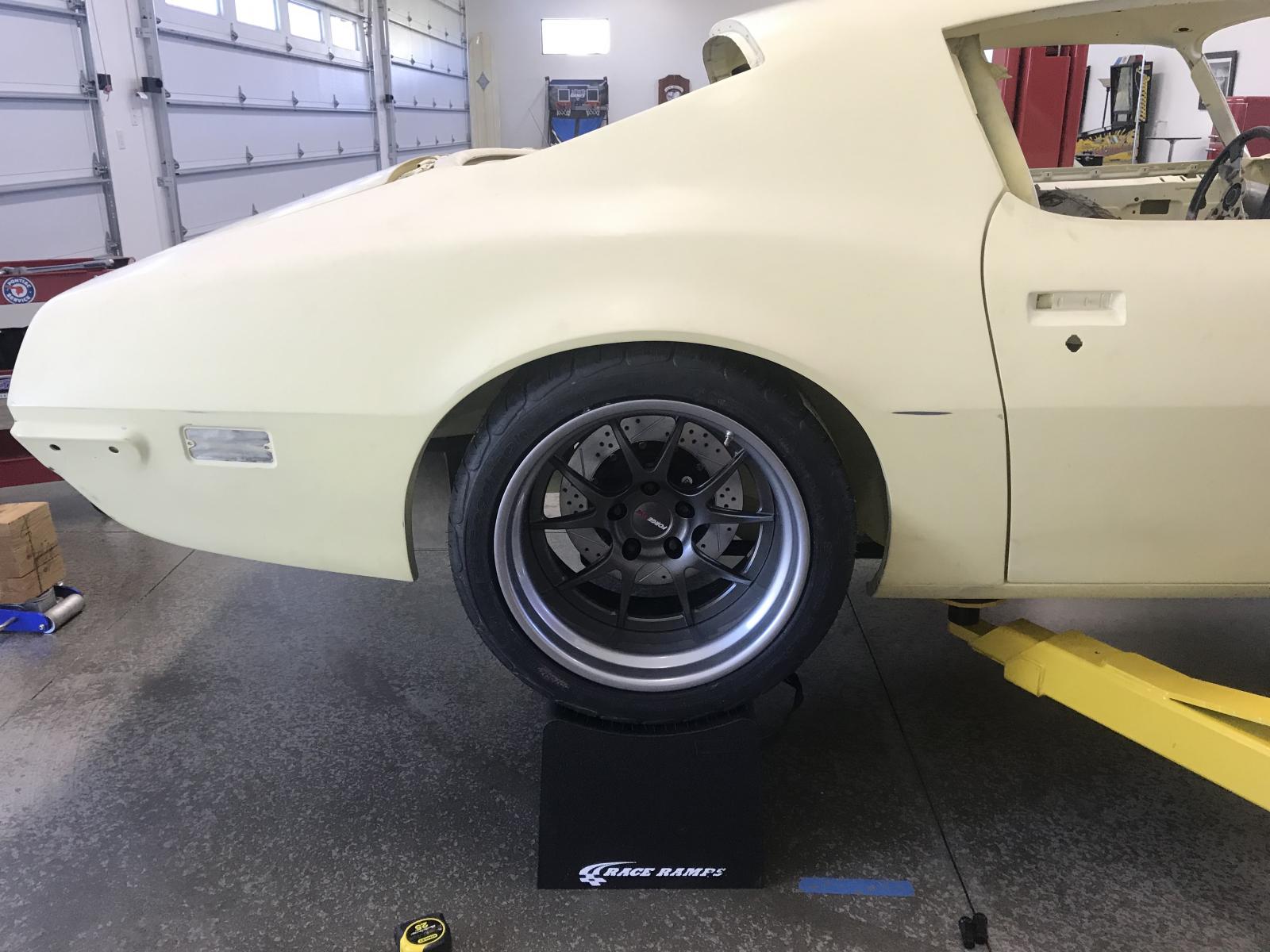

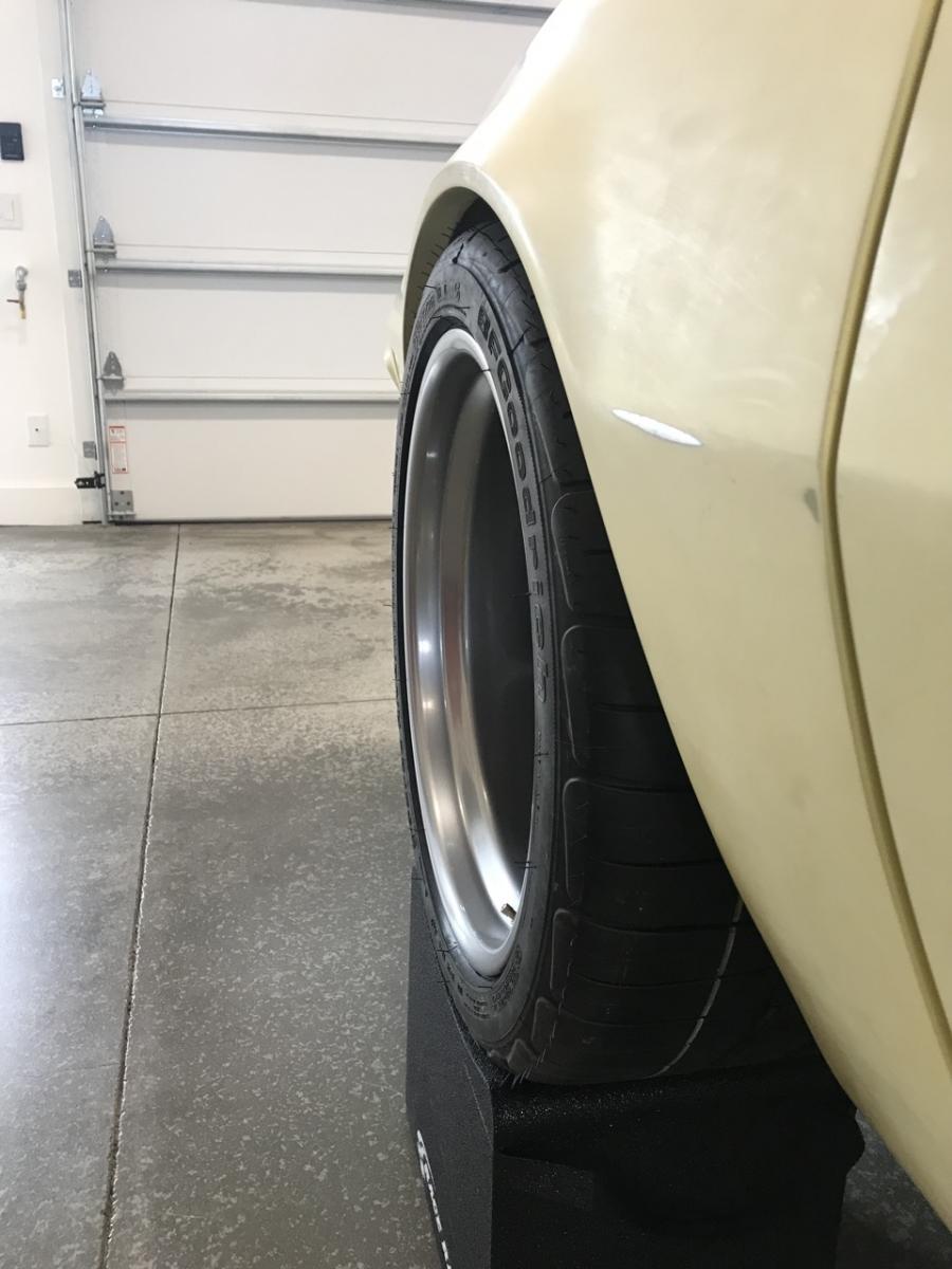

      Still waiting for a spot to open up in shop for paint. In the meantime I messed around with a few things.
      First, I removed the rear springs to see where the suspension would bottom out and found that I still have about .5" between the tire and lips. I think this should give me enough clearance even if I flatten the bump stop, so I should not have to trim or roll the lips any. Relative to a Camaro, the wheel opening is more rounded and so there's a bit more space available. I have plenty of clearance on the inside as well.

      I started thinking more about how much space there would need to be, given the current set-up, between the tires and lips at ride height to give me sufficient downward travel in the suspension. I would end up with slightly more of a gap at the tops of the wheel openings as compared to the sides. I played around a bit, and found that the car looks much better with less of a gap at the tops of the wheel openings as compared to the sides. So I ended up ordering the shorter shocks that now come with the Firebird specific Quadralink kit. I bought my kit from DSE years ago when there was just a generic 2nd gen kit developed with the Camaro in mind, so there was no accounting for the higher/rounded wheel opening of the Firebird. The shocks are pretty expensive and the lips will need work now, but a slightly lower ride height should look better.

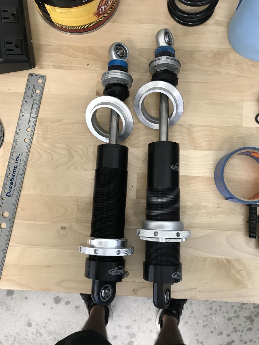

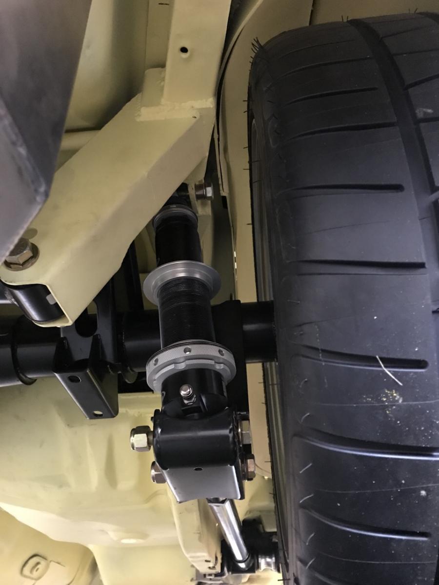

      Received the Firebird shocks. The body is .5" shorter than the Camaro ones. I installed them without the springs, and with the suspension fully bottomed out, I still have a sliver of space between the tires and lips. That was an expensive half-inch! If anyone needs coilovers for a Camaro, I know where you can get a good deal

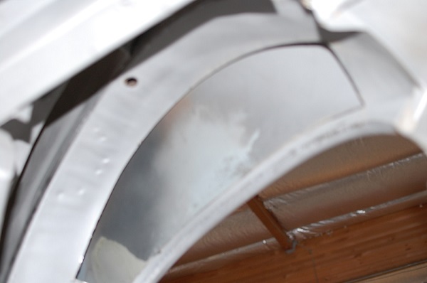

      Car looks fantastic and I am happy to see that you are still working on it.

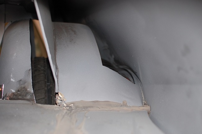

      Now that you lowered you may want to consider doing the outer wheel house mod when you roll the quarters. If you ever decide to run a taller tire this is the next spot that rubs.

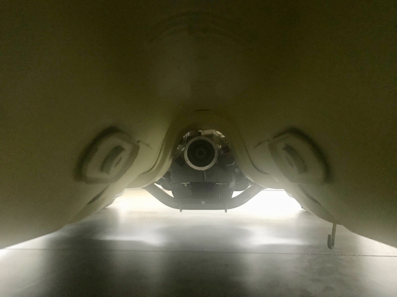

      Hauled the car to the shop for remaining fab work. Looking for input on a couple things.
      First, although the original plan was to keep the rear seat for aesthetics, I'm thinking about doing away with it so I can lift the floor in that area so that the mufflers can be tucked in a bit higher. Any reason I may regret doing this?
      Second, wondering if anyone has used the mini-tup trunk close outs that DSE sells, and if so, did they create significantly more clearance for the exhaust?
