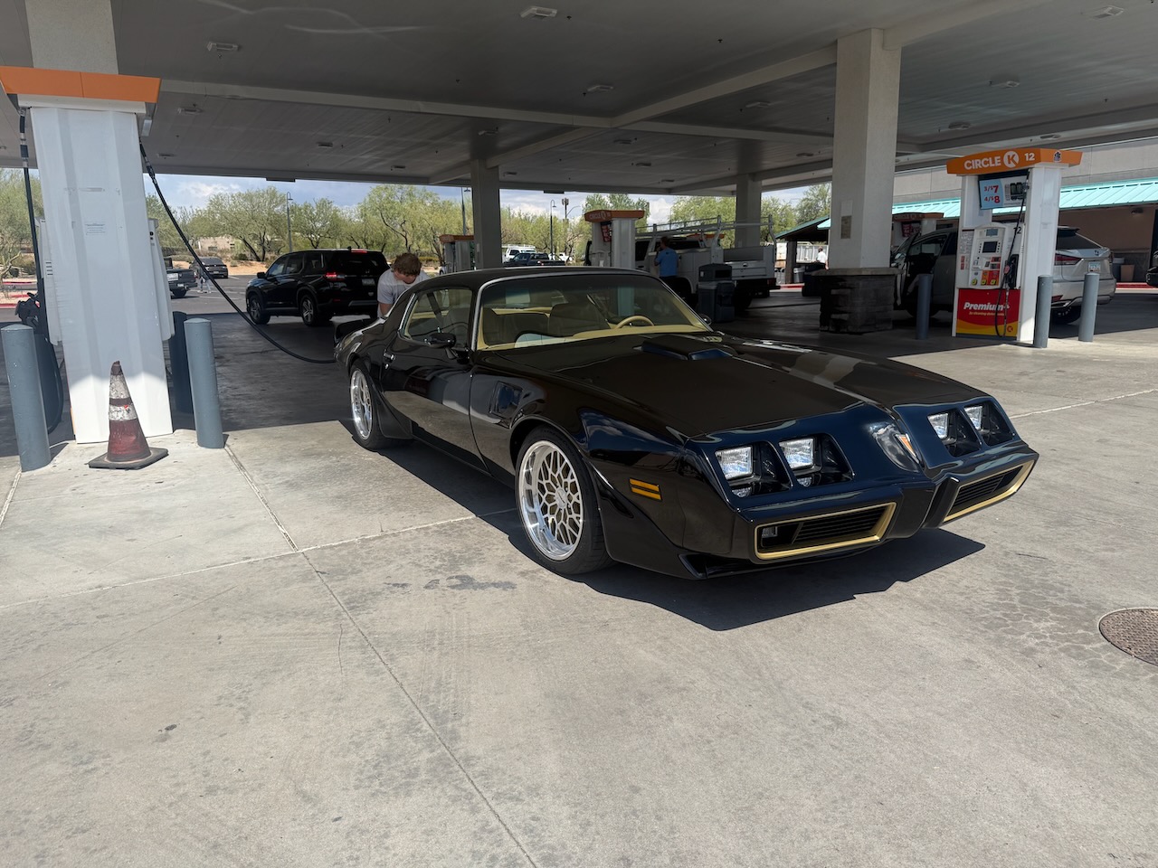

      Well, after 10 years, the car is pretty much complete now. I've driven it about 100 miles or so without issue. Everything works, it stays cool, A/C blows cold, no leaks or electrical gremlins, etc. It's quick and handles great. I was expecting a jarring ride, but it's actually no worse than some modern performance cars. It is a little raw--engine idles with some attitude and is loud, some gear whine above 70mph or so--but nothing obnoxious. The only things left to do is bring her in for an alignment, check fasteners, etc.
      I ended up spending about twice as much money on it than I originally planned. I went overboard on a few things, and I underestimated how much I would need to spend to maintain the factory Pontiac vibe. There are a few things I would have changed if I had to do it all again, but as they say, hindsight is 20-20. Overall, I'm happy with the outcome.

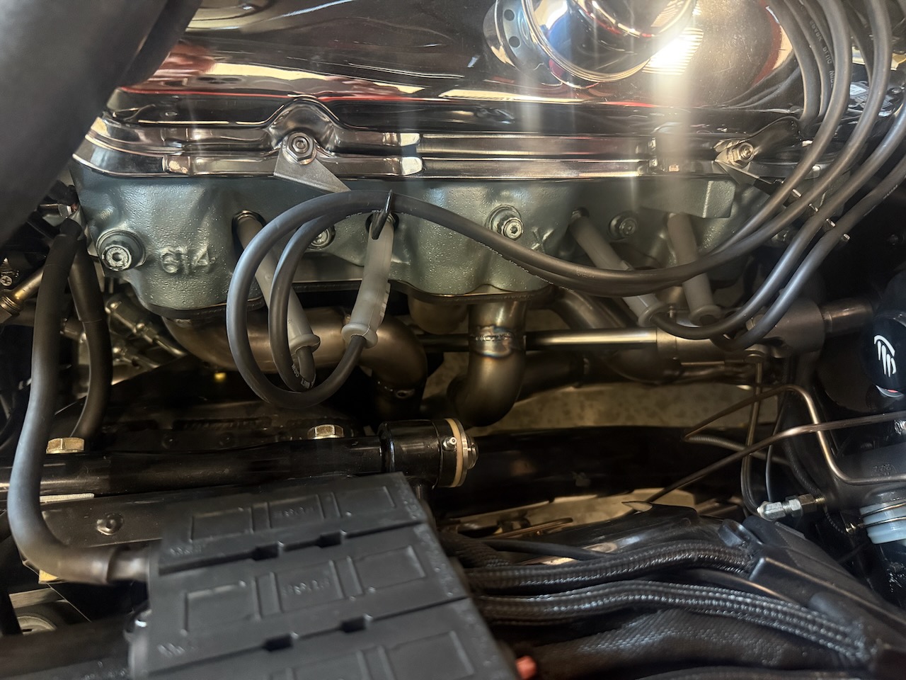

      Just finishing up my son's '79 Trans Am Y84. The build was a little different than my '70--LS (stroked LQ4), TKX, ridetech, Wilwood--but it turned out great. After the engine bay photo was taken, we replaced the long tubes from Hooker with a set from Ultimate Headers and gained about .75" of ground clearance. Only things left are polish and buff, install SE decals, & another remote tuning session with Andrew.
      So now that I have more time, I'll be making a couple changes on the Formula. First, I need more ground clearance...especially on the driver's side where the V band is ground down quite a bit. I'm having local guy a build some mid-length Tri-Y headers that will follow closer to the floor and not extend much below the subframe. We'll be redoing the exhaust to get it up higher as well. Second, I'll be replacing the center section with a FN988 from DSE (8.8" gears in a 9" case). The 9" in the car now howls some at highway speed which I find fatiguing on long drives. My son's 9" is a lot quieter, but not as quiet as I heard these DSE deals are. I may go with 3.73 this time.

      The tri-y's turned out good. Lots more ground clearances. They install easily from the bottom of the car and plenty of room for the steering shaft, oil filter & starter. I'm going to get them Cerakoted. Making progress on the exhaust. Have to redo the fuel line to the throttle body, clutch MC line, and park brake cables. But the added ground clearance should be worth it. Name:  IMG_1885 (1).jpeg
