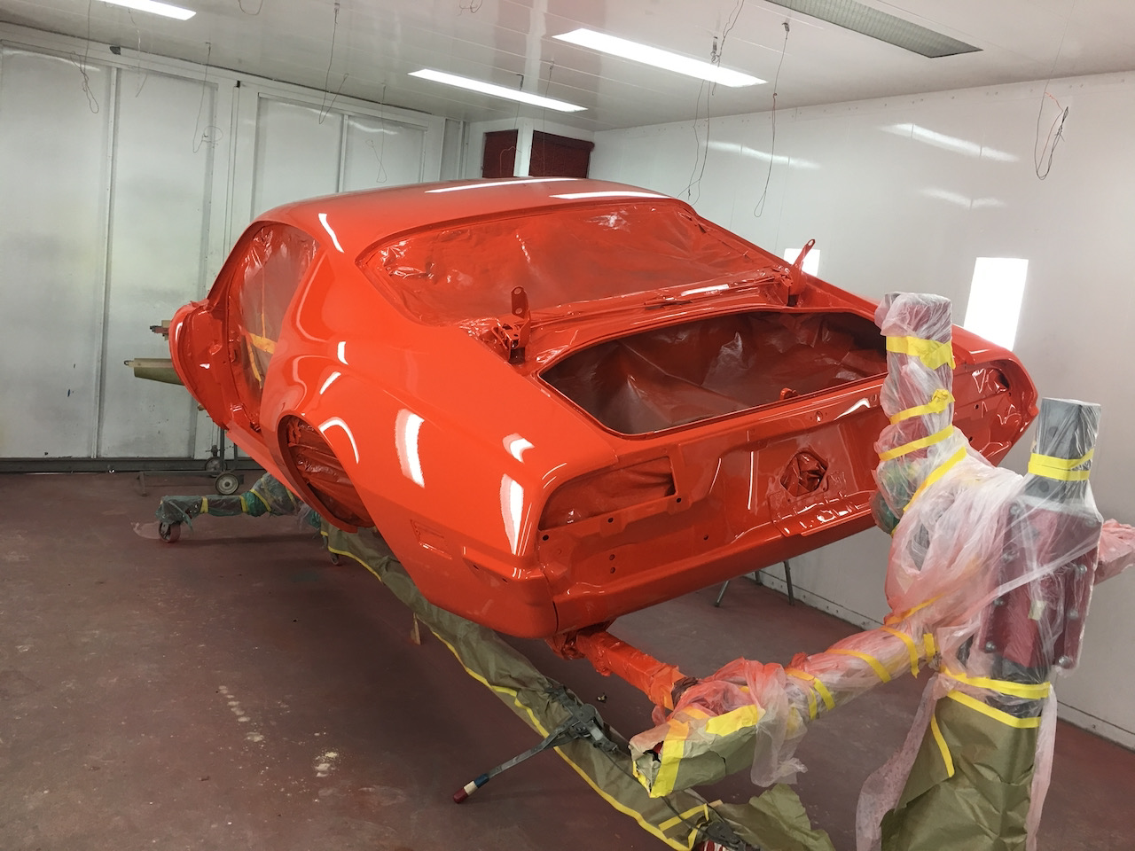

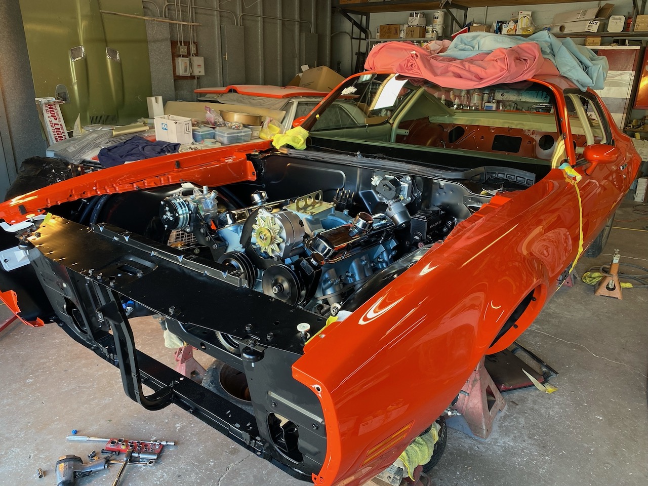

      She's mostly painted now. Hopefully backordered/delayed parts make it here over the next few weeks, this way we're ready to roll by the time sanding's done.
      Need to order wiring today...I haven't given this much thought...would the AAW Classic Update kit be my best bet?

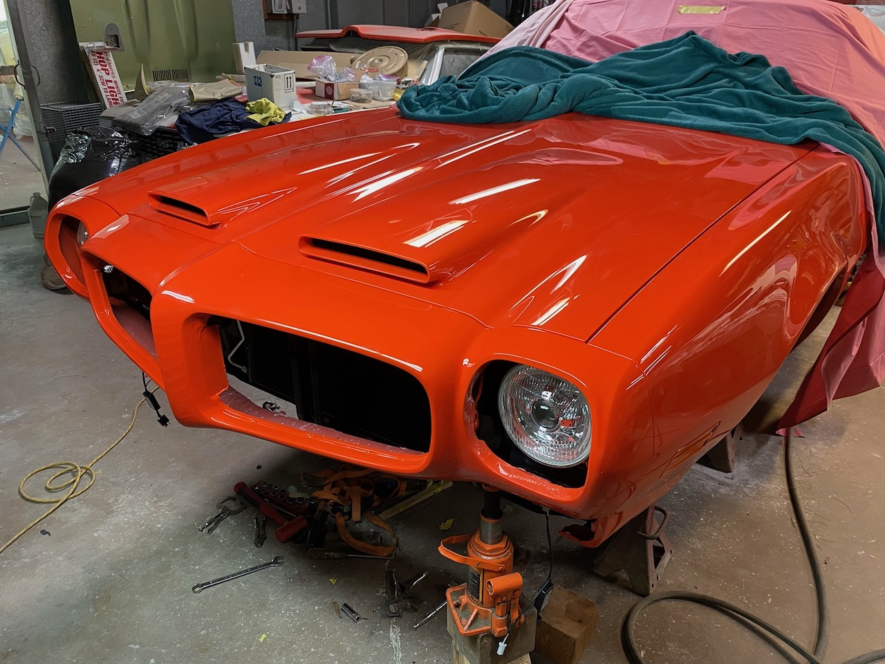

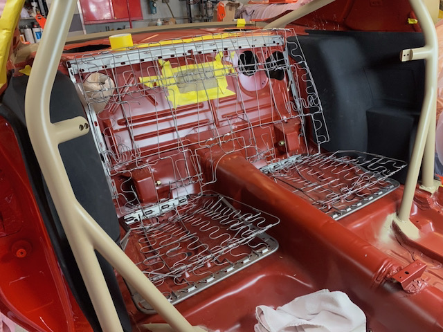

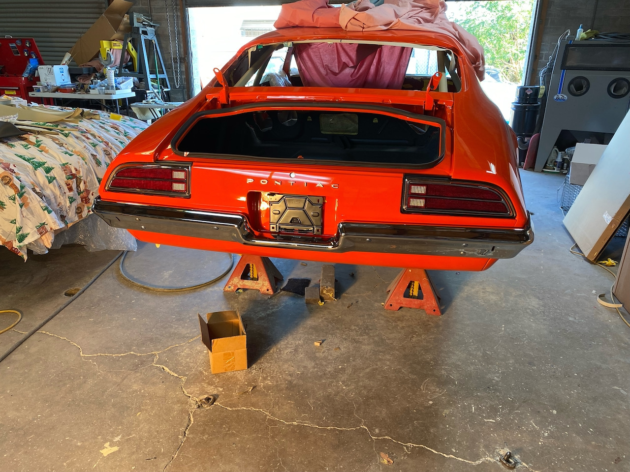

      Finished with the paint and polishing. Starting reassembly. Just fit the modified rear armrest panels and seat frames. Ready for upholstery. Engine should be done by Christmas. Name:  IMG_2486.jpeg

      Looks good, where did you source the seat frames and side panels?

      I modified the original factory seat frames and rear armrest panels in my garage shop. Neither are available aftermarket, unfortunately. There's not a ton of direction on-line either, but easy to figure out. Just time consuming (especially the armrest panels). My 17 y/o son helped out with the seat frames. He taught himself to weld during the covid lockdown, so he was able to piece the frame back together after the necessary mods. I took pics of the process for both if anyone is interested.

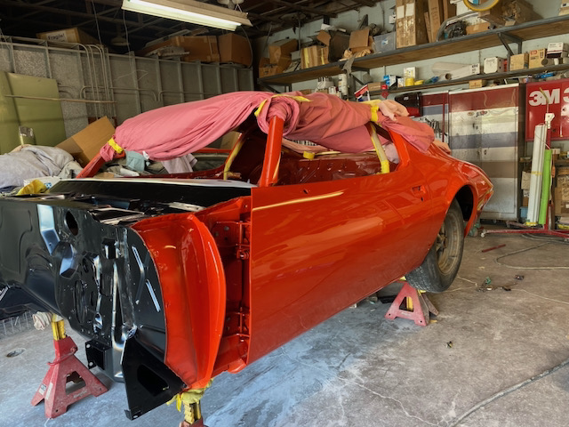

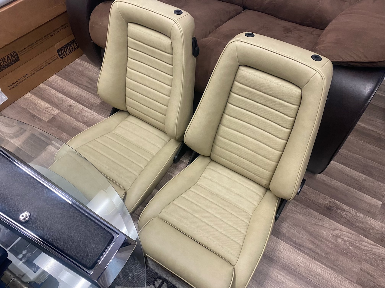

      More progress. Seats turned out nice...going to have the upholsterer look at the rear armrest panel. They turned out OK with the texturing I used, but I'm not sure they're nice enough for this car.
      Need to replace the trunk weatherstrip. It's NOS but won't compress nearly enough. I guess I'll try the Metro offering, unless someone has a better recommendation?

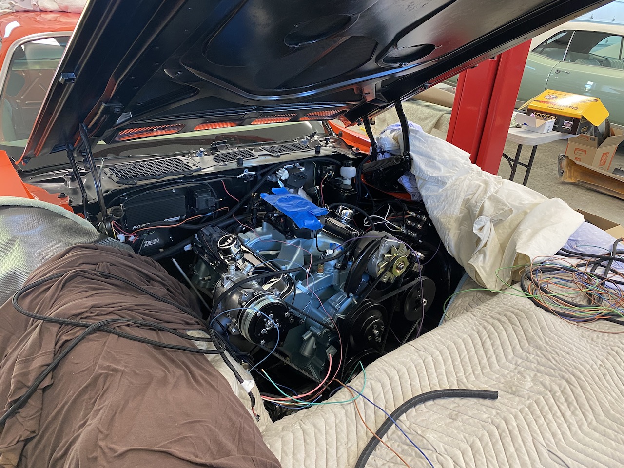

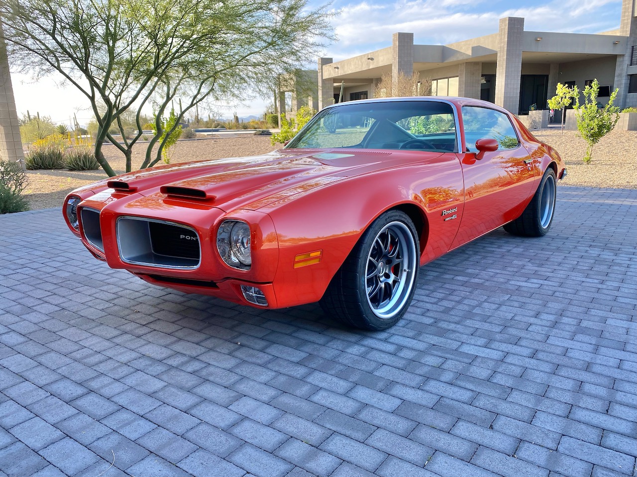

      Haven't posted updates in a while, but things are moving along. Aluminum 535 in place with factory style accessories. I'm hoping this set-up works well enough. Next up is wiring and fuel, brake, and other misc. lines. Haven't given much thought to AN lines I'll need to make, but the time is here. Never done this before, and not sure what the best options are with regard to brand of lines/fittings, etc.

      I've had the car home for a couple weeks. Been concentrating on wiring and plumbing and all the little details. The original plan was to hide things like the ignition box, ECU, vaporworx controller, etc., in the interior under the dash, but I'm prioritizing easy access to diagnose issues, make repairs, move things around, so a lot of that stuff is ending up on the firewall. I'm keeping the battery up front...may try a light lithium-ion deal.
