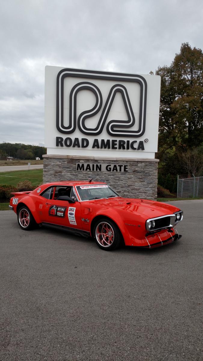

      Love the build, I am a huge Pontiac fan. I think you will be fine on the clearance, but as it has been pointed out already, I would cycle the rearend through it's travel and look for any interference.
      Looks great!
      You also asked early on about what direction to go. I say do what you personally like. I went pretty extreme on my 67 Firebird with flares and other body mods, some like it, some say I destroyed a classic. Build the car you will enjoy.

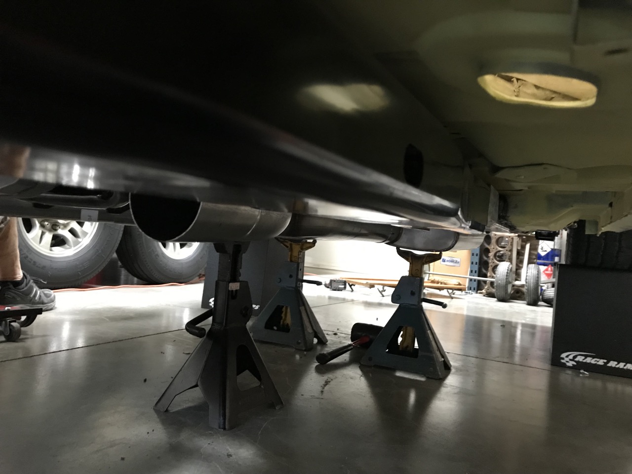

      I spent some time tweaking the tail pipes so that they fit without making contact with the fuel tank and panhard bar. I will still need to take it to an exhaust shop at the end of the project because it's still too tight in places, but at least I could fit the mufflers and the rest of the exhaust to get an idea of where the headers need to end up.
      I noticed that the exhaust will hang about 1.5" below the bottom of the subframe. Do I need to get it up higher? The header guy is really busy right now and not available until the 3rd week of January, so I still have time to make adjustments. I decided to go with mild steel and ceramic coating. From my research, should stay a bit cooler than stainless and a lot less expensive.

      You can flatten the spot under the rear seats to get the mufflers up a little higher...
