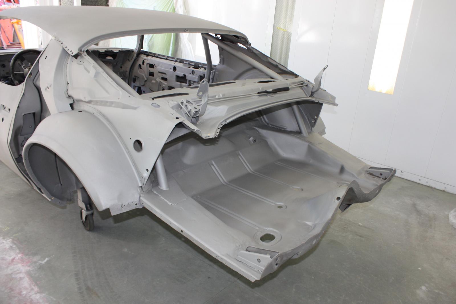

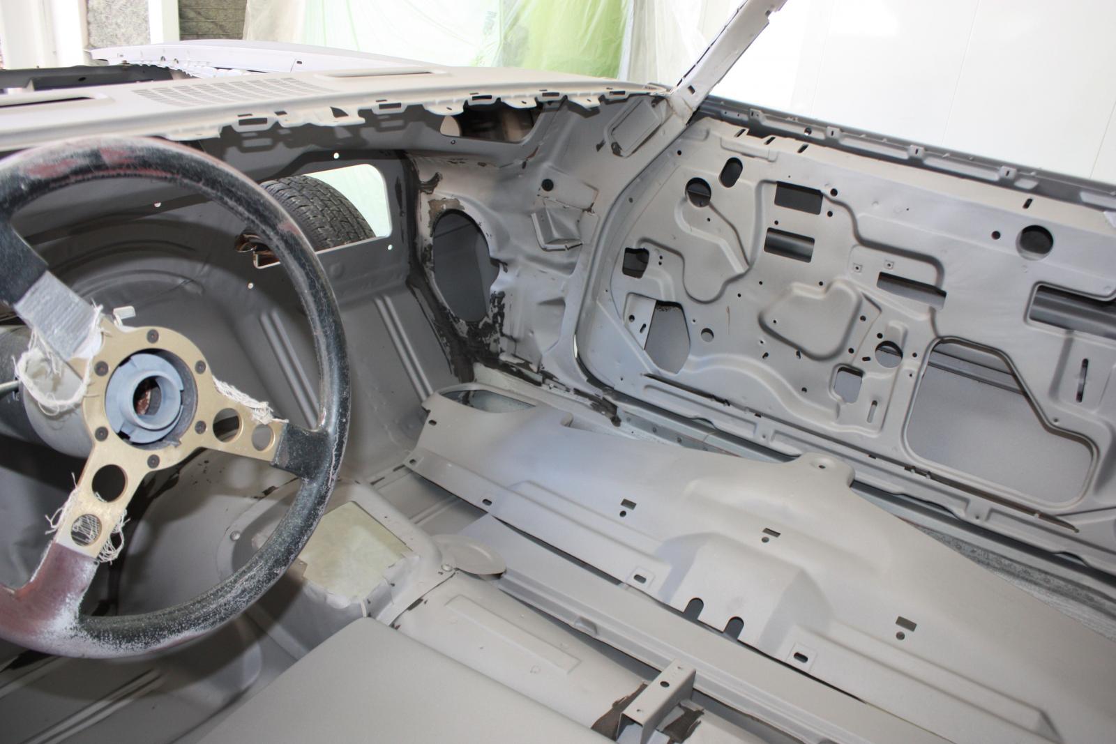

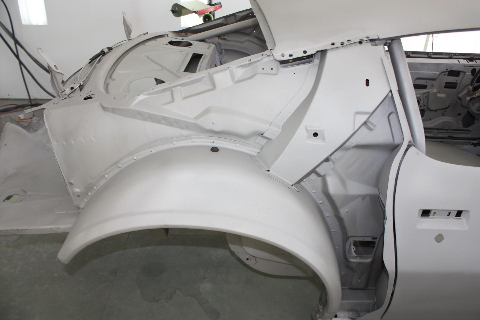

      Tubs are in and work on the Quadra Link is under way. Should be done next week, and then off to the blaster again. As you can see in the photos, we decided to go with fresh sheet metal rather than trying to straighten out the collision damage to the quarters and tail panel. To my amazement, there was absolutely no hidden rust in the inner quarter structures, outer wheel houses, or anywhere else for that matter.

      Should be finished with the Quadra Link stuff this week. Here are some photos of progress as of Friday. Not sure how far to go prettying things up. The original plan was not to go too far beyond what the car would have looked like had the factory installed these parts.

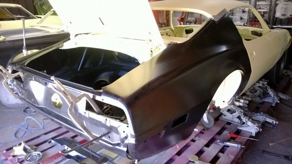

      Moved on to the front of the car for a while…preliminary metal work and fitting doors, fenders, hood, bumper & valence. We're going to leave the gaps a hair wider than a normal restoration to accommodate some flex. I'm really happy with how things are looking…I'm especially happy the hood fit so well…being made out of fiberglass many have warped and cracked over the years…I was lucky to find a really nice one close to home.
      Will weld in the main hoop and back bars of the cage before it leaves for the blaster…probably after the new year now.
      I decided to keep the stainless decor moulding around the windows and the "Firebird" and "Formula 400" fender emblems, but will not be installing the rocker trim or wheel well moldings.

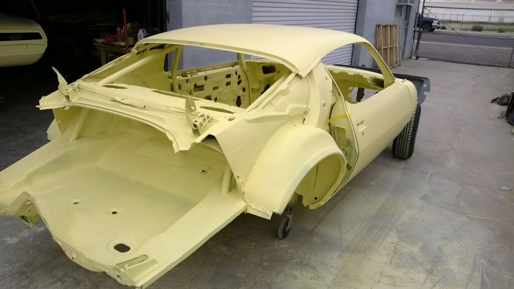

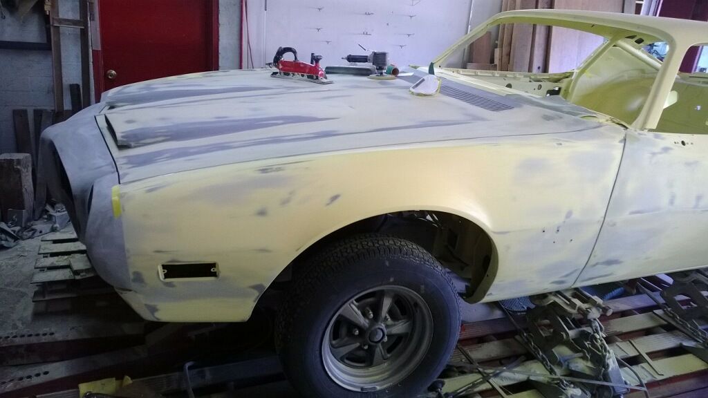

      Progress on this project has been slow and steady. After Randy was satisfied with the fit of the hood, bumper, valence, fenders, and doors, he took it apart and sent it to the blaster. As you can see from the photos, the body is really clean.
Size:  108.4 KBName:  IMG_4251.jpg
Size:  126.5 KBName:  IMG_4258.jpg
Size:  156.6 KBName:  IMG_4267.jpg
      Body in epoxy.
      Front clip back together. More fitting and straightening.
      Quarter and tail fitting…she's starting to look like a car again.
