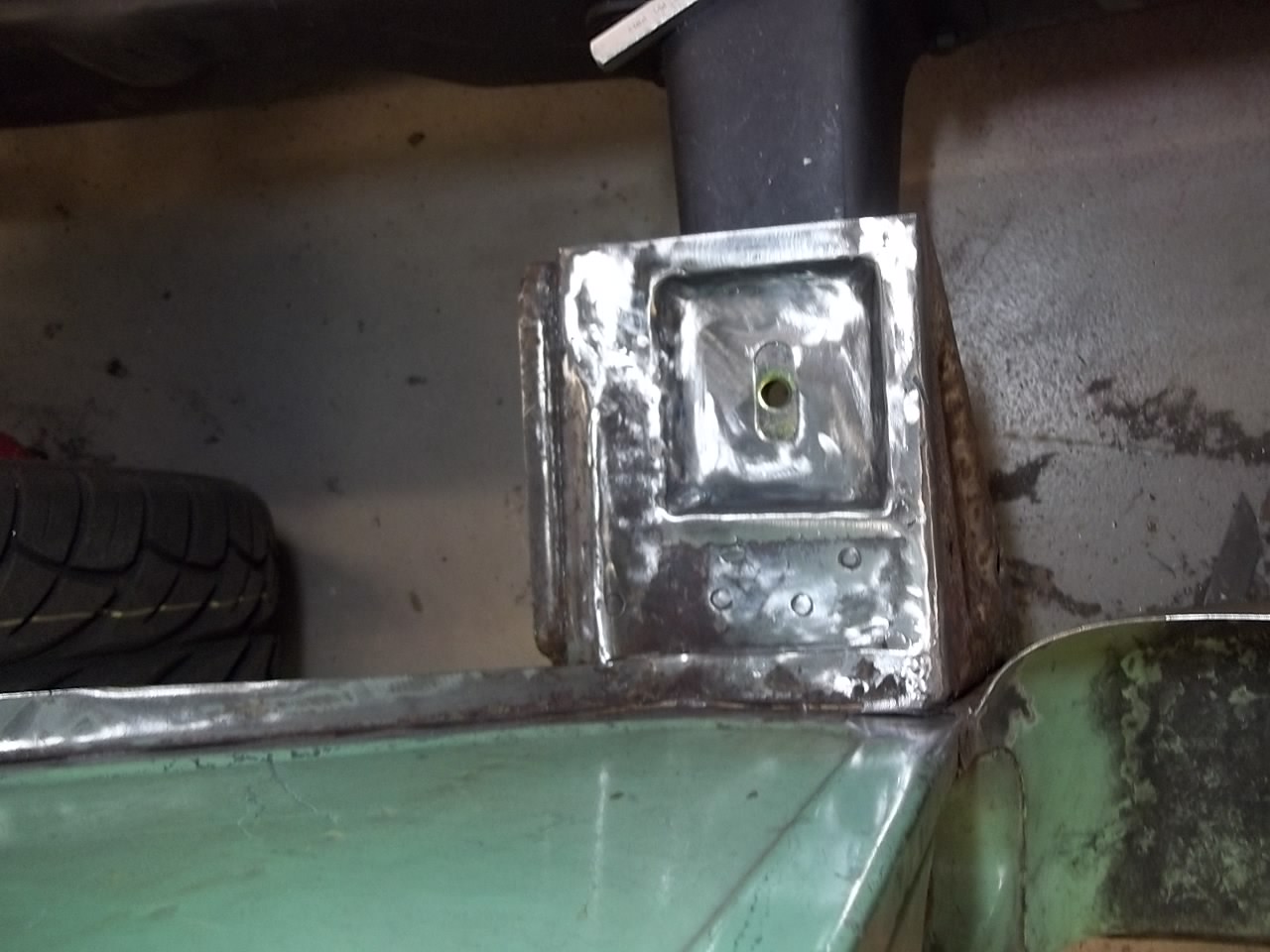

      Well, I finally finished up all the other crap I needed to get done so I can get back on the truck. Started on the drivers side sheetmetal work, repaired the body mount, the footwell and half the floor. Also got my valve covers back from Phoenix Specialty Coatings.
