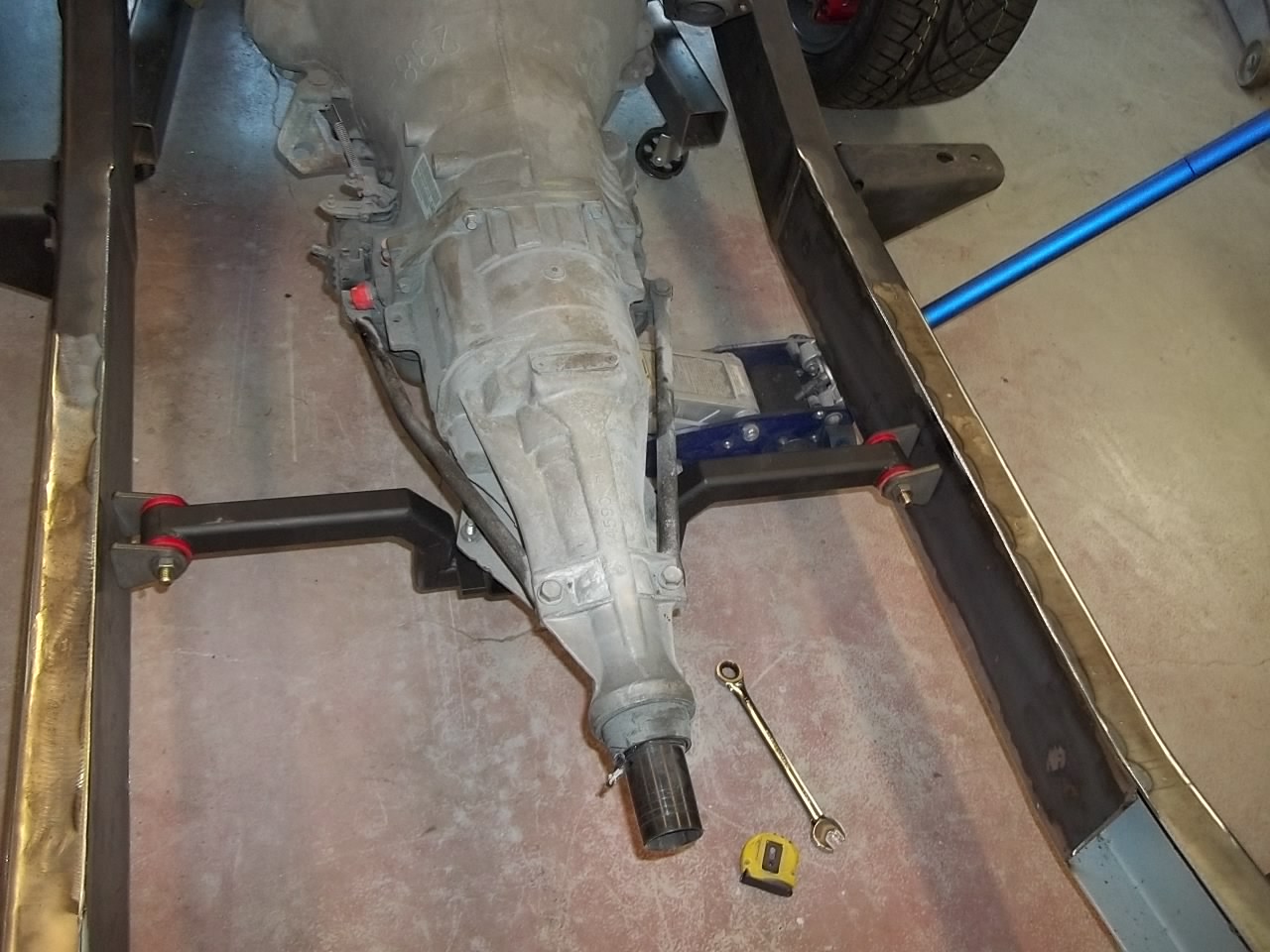

      Not a lot to update, but I did box the center frame section with 3/16" plate, I fabbed up a trans crossmember, and got that tacked in.Name:  100_1218.JPG

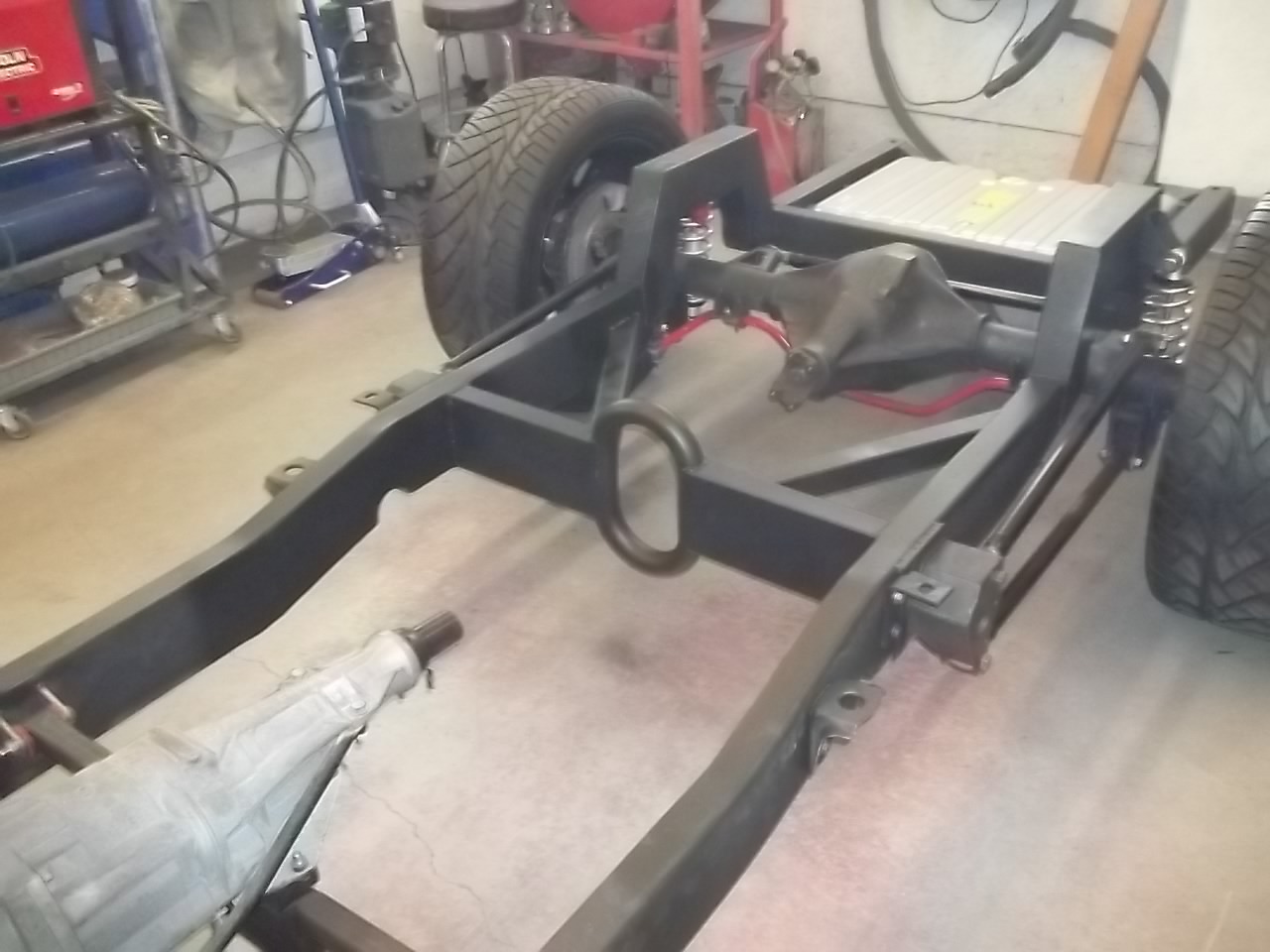

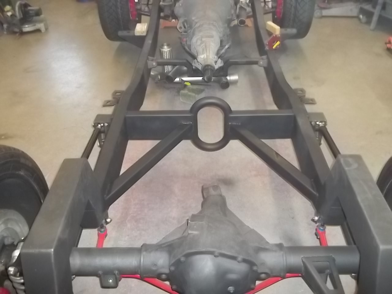

      Been a little slow lately, life keeps getting in the way. I did manage to replace the factory rear crossmember with an Art Morrison one. Then finished boxing the frame, and added a couple diagonal braces. Next will be the exhaust.
Size:  211.2 KBName:  100_1233.JPG
