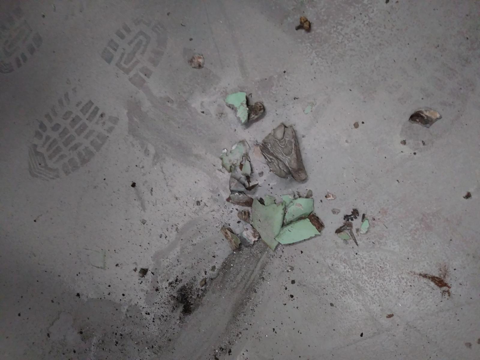

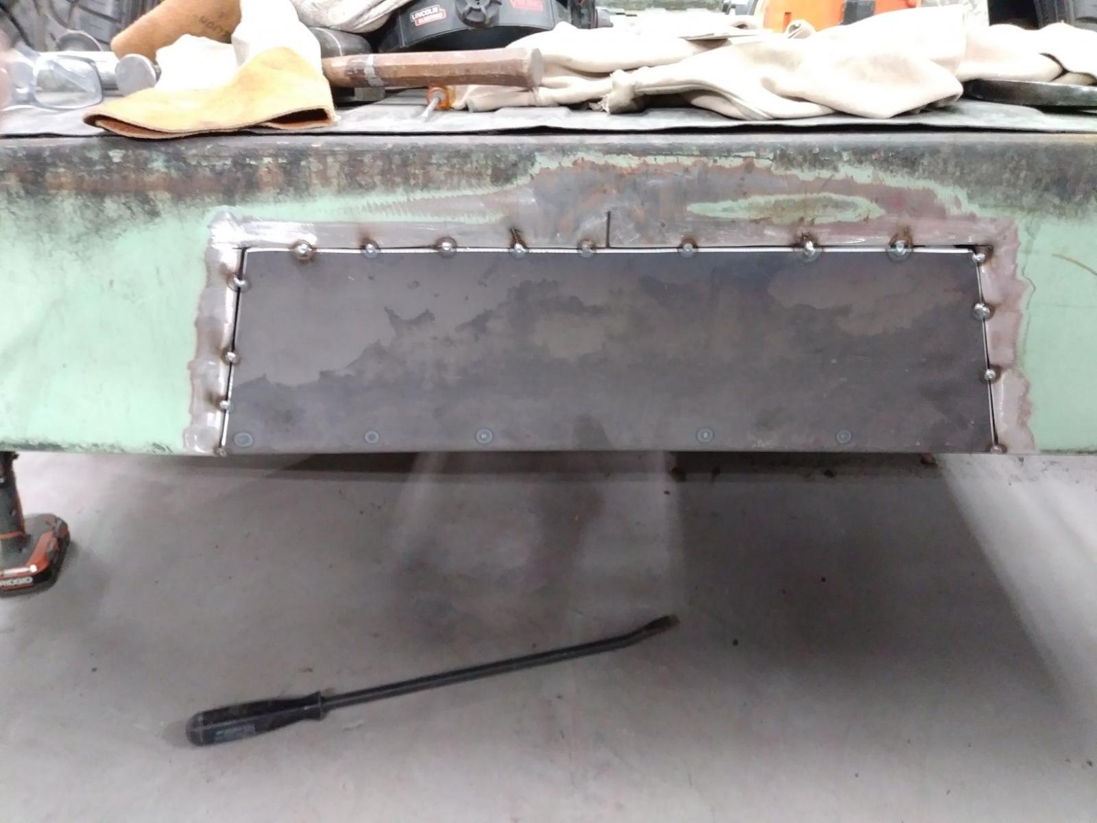

      Work on the bed is progressing. I had to cut out the recess area for the license plate in the rear pan. The plate goes in the bumper so I won't be needing it and it was hitting the rear crossmember I welded in to protect the gas tank. Unfortunately I had to remove the tailgate to get at the rear pan, in doing so, all the bondo that was packed into the rust hole began to fall out, so now I have to rebuild the bed corner. Opened up a "Can of Worms"

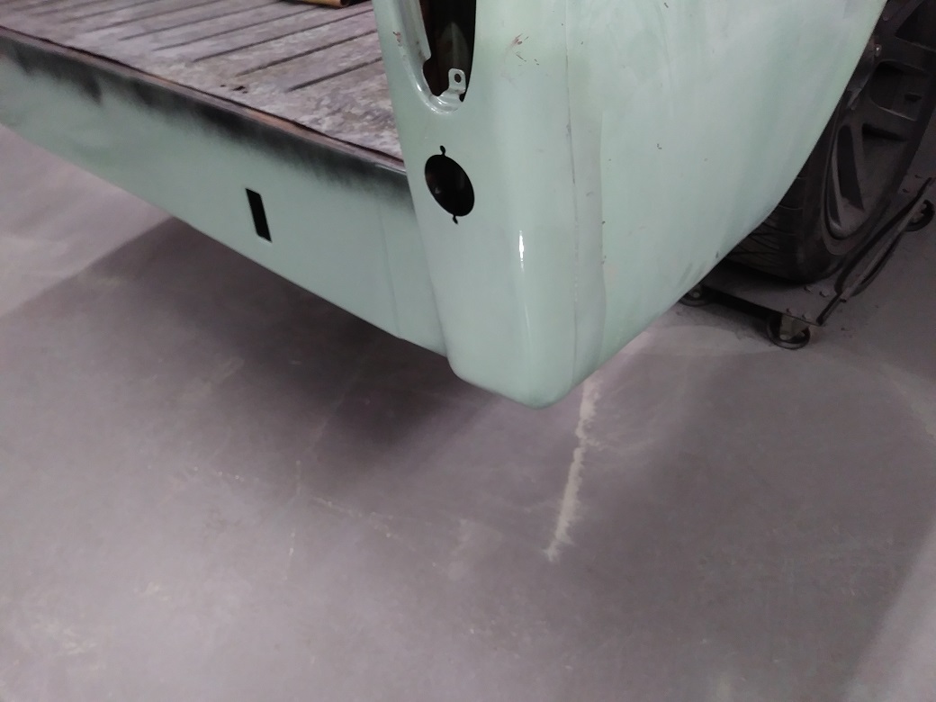

      Finished rebuilding the bed corner, it took 5 different pieces of sheet metal to get all the structure back .

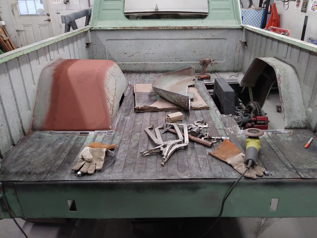

      Moving on to the wheel tubs. One done, second one almost done, should finish up tonight...

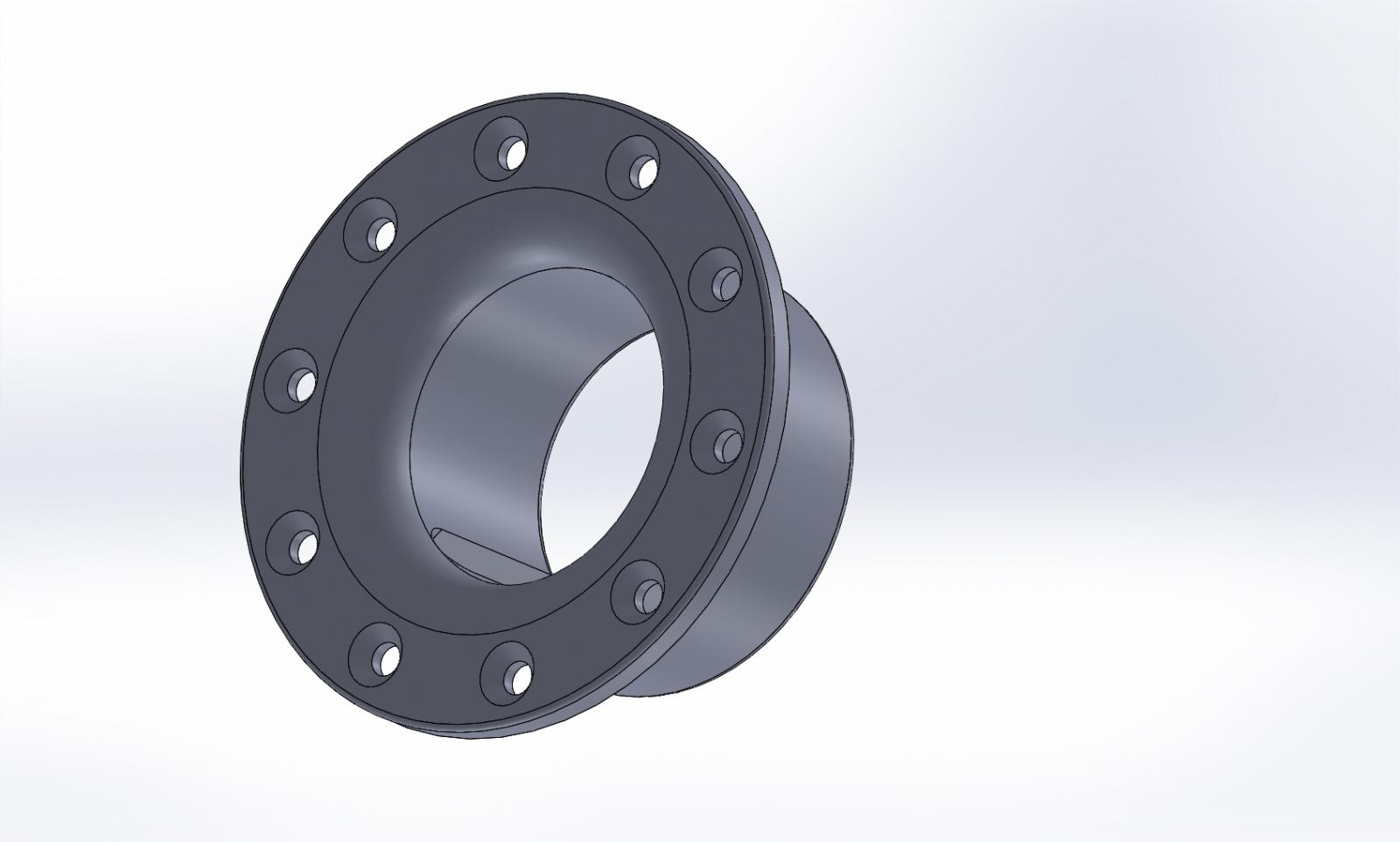

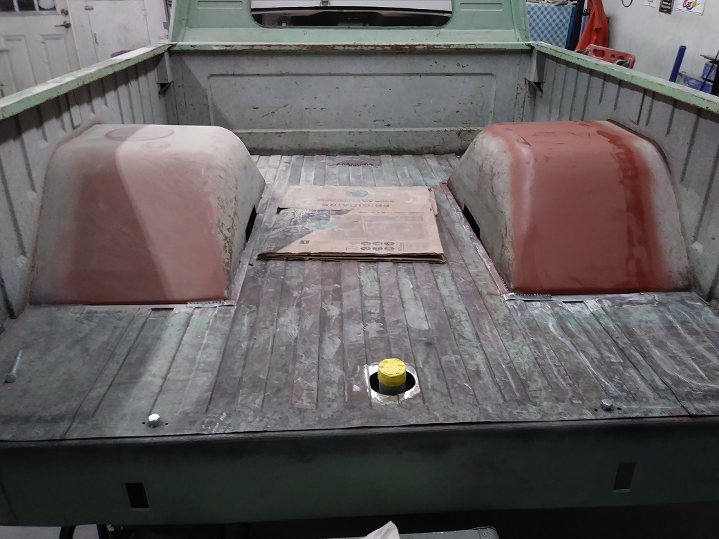

      Wheel tubs are done, got the hole cut for the gas tank filler, just have to machine a bezel to clean up the hole..
      Name:  Gas Filler Bezel.jpg
    10. #250
      Nov 2010
      579

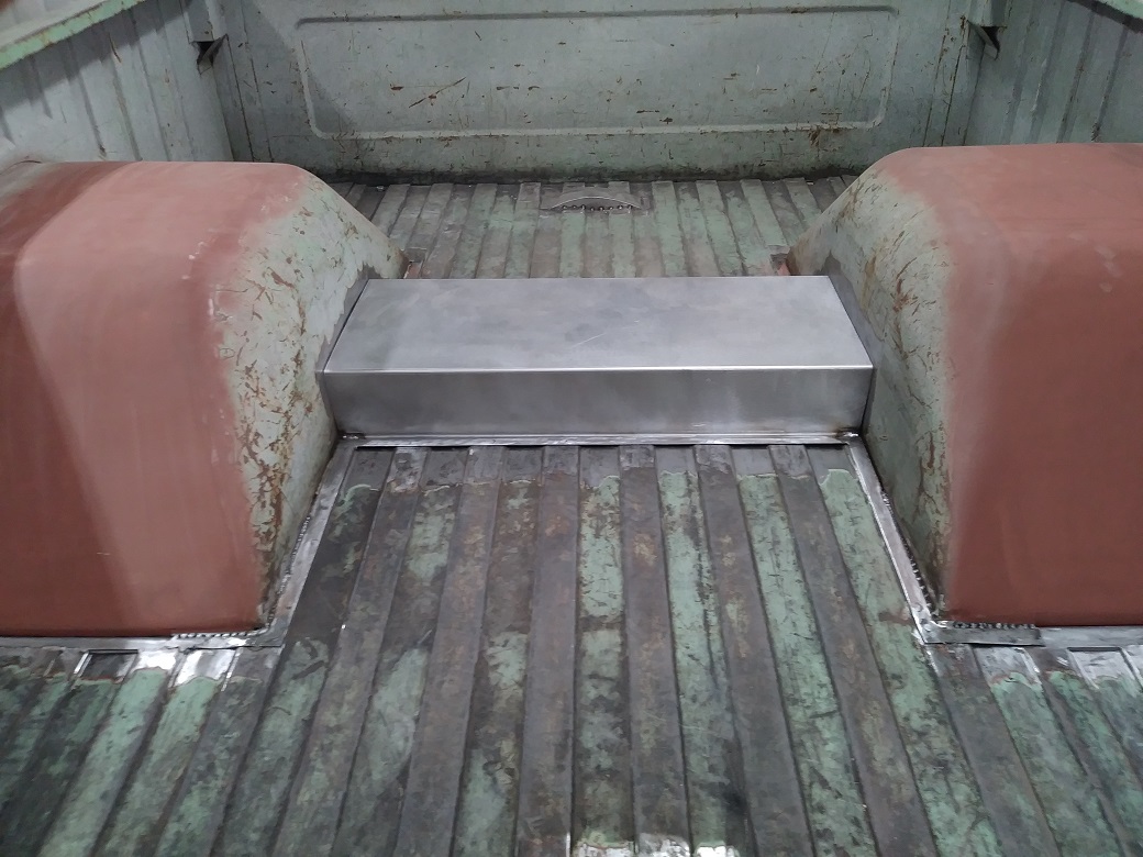

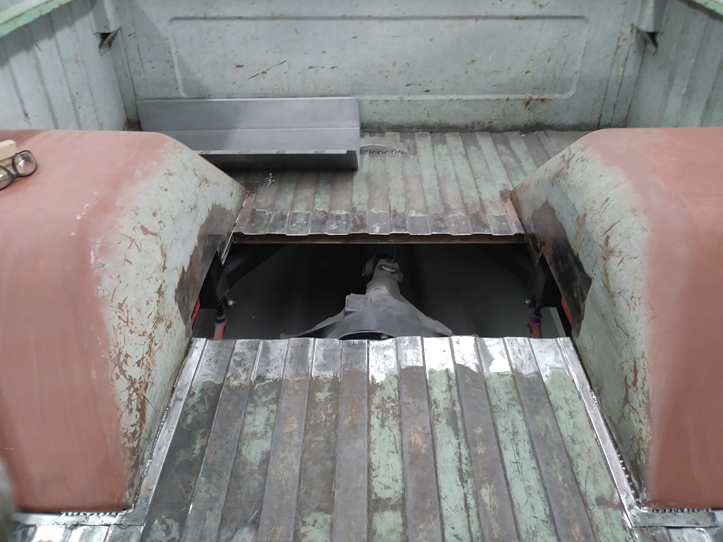

      It's Hump Day! Got my axle cover welded in. I had ordered a cover online, but it came in made out of 18Ga. sheet metal, kinda flimsy. So I went to my local sheet metal shop and had one bent up out of 14Ga. same as the floor. Also decided to 3D print the bezel for around the filler neck, then welded a steel ring to the floor to bolt it to.
