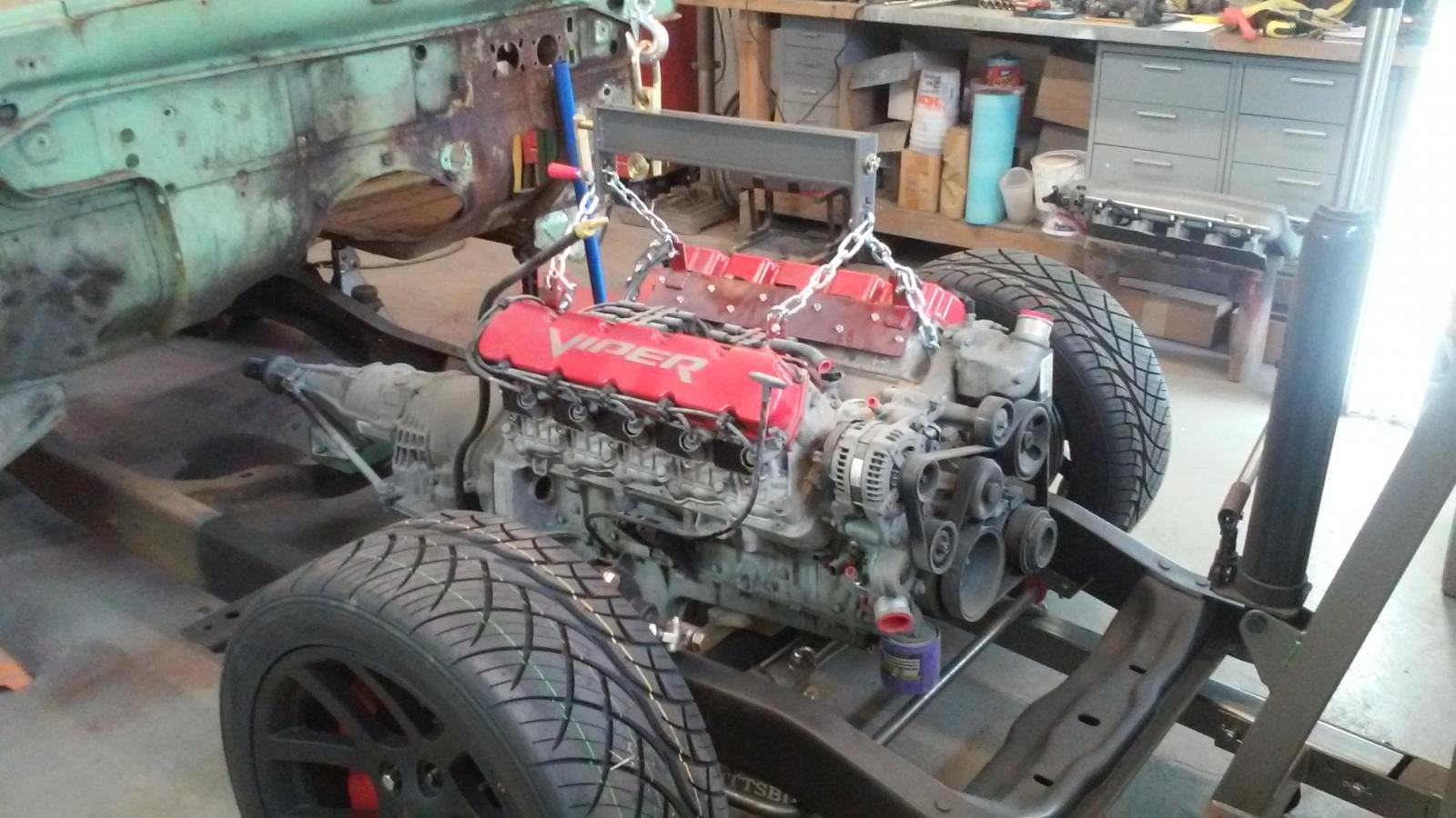

      Looks like it might actually fit....Now all I have to do is fab up some motor mounts.
      Name:  Phone Pictures 290.jpg
      Name:  Phone Pictures 291.jpg

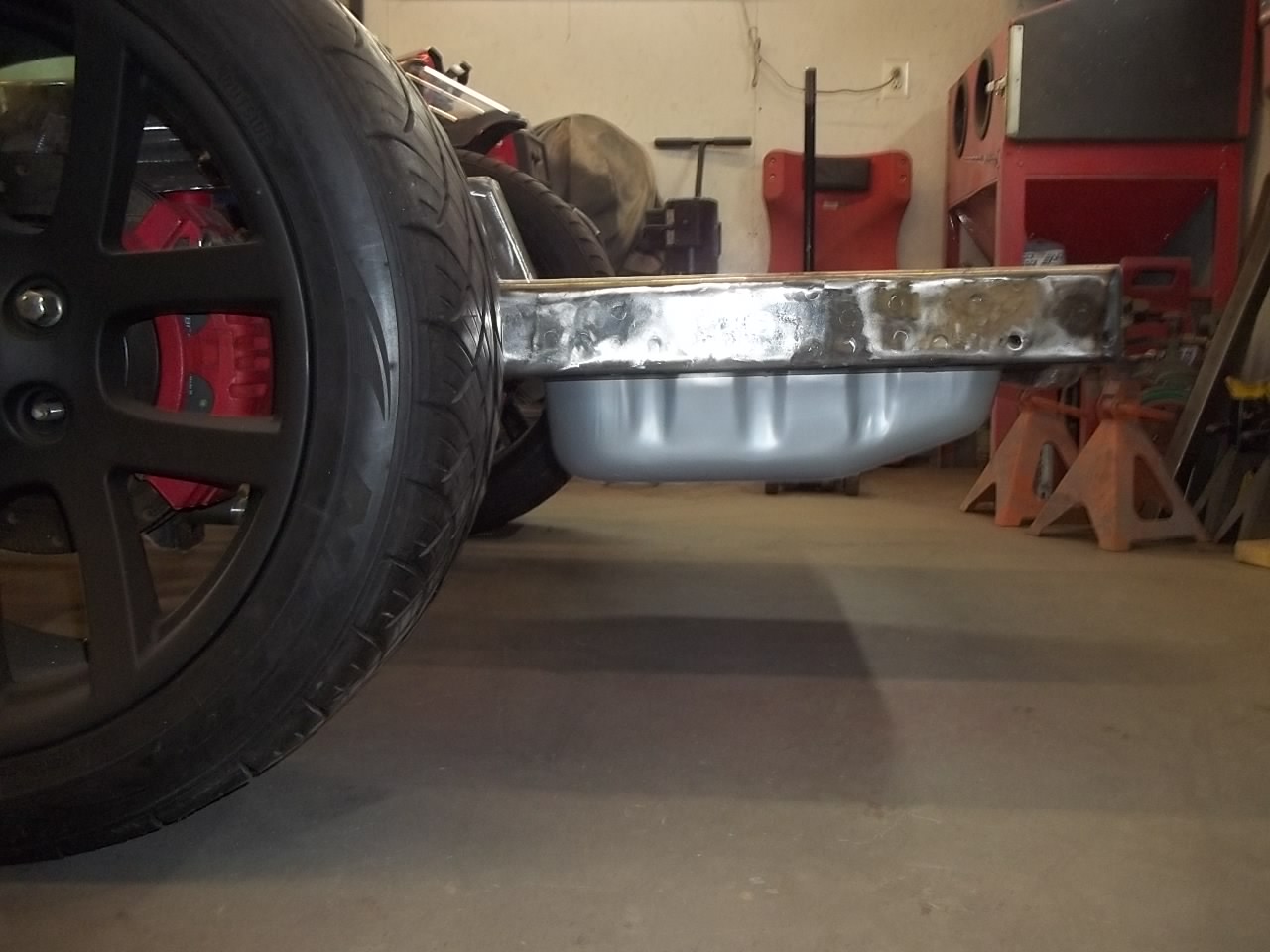

      Gas Tank is finally mounted (22 Gal. Mustang). It took a while to box the rear frame rails, then weld in 1 1/4" box tubing, and use (13) 1/4" riv-nuts. The best part is it fit perfectly between the frame rails, so when I want to remove it, It just drops out from the bottom...

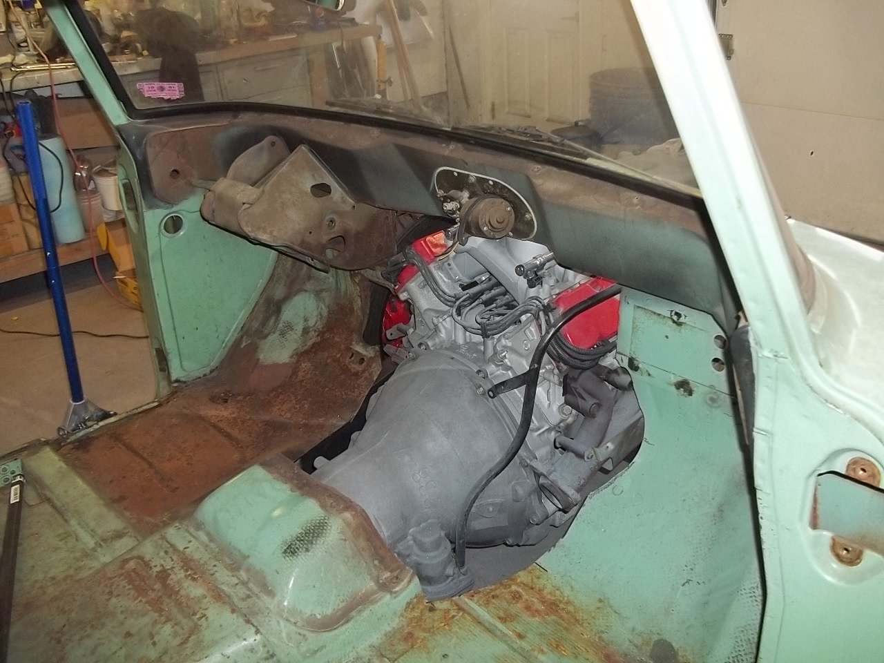

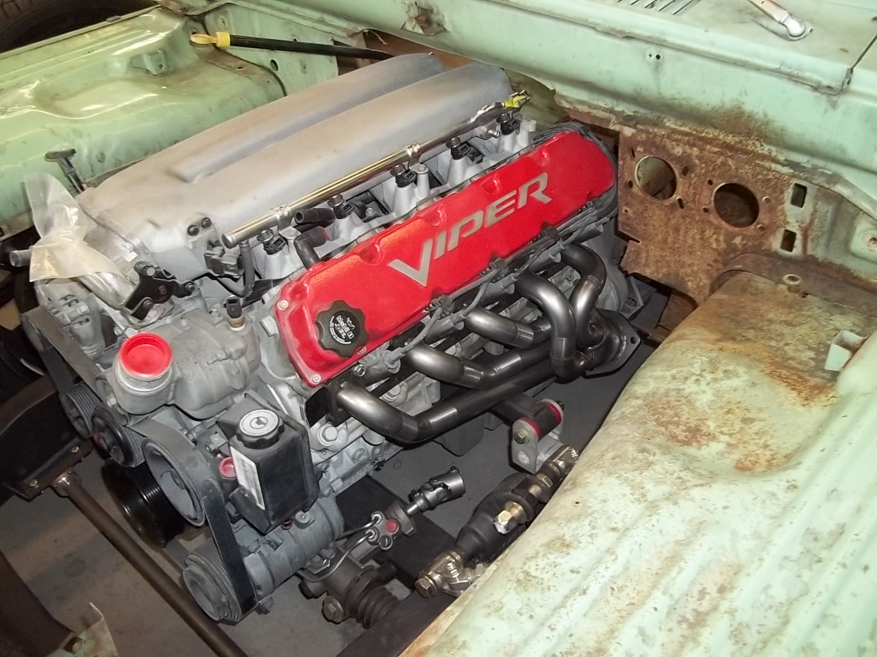

      Motor is in, and the cab is back where it belongs....

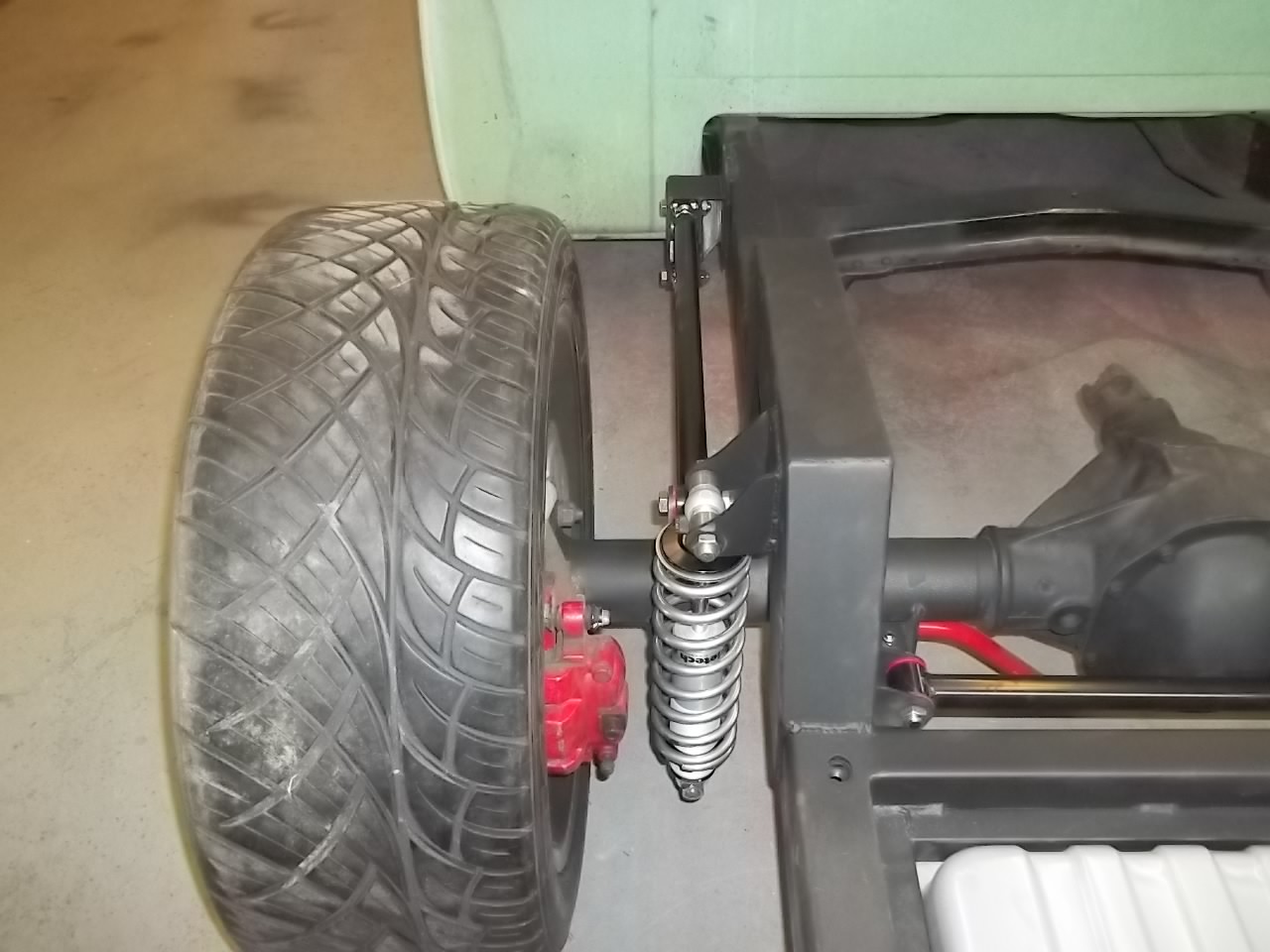

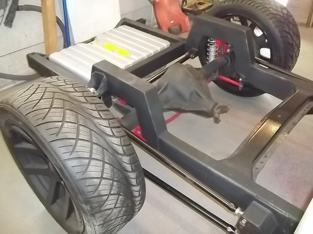

      OK, I haven't been slacking off, I've been sick as a dog. After 2 weeks of not much progress, I finally got out to the shop and welded in the rear suspension. Also got my headers installed, I'll bet I lost 50lbs off the nose.

      It looks good in there. Is the steering going to go on easily ? From the angle it look pretty good.
    17. #97
      Nov 2010
      579
      I'm gonna have to modify the motor mount, but it should have plenty of room.

      I really love the stance of that truck.
      Hint: If you can, make that panhard rod longer.
      1985 Dodge Power Ram W250 3/4t 360/518/241
      2005 Dodge Ram 1500 SRT-10 505/T56/D60 small upgrades
    19. #99
      Nov 2010
      579
      Quote Originally Posted by kingcrunch View Post
      Thanks, If I make it any longer, it will hit the chassis....
