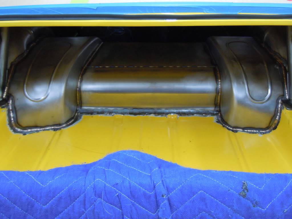

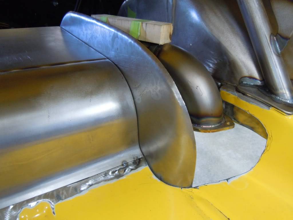

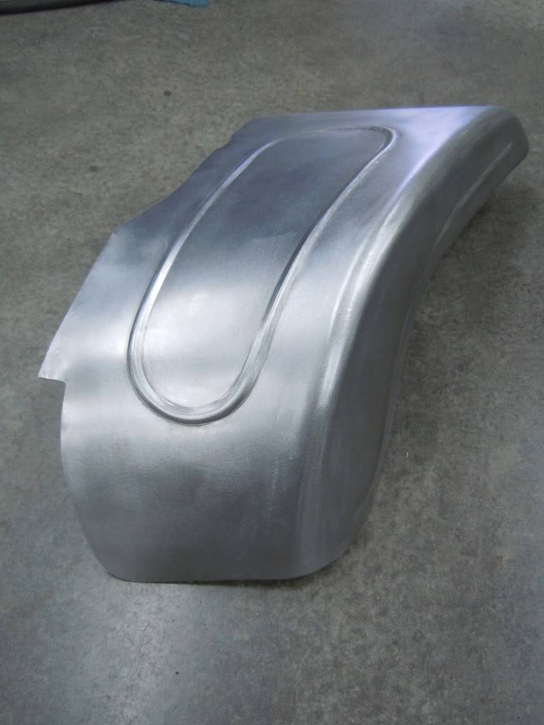

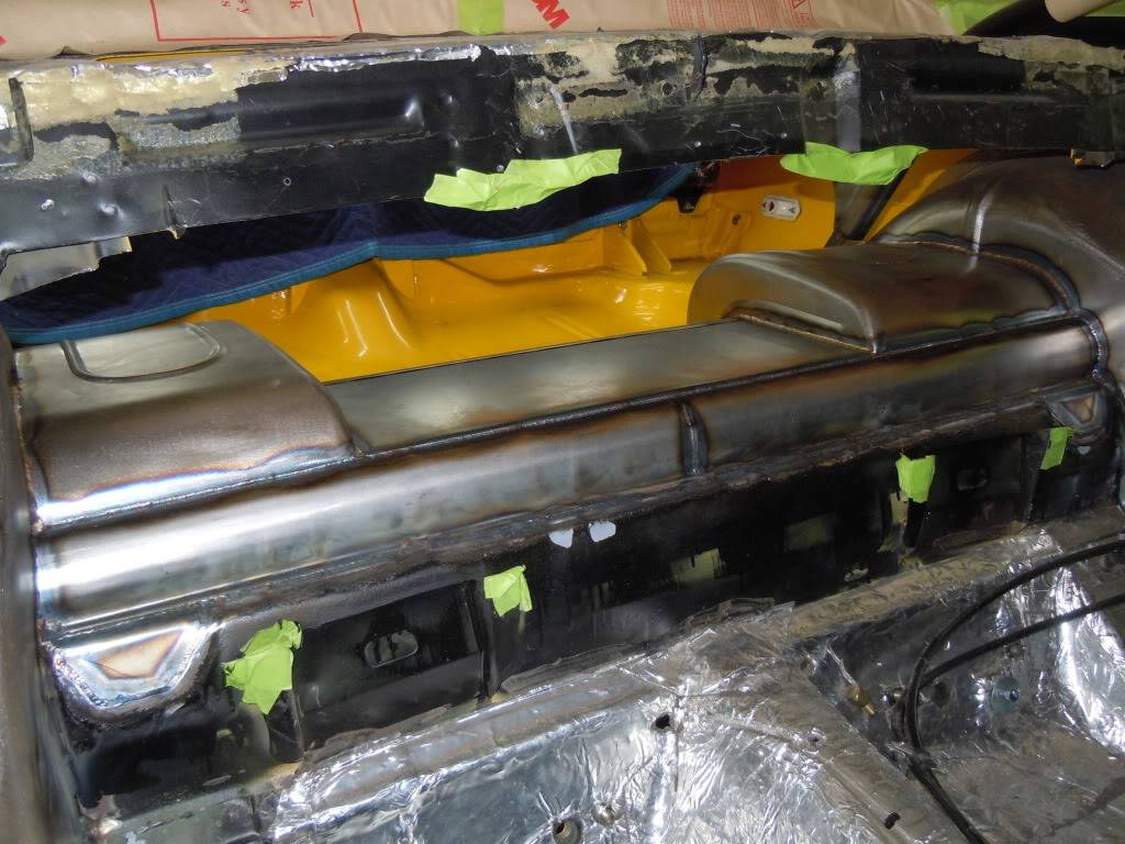

      I have seemed to misplace a few pictures, so I will have to explain and show the final product. We cut so much out of the trunk that Dan plated the rear portion and added some additonal bars to strengthen it back up.
      Here is the final product before we start the trunk floor.

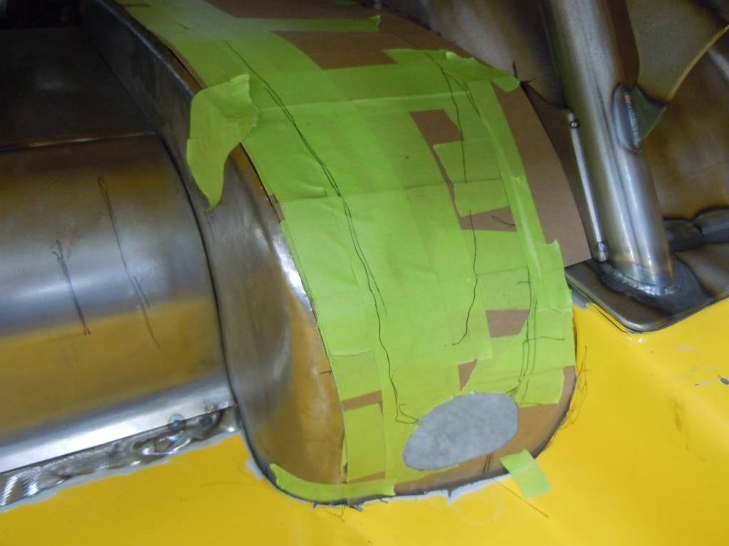

      Time for trunk fab

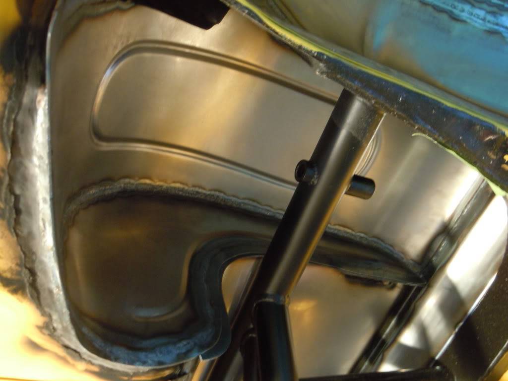

      From the bottom looking up into the exhaust pocket

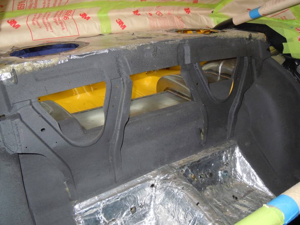

      From inside the car before the seat brace goes back in

      Seat brace back in and small section POR'd and then lizard skinned.

      Payton, that's lovely tin work. Just lovely. Did Dan use an english wheel and electric bead roller?

      My guess is slip roll, then bead roller, then maybe a little flat die english wheel??
      Looks great buddy! Must be getting close to done and ready for some auto crossing down south?
