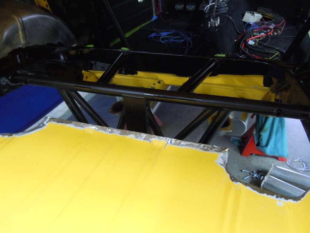

      Payton, that's lovely tin work. Just lovely. Did Dan use an english wheel and electric bead roller?

      My guess is slip roll, then bead roller, then maybe a little flat die english wheel??

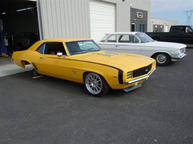

      Looks great buddy! Must be getting close to done and ready for some auto crossing down south?

      sweet car and man do you ever love yellow the car is very clean

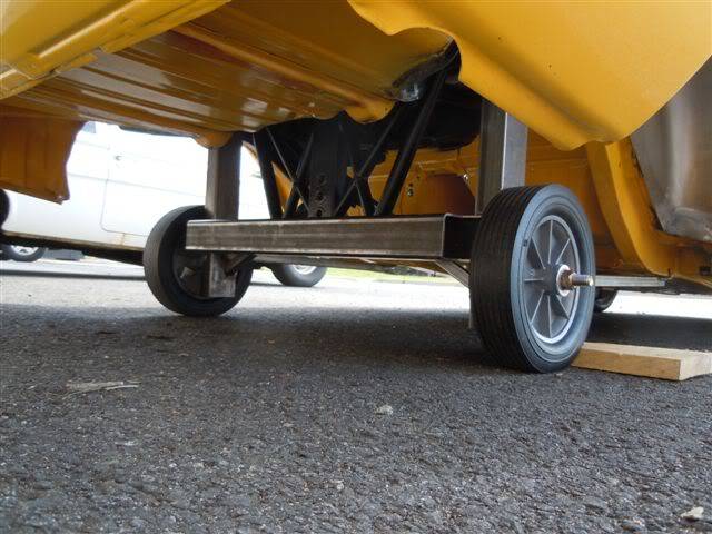

      Glad you like the work. All the metal forming was done by hand in making the shapes out of 16 ga., then a bead roller, no wheel work. Some slip roll work was also done but mostly bending, twisting and tweaking by hand over anything that doesn't move. Corner radius's done by hand also then everything TIG welded and mteal finished.

      Tig welding all that sheetmetal, wow. Dan you are a patient man, fab work is phenomenal. Ron
      no kidding!....GTAW takes some time compared to the squeeze and squirt method.

      Not to mention flexible... I can't imagine climbing into that trunk to TIG weld all those seams!

      Stunning fab work and welding

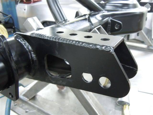

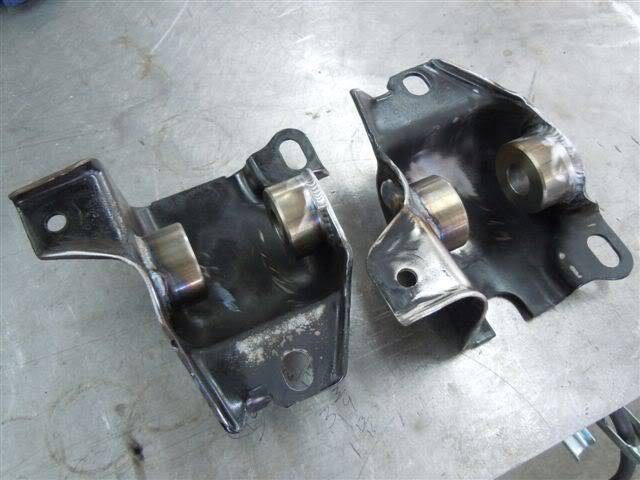

      I did not want to use the poly bushings so I took JP's advise and used Sphoons end. Very nice piece but it is large, so more mods were in order

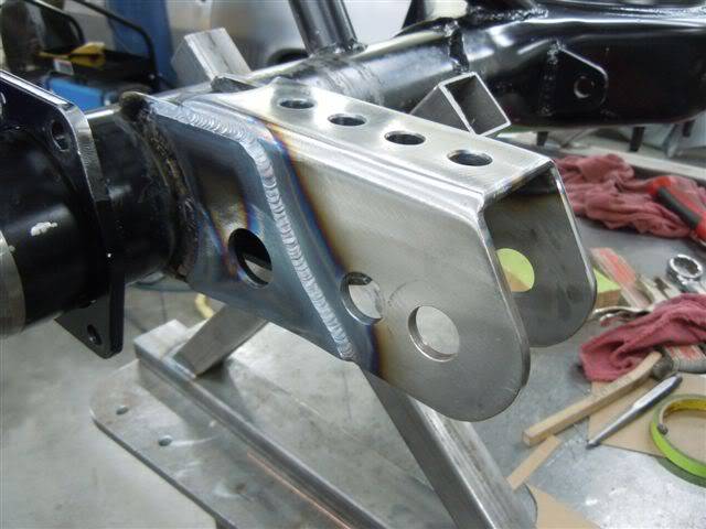

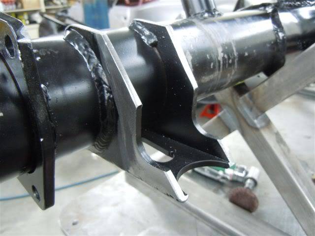

      pocket mods

      It's fabrication like this that brings a smile to my face. Damn good work!
