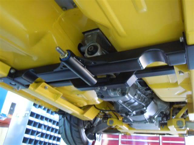

      I'm a little confused why you had to cut the LCA mounts off and weld on the other mounts?
      I have a JRS setup and am using Del-Spheres (my JRS housing has 1.8" to fit the LCA ends, and Del-Spheres are 1.5" wide).
      I just made stepped spacers that reduces the thru hole for a 5/8" bolt (the Del-Spheres have a 3/4" thru hole).

      If I remember correctly we ran out of room for the del-spheres clearance and the shock mount bolts. Decided to go with the heavier bolts and it made the bracket a little thin when widening the hole.
