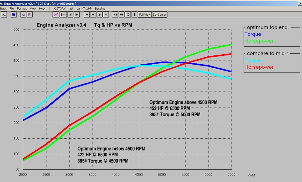

      Okie Dokie … here are two combinations.
      Both are based on:
      327 bored .030” to 331 CID
      10-1 compression with flat top pistons
      Quality internals
      Heads for both combinations:
      Dart Pro1 200 Aluminum Heads - 64cc +/- (to start)
      2.02 Intake & 1.60 Exhaust valves
      Cometic Head gasket 4.060”’ x .030” (6cc)
      If piston has .030 clearance to deck, that’s 7.3cc (adjust accordingly)
      If pistons have 1 “eyebrow” (reliefs for 2 valves) that’s around 4cc
      You need 75.5cc total, counting the chamber, gasket & piston-to-deck-clearance. So you will need to remove about 6cc from the head chambers, with a modest milling, before you install them.
      Roller Rockers: 1.5 Ratio – Recommend Comp Cams Ultra-Pro Magnum or Crower Stainless Steel rockers.
      Combination #1 – Awesome Street Package
      422HP @ 6500 RPM
      385# Torque @ 4500 RPM
      Cam: Comp Cams XR288HR (Hydraulic Roller)
      Intake: Edelbrock RPM Performer Airgap
      Carb: Holley 750cfm Carb
      Headers: 1-5/8” stepping up to 1-3/4” tube diameter & 32-34” length
      Combination #2 – Awesome Track Package
      452HP @ 6500 RPM
      395# Torque @ 5000 RPM
      Cam: Comp Cams XR294HR (Hydraulic Roller)
      Intake: Edelbrock Victor Jr.
      Headers: 1-3/4” stepping up to 1-7/8” tube diameter & 32-34” length
      Here is a computer generated dyno sheet of the two combinations compared to each other. The power curve tells an engine’s personality & the differences show here on each side of 4500 rpm.
      The Combination #1 will make a better Street Package, building impressive torque … especially for a short stroke 327 … from 2000 to 4500 rpm where you’ll spend most of your time on the street.
      The Combination #2 will make a better Track Package, reducing low end torque some to aid traction on corner exits & building more power from 4500 to 6500 where you’ll spend most of your time on the track.
      But neither is far from the other. These two packages are close & the torque curve will be real driver friendly in either one. You’re just deciding where you want to give some & gain some.
      If anyone has any questions, feel free to chime in on this thread.
      Ron Sutton
