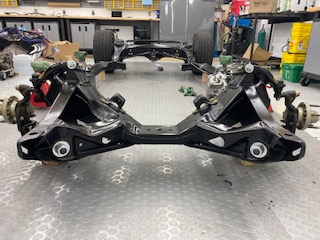

      Found this rattling around my front cross member.

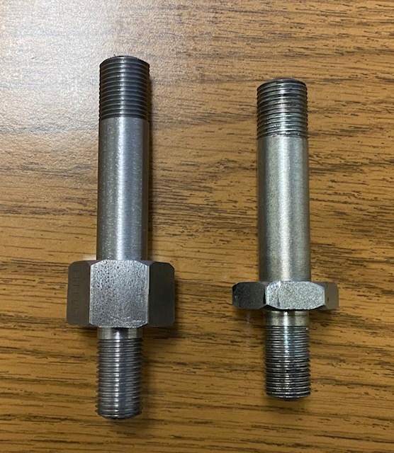

      935

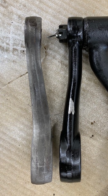

      Dealing with the curse of my own industry on the steering geometry. I snagged an OE pitman arm on Ebay the other day to see if it was the same as my new one... Close, but not quite and it explains some of the asymmetry I'm seeing in the steering linkage. The new arm is black and the OE one is bare. They are both oriented in the same direction, not 180 degrees apart.

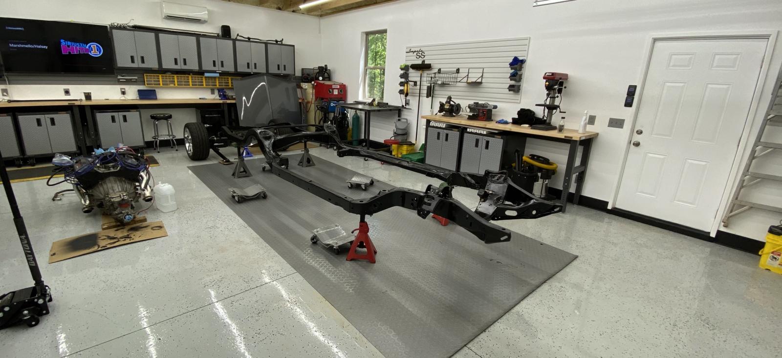

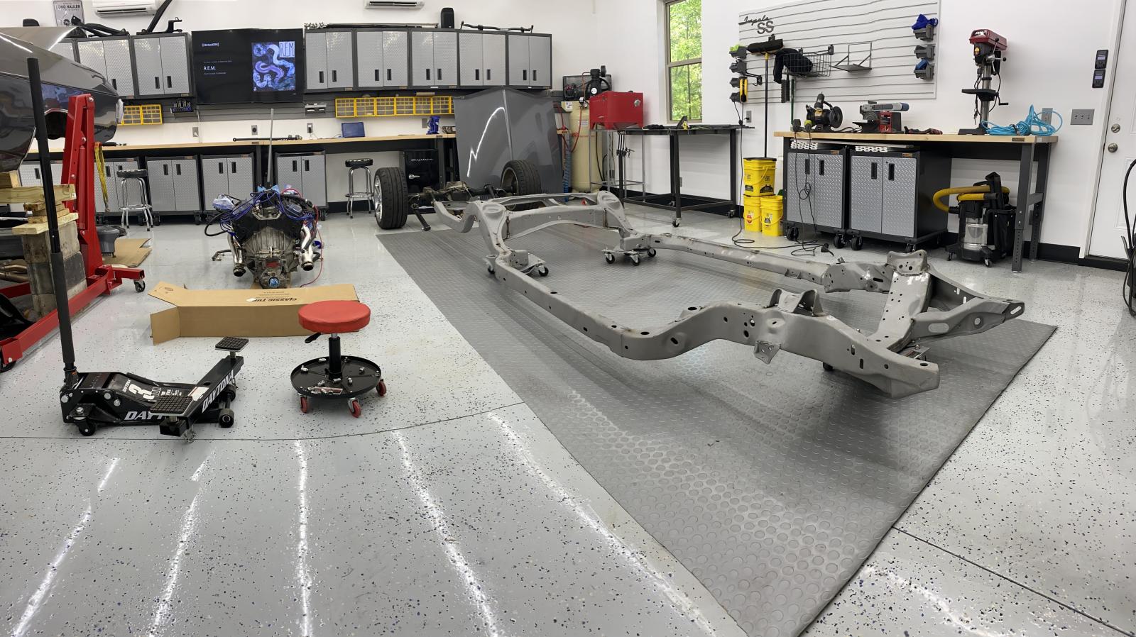

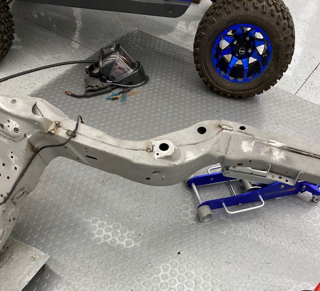

      Progress continues... The sandblaster was fleet service for a trucking company so still open for business. He turned my frame around in 2 days. Now I've got something to keep me busy for a while.
      Only one spot that looks like it needs repair. The front right body mount bracket looks like it had some corrosion and is thinner than I'd like to see. Will patch that in and then on to paint.

      Mundane repair for a lot of you guys but my favorite so far. Right side body mount was too thin for my liking plus somewhat deformed, possible from sandblasting. 1-1/4" washers had the correct ID so I grafted it in place of the old metal. I didn't notice it until after several days worth of frame walk-arounds.

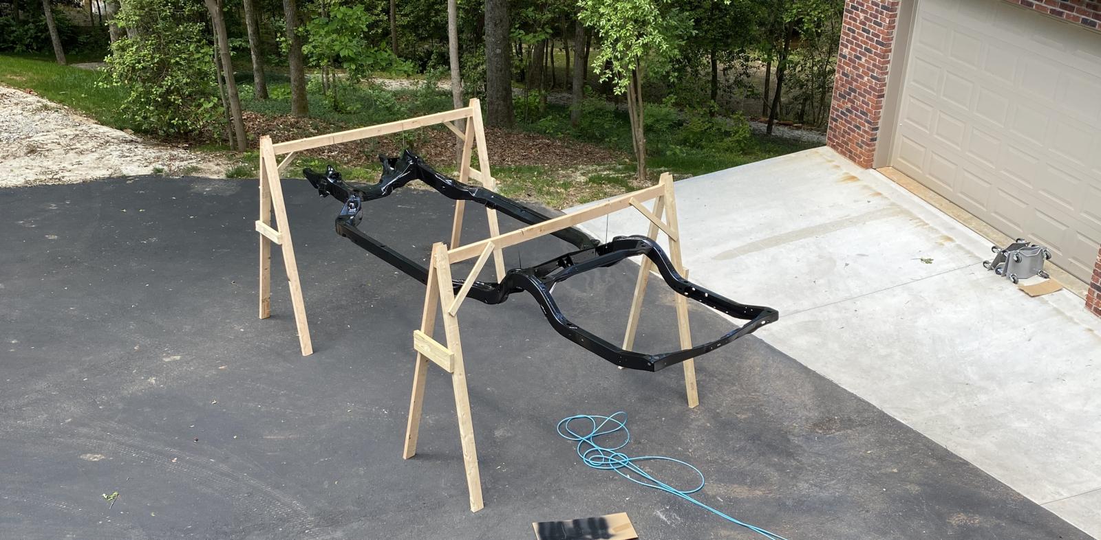

      Progress continues in spite of the world being on hold. This was the biggest paint job I've ever done by far and my arms were ready to drop on the 3rd coat. I used SPI epoxy for everything I could get a line of sight to but what is conventionally used for inside the frame rails? The only product that seems to be out there is Eastwood internal frame coating.

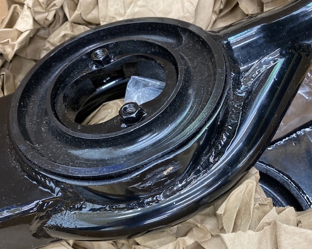

      The hits just keep on coming. My *new* control arms showed up like this:
      No idea how long it's going to take to get another one since they're currently out of stock.

      16,129
      Who's control arms are those?
    16. #136
      Feb 2013
      South Carolina
      935
      They are Global West. I looked at the US made options out there and they seemed like a better fit for a street car that I already have expensive shocks for.

      That would be a noise to drive you crazy :D

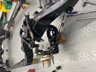

      Front end is starting to come together. Global West was closed so I'm waiting on their lower control arms. Bought my first "mock up" parts to fill in until they get here. Everybody seems to have the GW copies so I picked up a set until the real ones make it out of the factory.

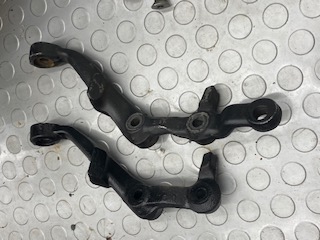

      I bought a set of drum brake steering arms to get rid of the additional caliper mount point on the disc brake version - I just didn't want the extra metal stick out there. Found a difference between the saddle clearance on the castings.
      For whatever reason, there's more material on the drum brake steering arms and it interfered with the cheap tubular control arms. Ground off some of my paint prep and epoxy to get them to turn. It may not be an issue with the GW version, but this is pre-assembly.
      Also found my center link has it's symmetry back. The aftermarket pittman arm is the wrong offset height. Found an NOS replacement and I think it won't take any other tweaks.
      Everything is just finger tight at the moment.
      I was (and still am) on the fence about the GW strut rods. I get they don't deflect but am waiting to see what ride quality feels like. All of the squish is gone from the steering now.

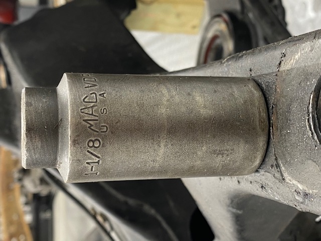

      Pretty much done today. My 1-1/8" socket came in so I can torque those giant nuts on the strut rods. Have a long list of new hardware to order as well.
