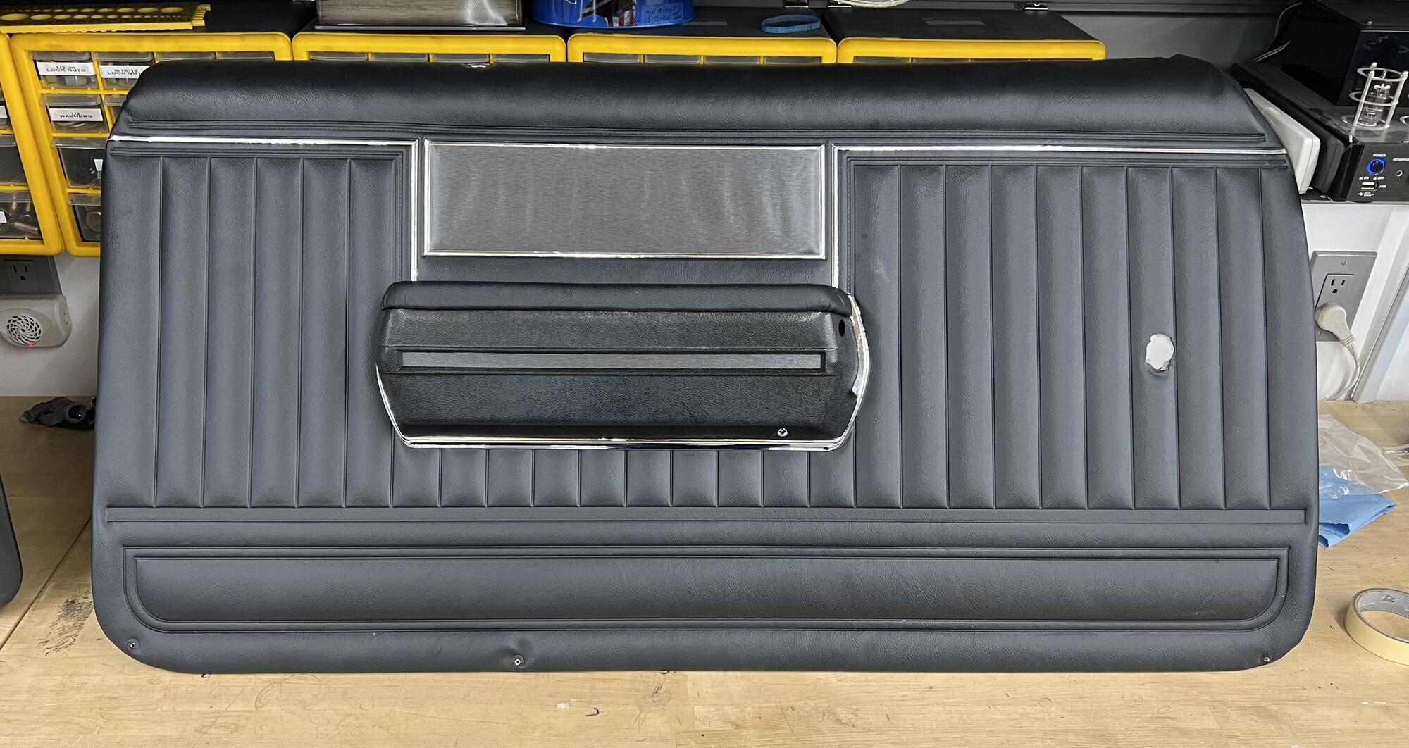

      Finally got it together to try my hand at upholstery. Something to do while in the paint jail.
      One down, 5 more to go.

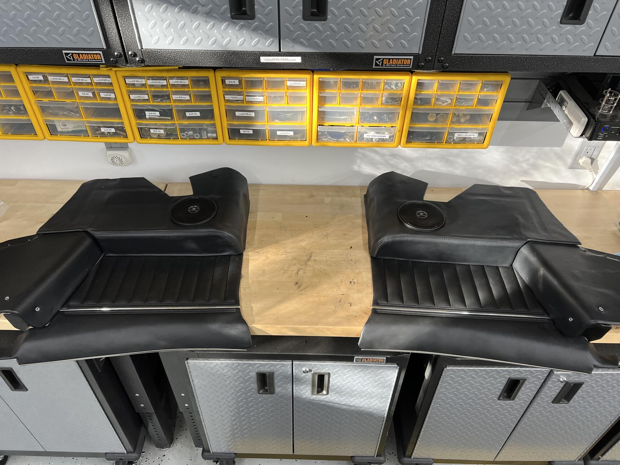

      Took forever to figure out room for rear speakers. The last "restoration" somebody put 6x9's back there and they were hitting the top mechanism when it lowered. I decided to delete the ashtrays to make space.
      First and probably last effort at upholstery on this car. Everything else will need stitch work.
      Happy overall and learned a few things. I had to weld in a flat plate for the speakers and I thought the foam underneath was enough to hide the seam. Not quite and there’s a ghost of a square there but it’s something I can live with. Used a 1/8” closed cell foam on the armrest panels and they have a really good feel to them so there’s that.
      Dropped off the gas tank at the paint shop and we’re waiting on quarter panels.

      Finished one rear side panel and like everything else this weekend I ran out of mass loaded vinyl to finish.

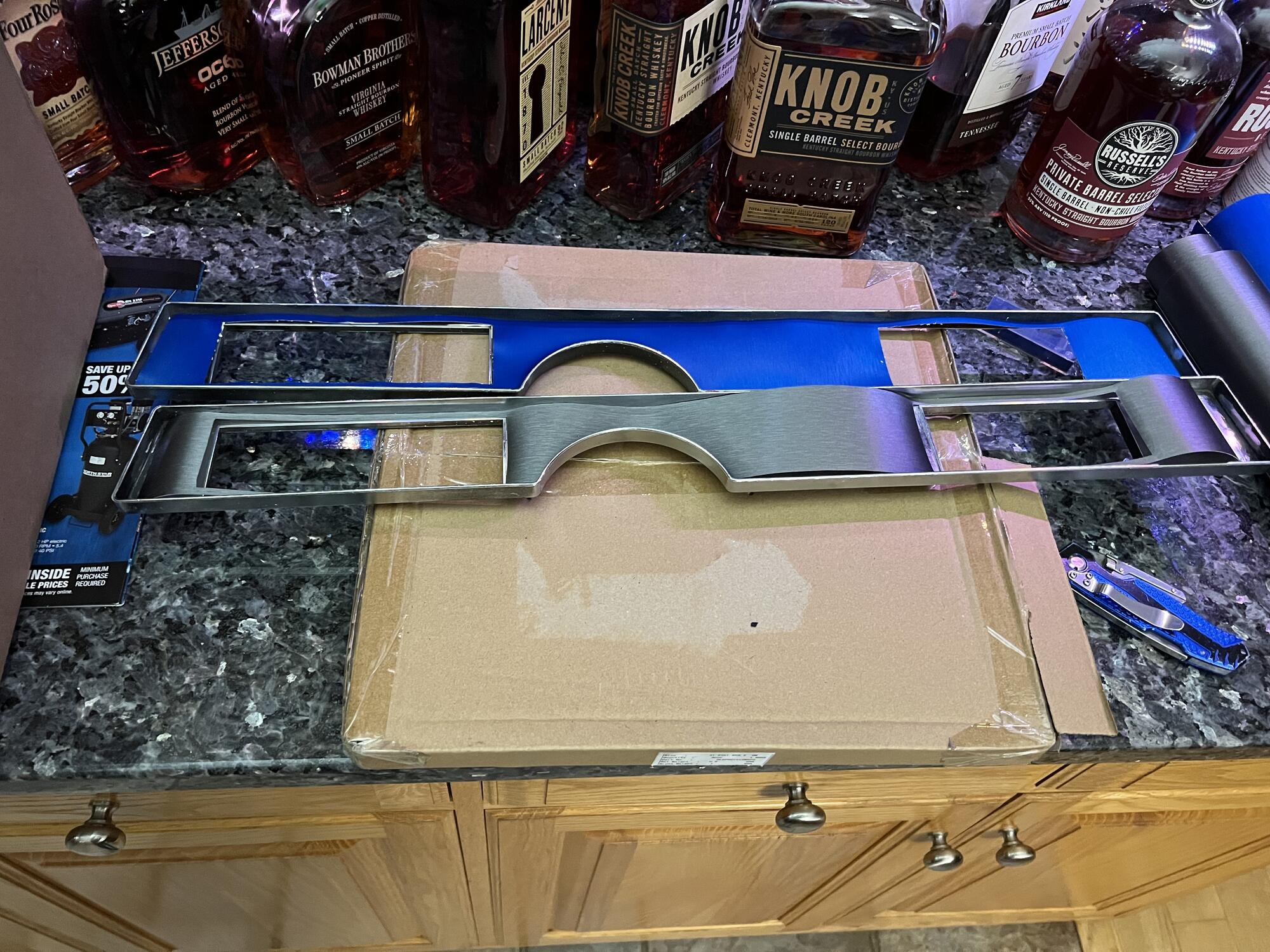

      I was thinking about color inserts for the interior but no, just no.

      Going with a conservative insert. No more wood grain.

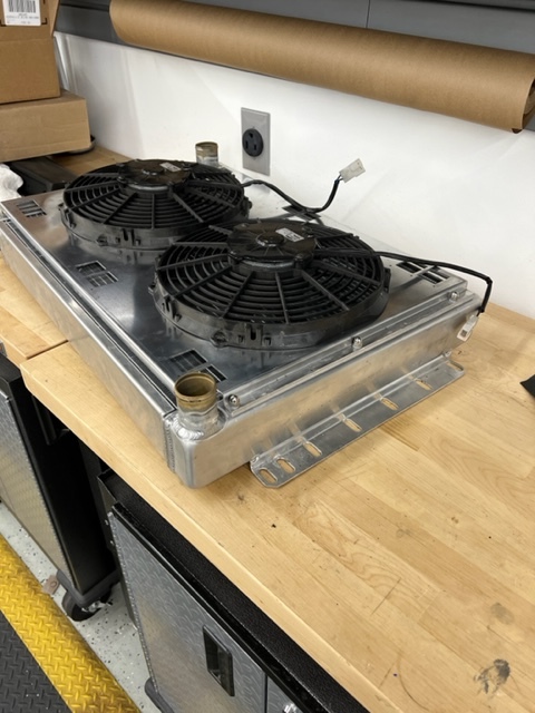

      I finally got around to solving an old mistake with the fan shroud. I ordered the wrong one and didn't have a good solution for mounting it. I had some short term sheet metal brackets that bolted up with the radiator mounting bolts but I was never happy with it. It was a pain to install with the radiator and just not what I wanted short of coming up with another shroud. I finished the hardware this weekend and will have to get a real welder to TIG the brackets in place but I can live with it.
      1/4" aluminum stock with #10-32 threaded studs, high vibration Nordlock washers and acorn nuts. I'll seal the top and bottom gaps with automotive weatherstrip similar to some OE shrouds I've worked on in the past and call it done. I maybe would have preferred 1/4-20 fasteners but I wanted more thread engagement and the shroud was already slotted for #10 fasteners.

      Secondly... I'm leaning heavily towards electric fans as well. I've already got the Sniper EFI to control a 2 stage / 2 fan set up, and it makes better sense in my head since one of my use cases for my 68 is a daily driver. When I have to run up to the office there is a very strong chance I'll get stuck in traffic. Beyond that, is there any truth to the idea that you save a couple horsepower from not running a mechanical fan off the pump, or is that a wives tale?
      Thirdly... I just had to hop over here and follow this build officially, since I was clicking on the link over in Impala-ville so often.
    20. #240
      Feb 2013
      South Carolina
      935
      Thanks. Waiting for paint is torture. 3 month hold up waiting on rear quarter panels which will hopefully end soon.
      I just ordered the Holley BBC EFI intake in anticipation of installing a Terminator X Max kit but "ship date coming soon!" is the current status of that part.
      Mechanical fans use HP but so does the alternator when it's generating electricity for the electric fans. It's probably ever so slightly more efficient to run electric fans but you will find about the same level of debate on that as a "which oil to use thread." Everything I've ever driven with the exception of my 1st and 2nd car (69 Camaro and 73 LeSabre coupe) have used electric fans and FI so I've really just stuck with what I know.
