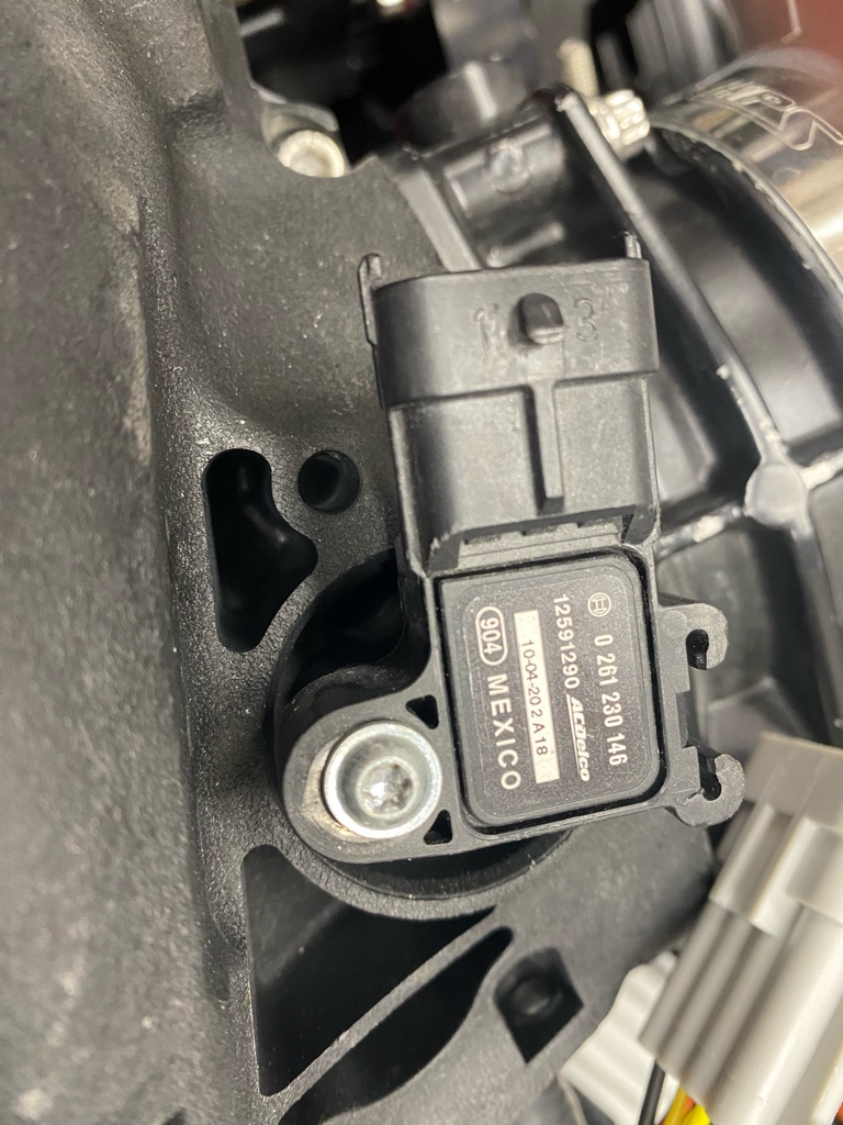

      Can you guys help me identify the style of connector I need for these plugs? The first is my MAP sensor. I need a plug for this one.

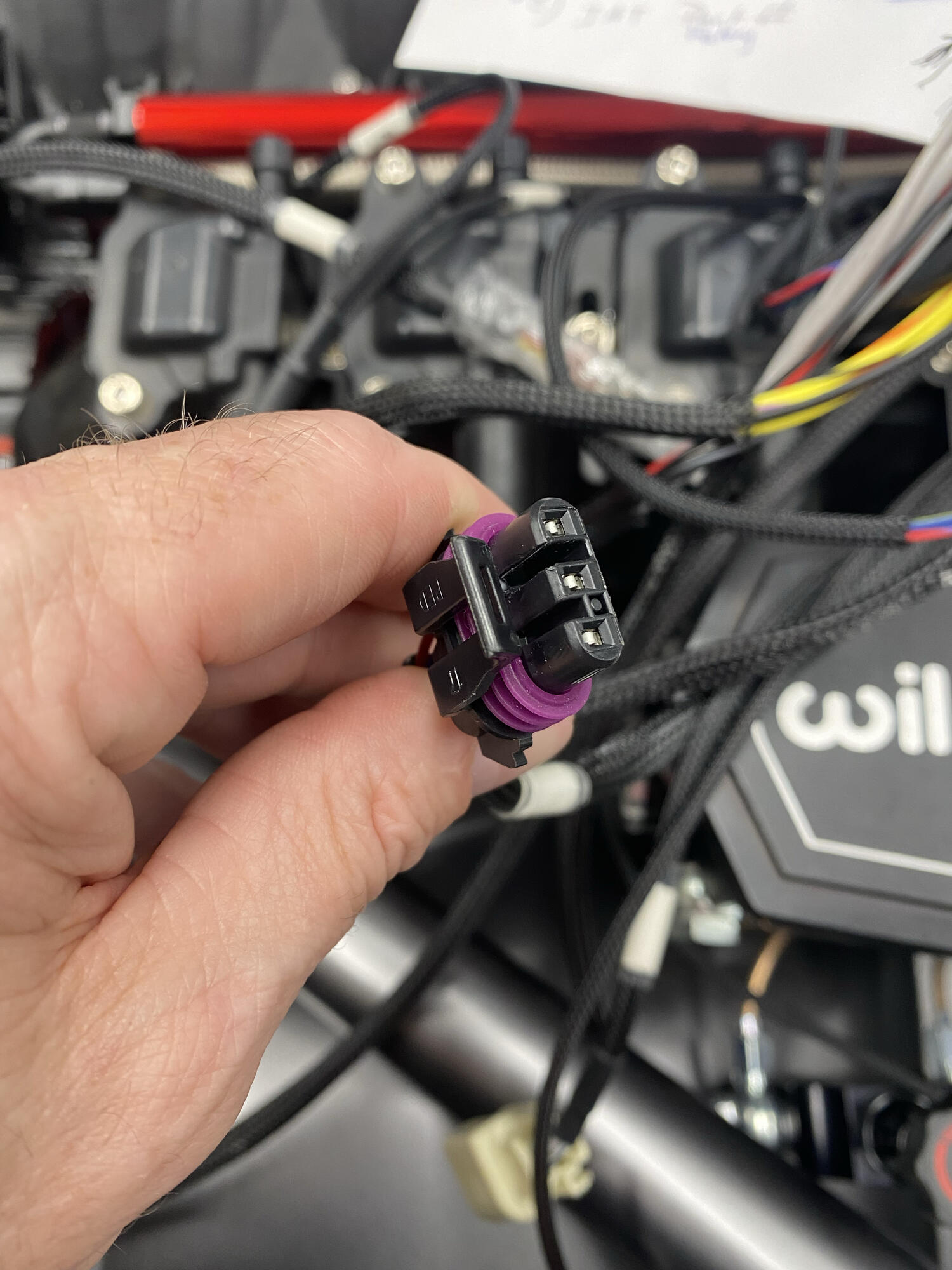

      This one is for my fuel pump plug. I need pins and the male plug for this one. Basically the other side of it.

      The Haltech ECU uses the same Tyco connectors as the Holley ECUs. TE Connectivity offer the correct crimpers. If the harness is laid out well in the engine bay, the easiest way to shorten the harness is at the ECU. I've taken the basic and club level wiring courses and they have been helpful.
      Crank and cam are metripack 150.
      Knock sensor is Metripack 150 GT
      O2 is a Deutsch connector DT
      Next one is Metripack 150 pull to seat
      MAP sensor I think is Molex...I'm not 100% on that
      It's got a Bosch PN on the sensor, looks like a BSK.
