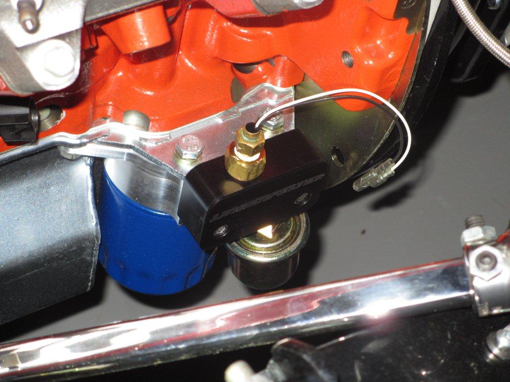

      With the headers removed for welding, it made the installation of the Lingenfelter oil pressure adapter a cinch.
      Some people should not be allowed near a project with power tools; I am one of them. This is pretty much how the fuse panel opening looked before I got to it (although you can see that I'm already beginning to butcher it slightly)

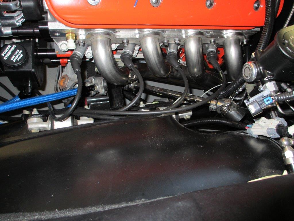

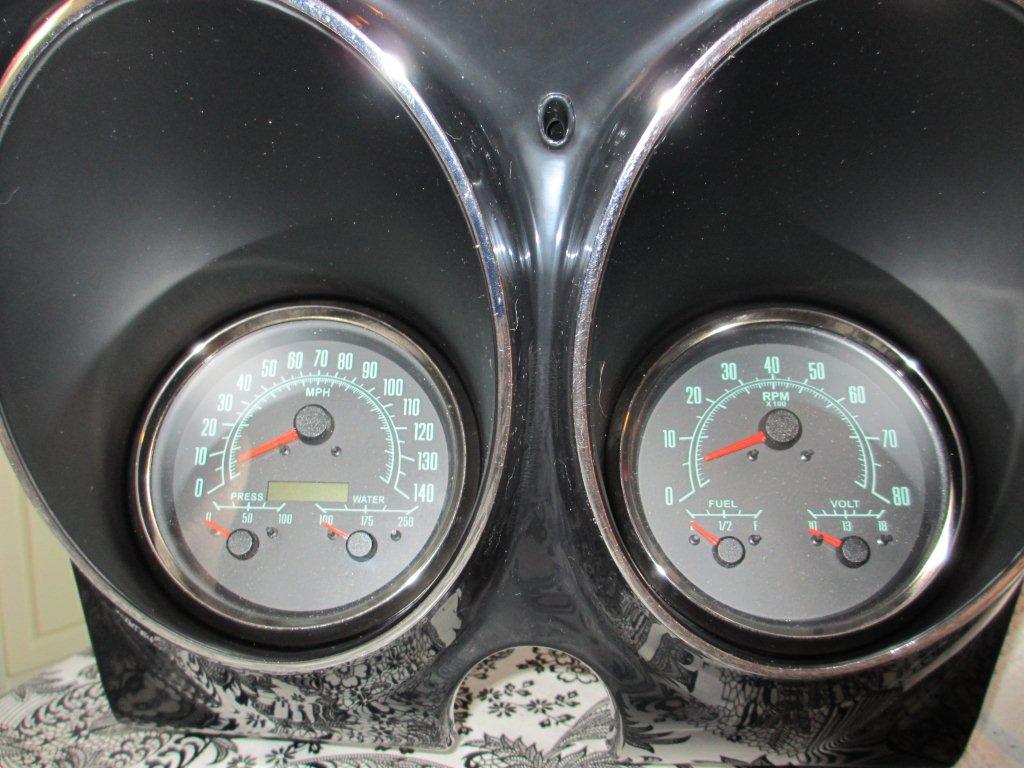

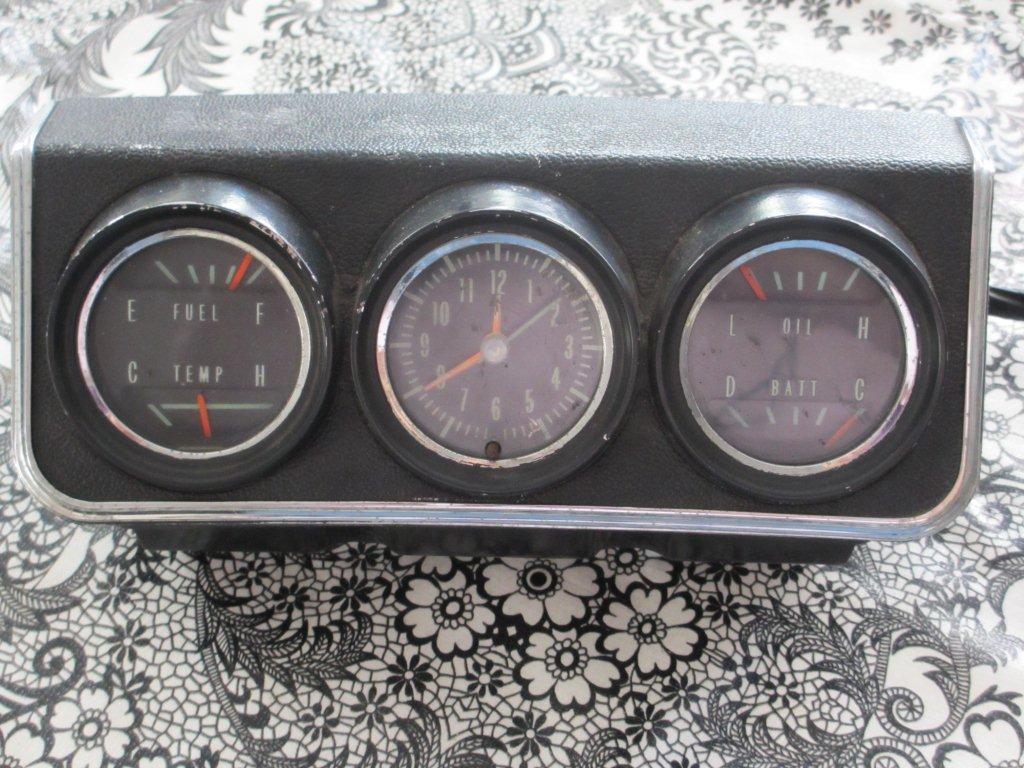

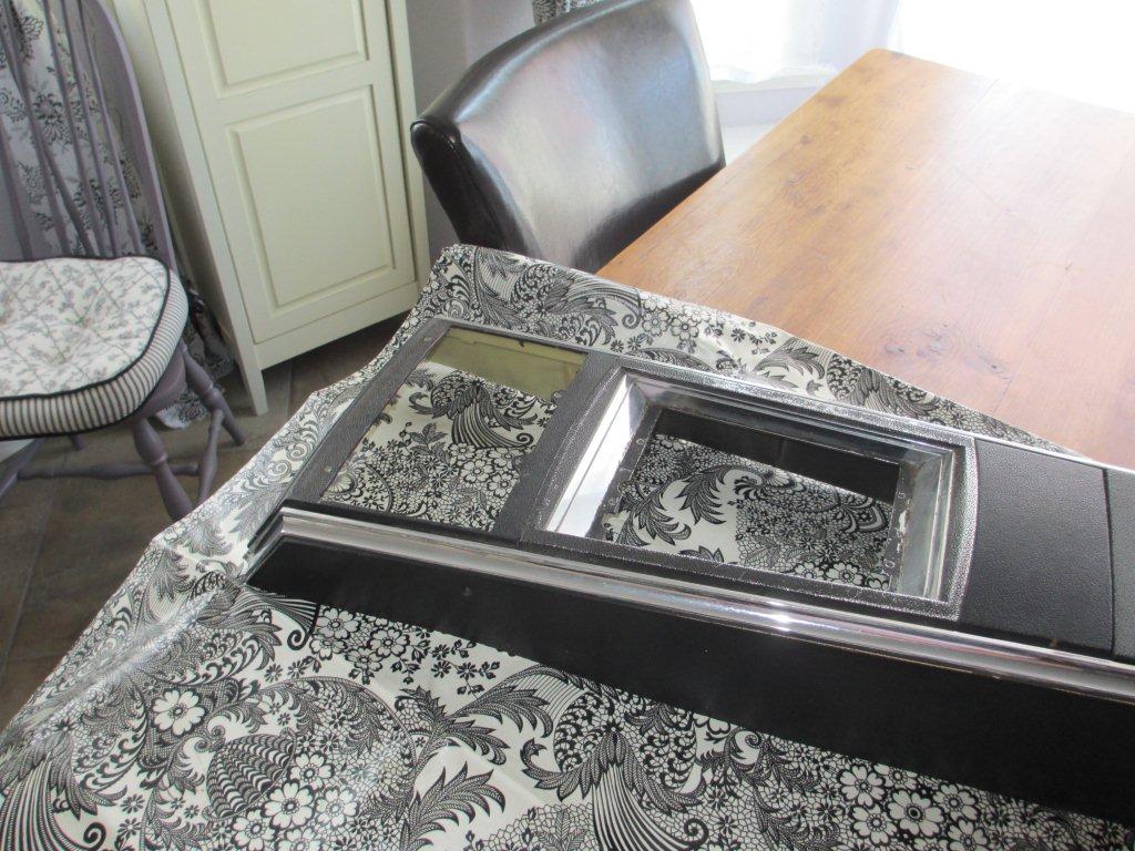

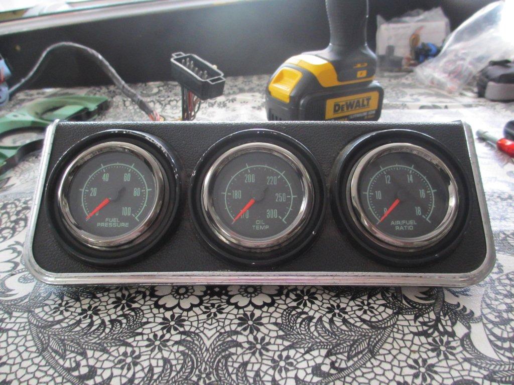

      One could make an argument that gauges are critical to engine fire-up, so I went to town installing a full set of New Vintage gauges. Since the speedo and tach now incorporate the gauges that were in the console, that makes room for new gauges down there...

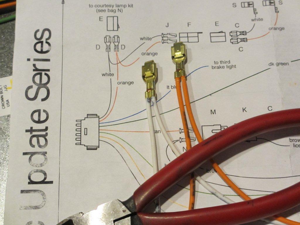

      They say that the journey of a thousand miles (of wire) begins with the first crimp. Well, here it is:
      After re-doing this at least three times, finally got to the point where I felt that the rear harness wiring was "good enough." The installation of the fuse panel was precipitating by the installation of the rear harness which was needed to be able to run the control wire to the vaporworx controller that will be in the trunk; I wasn't sure where the actual connection was made to the rear body harness so all of this needed to go in so that I could be certain that I had left myself enough slack.

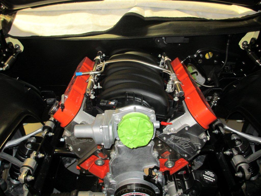

      Turning attention to the engine bay, we were able to get quite a bit accomplished over the weekend. Project #2 for Brent was the installation of the DSE Wiper Motor, and it took a cooperative effort from all of us to transition to the Ring Brothers billet reservoir for the clutch M/C. Also, although you cannot see it, the much belly-ached-about fuel and brake hardlines are installed, if not exactly in place yet...

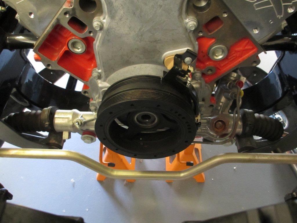

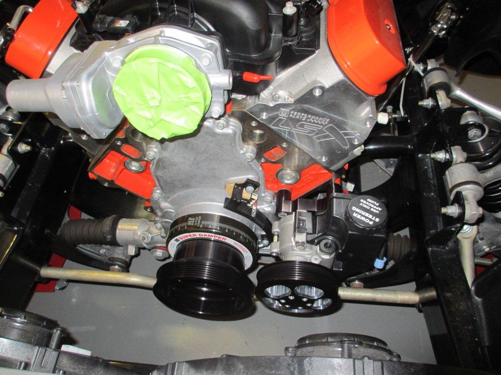

      Here's what we started with from GM regarding the crankshaft pulley
      Here's where we ended up with the beginning of the installation of the Wegner system!

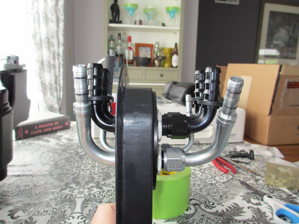

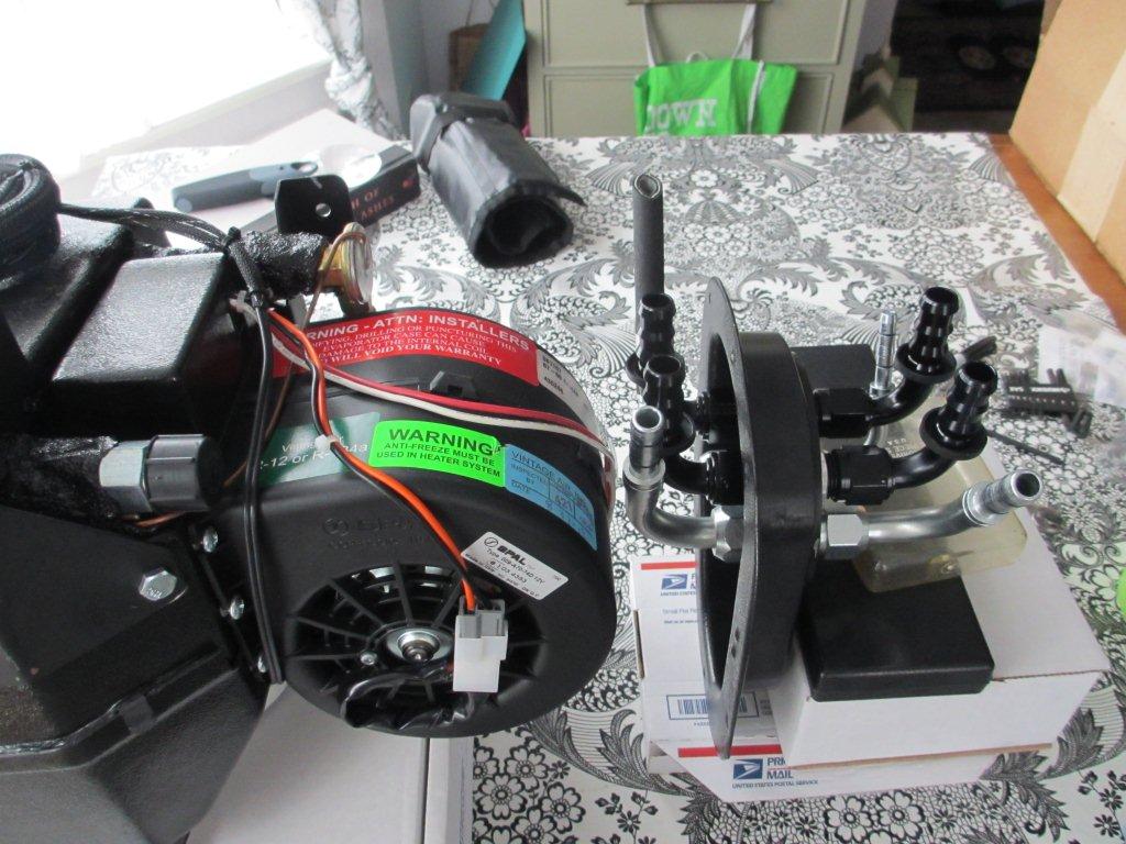

      On Sunday, after Doug and Brent departed, my brother and I unboxed the Vintage Air equipment for the first time in many, many months. If you've followed the thread, you might remember that while the Camaro was off at the body spa in Florida, I helped him to install a Vintage Air in the 66 Corvette, so he had been champing at the bit to put some of our newfound wisdom to work on returning the favor.

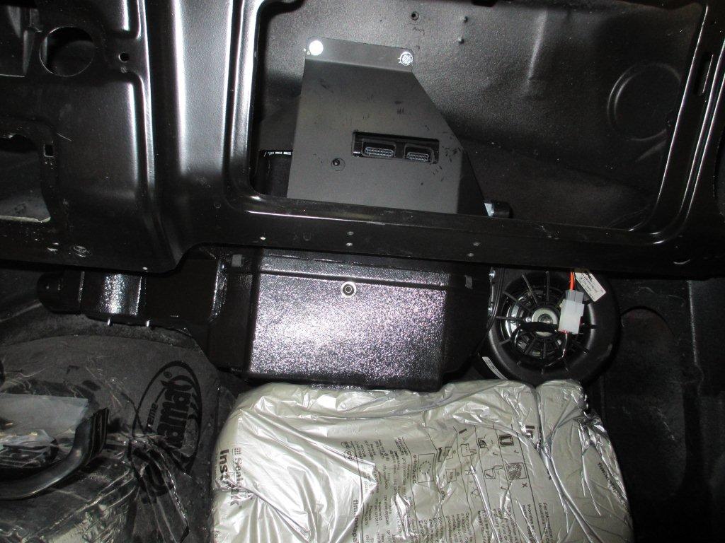

      I also spent some quality time at the workbench and prepared the controls for the GenIV system

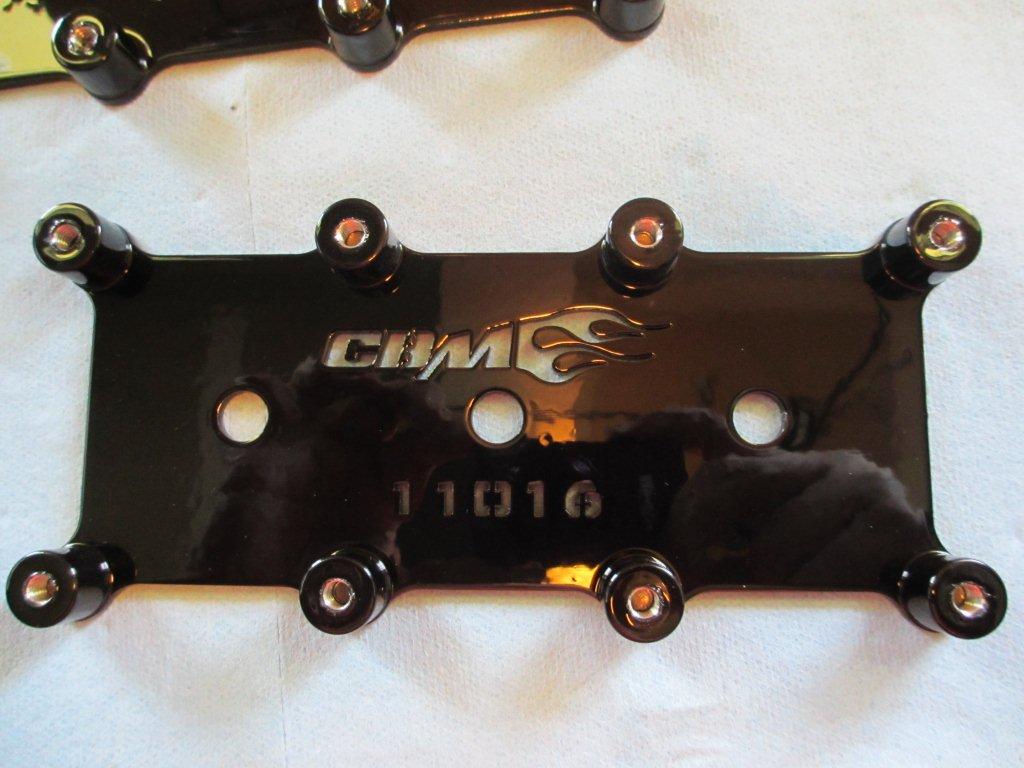

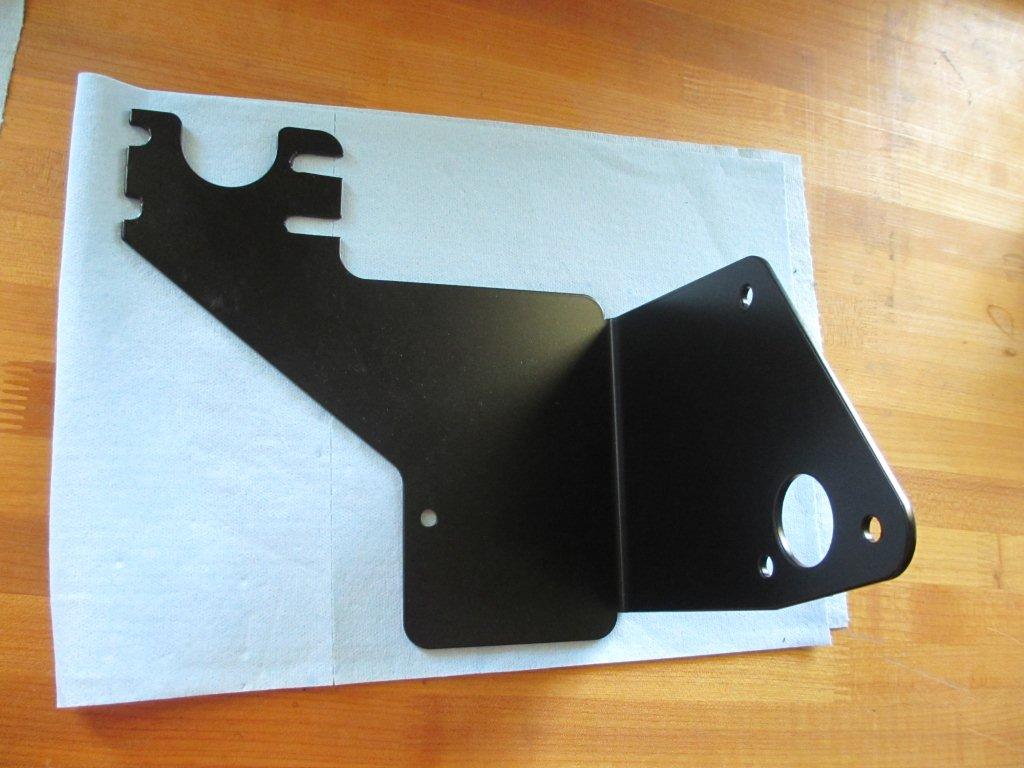

      While I was at the powdercoater, I also dropped off the coil pack brackets, which you also might recognize from an earlier post. I chose gloss black for them, as they will likely end up being mounted to the gloss black subframe; I chose satin black for the Ironworks bracket as I'm just hoping that it disappears up under the dash.

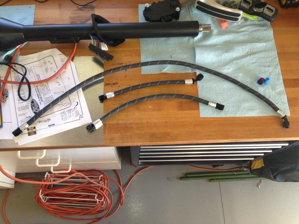

      I have been making slow progress while I can. With the help of my brother, the hydraulic system is now in and buttoned up; at some point, I'll gather up enough gumption to actually put some fluid in (and then look for all of the leaks!). Yesterday I ordered some screws that I need to button up the steering column/pedals/DBW throttle portion, so I will be excited to get that done and get the column back in. The console gauges are wired, as is the instrument cluster, and I've put together a harness to run all of the things that will get their power and signal from the bulkhead connector; I'll trim it to length and install it once I'm a little further along with the wiring and dash. Hopefully will be able to take a day off of work towards the end of the year when my brother is here and begin to wrestle with heater and A/C hoses, as well as trying to find a home for the A/C dryer, the coolant overflow tank, and the Norris PCV catch can, all of the while leaving room for the Rally Sport headlight doors to open. Should be "fun."
      Another task that I was semi-terrified of was making up the PTFE-lined hoses for the fuel supply and the gas tank vent--it turned out to be very, very easy. Although VERY expensive, I would highly recommend the fittings and hose from Pegasus Racing (I believe Goodridge product?). I went with the black Aramid hose with their black and silver fittings and couldn't be happier with how they turned out.
      Now just need to pester my neighbor who has an air compressor to test and I'll be able to button up the fuel system, too.

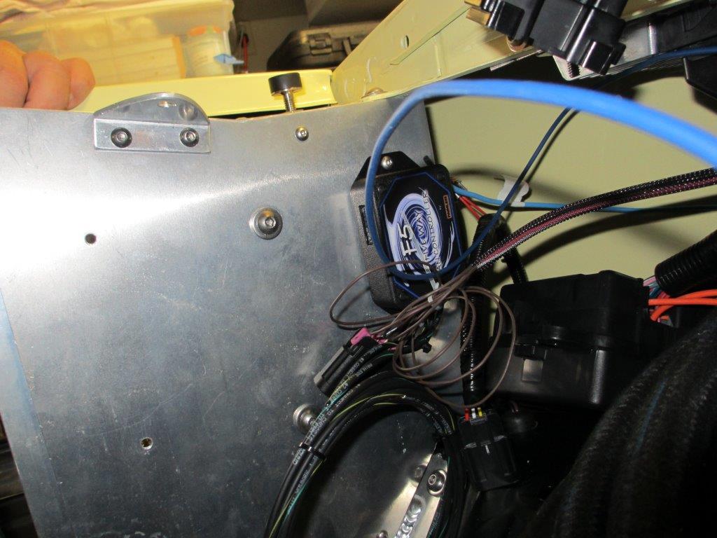

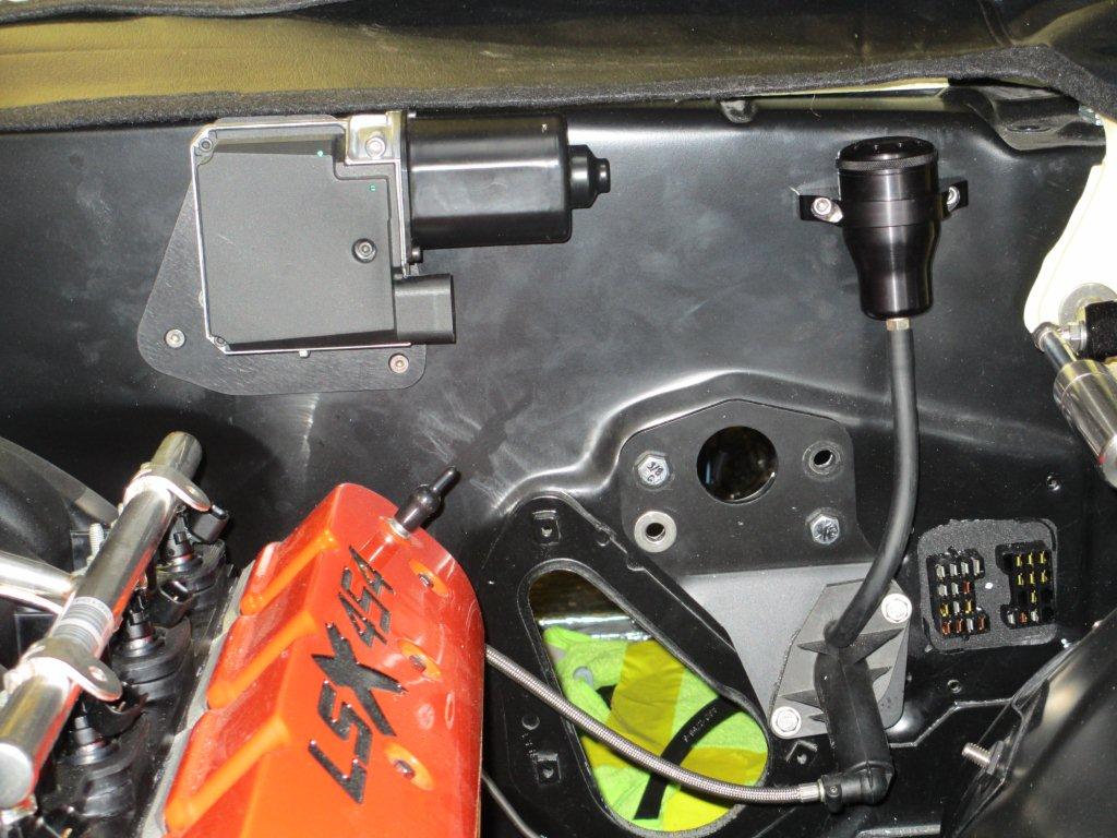

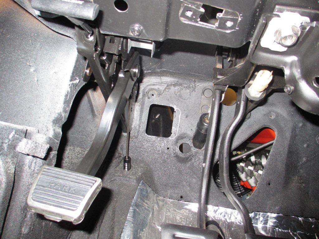

      With the help of my friend Doug a week ago we were able to knock quite a few things off of my list:

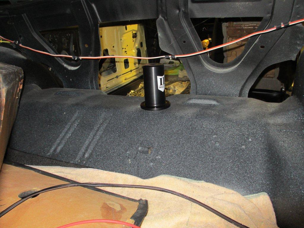

      1. Able to mount up the computer under the right front fender using a Rally Sport Headlamp Door Relay bracket (holds the Rally Sport headlight door relays together usually under the driver's fender)
      2. Drilled a Big A$$ Hole through the firewall for the Speartech grommet for the accelerator pedal and OBDII harness to pass through
      3. Drilled a smaller hole through the passenger footwell for the AAW positive battery cable bulkhead connector to pass through
      4. Drilled a smaller hole still in the same general area for the A/C evaporator drain hose to pass through
      5. Devised an approach for mounting the A/C dryer that ought to hold it securely and relatively "out of the way"
      6. Played with the very cool Fesler fender struts that I had purchased (not taking in to account that I changed out the stock radiator support and sub-frame, etc.) and came up with a pretty easy fix to be able to use them
      7. Still stumped by where to mount my coil packs, but came up with a couple of ideas that could still work (and it helps that Doug has access to metal-working equipment )

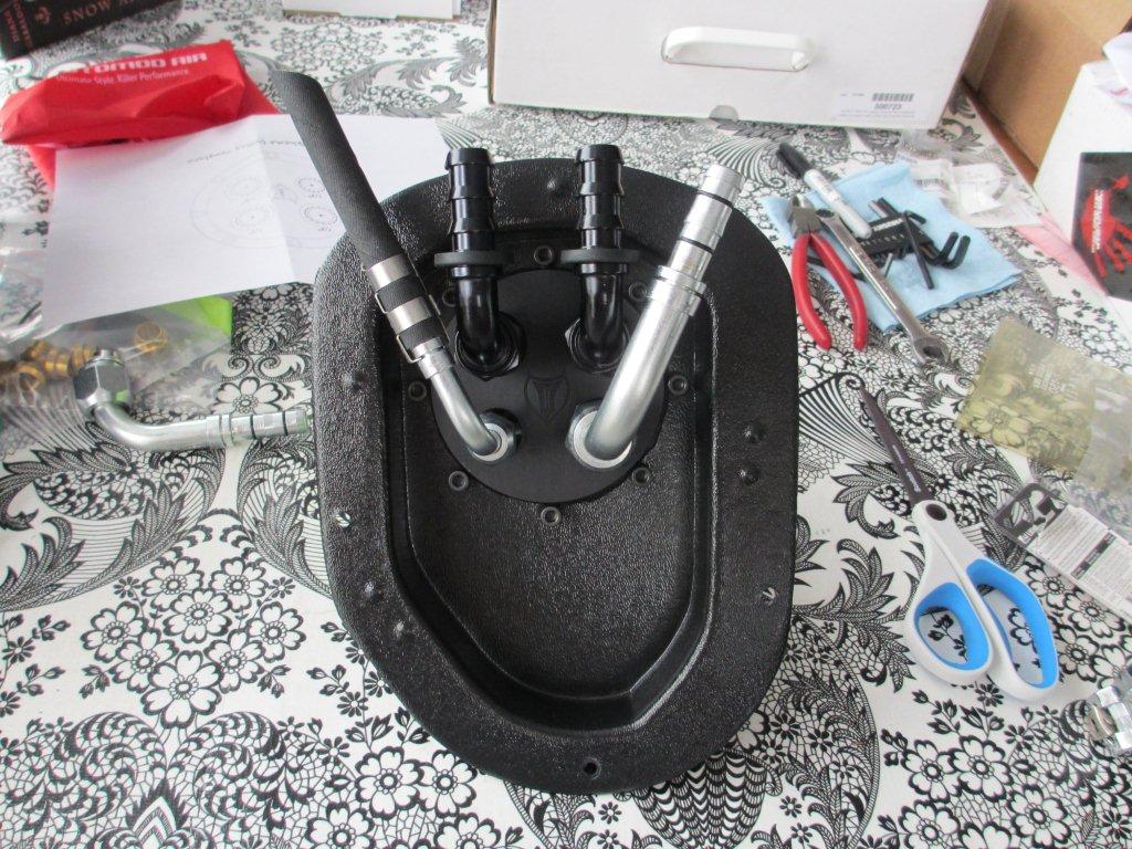

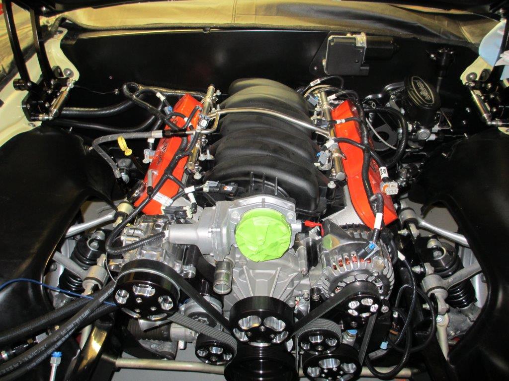

      Although much time has passed, much work has been accomplished. A/C Evaporator is in and plumbed inside the car, positive battery cable is run from the trunk to the bulkhead passthrough on the passenger floor, Braille battery and bracket installed in the trunk, much of the wiring for the vaporworx controller and the remote disconnect is done, working on running the ground cable to the chassis and to the front of the car as well, and the driver's side header is finally reinstalled and the exhaust piping is back to being complete. Also filled the oil filter with oil and bolted it up (hoping that will help with building pressure for initial start up). But I don't have any photos of any of that--haven't actually poked around inside the passenger compartment for a while, letting the spiders have their way with it for a bit until I vacuum them all up. Instead I've been trying to put a dent into the engine compartment.

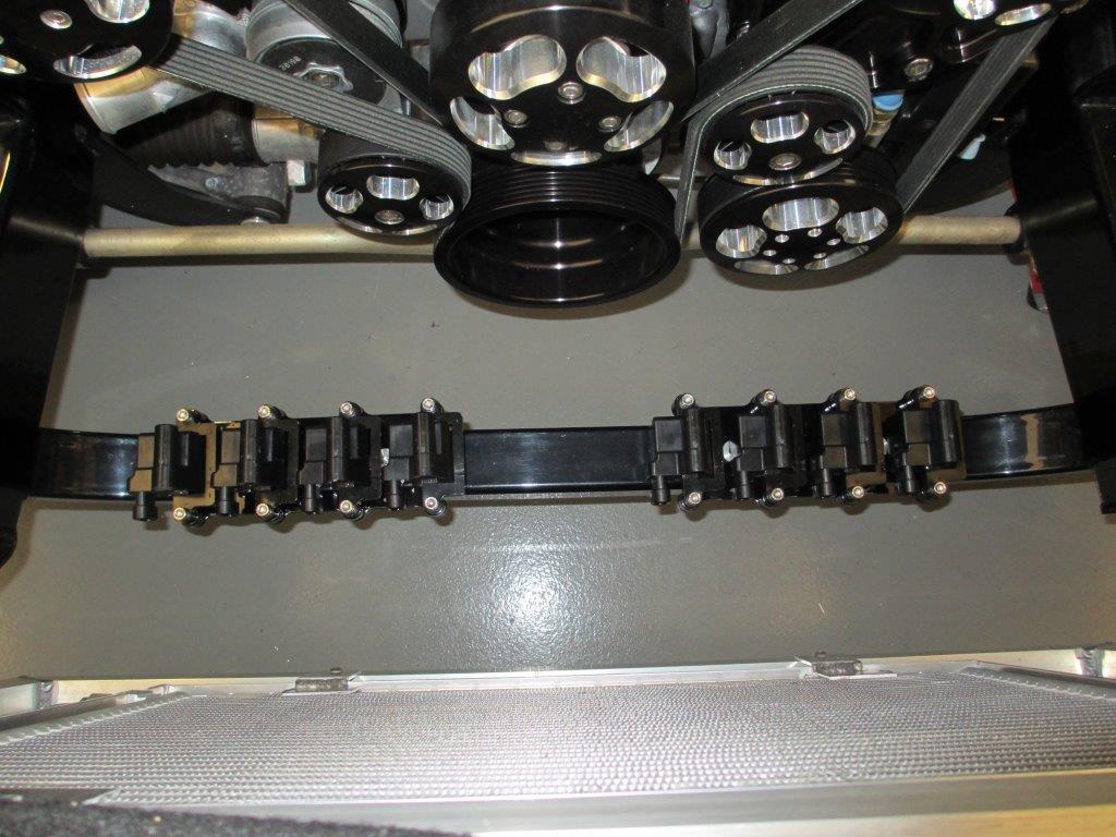

      Finally figured out where to put the coils and how to mount them. Ordered some neat hardware from McMaster-Carr, had a local machinist touch it up so that it all fit, and my brother and I went to town with the drill making holes in a crossmember of the Art Morrison sub-frame.
      Aesthetics sure go out the window once you lay the GM EFI harness under the hood. In is a tight fit to be able to connect to the computer under the fender and still be able to get on to the #8 injector, among other indignities. I have nothing but respect for the people that have the time and patience to wire these things up without actually showing any wires!

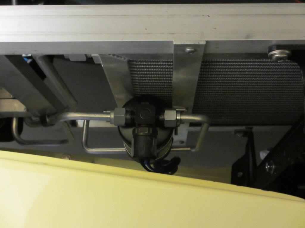

      Had to get creative on how to mount and pipe the A/C drier, as none of the custom tube places could bend up hardlines to my spec, so I had to go with the stock Vintage Air pipes for a 67 Camaro and tweak them (since I'm not using the VA condenser or the stock radiator support). Thank goodness I was able to make these work without destroying them too badly.

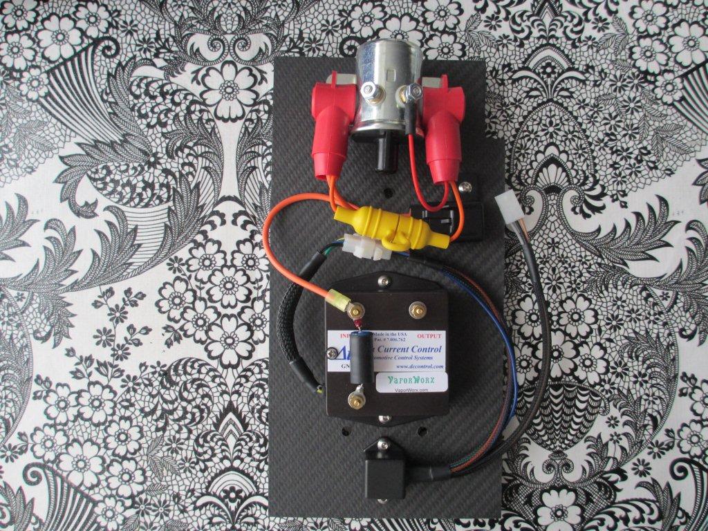

      Found a home for the Painless F5 controller, just need to focus on putting the loom together now.

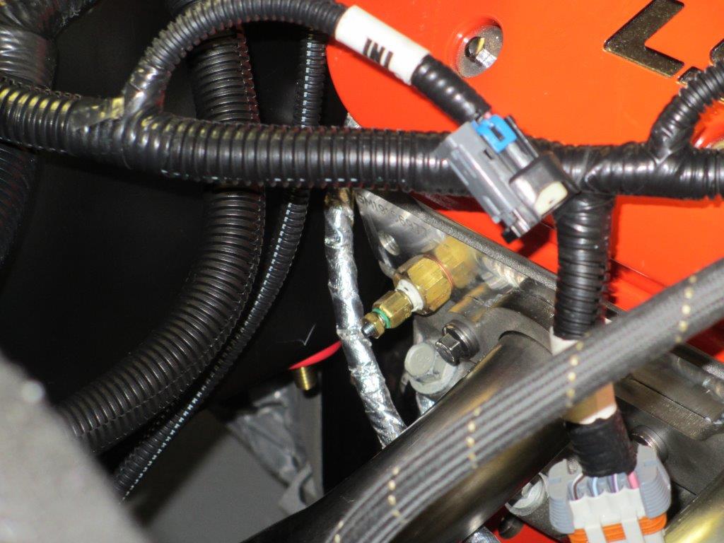

      Installed the 3rd water temp sender under the hood (this one in the passenger head to drive the New Vintage water temp gauge, the stock one in the driver's head to talk to the computer, and the 3rd one in the radiator to drive the F5).

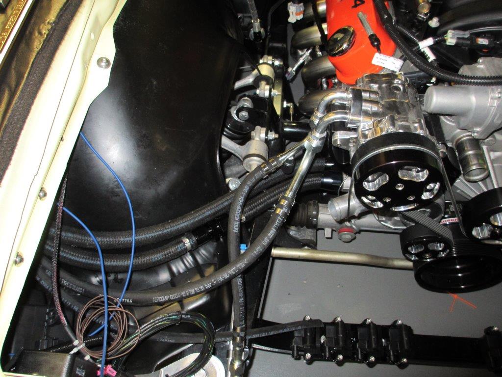

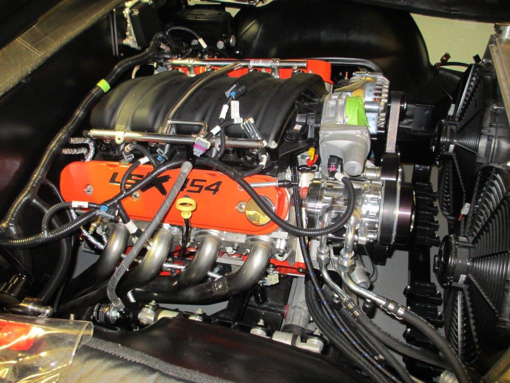

      Power steering hoses done (for the most part--there was no way humanly possible to get those fittings started once that hose was jammed into that hose end, so I cheated and bored out the end of the hose with a drill in order to be able to at least start the threading. Remains to be seen if it will leak or not).

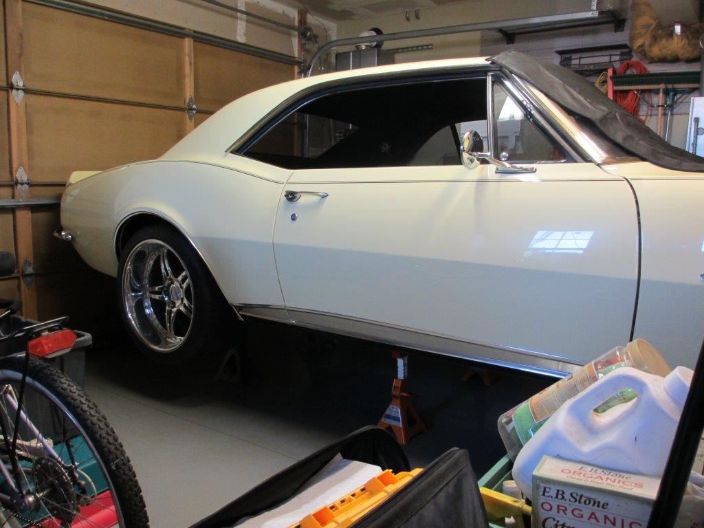

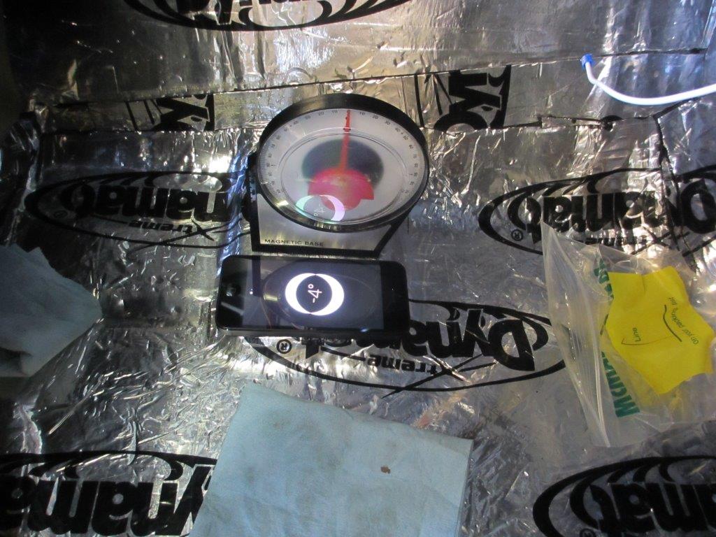

      Trying to get prepped to measure for a driveshaft. With the car resting on all 4 tires, I took some baseline measurements--do you believe the pointer, which is showing damn close to Zero or do you trust the iPhone which is showing 4 degrees? Regardless, I've now jacked the car up on stands, and when I'm ready, I'll support the frame in the front but the rear end in the rear, so that the rear suspension is loaded at ride height but the car actually has enough room to work underneath it. I'll do my best to recreate the same angle/tilt so that accurate driveshaft measurements can be taken.
