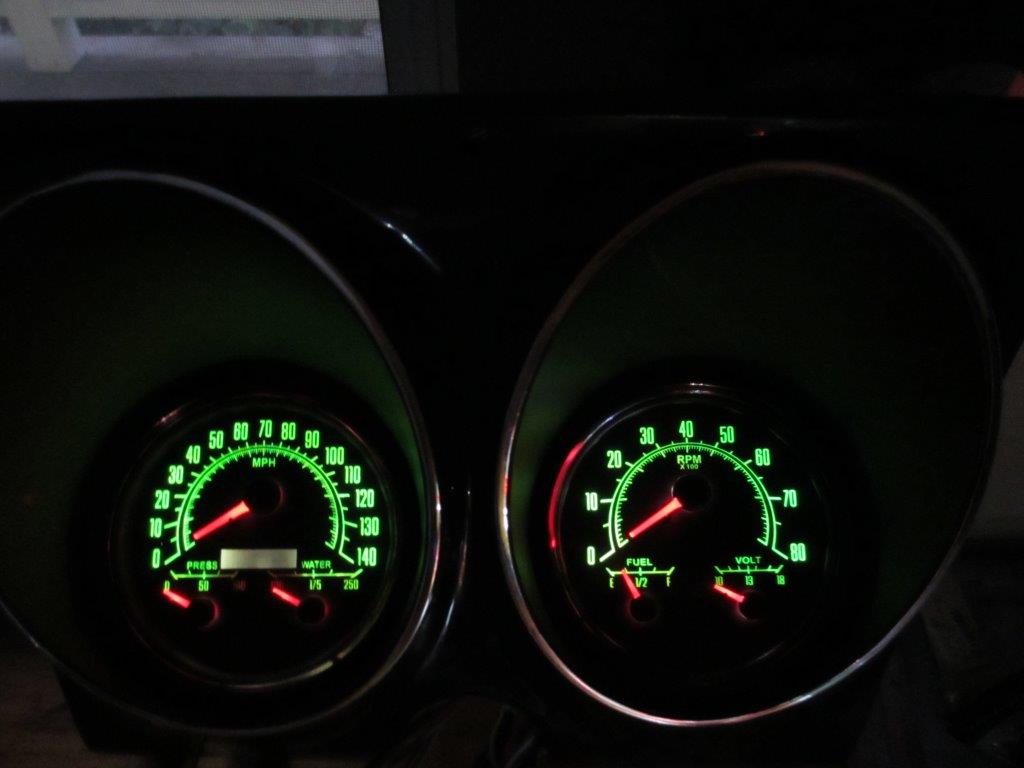

      Played around with the Power Probe a little bit; at least I know that the headlight doors close and the right front parking light and turn signal bulb works, as well as the console ashtray courtesy lamp, in addition to the lighting below :-) My brother is coming down tomorrow to help move along the A/C install and I'm gearing up to try to get some behind-the-dash wiring moving forward, too. And I bought a borescope (inspection camera) at Lowe's today so I might see what there is to see inside the bellhousing and figure out what is banging. And while I'm under there, I'll certainly be sizing up what the scope of dropping the trans is going to be. I don't think it will be that hard, but I think that a low profile trans jack is called for :-).
      (New Vintage USA gauges, BTW)
      Steve

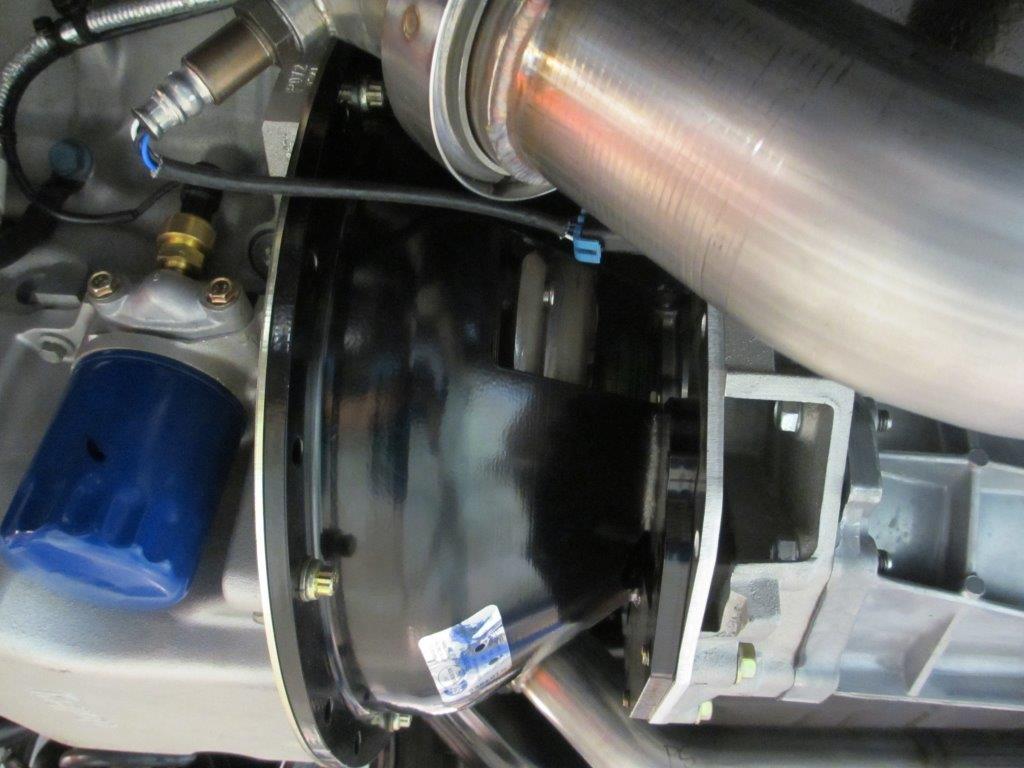

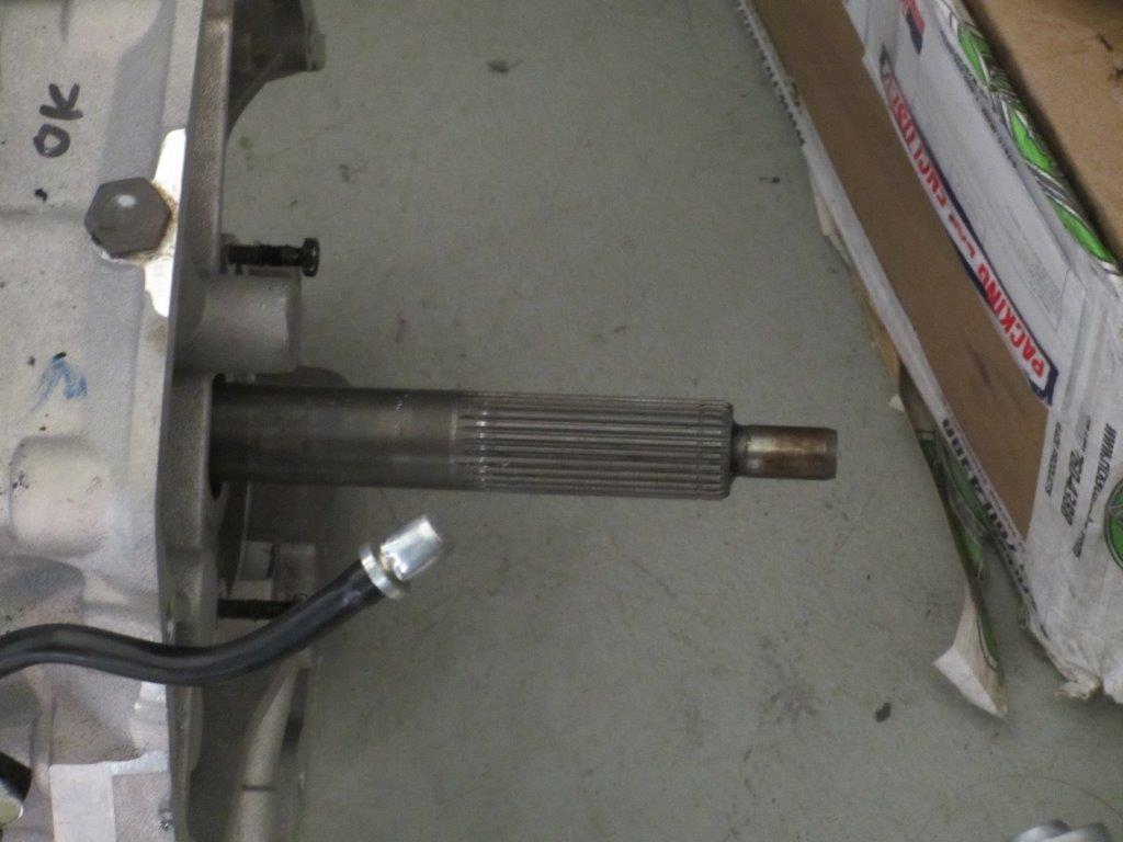

      Well, I had to make some strategic decisions. Do I know how to take out a trans and/or an engine? I think that I do. Do I have the desire, the tools, and the space to do it, on my already painted car? Turns out, I did not. So I reached out to the good folks at East Bay Muscle Cars and asked if they would be willing to take on the forensic disassembly, the repair, and, as long as they have the car, several more tasks that I just wasn't looking forward to accomplishing, and much to my delight, they were. So Steve from EBMC now has my baby and has given it a pretty thorough going-over, and I think that we have a path to get the car moving forward once again on its journey to completion.
      First, the analysis of the banging. Basically, trying to pack 10 lbs of ***** into an 8 lb bellhousing just doesn't work! The banging turned out to be three finger-like structures on the clutch beating the throwout bearing anti-rotation/alignment pin into submission:
      Also, the throwout bearing was so jammed in there the top of it mushroomed out a bit (as you can also see above), but there definitely wasn't the proper clearance between it and the clutch diaphragm. And finally, even with the trans spaced back from the block, the input shaft was jammed into the clutch disc right up to the end of the taper of the splines; you can see the shiny part where it was jammed up against the end:
      So the solution, which luckily for me EBMC had to solve with another customer car as well, is to change out to an LS-to-Viper T56 scattershield, which provides more room in the bellhousing, and a small spacer between the trans case and the scattershield (I believe from American Powertrain). This is the GTO where they solved the issue:
