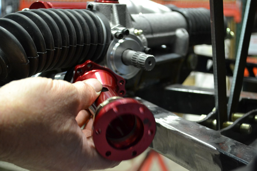

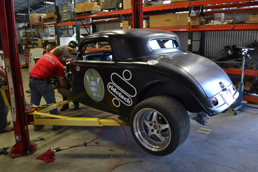

      The steering rack and radiator are back on and it looks like its going to be at Nashville this weekend! And if not we've always got a backup (1969 Silver Mustang)
