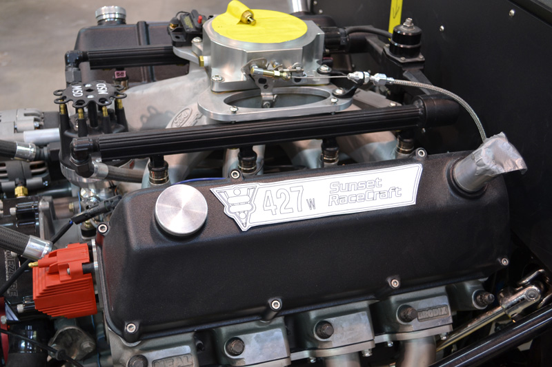

      Engine - 427 cu in small block Ford with a Dart aluminum block and Brodix Neal heads built by Sunset Racecraft in Lubbock, Tx. MSD ignition, Holley Dominator EFI, custom stainless headers, Earls oil cooler, Mezeire electric water pump Approx. 630 hp and 600lb/ft torque

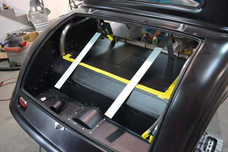

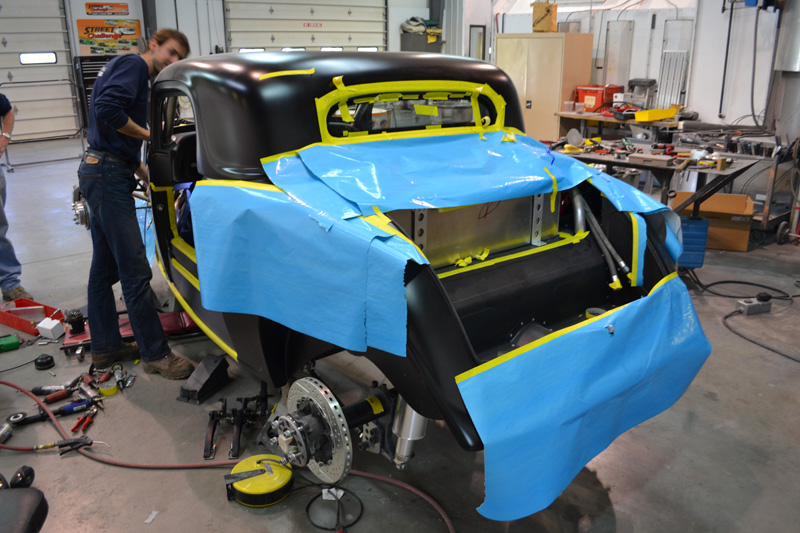

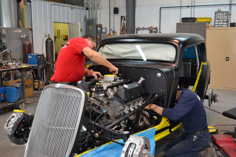

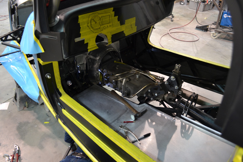

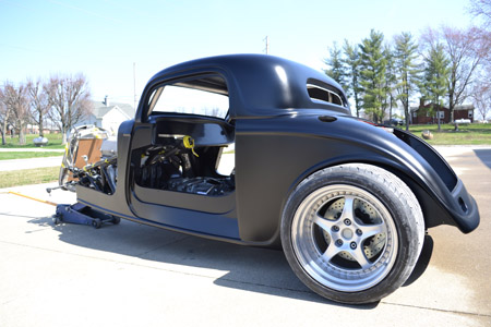

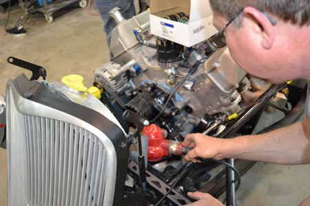

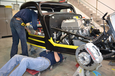

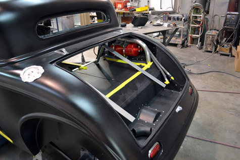

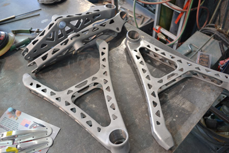

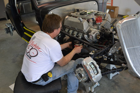

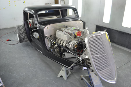

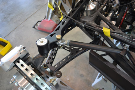

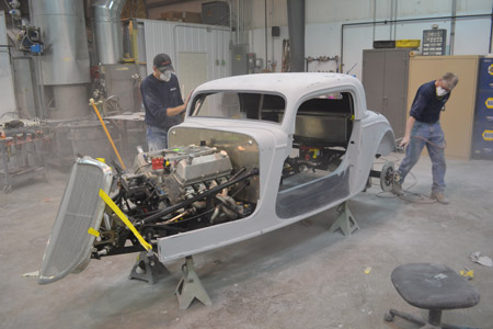

      Here are some earlier pictures of the ford. The rest are up on a build blog at: http://www.ridetech.com/33ford/ More pictures on the way as the build progresses!

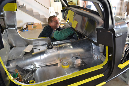

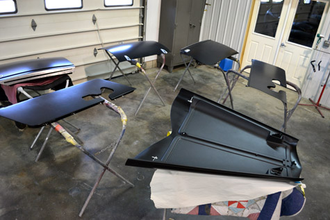

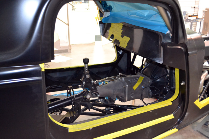

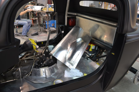

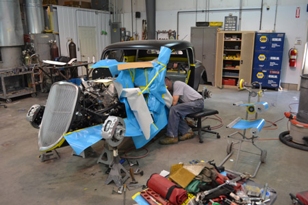

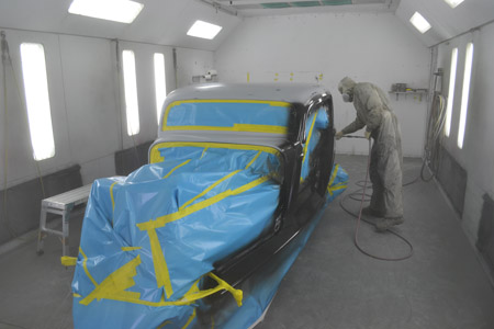

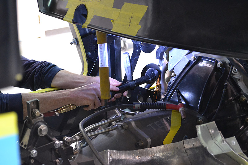

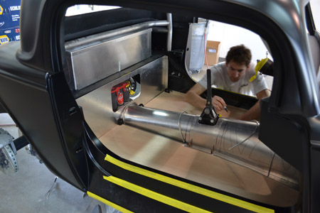

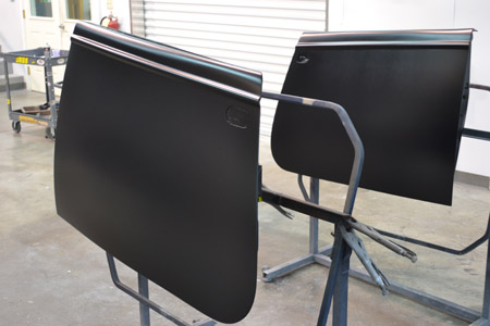

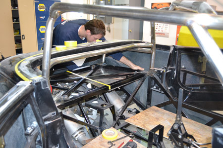

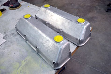

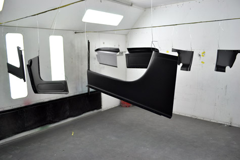

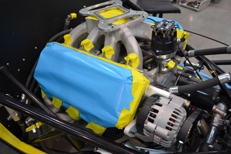

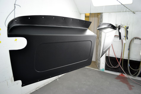

      Some pictures from Friday/Monday. Interior paneling and valve covers were recently painted flat black

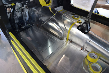

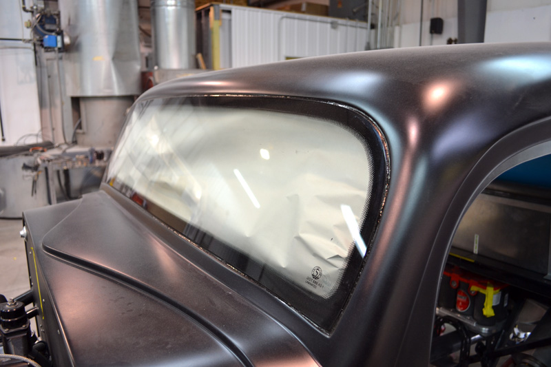

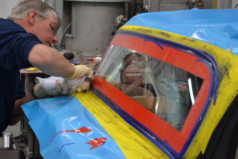

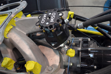

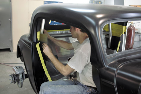

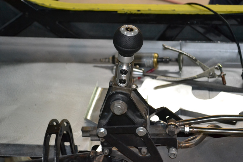

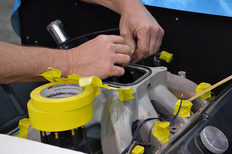

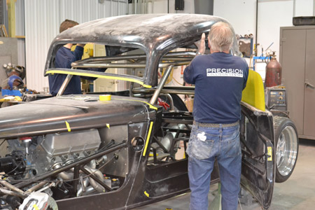

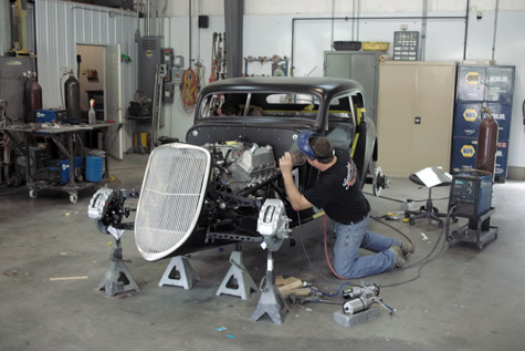

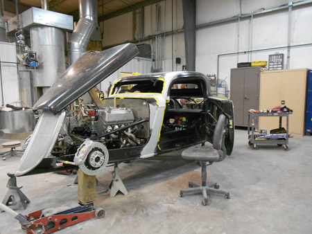

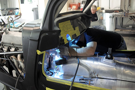

      Front and read windshields are in. Still hammering away at the interior.

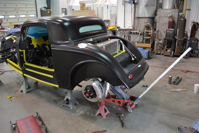

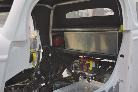

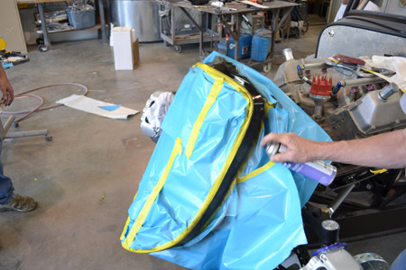

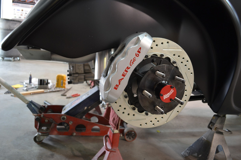

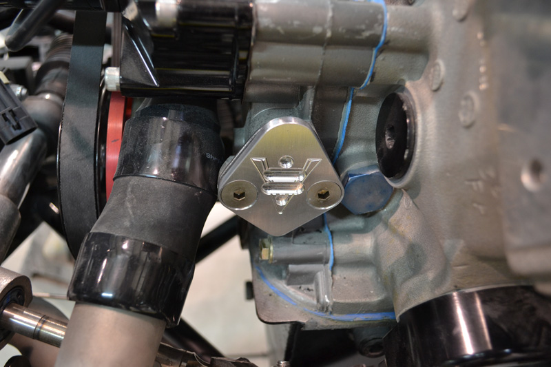

      Below are some more pictures from the past few days. We're starting to incorporate a Ford V8 ridetech logo all over the car.

      Our prototype machinist John Hochegsang came up with a really cool logo that incorporated the ridetech icon with the old time Ford V8 logo. We will be sprinkling it around the 33 Ford. Here is a video on the logo being created on the battery compartment cover...http://www.youtube.com/watch?v=-gfw4wROgXg
      We're getting close...brakelines are being built now, the rearend has been installed for the final time...the painted interior will go in tomorrow...wiring this weekend...

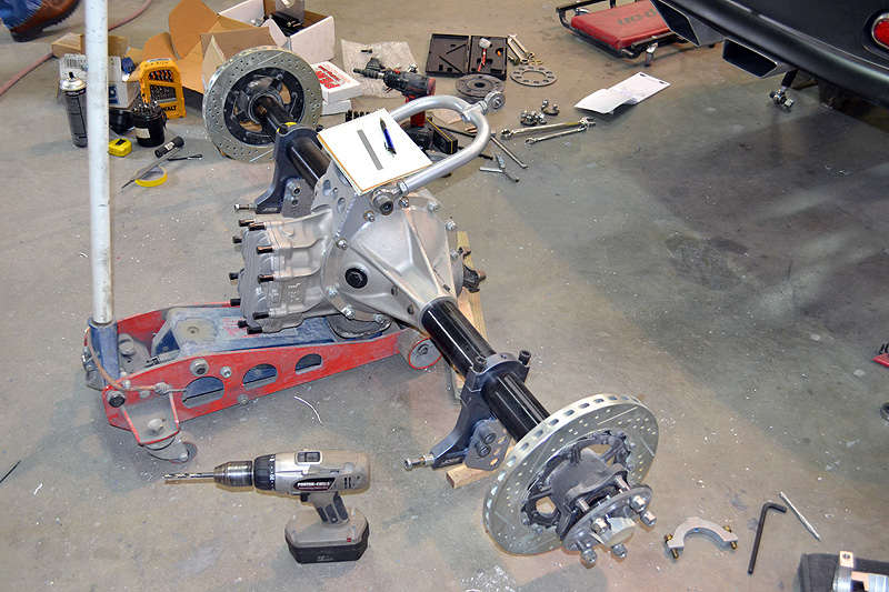

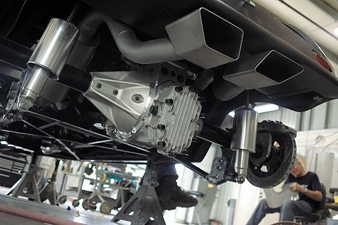

      Quote Originally Posted by jorge View Post
      Okay, this is driving me nuts, so I just have to ask.
      Exactly how are the axle tubes secured to the aluminum differential housing? Are the bolts just big set screws, or are there threads in the steel axle tubes? I think it's safe to assume that the tubes are a press fit, just wondering about the bolts.
