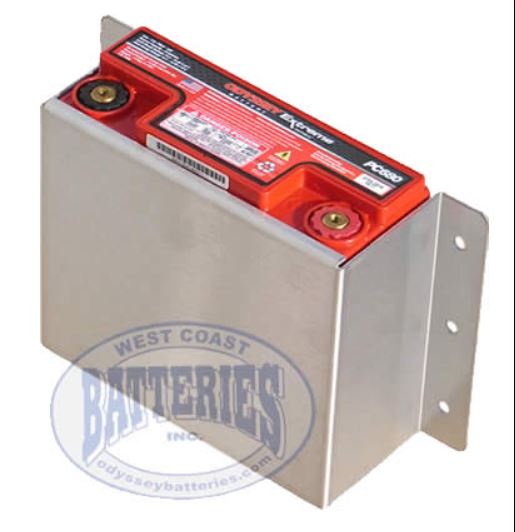

      i liked the idea enough to add one even though i had already installed a yellow top in passenger side trunk with 2 gauge. It wasn a lithium battery but a compact AGM type from odyssey, it fit like a glove even left space for my catch can and window washer tank retrofitted from a 2002 ford with built in fluid pump.
      why? because although the set up had never failed it had a slow crank when at full operating temps, not to mention our 100 deg plus temps.
      now it cranks over like a shot at any temp like its suppose to. About 2' of 0/1 gauge from the battery to starter and about 1' of 0/1 gauge to ground.

      saw that one, pretty clean, this is the one i bought out of L.A. for 35 bucks delivered sans battery of course.

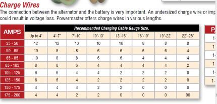

      Quote Originally Posted by tonyvol View Post
      I'm glad I found this write up since I'm in the process of relocating my battery on 67 Camaro to the trunk. I have Powermaster 140 amp alternator and was reading on their site about the size of the charging wire. Here is a chart with the wire size they recommend. The length of the wire from the alternator to the battery will be 18 - 20' long. I was thinking a 4 ga. charging wire would be plenty, but they are suggesting a 2 ga. Able I reading this correctly? 2 ga. seems pretty big for a charging wire.
      Attachment 79063
      Just food for thought I have bulkhead fittings at my firewall. Both hot and ground pass through on its on one. That wayy 2 gauge runs from trunk batteries to those bulkheads. But alternator only has to go from itself to those fittings on firewall. I used #4 for the alternator and ran a separate hot and ground. Other things up front also pick up power there such as starter main cable, fan controller, and anything else up there needing a constant hot
