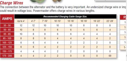

      Is there a difference if I run my 8G charging wire, from my battery, to my junction, then junction to alt? Instead of going battery,alt, junction for accessories?
      Would make for a cleaner run.
      Thanx
      Steve
      Jul 2010
      Monticello, MN
      249
      It should have no effect whatsoever providing all of your connections are the best they can be. A continuous run of wire by a direct route will always be the least resistance. It is best to both crimp and solder, then heat shrink all connections.
      Clean routing and solid junctions will be well worth the time and energy spent. Have fun.

      That could be correct. 8 gauge may be for stock alternator. But for charging the battery it seems the regulator would just send what the battery needs. Maybe use 4 ga going from Alt to main terminal and then 8 ga going back to battery.

      Jul 2015
      Lake Forest, California
      3
      Perfect!
      Been using this site's expertise a lot as I'm building my 68 Camaro - Pete, this write-up has been my bible in relocating my battery! The only trouble I had was finding the right "plastic" grommets you mentioned as Monster. Thought I'd share what I found in case others happen about this thread. I found these "gland joints" (new term to me, but I've seen these before) on Amazon - got a whole mixed box for $15 (https://www.amazon.com/gp/product/B0...?ie=UTF8&psc=1), and I like them much better than rubber grommets...enough to fit all my 1/0 cables as well as smaller cables. Not sure if this is what you used Pete, but they're working great for me (as long as I remember to put them over the wire BEFORE I put the connectors on!)
      Like Tony, I am also installing a PowerMaster (#27294 in my case), and am deviating from the 8ga to 4ga based on the same table he posted above.

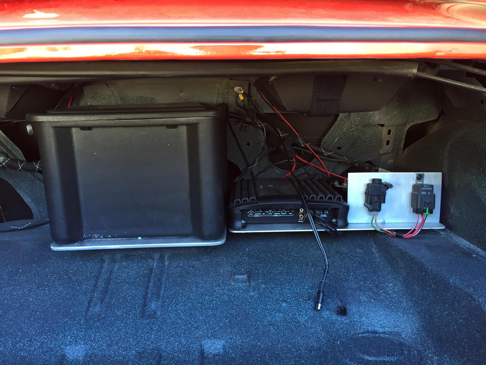

      I finally got around to taking some pics of my relocation.
      Here is the overall setup from left to right, battery Box, Amp, Inertia Switch, Relay (for fuel pump). Behind panel is the kill switch with removable key and the solenoid.
      You may be asking, "whats an inertia switch"? In this case its a switch that cuts power to the fuel pump relay in case of a rollover (and hopefully also a severe accident). You can find them in the junkyards on the front passenger footwell of 90's Fords like the Mustang and Explorer, right behind the carpet. Of course if you roll over in an old muscle car fire may be the least of your worries but its a simple add for a small peace of mind. And yes, my TIG welding sucks, I blew thru the aluminum in 2 places! I only have a few hours welding experience.
