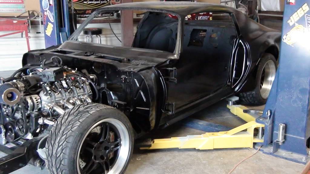

      A few more pictures of progress on Project "ERNREE"

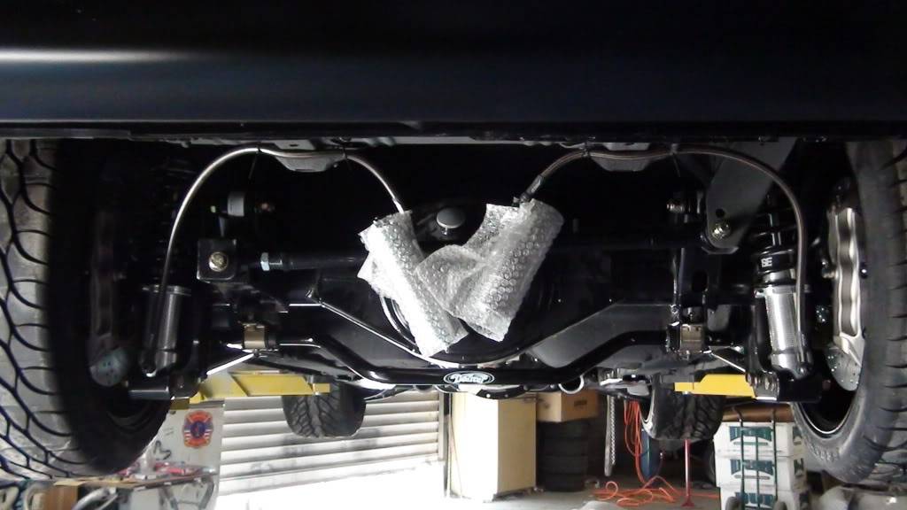

      Bill,
      I recommend flipping the rear shocks so the lines are up top and the rebound adjuster is on the bottom where you can just reach under the car and adjust. This also allows you to pop a couple holes in the trunk floor and mount the remote canisters in the trunk for even easier access.
      Overall looking great and will put this on my list of cars I want to flog

      Will do my brother. Thank you for the advice. Hope all is well....
