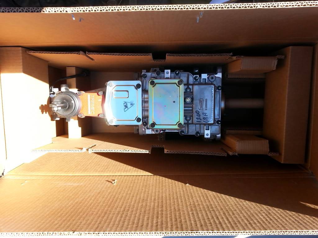

      TKO 600 with .64 overdrive! I always make a big purchase every year we go to HAN. Summit's 10% off during the event. Well this year with all the gift cards I had from the previous Christmas and birthday, I got the OK from the boss. Last year it was the Currie 9 inch. Hopefully these will be installed in the next 2 days.

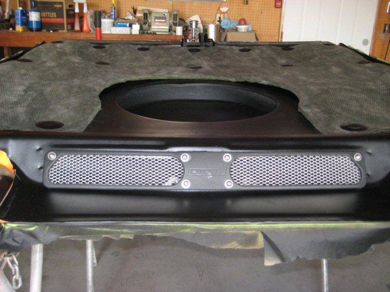

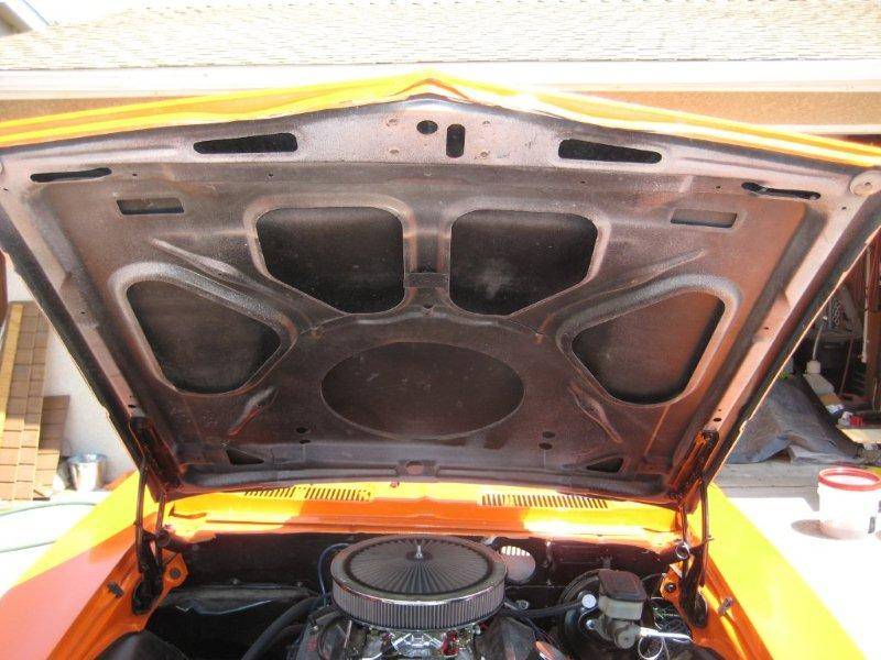

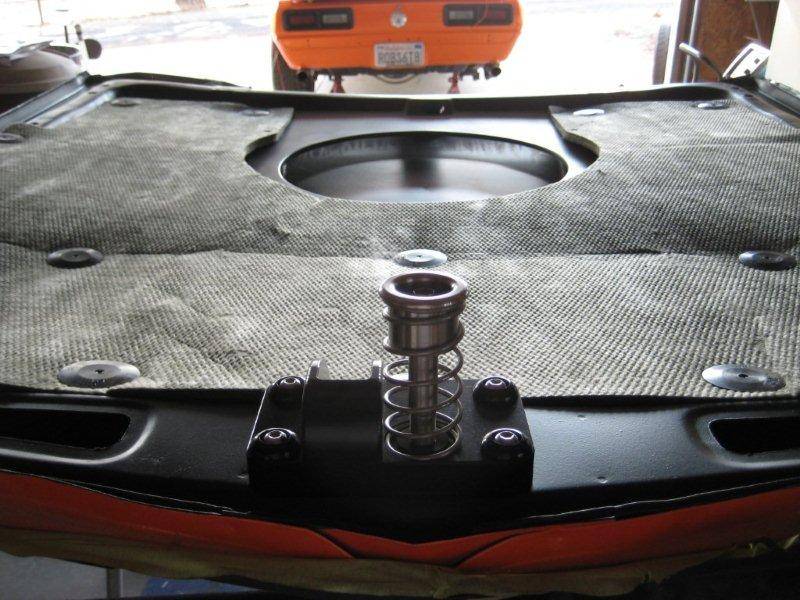

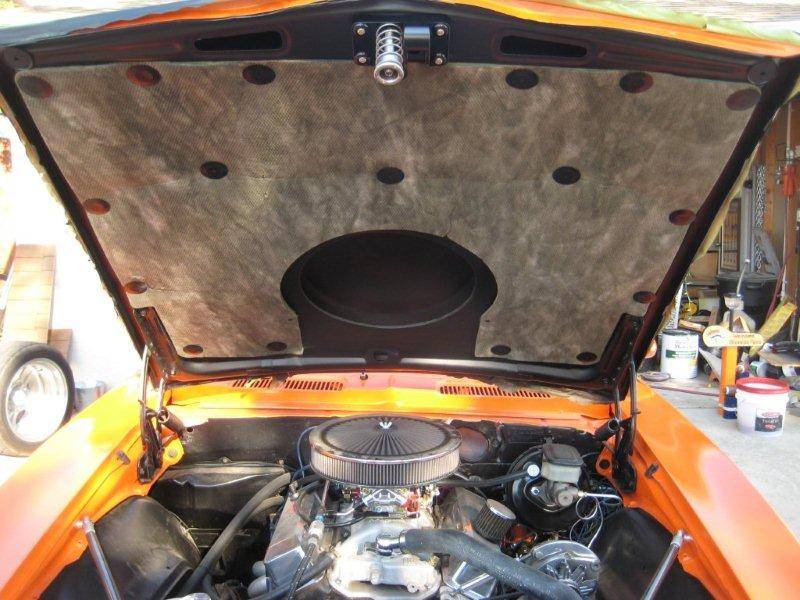

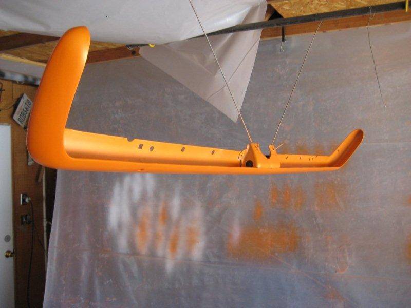

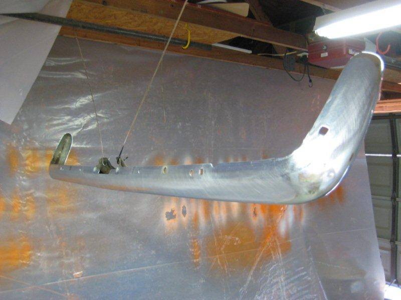

      Now that I'm here updating, I'll throw a few more in. What I've been working on before Hot August Nights...
      Did the underside of the hood. I know backwards...
      Before...
      Eye candy...
      Anvil goodie...
      All complete!
      Robert

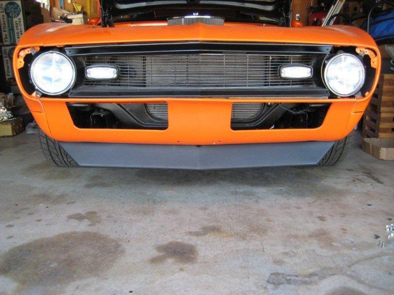

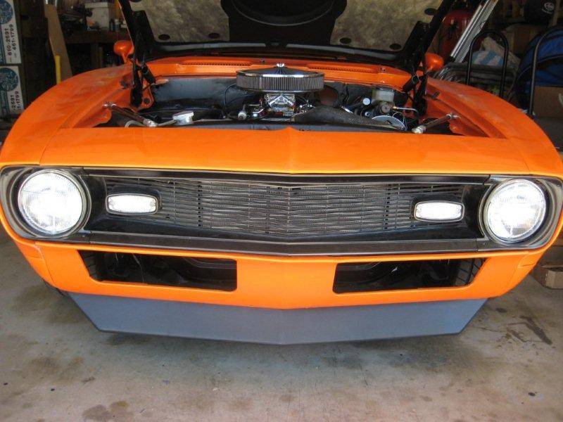

      Painted everything up front that I could black. Put it all back together, finally. It's only been apart for 2-3 years. Installed the spoiler that I've had before I even bought the car!!
      I read the stories of damaging sheet metal using the braces with the spoiler so I just screwed it in and left the corner brace off.

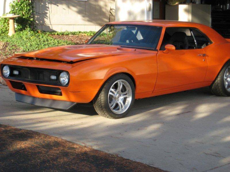

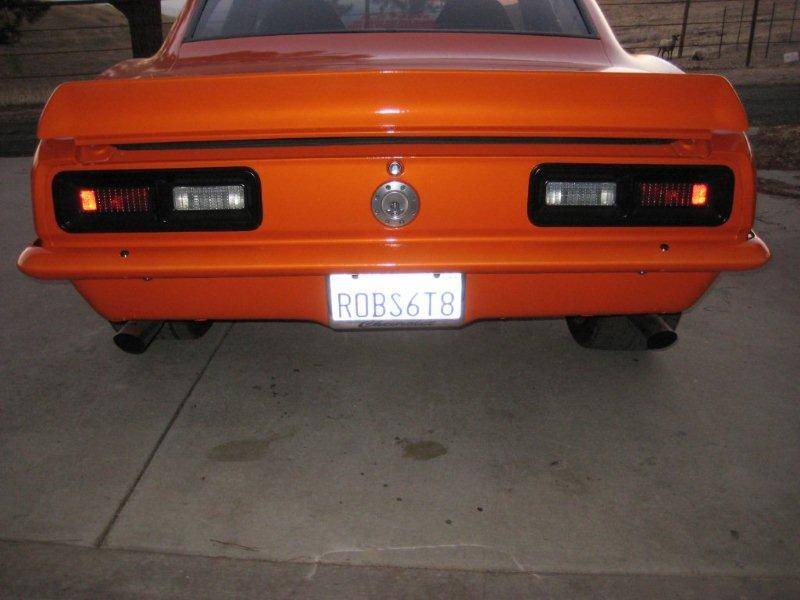

      I also did the rear bumper. Nothing special. Just didn't want the chrome and I wanted to make it some what legal for the street!
      I like Rod's idea of painting the rear bumper the same color as the stripe! Who knows? Maybe someday... when I get the stripe on!

      The past few days I was working o getting the TKO installed. I pulled the Muncie out and the next day I go out there and have a look at the TKO. Hmmmm, something doesn't look right? The 26 spline input shaft vs. the 10 spline on the Muncie!! Call around looking for an 11" clutch disc and no one has any in stock!

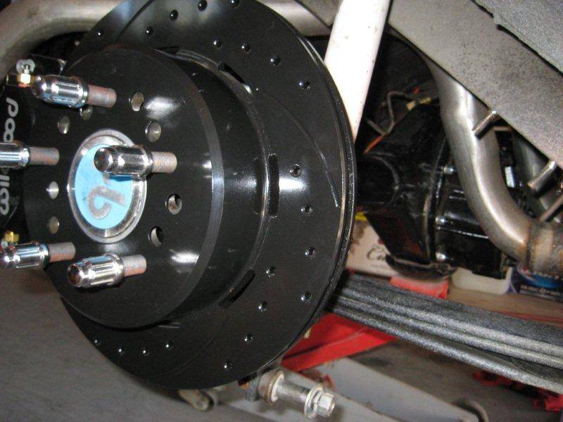

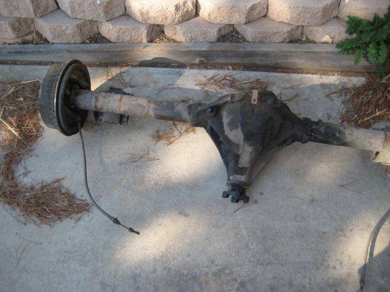

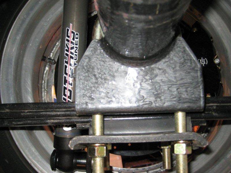

      On to the next project... installing the 9 inch thats been sitting in my weight room for the past year. Need to do this anyway so I can get the measurement for the driveshaft.
      Out with the old...
      Installed with the Wilwoods...

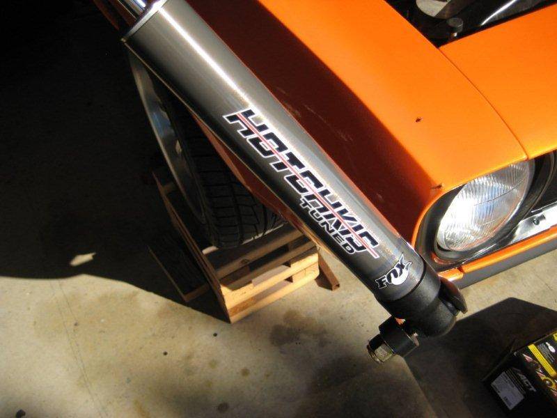

      More goodies. Hotchkis Fox tuned shocks. Unfortunately the will be well hidden!
      The Hotchkis leafs just weren't doing it for the drop(1.5) so I added some 1" lowering blocks. I have 1.5" too but started with these.
      Still need to plumb the brakes and add some gear oil. Waiting for some body bushings (stock height). **WARNING** Don't do the .5" lower body bushings if you plan on making any changes! The new crossmember doesn't fit. Heck I played havoc with the other one but made it work. I'm done with messing around with these bushings.
