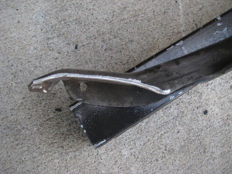

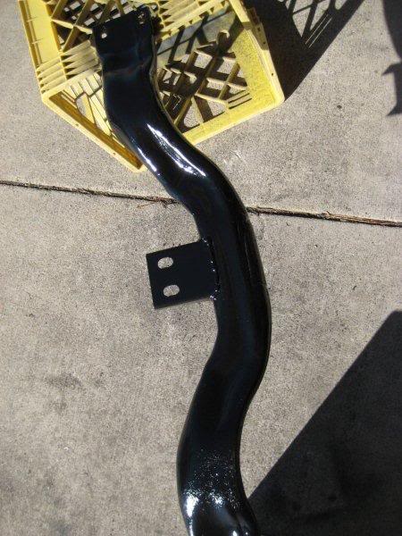

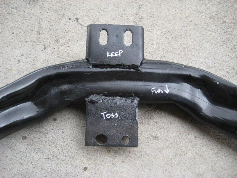

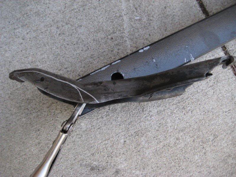

      I said I almost got something done. The next problem was when we went to bolt the crossmember back in and get the tranny lined up. The previous owner had modified a turbo 400 crossmember, I think, to make it work with the Muncie. There was no way the tranny was going to line up with the mount without seriously tweaking it into place. No need for extra strain on it!
      I will remove both of the mounts and re-weld the original mount onto the right side where they had welded the homemade channel mount. I will get the crossmember back in and line everything up and tack the mount in place. Remove and finish welding it. Photos and progress to be posted later today... hopefully!

      Didn't realize how long it's been since I posted! It's like I fell of the face of the Earth! There's been a lot of honey-dos, trips to Disneyland, birthdays, holidays.... no excuses. Let's get caught up. Spring is right around the corner... or is it here already in California? LOL
      Here's a pic of the finished xmember. That was not as easy as I was expecting. Keep this, toss that, re-weld done... NOT! The original mounting bracket that I was going to keep ended up being too short. I had to get some new metal and make my own. After tacking it on a few times and realigning it under the car, I was able to finally weld it up. Hopefully it want be under there too long as I want to go with a 5 or 6 speed tranny.

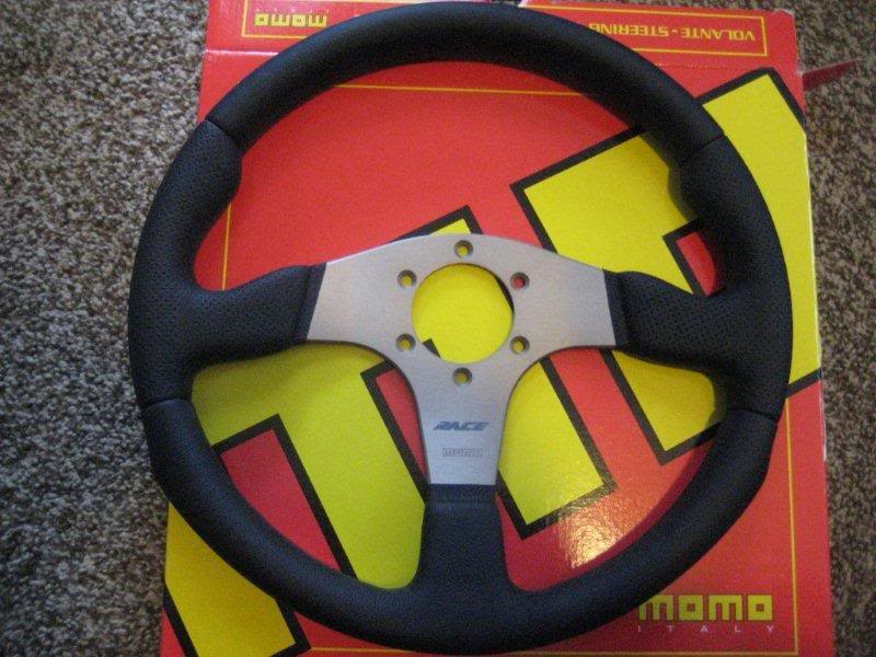

      The wife hooked me up for my birthday with this beautiful leather piece...
      MOMO Race steering wheel
      A little motivation to get out there and get to work. Won't need this if she's up on blocks!

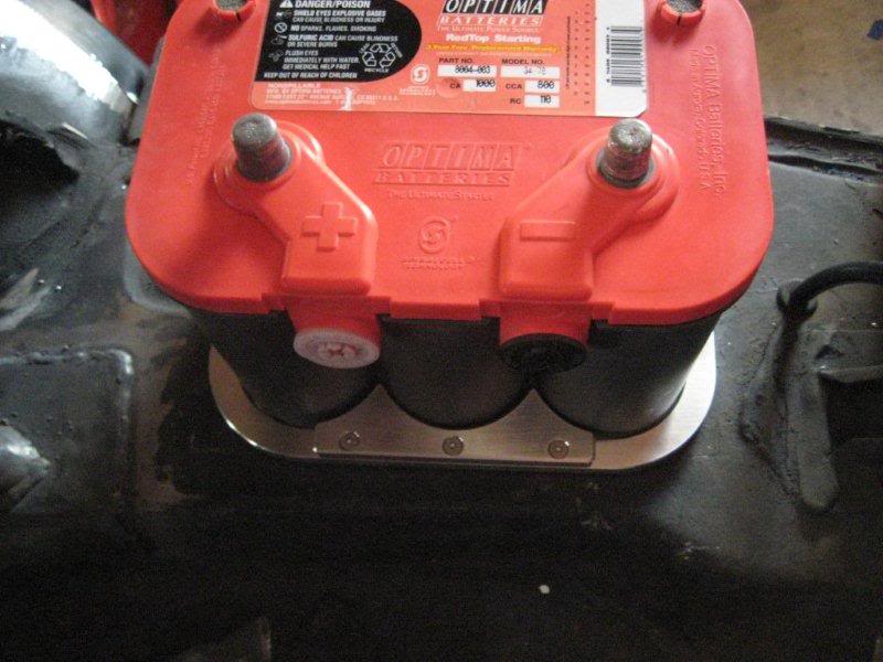

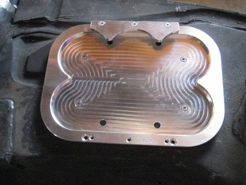

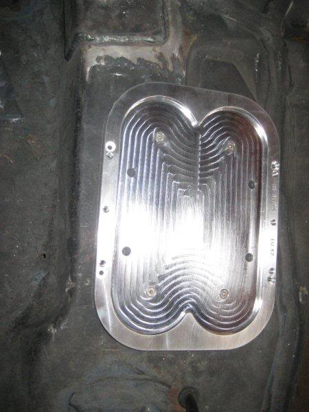

      The wife gave me some more motivation at Christmas. She bought me a Barch Designs optima tray... www.optimatrays.com Benjamin is a great guy and customer service is awesome.
      Location for the battery...right rear
      Tray installed
      Slip Clamp installed
      Battery installed
      It's a beautiful piece. I'm installing the MAD electrical trunk mount kit as well. I'll post some pics of the mounting locations and wire routing when finished.

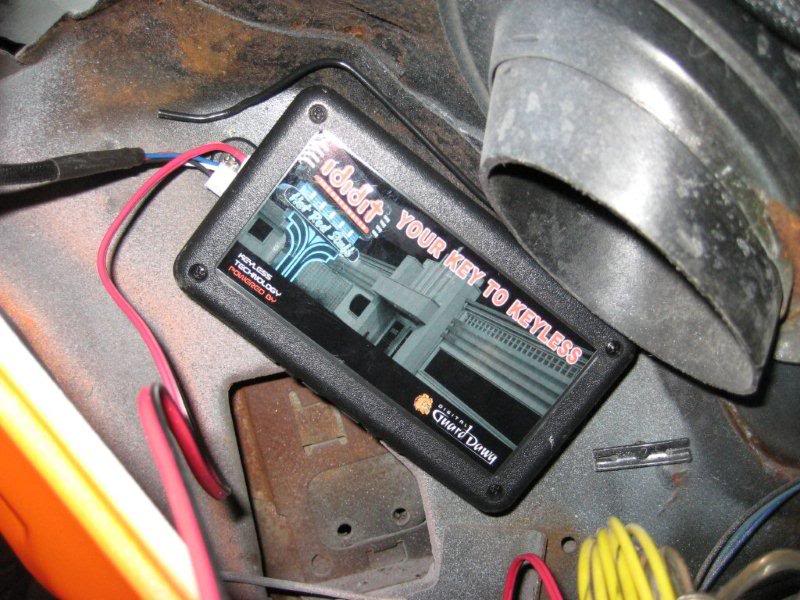

      Oh yeah, here's the other project I started months ago! Told you I suffered from ADD!
      This is the module for the keyless ignition. I installed it under the dash on the lefthand side. I was held up with all the other stuff ie., engine and tranny install and of course no battery installed! lol

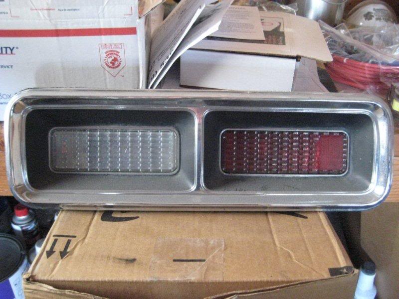

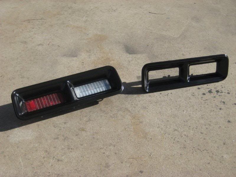

      The wife also bought me some Spaghetti Engineering LED tail lights. I couldn't just put them in the stock bezels so I took out the bezels and had them powdercoated. I wanted to get some billet ones but I couldn't see spending $400+ right now. This cost me $80! I really like the way they turned out. Who knows how long it will be before I purchase the billet ones now!
      Old...
      Powdercoat...

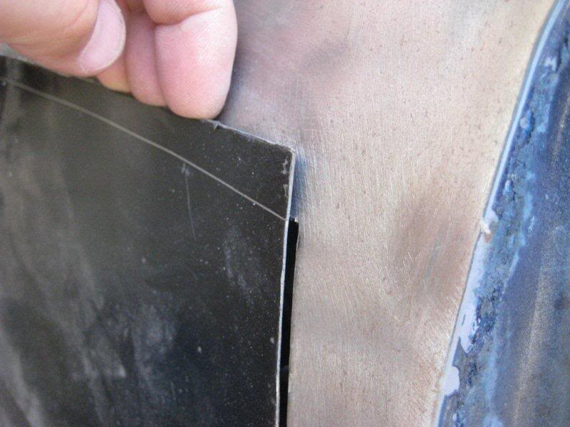

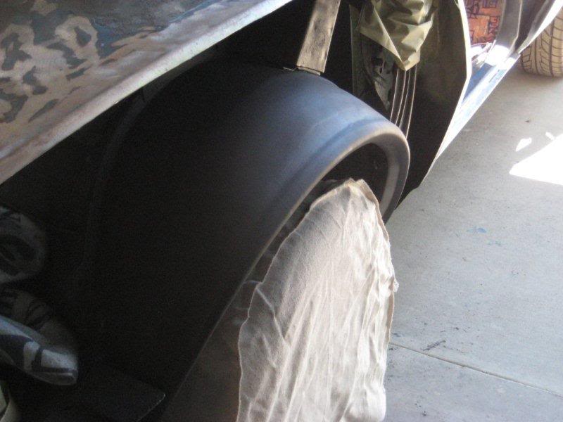

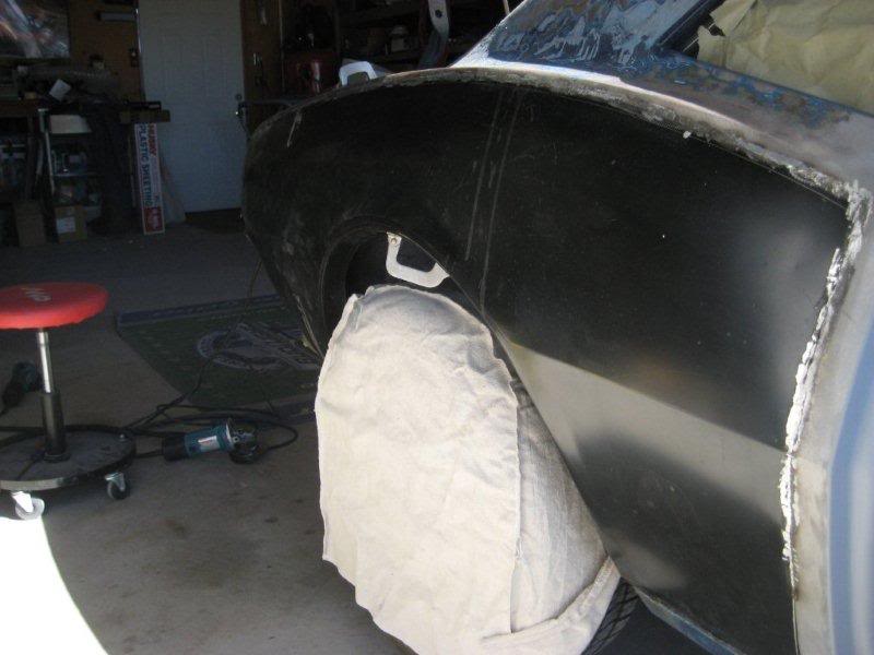

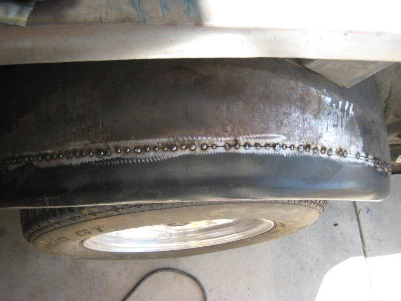

      Updates? Sorry I have been busy working on her and it seemed like it slowed me down posting pics. You want updates? I'll give you some updates with pics! Where do I start?

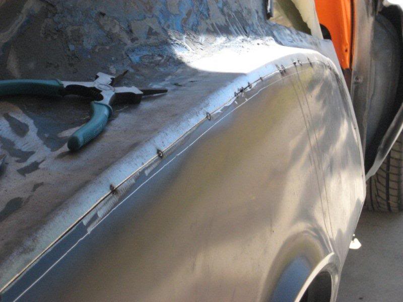

      Quarter panels...

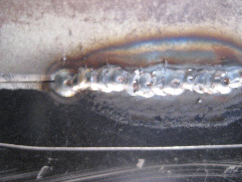

      Didn't have a clue as to how to measure and cut these properly so the right side was a virgin that I somewhat hacked! lol I can see why they say complete quarters are easier than the skins... less welding!
      Oh yeah, I forgot the wheelhouse...
      And what happens when you can't measure properly! Just add some more welding!
      Finished wheelhouse
      Quarter panel welding...
      PIc of where I was going to cut and how it was perfect... but I learned to put the panel on the old and scribe on old and remove old. It was much easier doing it this way...
      All welded in
      I wont bore you with the other side!!

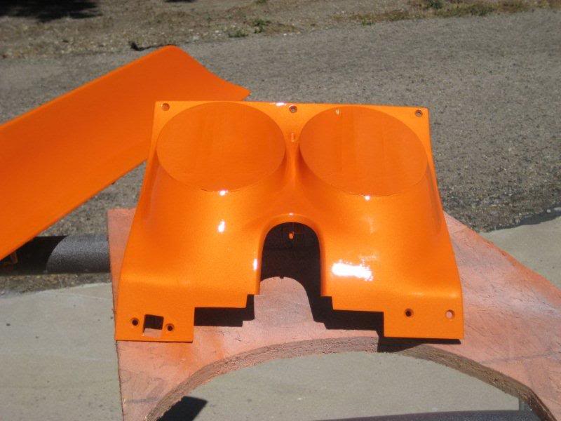

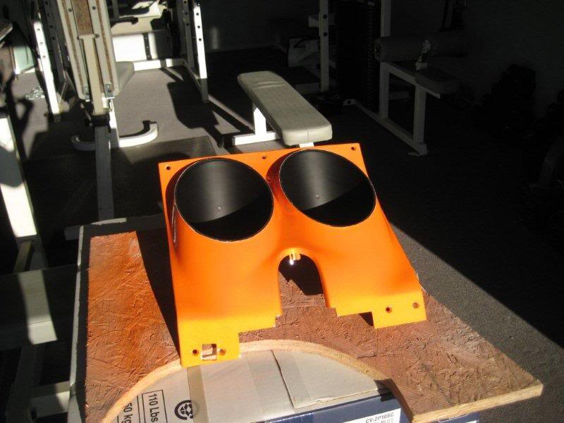

      I painted the instrument bezel to match the dash. The black was just too much contrast. I had to do this twice as the first time the paint wrinkled up on me! I laid it down too wet!
      I installed the Dakota Digital gauges... which I absolutely think are GREAT!
