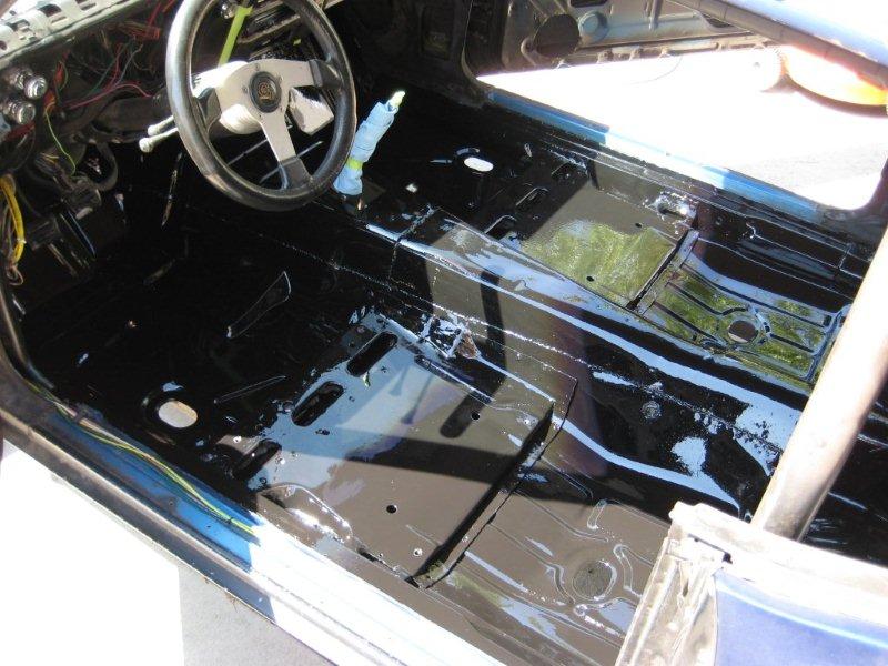

      Orignally I didn't think I was going to take the windows out. Therefore, I replaced the floor pan in two halves. This was going to be my first time welding sheetmetal with a mig. I figured it was going to be covered with carpet anyway. How hard could it be and it was a nice place to practice! Afterwards, I covered the entire thing with Por-15. I know it's only for rusted metal and there was still some in there, but what's a lil' added protection. Fatmat will be installed as well.
      More to come...
