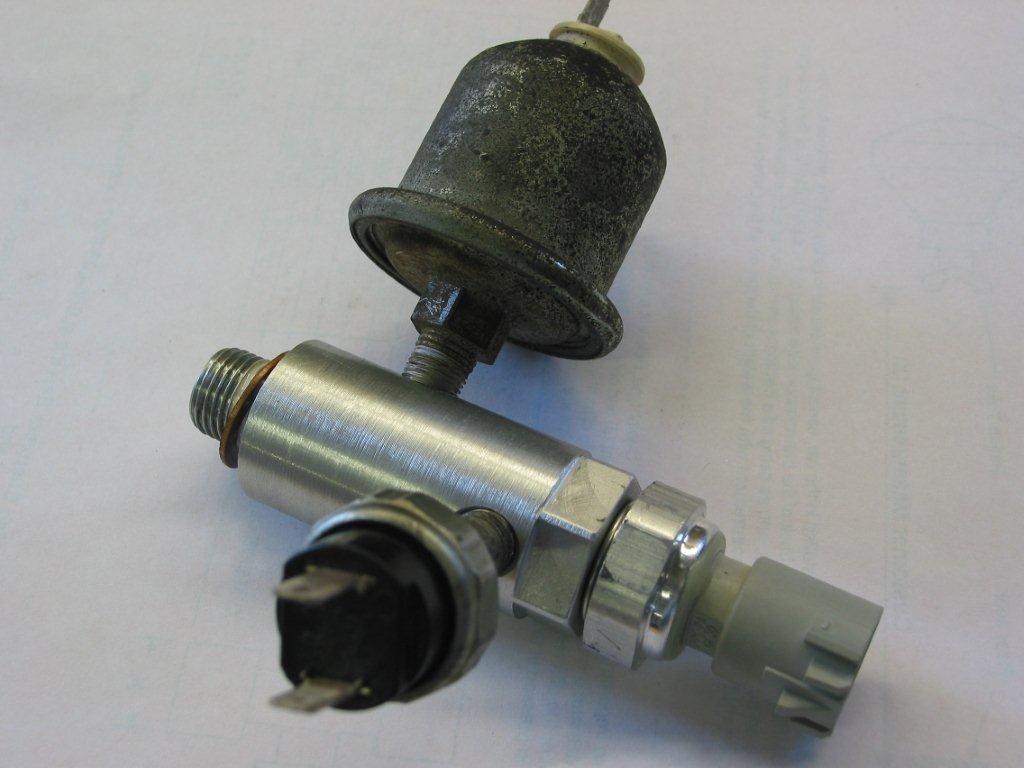

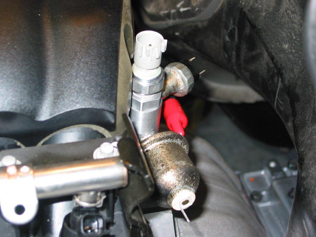

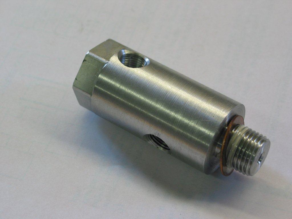

      LS Monte Oil Pressure Adapter
      Scott:
      This was our soln for my 85 LS Monte SS .....adapter has provisions for the Monte analog gage sensor, an oil pressure idiot light( old "choke" idiot light in Monte stack was retasked), and a sensor to the ecm....tricky part was getting the "clock" right for posn of the analog and idiot light sensor so as to assemble correctly....

      I like it. Did you make that yourself? I'm having doubts about my method now.
