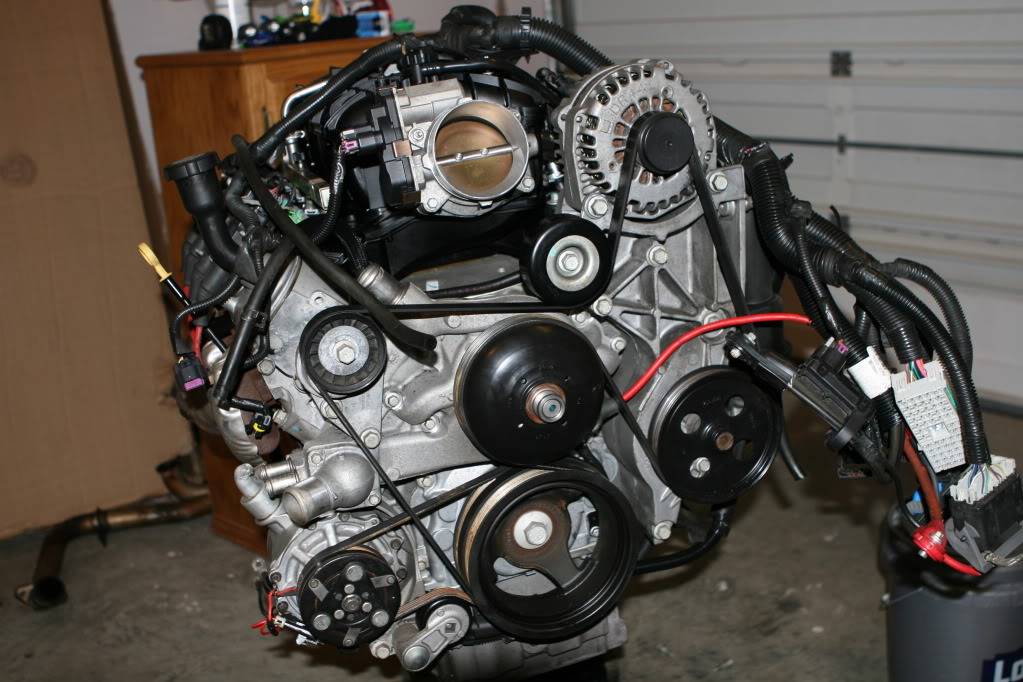

      Finally (I know), the motor is in the garage:
      Did some tinkering around with the Trans Dapt 1" set back adapter plates.

      Seems like the plates were around $65 shipped from Summit.
      I went with the 1" set back because I had read somewhere to use them & then I can use Pacesetter F body LS headers without problem. Those headers uncoated are like $250. Plus the tranny I want has the shifter 3" farther forward from where mine is now, so I was trying to get it back to that location. Because it fit me perfectly with my long legs & seat all the way back. I don't want to use a funky curved shifter.
      I didn't take the windage tray off, so I didnt see the crank or ends of the rods.
      Don't know yet if I am going to use the accessory drive. I think it might be too tall. Would prefer to use the C5 Vette alt & PS pumps & bracket & space them out to match the location of the crank & waterpump pulley.
