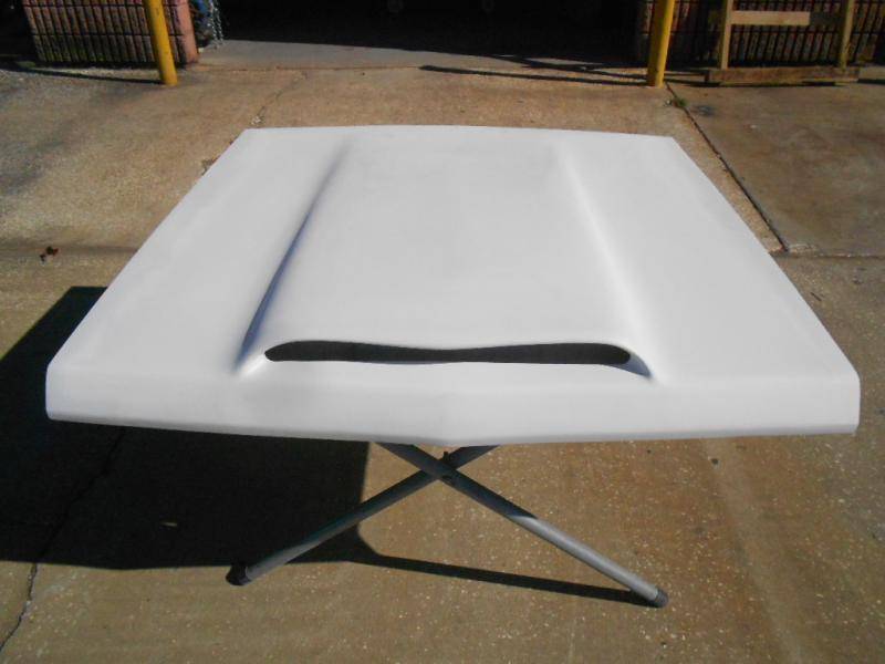

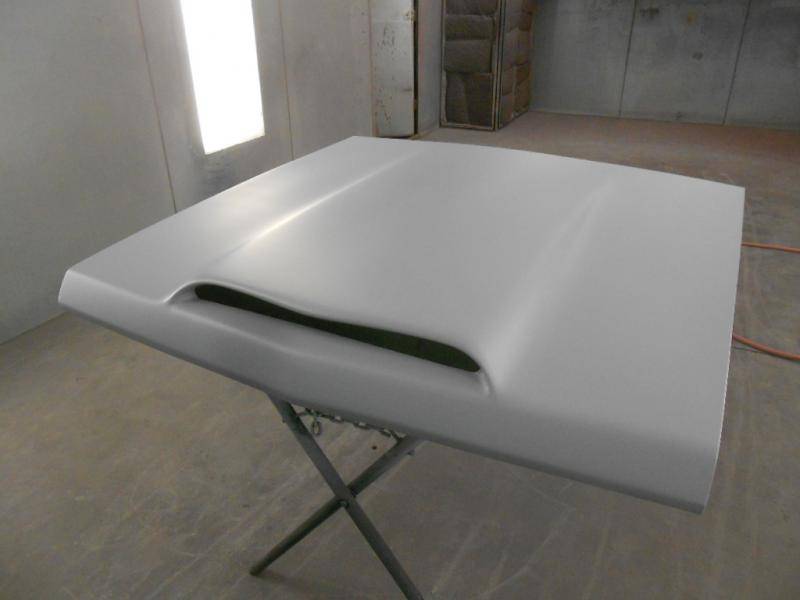

      My plan is to race in one of the SS/GT classes so I ordered a 427 fiberglass hood as a Christmas present for myself and it came in today.

      I had to trim about a 1/4" off of each side and a little off the back block sanded and epoxy primed.

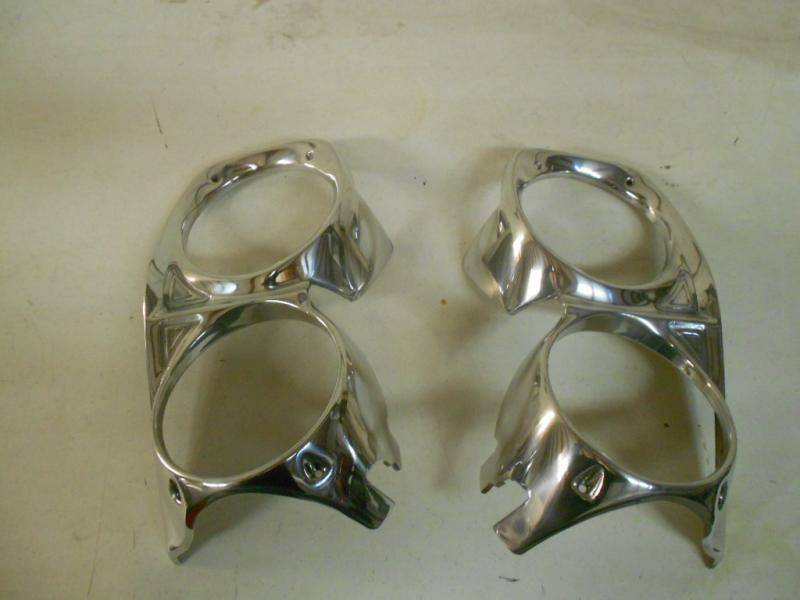

      I had the headlight bezels polished and he now has the grille

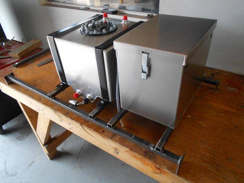

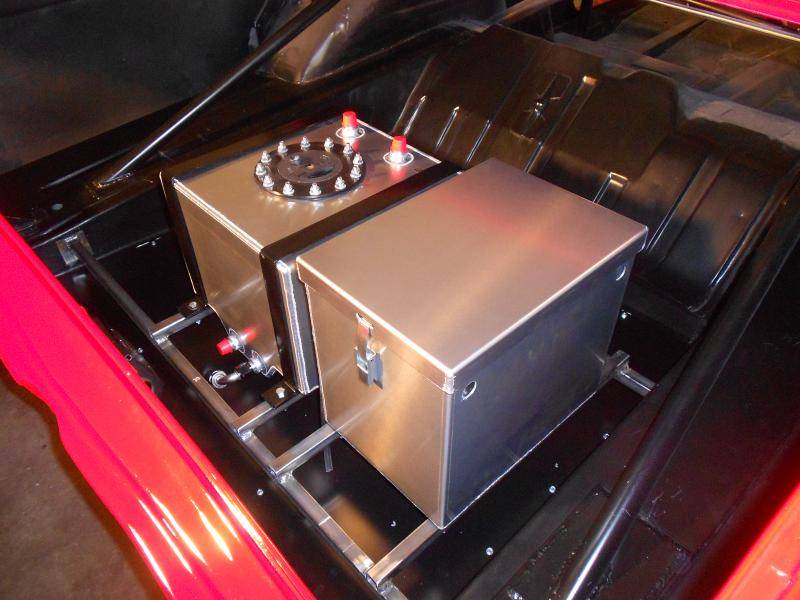

      Rusty,
      Who makes that battery box?
      chunger
      '68 Ranchero 500
      '70 Cougar XR-7 Convertible
      '98 Mustang GT Convertible
      Sep 2009
      Port Richey Fl
      775
      Quote Originally Posted by chunger View Post
      Rusty,
      It came from Summit

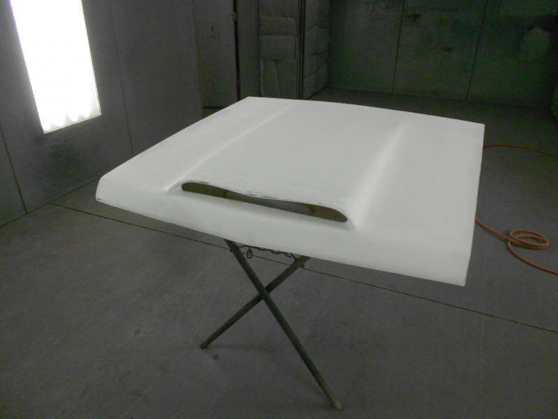

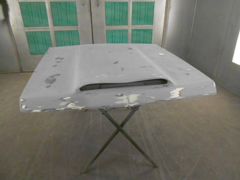

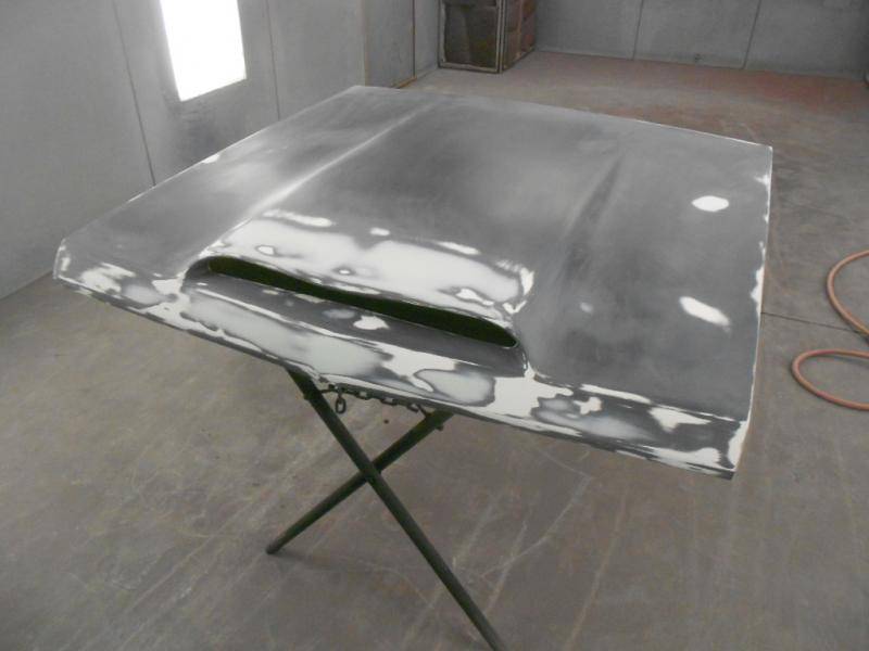

      I block sanded the fiberglass hood and added a little filler
      Sprayed a couple coats of SPI Turbo primer

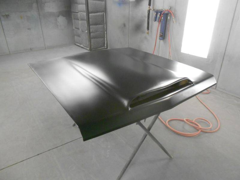

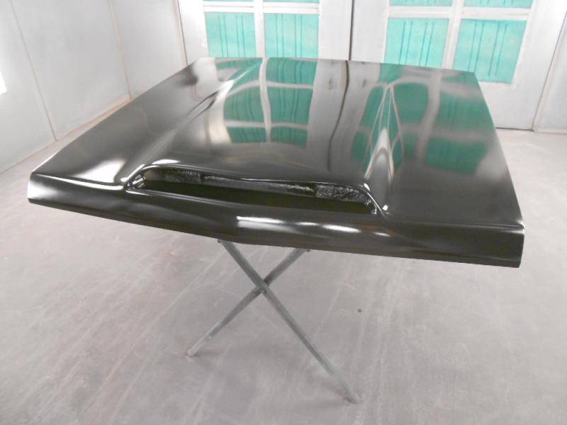

      Today I block sanded again and sprayed two coats of black epoxy primer. I will paint the hood red before I'm finished but it will be awhile.

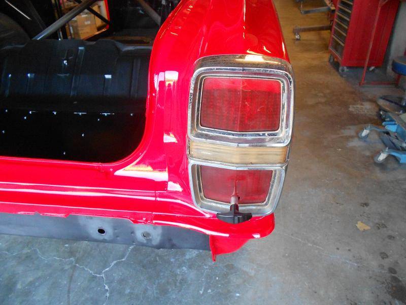

      The rear bumper needs a lot of work
      After straighten, welding and a lot of grinding and sanding I sprayed at least 3 coats of SPI epoxy and started the bodywork
      After a few times of block sanding and priming I sprayed 3 coats of SPI Red the next day 3 coats of SPI Universal clear
