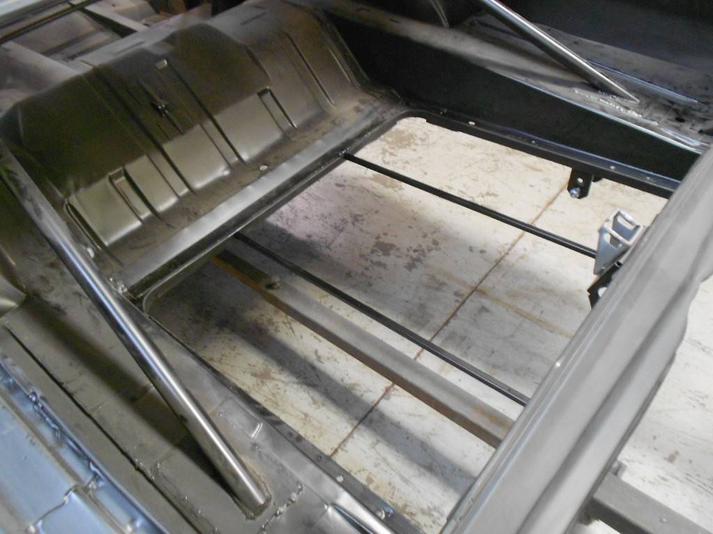

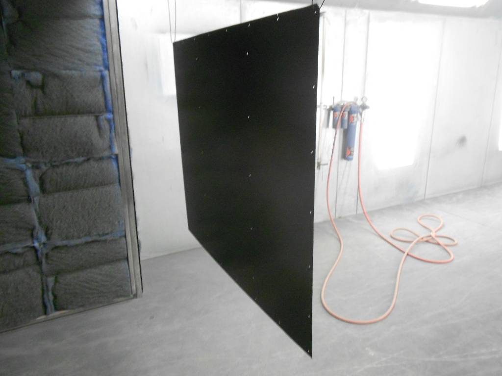

      The stock fuel tank will be replaced with a 5 gal fuel cell so we needed to fabricated a trunk floor. Brian added a couple of braces using small box tubing
      He cut out a piece of sheetmetal drilled and marked the attachment holes and than sanded it with 80 grit.
      I sprayed 2 coats of SPI black epoxy
      Brian used a little seam sealer than screwed it together.

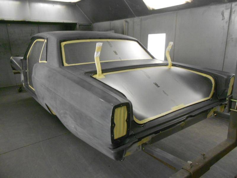

    2. #122
      Sep 2009
      Port Richey Fl
      775

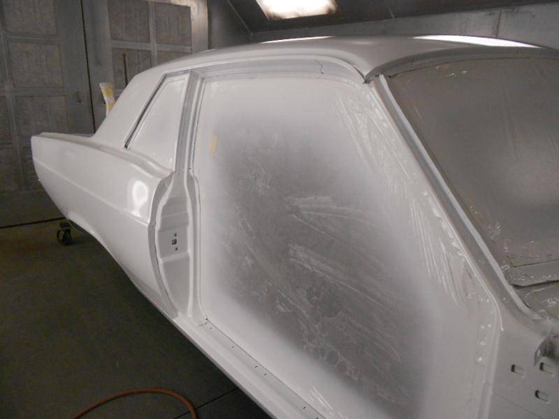

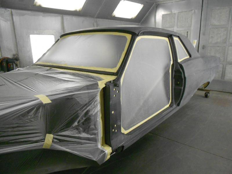

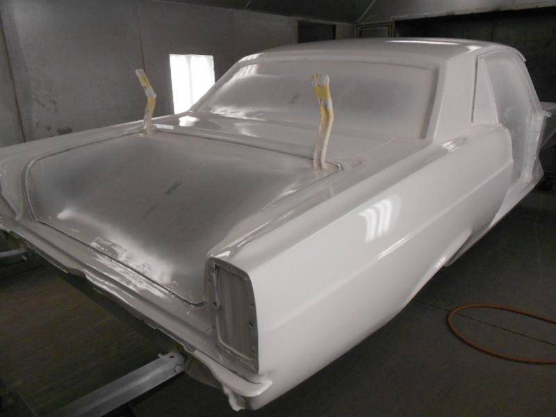

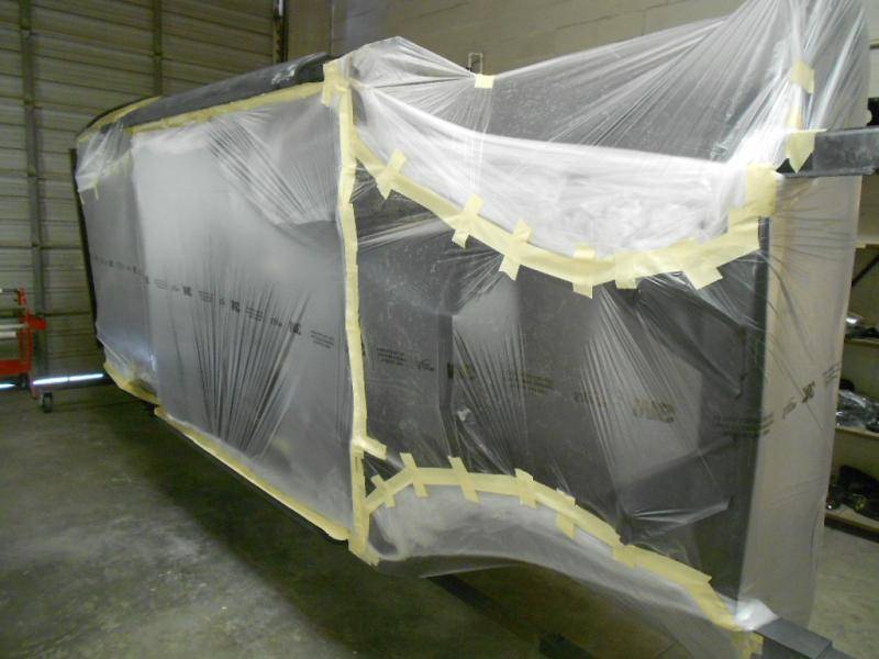

      Brian taping the body getting ready for SPI white epoxy

    3. #123
      Aug 2009
      Honolulu
      72
      That's the nicest tape job I've ever seen!! Seriously can't wait to see it in color all reassembled:D

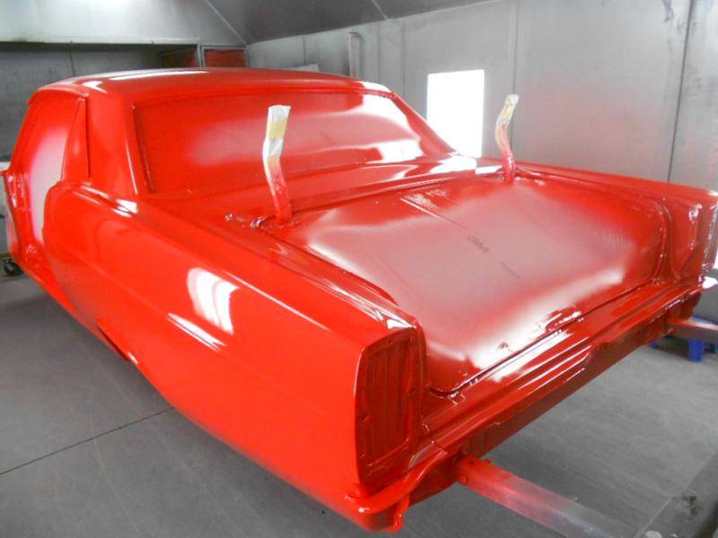

    5. #125
      Sep 2009
      Port Richey Fl
      775

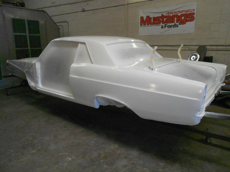

      Ready to go back in the booth today for 3 coats of SPI Red

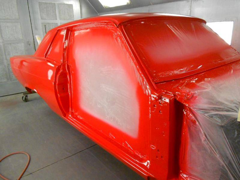

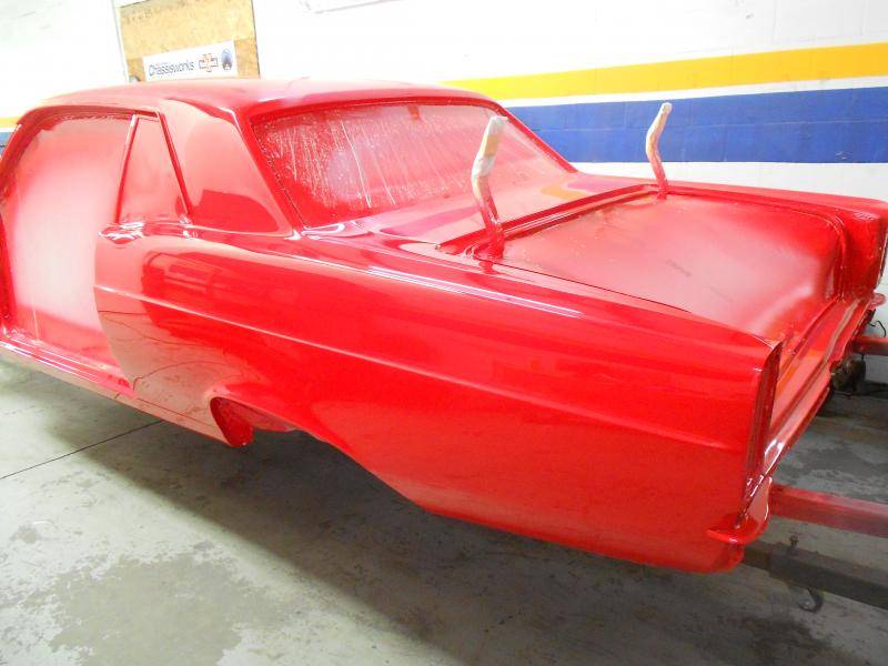

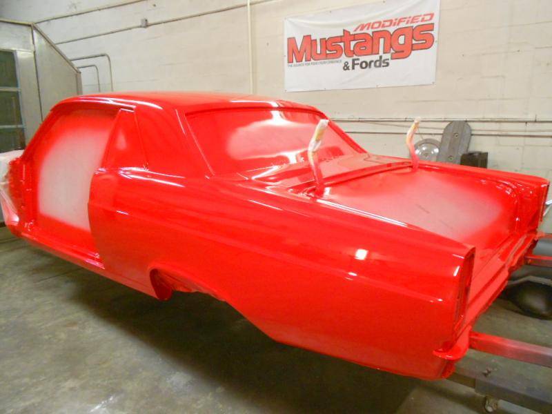

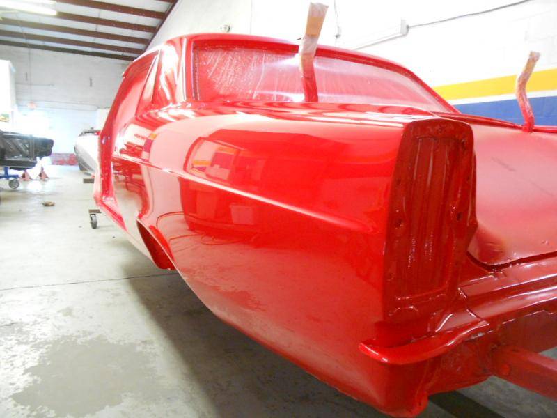

    6. #126
      Sep 2009
      Port Richey Fl
      775

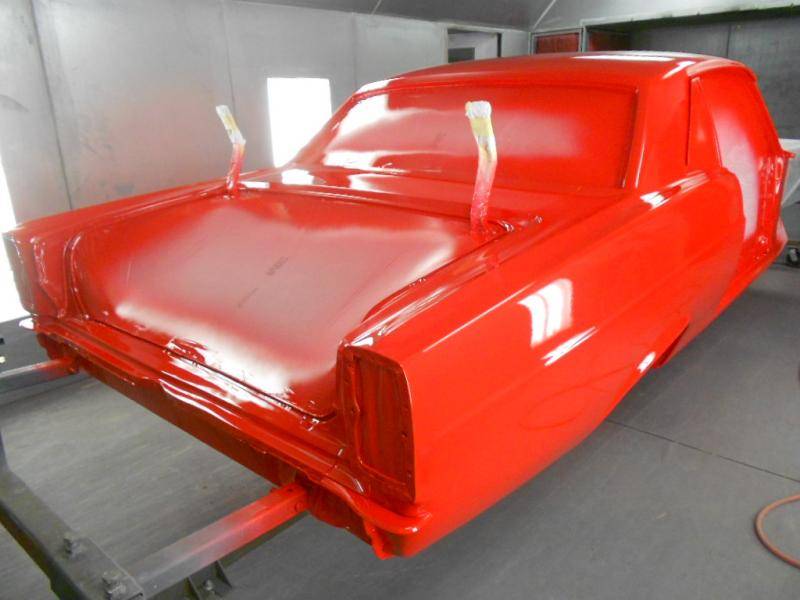

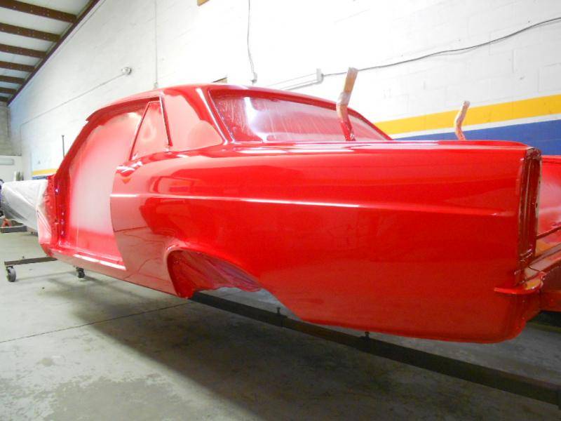

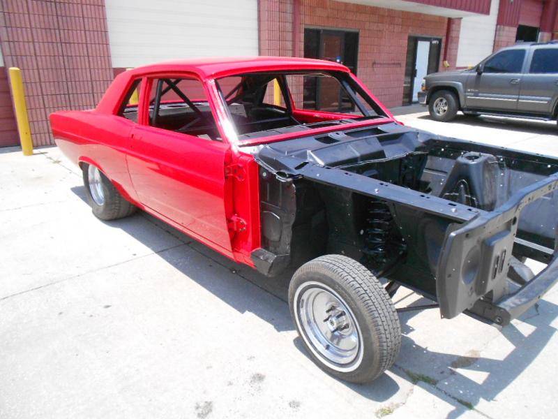

      Yesterday I sprayed 3 coats of SPI Red and today 3 coats of SPI Universal clear.

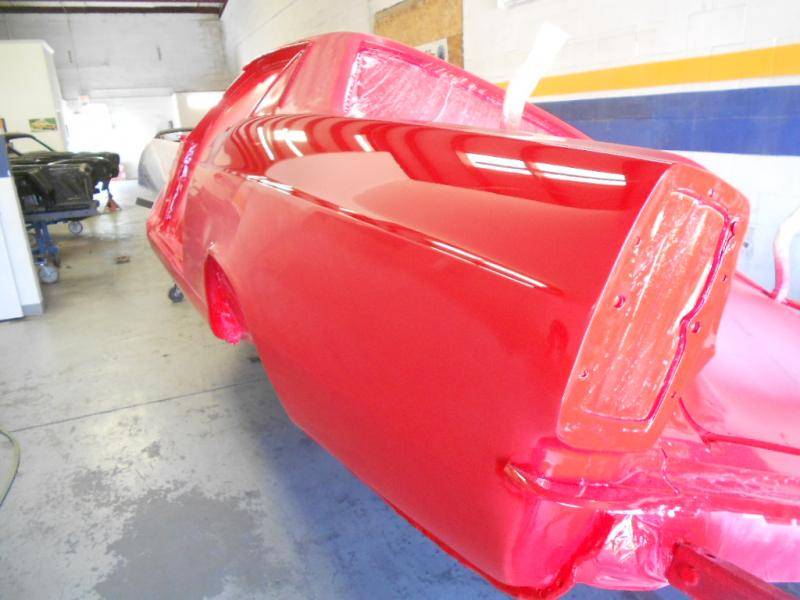

      A couple of photos out of the paint booth

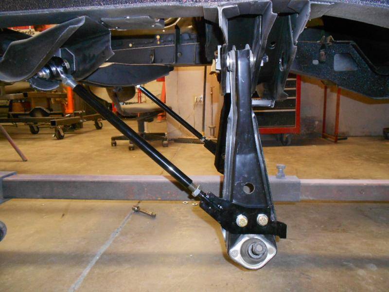

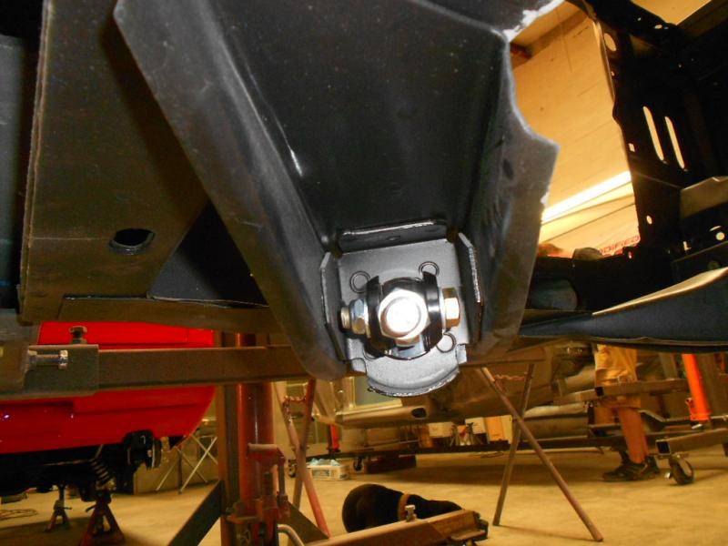

      Installing Opentracker strut rods, upper & lower control arms and double roller spring perches

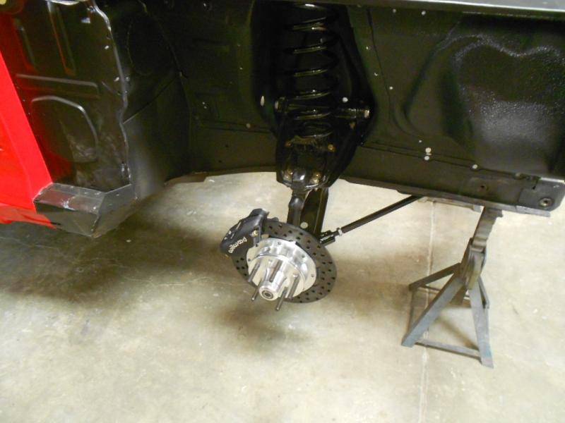

      Slowly going back together
