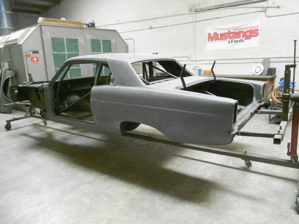

      It has been a long time since I worked on the Fairlane but the Super Stock project is back. Stay tuned for more details. The first thing I need to do is block sand the body and fix any imperfections.

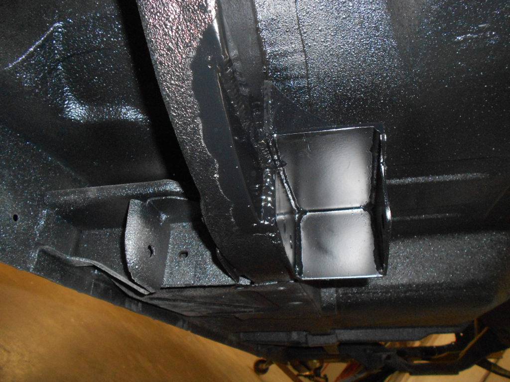

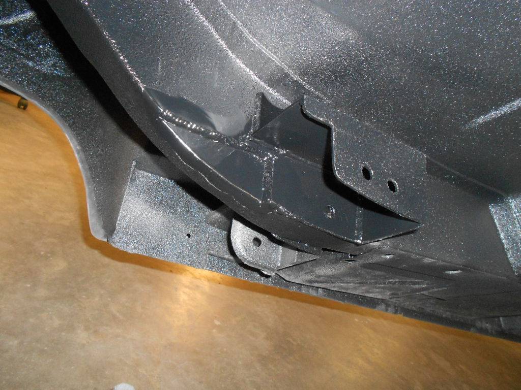

      There is a clearance issue with the front spring hanger and the CalTracs. We notched the front spring hanger and after I installed the springs found out it was binding at the frame rail. I decided I would correct this problem later. Since we started working on it again now is the time to fix it.
      The frame rail will need to be notched for clearance. If you look at a stock Ford frame rail where the leaf springs bolts in the stock location it has been notched

      You can see where the pin from the CalTracs was rubbing the frame rail and I marked where the top of the bracket is on the frame rail.

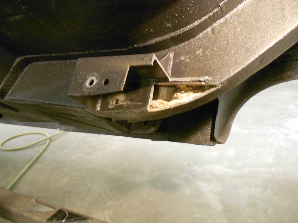

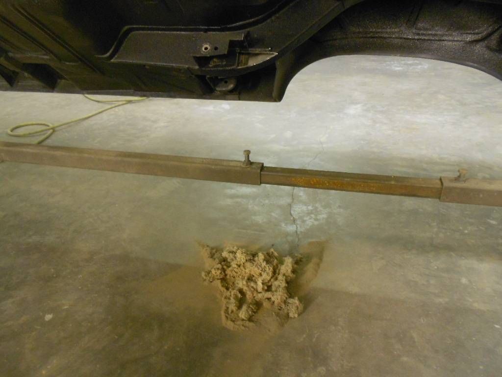

      You never know what you will find inside a frame rail

      Ewww! What is that stuff?

      Quote Originally Posted by chunger View Post
      Sand and it looks like insulation.

      Brian made a patch and we gained about a 1/4".

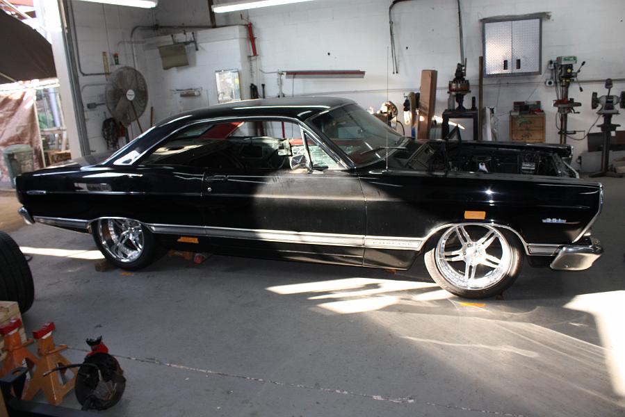

      Awesome job! These cars are unique! Here's one that's in the shop up over here on the east coast! Getting the full CHris Alston chassis...just some "motivation"

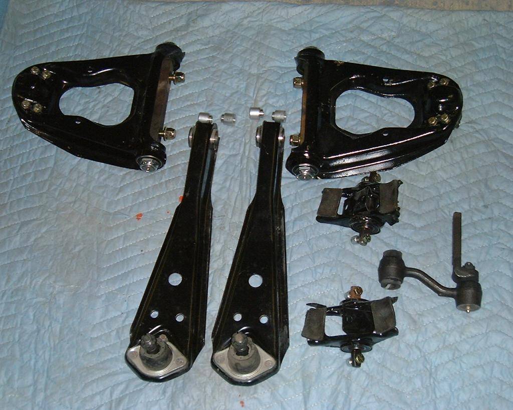

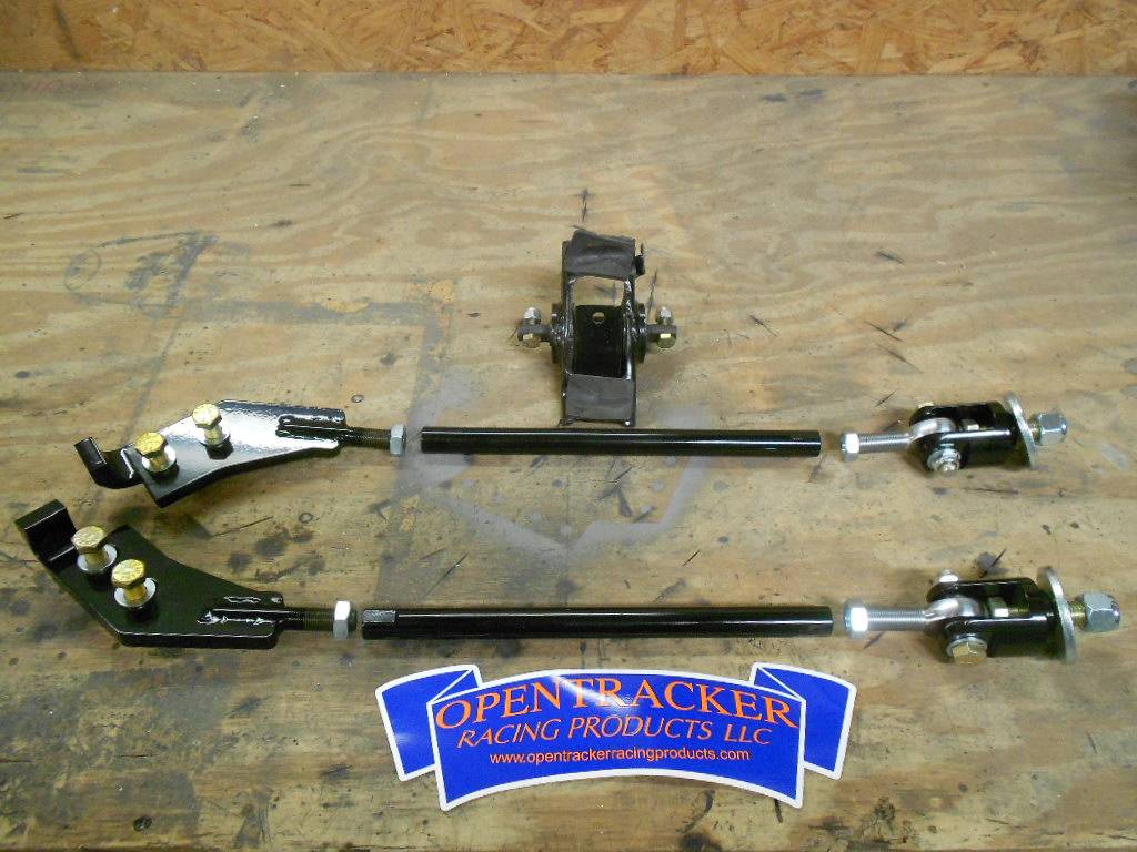

      I removed the Opentracker suspension to make it easier to tape the undercarriage.
      I also wanted to install the adjustable strut rods that came in yesterday
