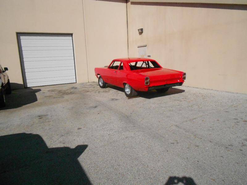

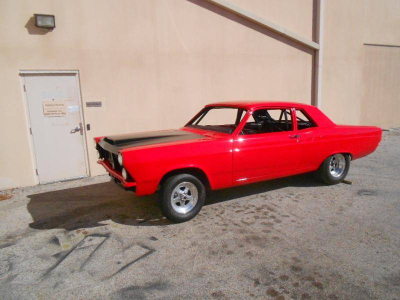

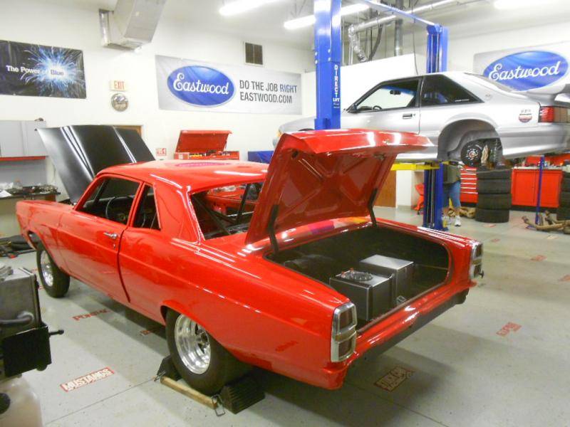

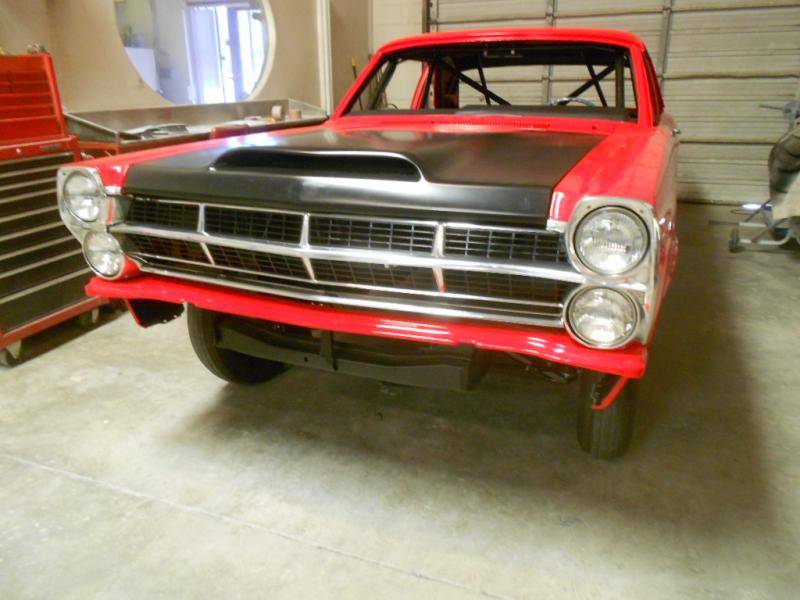

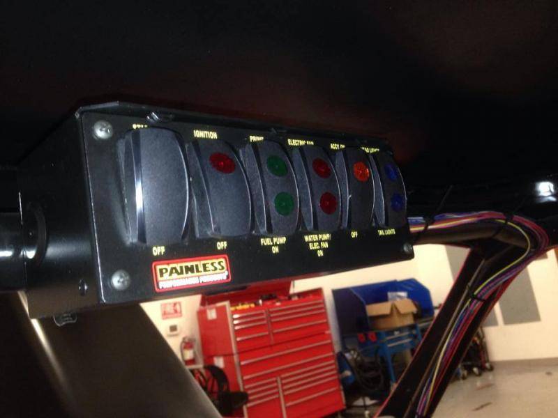

      The Fairlane was moved out of the storage warehouse this morning and waiting to get in the shop.
      Ready to start installing the Painless wiring harness and control panel. Once this story is finished the magazine will be ready to go to the printers.

      Read all about the wiring install in an upcoming issue of Modified Mustangs & Fords magazine.

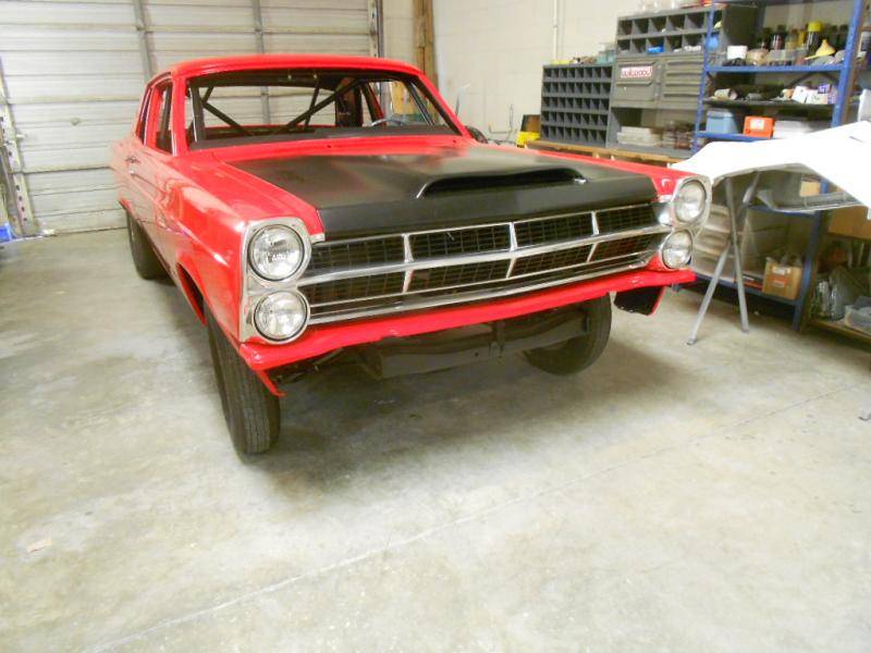

      Yesterday I taped the grille and sprayed it semi gloss black let it dry over night and installed today

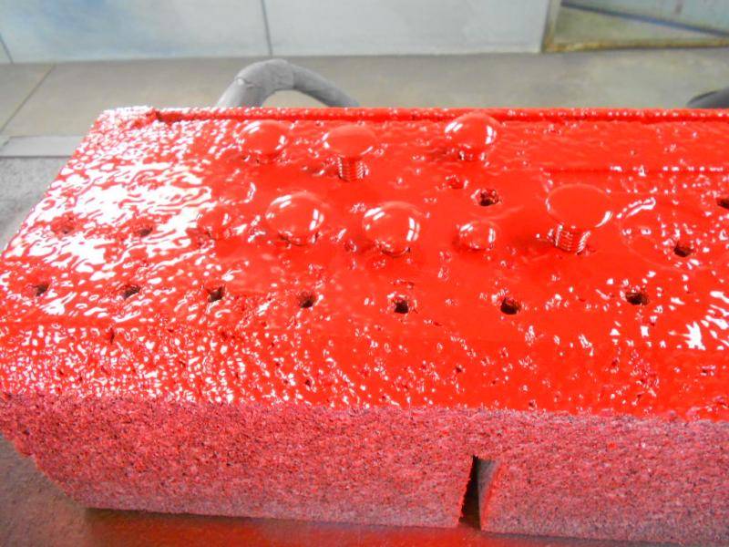

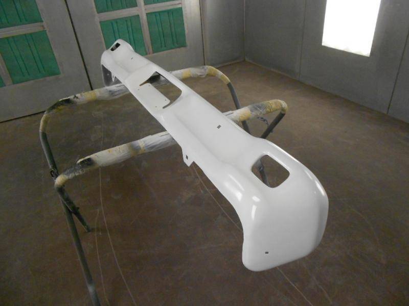

      I forgot to take a photo of the front bumper showing all the surface rust and dents. The rust and chrome was ground and sanded off and epoxy primed. Had to do a little bodywork
      Epoxy primed again
      Sanded
      Slick Sand
      Block sanded with 180 and epoxy primed black so I could see if there were any imperfections
      Sanded again and epoxy primed white
      Three coats of SPI red next day three coats of clear
      Sandblasted bumper bolts before priming and painting

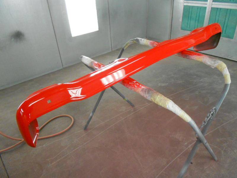

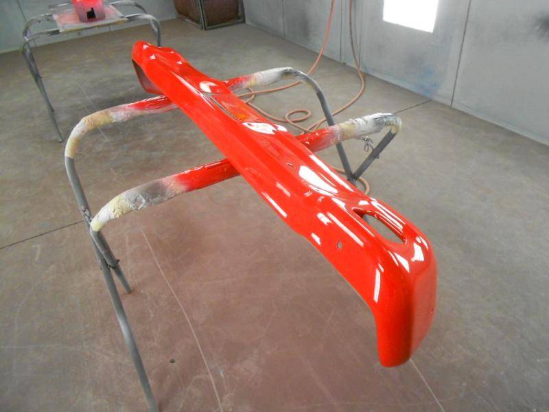

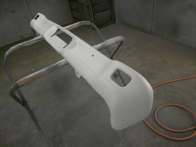

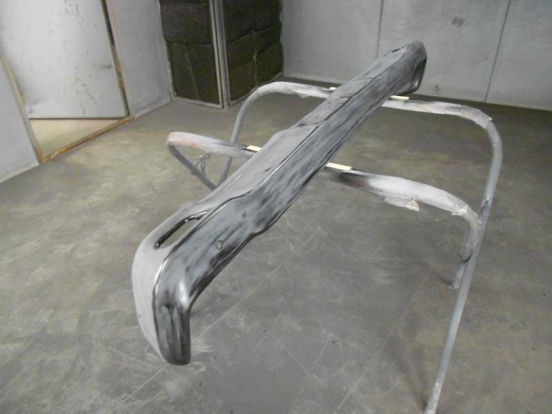

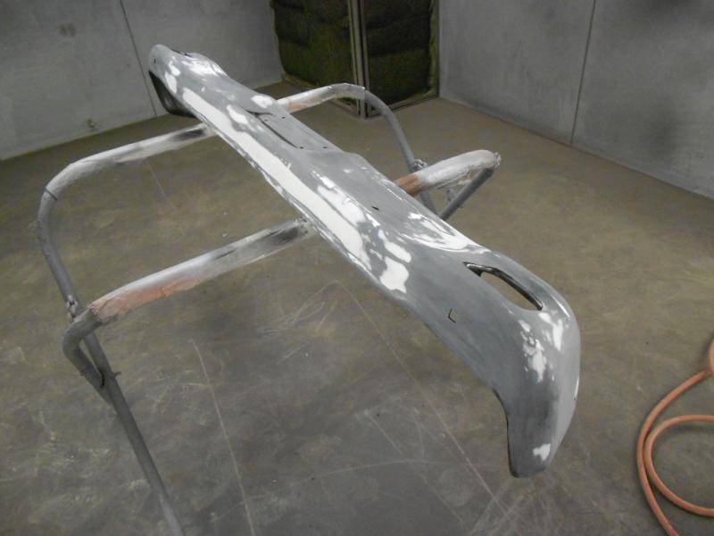

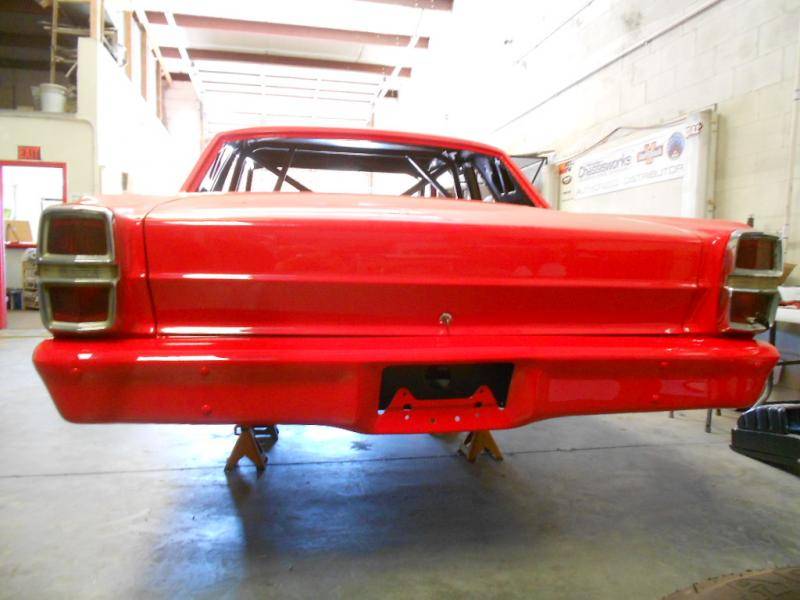

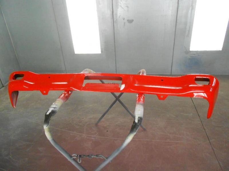

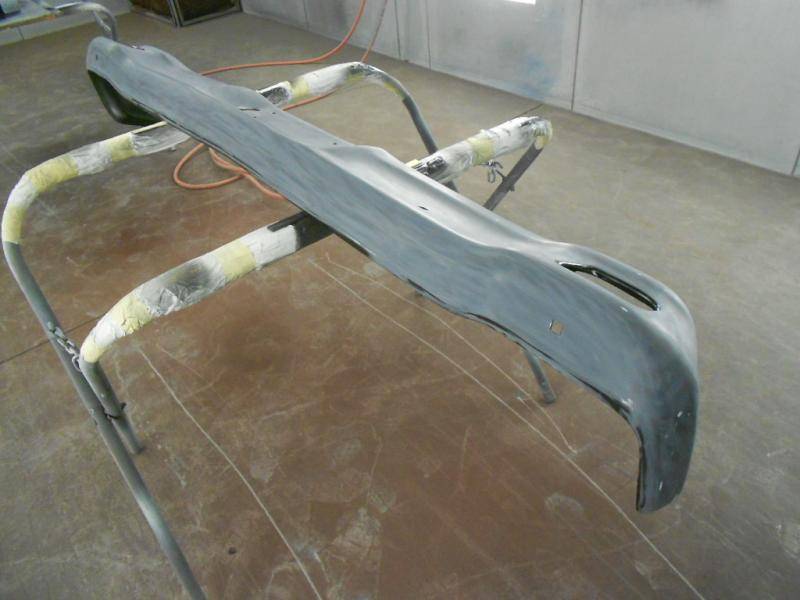

      The rear bumper needs a lot of work
      After straighten, welding and a lot of grinding and sanding I sprayed at least 3 coats of SPI epoxy and started the bodywork
      After a few times of block sanding and priming I sprayed 3 coats of SPI Red the next day 3 coats of SPI Universal clear

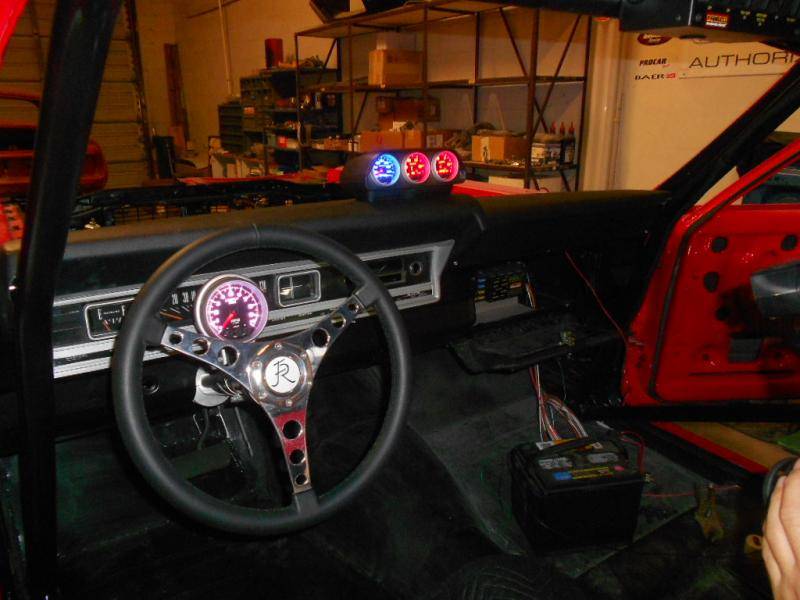

      Autometer Elite tach and gauges installed. You can read all about the install in the August issue of Modified Mustangs & Fords magazine

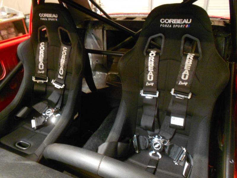

      I have been busy working on customer cars and have not had a lot of time to work on the Fairlane. We now have the headliner installed and the seats.

      This is a great build! I love fairlanes. I like the X brace on the roll bar. Been thinking about doing that in my falcon. How do you like those seats?

      I haven't gotten to use them yet but they are comfortable to seat in.

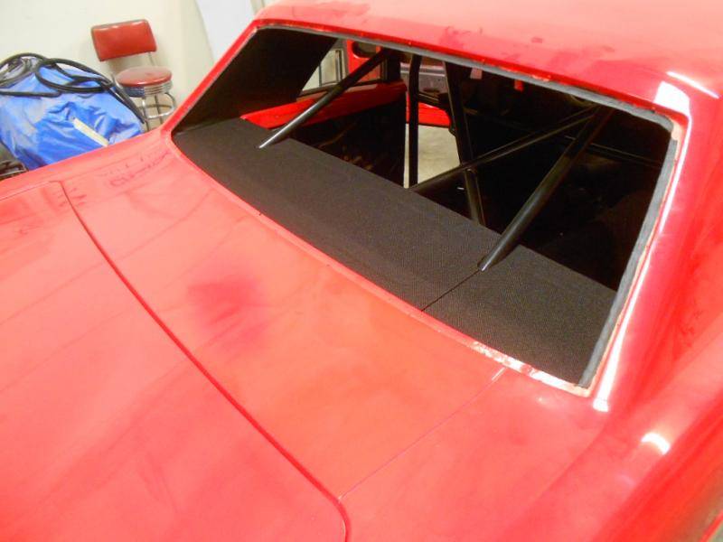

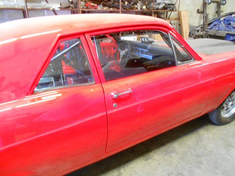

      We are making a little progress it has been over 5 years since there has been any glass in the Fairlane

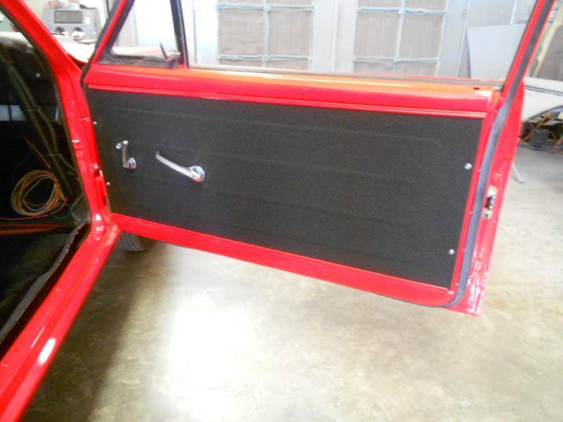

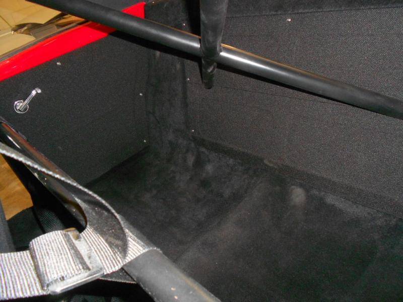

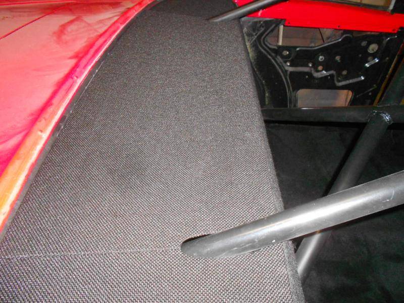

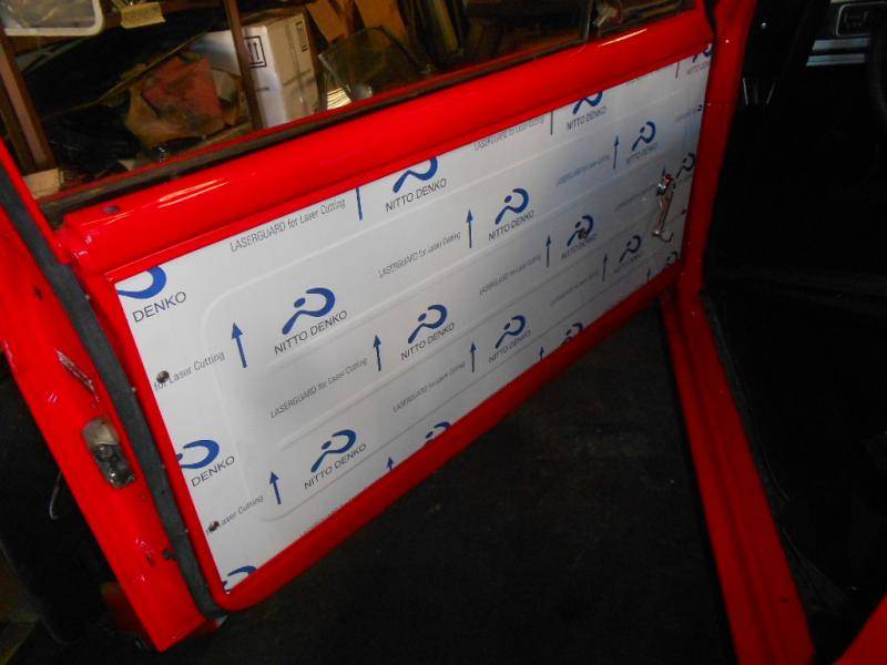

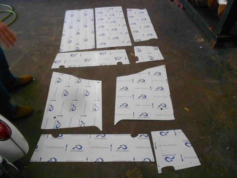

      Brian made patterns of all the interior trim panels out of poster board
      The patterns were sent to Scott Rod Fabrications in Toledo Ohio and were made in aluminum.

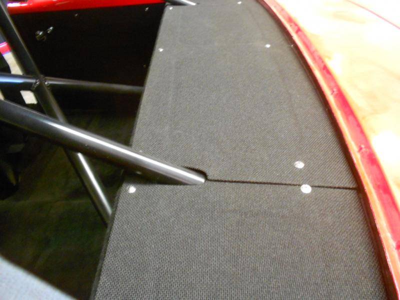

      NHRA requires the interior trim panels to have upholstery on them so I had Mike at Mike's Tops in Port Richey cover them in cloth.
      Mike also covered the rear seat area with carpet. It looks a lot better in person

      Interior trim panels are installed

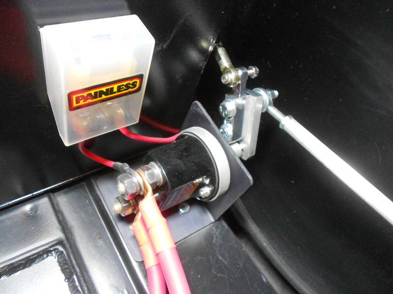

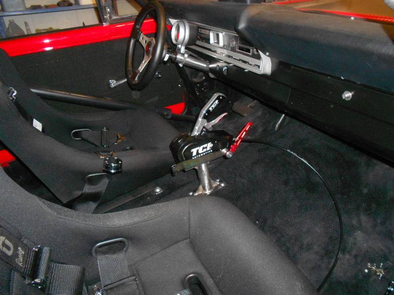

      We have been very busy in the shop and I have not had a lot of time to work on this project.
      We installed a TCI shifter with a custom mount made by my son Brian and Lokar power cut off attached to the Flaming River unit in the trunk.

      Looking good Rusty!
      Where does the other end of the linkage go?
      I assume the big link goes out to the rear of the car for the cutoff, but where does the link on the other side go to?
      Is that just a fuse under the Painless cover?
