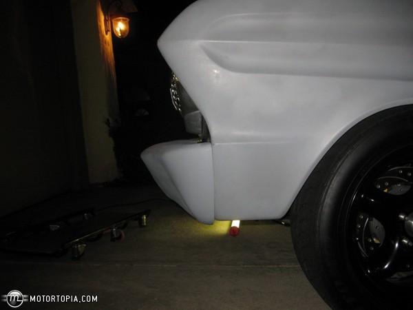

      have any photos from the side on a flat surface?
    12. #152
      san diego
      5,101
      Windsor,
      I will get one. The top of the valance is fairly horizontal. slopes down in the front slightly not as much as other mustangs I have seen with this valance.

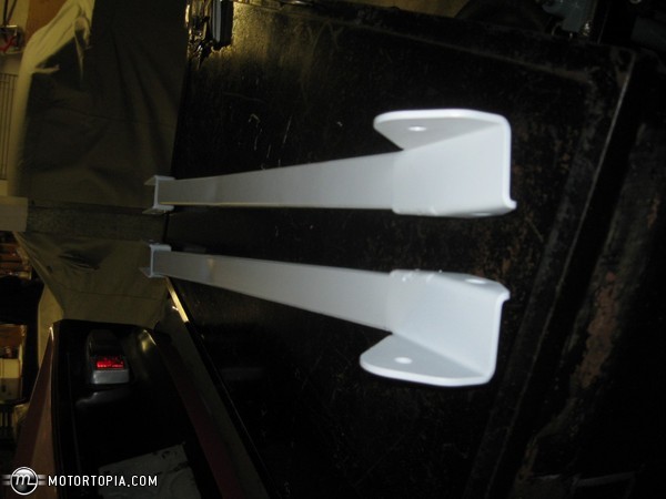

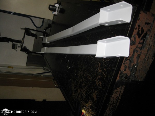

      Im painting my subframes connectors tonight with some self etching weld through primer.
      I will be bolting them in while I plan the rest of the car around them. My front drive shaft loop and rear third link crossmember will be tying into them. But I will need to take them in and out a few time before I can final weld them to the car. The weld through primer will ensure that the back side of the SFCs will be protected.

      here is the picture you wanted.

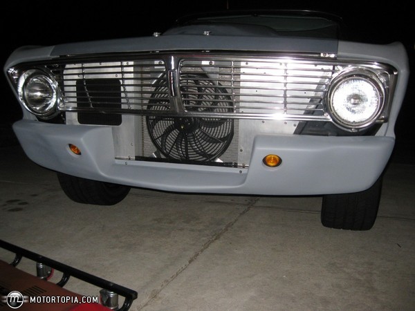

      I painted the subframe connectors and got the blinkers all wired up and the horn mounted and wired.
      Pictures:

      Quote Originally Posted by falcon65 View Post
      John,
      Thanks Bryce...looks even better than I thought it would from that angle. Doesn't stick out as far, which is good. Flows well with the contour of the point of the fender.
      I like it more and more very time I see it.
