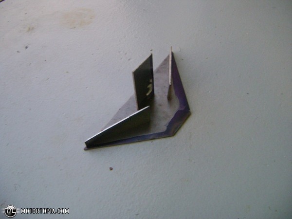

      Too much football is distracting me now. anyway. back to the garage, updated pictures tonight of my boxed in upper third link mount.

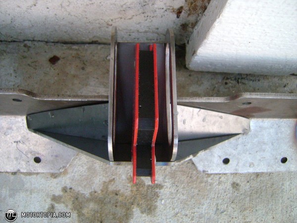

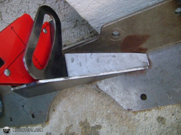

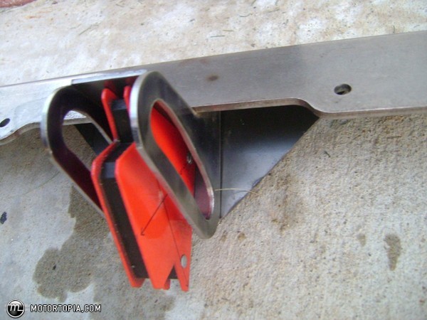

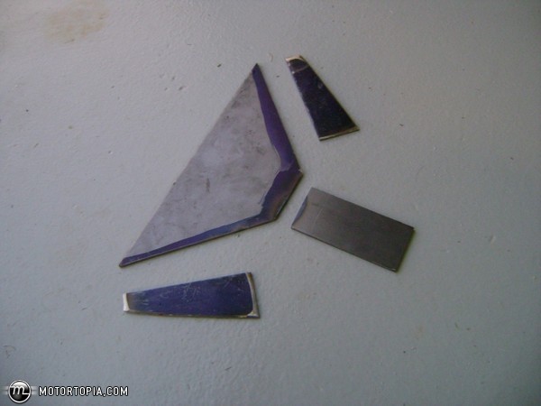

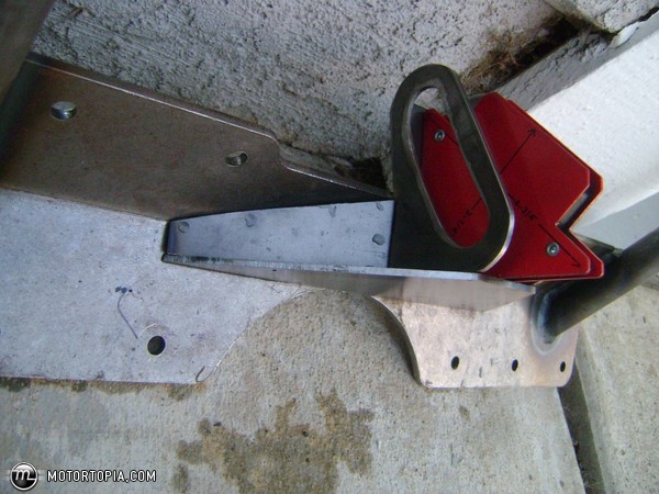

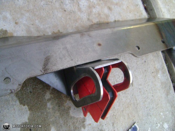

      Here are the pics of my boxed in third link mount, before welding.
